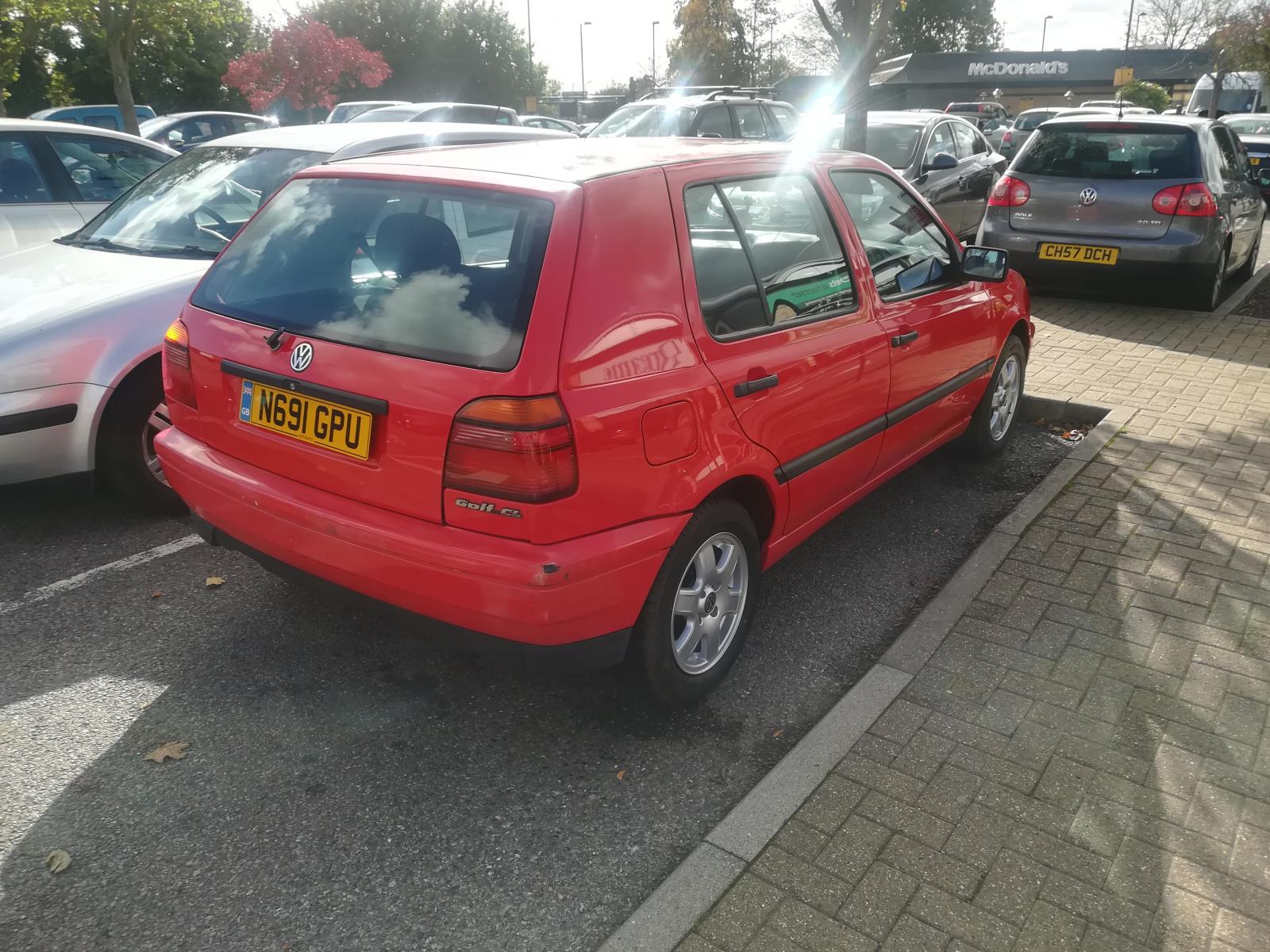

pandamonium Posted October 12, 2017 Author Posted October 12, 2017 During a jet wash, the car helpfully managed to 'delete' its rear wiper... Oh well. Weight saving... HillmanImp, loserone, Heidel_Kakao and 4 others 7

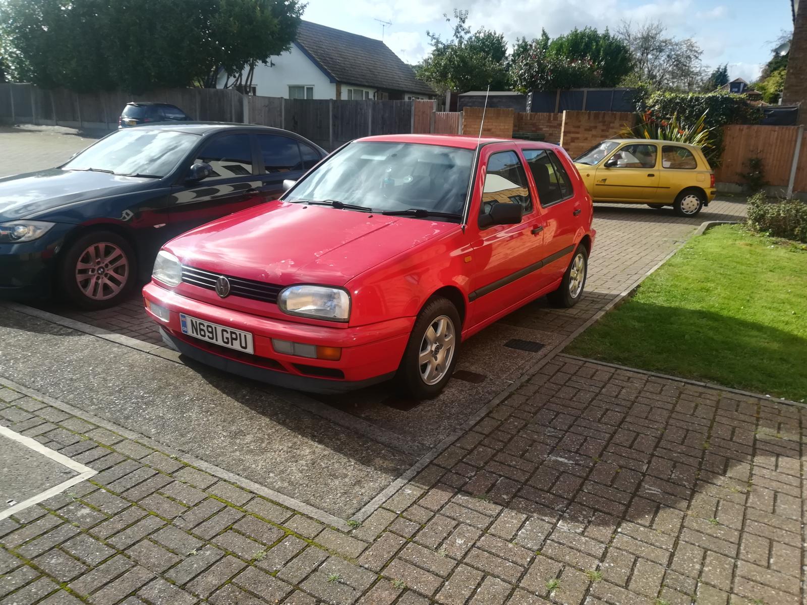

pandamonium Posted October 12, 2017 Author Posted October 12, 2017 Scrubs up well ... Mr Laurence, Alusilber, Lacquer Peel and 3 others 6

Mr_Bo11ox Posted October 12, 2017 Posted October 12, 2017 Tidy. I'm going to suggest leaving the springs alone, just in case you need to travel any distance or attempt to sell the car in future. cobblers, strangeangel, Heidel_Kakao and 9 others 12
pandamonium Posted October 12, 2017 Author Posted October 12, 2017 Tidy. I'm going to suggest leaving the springs alone, just in case you need to travel any distance or attempt to sell the car in future. Yes, that would be wise. Thanks for keeping the 'I told you so' subtle... The Moog, DeeJay, purplebargeken and 5 others 8
