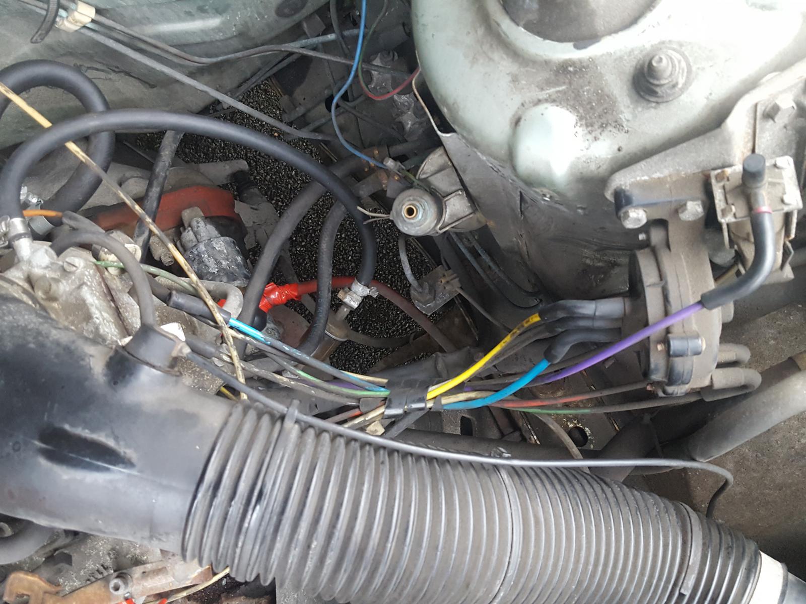

Long shot but I dont suppose any one knows what this device is on the inner side of the strut? Also follow the blue pipe - its disconnected and looks like a vacuum pipe. Can someone confirm if its supposed to be connected - someone with similar engine? Mines the 2.3 B230K.
Here's a photo
Never mind - found a diagram online... connects to bottom of air tube. Engine running sensor apparently.

Excellent! I'm guessing the odd conponent is something carb related? Never seen one on an injected 740, bracket is usually empty.
No Idea, That thing on the inner wing, has a hose coming off it with a jubilee clip on the end, but its not connected to anything and the hose is about a meter long if that.
Strange
its a vacuum amplifier ....
