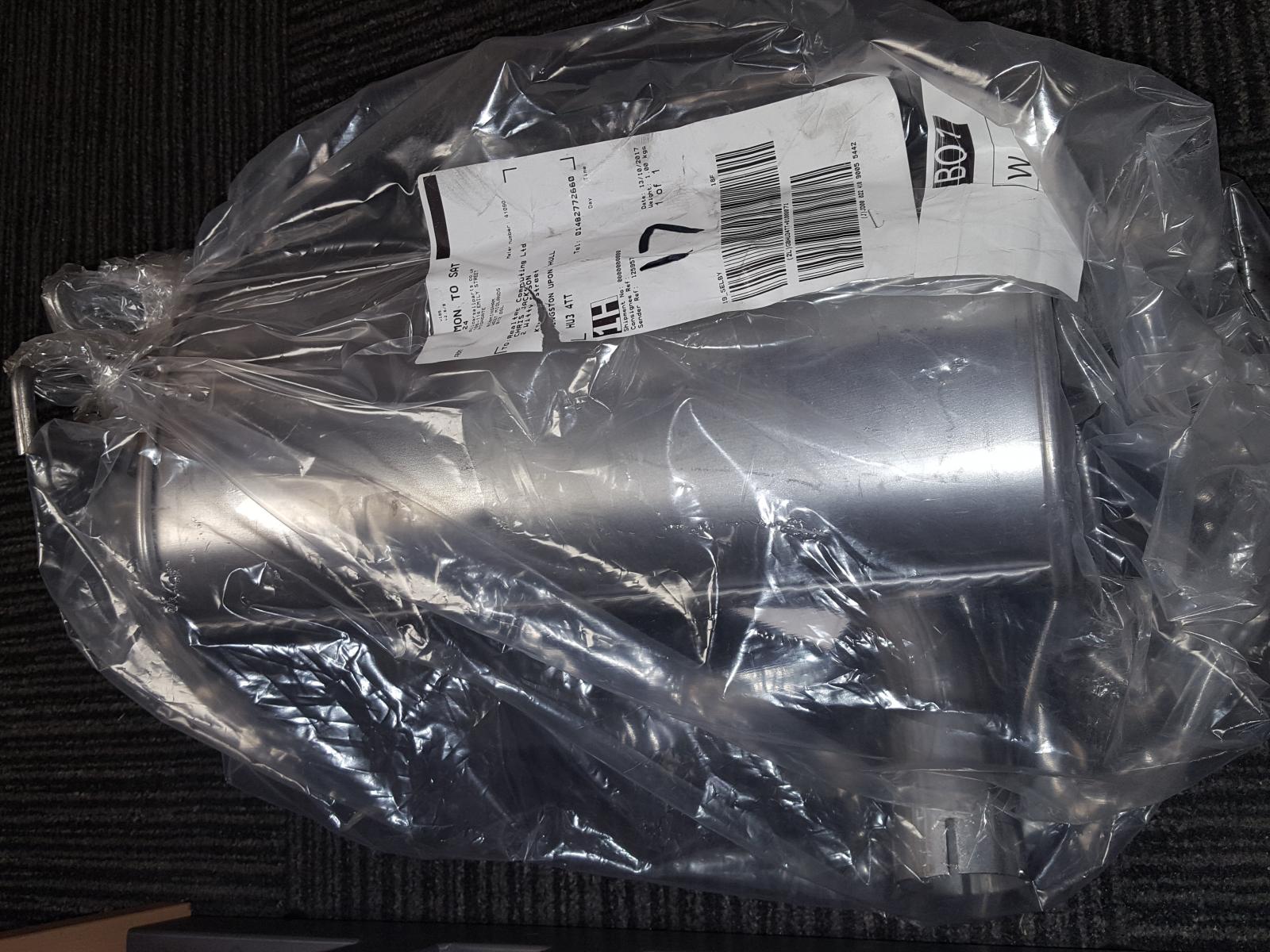

First of many jobs. Next job is rear silencer - when it arrives.

This will be interesting - whats the betting the pipe behind the back box is rotten meaning I need a new centre section ;)
