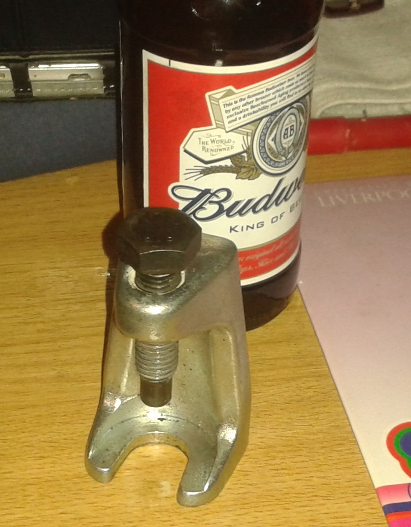

I've tried hammers, screwdrivers, crowbars (hence the broken mechanism), plusgas and swearing loudly and nothing's worked. I bought this device hoping it would be the answer but the bar at the top bends and still the little b***ard won't shift. Any suggestions? I did think about heat but I'm likely to cause nore mischief with that method.

I have used one of these on a stubborn  wiper blade , needed a piece of metal to take up the gap , but it worked !
the bottle behind is to rejoice with afterwards !
I've tried one of them but there's not enough room behind it due to the shape of the plastic moulding.

Was going to suggest this along with a small version of a ball-joint splitter tool.
Put the splitter tool on the shaft/wiper arm & wind it up as tight as you can.
Pour the boiling/v.hot water on the wiper arm.
The combination of the expansion of the arm and the tension on it will (almost) always pop it off. Worked on my old 406 that resisted all other tries at it!

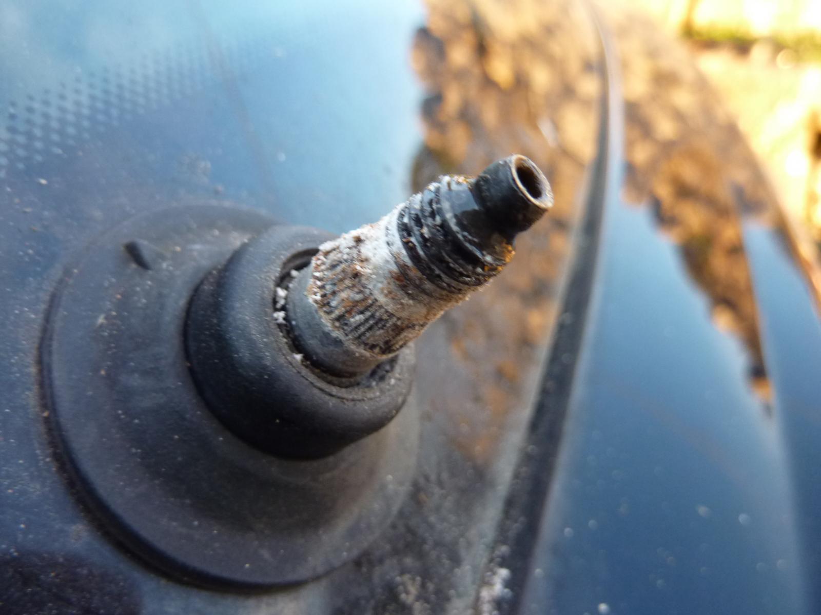

The thread looks totally fucked on the wiper mech now though from the pictures, a good die or you may get away with a file of and hope for the best.

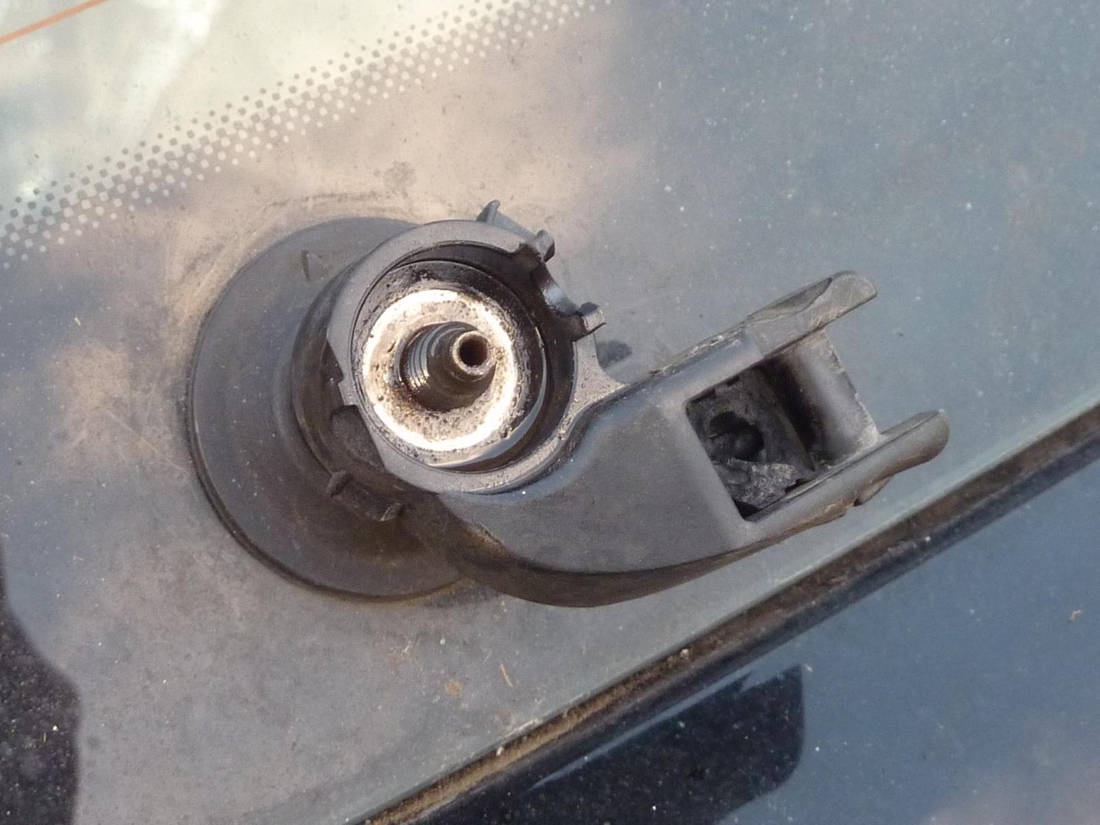

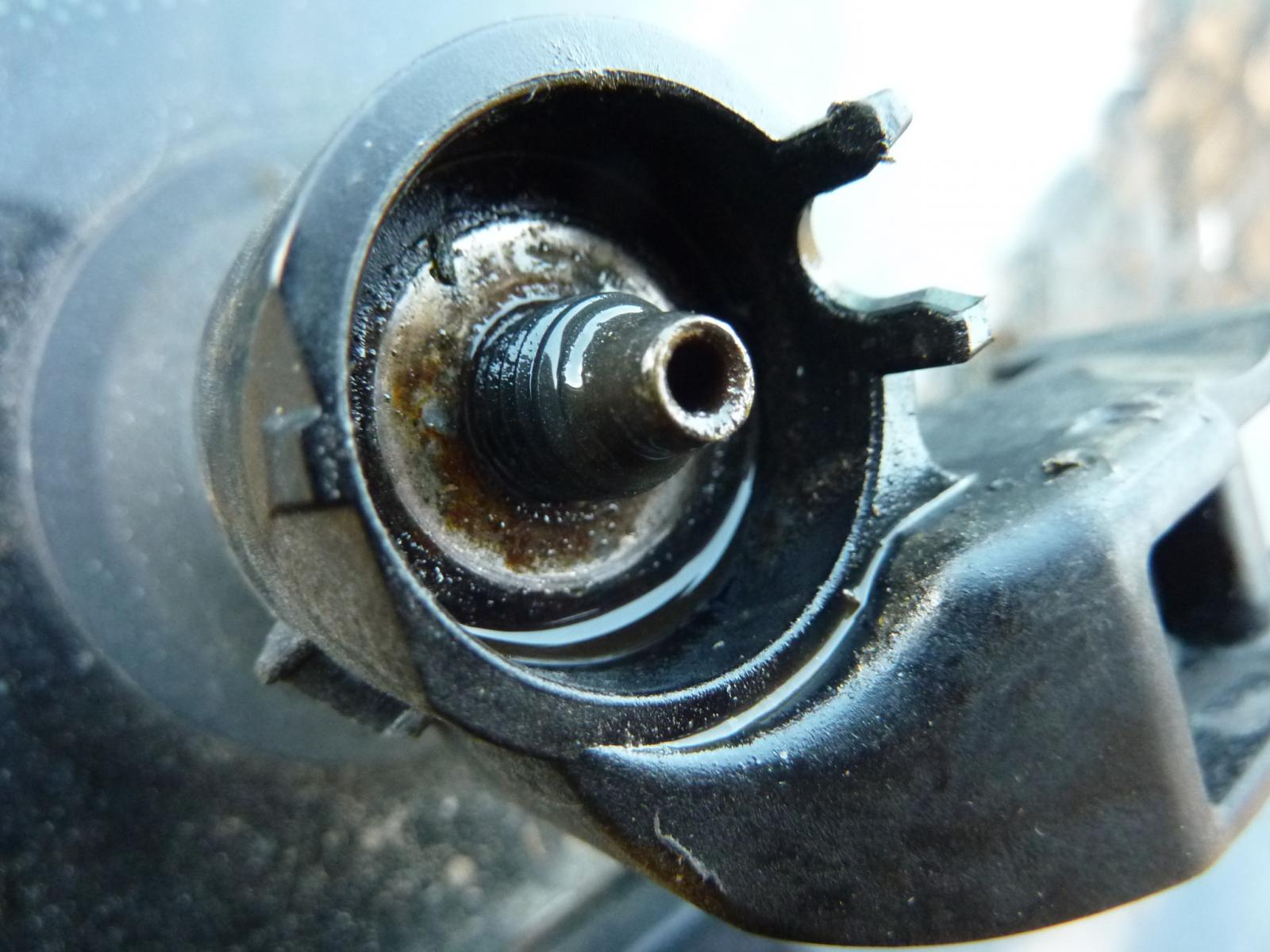

All the good ideas have been shared, so I can only add that I had similar fun* with my sister's A1 rear wiper. So I feel your pain.
I managed it eventually, but it was a buttock-clenching episode, especially as the spindle comes through the glass.
Oiled up, nut and socket for the hammer taps, grips to pull and wiggle lots...
Looking at the new arm I put on it, I theorised that they seize on so badly because the spindle splines cut their own new splines in the soft alloy hole in the wiper arm. The new one came without splines in it.

The device you bought looks ideal - I'd find something that doesn't bend to replace the cheese part then persevere up to the point where the jaws snapped or I'd prevailed. Also, wind it up to tension THEN chuck a bucket of kettle water on it.
Sent from my BV6000 using Tapatalk
You bought the same tool I would recommend. It does need a bit of force sometimes, but I'd wind to tension then use some shock-release freeze spray on it. Put as thick a cloth as you can on the window behind though. Just in case.
I have that tool originally for changing the spark plugs on a Chrysler Voyager, and it's allowed me to have no stress or undue forces when changing seals/wiper parts on a few Mercedes since, so they're a good investment. Useful for things like window winders as well.
