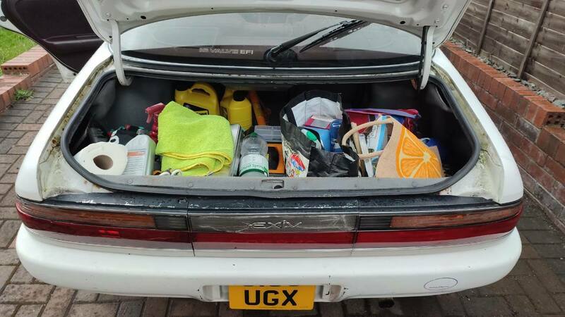

Things looked good until it started to rain and the wiper motor died😂 Fortunately we only got to Durham, turned around and took the Lincoln instead. Lincoln in Lincolnshire, fine with me. Next time!
However, if you are curious how many tools and other garbage fits into the boot of a Toyota Corona EXiV, here ya go:
