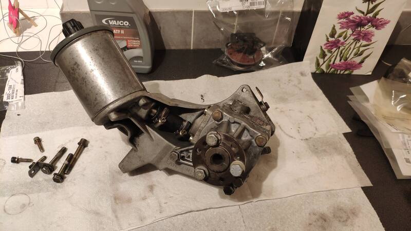

Time for an update! The power steering pump rebuild was a success, I was able to buy anything I needed directly from the dealer, to my surprise the kit needed to rebuild the pump was just a lousy 11 quid. On the other side they were also asking 25 quid for a paper gasket that goes underneath the reservoir, being the cheap shiter I am I decided to buy a sheet of gasket material instead and cut my own gasket. I did the same for the 5cm of hose that connects the reservoir to the pump, Mercedes wanted over 50 quid for a meter of the stuff, I managed to find an oil/fuel/temperature resistant hose with a 15mm inner diameter (which is surprisingly hard to find as most automotive hoses apparently are factions of an inch in size, none of which would fit the pump assembly...) and cut it to size.
I had to buy a puller tool to remove the leaking front seal, something that was on my list for a long time anyway, apart from that no special tools were needed to get the complete job done, although accessibility was quite a pain.
I think in total, not counting any tools I should have anyway, I invested less than a hundred quid. Thats a fraction of the price of a used pump which might leak as well, an even smaller fraction of a rebuilt pump that might not even have all relevant parts replaced, and probably 15-times cheaper than anything you would have paid for at a dealer to have this job sorted. All in all I'm very happy with how things went. The instrument cluster is getting fixed and tested next week and I have already reserved a set of front wings in the correct color to replace the old rusty ones.

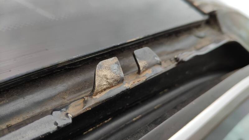

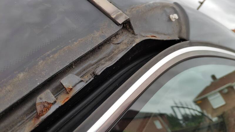

Update time. I noticed that some of the brackets for the A-pillar trim had some minor corrosion so I thought it'd be a good idea to sort these before the new windshield goes in on Saturday (unless there are new issues...). Instead of using a wire brush I've actually done the right thing and bought some wire wheel attachments for my Dremel, which once again proves itself to be one of the best tools in my tool box. Considering two dozen or so of these Chinese wire brush attachments did cost me next to nothing, they held up extremely well (only used one of them) and took any rust down right to bare metal. Kurust, primer, paint and clear coat, and heres the result:

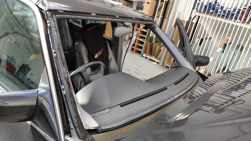

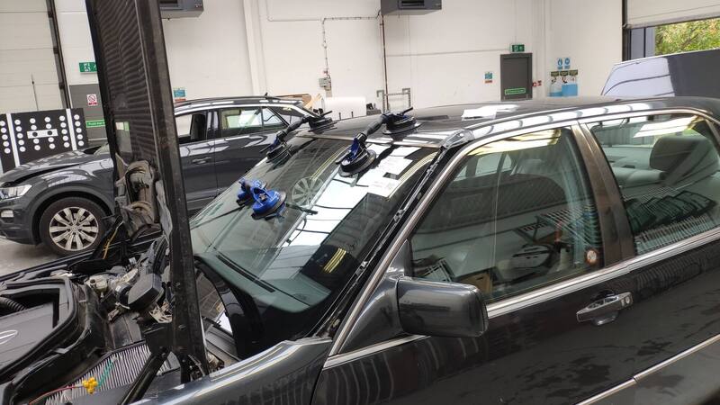

Update time! After the first Autoglass technician proved to be a lazy c*nt, I brought the car into their local branch, properly prepared to have the windshield replaced by someone who can actually give a damn about what hes doing. And as it turns out that is the only thing that was really needed, as the replacement windshield went in without any issues, no extra parts needed. We did however find out what caused the old one to crack. Surprise, its once again shoddy workmanship by someone who couldn't give af about doing his job properly (something that has been a regular occurrence with garages since I moved here until I met Scaryoldcortina) , which ultimately caused it to crack under stress. We found out it wasn't even sealed properly.?
Anyway, I put everything back together today and its as good as new. Just need to get a new wiper arm from the breaker (who still hasn't managed to get me the blower motor after 2 weeks, which takes 10 mins max. to remove), as it turns out the old arm doesn't have any splines left. I managed to clean them on the wiper assembly side at least.

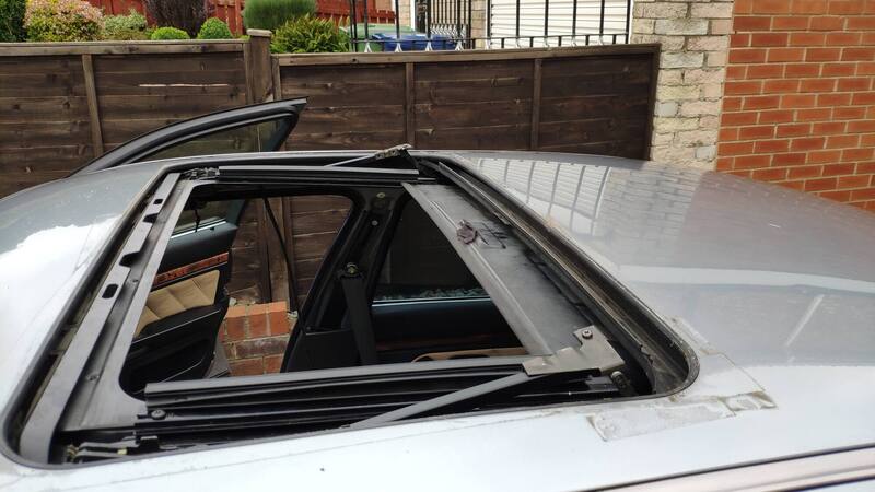

In other news, I finally fixed my sunroof in the E39 after what must be 3 years. That involved removing it completely and assembling the sunroof itself, as well as putting everything back together. Good thing Ive done this about 3 times before... Bonus picture from 1.5 years ago when it was used properly the last time.
A few more things and it should be ready for MOT. However a friend of mine mentioned an incredibly cheap 2006ish A4 Quattro his parents in law try to get rid of, maybe that could be the winter beater I was looking for...
