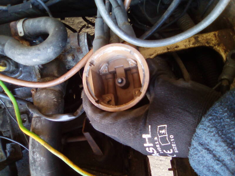

Cleon-Fonte Posted May 29, 2019 Posted May 29, 2019 Good stuff. Does the dizzy cap look like this one?
strangeangel Posted May 29, 2019 Author Posted May 29, 2019 11 minutes ago, Cleon-Fonte said: Good stuff. Does the dizzy cap look like this one? That's like the new, boxed one we found in the boot - unfortunately that one screws on, and the car's distributor has clips.
Cleon-Fonte Posted May 29, 2019 Posted May 29, 2019 This one is the one we need then: https://www.ebay.co.uk/itm/46030-INTERMOTOR-DISTRIBUTOR-CAP-CITROEN-FIAT-PEUGEOT-RENAULT-SEAT-TALBOT/202683484518?epid=248744646&hash=item2f30e08966:g:fEMAAOSwX8dbqjoj&frcectupt=true
strangeangel Posted May 29, 2019 Author Posted May 29, 2019 7 minutes ago, Cleon-Fonte said: This one is the one we need then: https://www.ebay.co.uk/itm/46030-INTERMOTOR-DISTRIBUTOR-CAP-CITROEN-FIAT-PEUGEOT-RENAULT-SEAT-TALBOT/202683484518?epid=248744646&hash=item2f30e08966:g:fEMAAOSwX8dbqjoj&frcectupt=true It is, and it's now ours. How this project has missed you Michael Cleon-Fonte and beko1987 2
KruJoe Posted May 29, 2019 Posted May 29, 2019 Our dizzy and cap. As Jaz said, clips, not screws to attach it. There's also a new rotor arm in the box with the (wrong) new cap, which looks like it *might* fit. It did slot onto the shaft ok when I tried (but I re-fitted old arm and cap.) Cleon-Fonte, Mrs6C, strangeangel and 1 other 4
