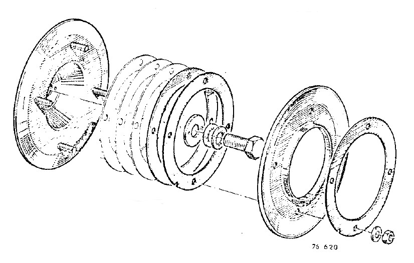

Junkman Posted November 30, 2017 Author Posted November 30, 2017 Guys, it's very noticeable that you don't live in the parallel Universe of R16 ownership.Not only are those shims highly sophisticated, no, there are also early and late types.Mine sure enough requires the early type, with the large inner diameter, which are very delicate.
Squirrel2 Posted November 30, 2017 Posted November 30, 2017 In less hotel related news, the new fanbelt actually makes the entire car run smoother, who would have thought?Another side effect is that the water now actually gets pumped around, which means the heater is even better.Yes, an R16 can serve as an impromptu sauna. On the down side, I'm afraid the tension is too high, due to lack of shims, which btw. aren't available anywhere.I only hope it will survive the 200 mile trip home tomorrow.Could you get a pile of M8 flat washers to temporarily space out the pulley sections? Just a suggestion... heck of a pull on the water pump bearings otherwise. Squirrel2
Junkman Posted November 30, 2017 Author Posted November 30, 2017 M6 more likely and yes, it crossed my mind.You do realise how quickly these temporary solutions become permanent? Squire_Dawson and Squirrel2 2
Eddie Honda Posted November 30, 2017 Posted November 30, 2017 DSCF1372 by Baron von Zach, on Flickr There's no fanbelt there as there is no fan driven by that v-belt I see it is the camshaft to waterpump belt, rather than the waterpump to dynamo/alternator Mine sure enough requires the early type, with the large inner diameter, which are very delicate. Blah, blah, blah. drawing says 5 inside, 1 outside. Two part numbers 06 07 970 200 / 06 08 160 200, probably 1 thick, 1 thin. Arrange the stack as necessary. Later cars have fixed pulley and "normal" tensioning mech? So question is: How thick? Buy slab of beer. Tin snips and punch and keep drinking cans until sufficient shims made.
Junkman Posted November 30, 2017 Author Posted November 30, 2017 Yep, that's pretty much the result of my research as well.Real World says as many inside that the fanbelt is snug, rest go outside.Sadly this can't be rigged up tomorrow between when I finish work and me jumping into my car to drive home,since I can't wait to leave a trail of dust between here and Oop Narf. Oh, and I keep calling it a fanbelt just to piss you off. Squire_Dawson, Eddie Honda and Squirrel2 3

Junkman Posted December 1, 2017 Author Posted December 1, 2017 Home achieverated. WGC to Civilisation in 6.5 hours with not a foot of motorway.2 hours just to get out of that shithole Darn Sarf. All well and good past Beddfedd.Kettering void of signposts, except for some to such metropoles as Oakham, Rockingham,and some other dreary dumps I've never heard of, thus some lost gettage was had. Car still runs fine, but has developed an intermittent knocking sound from the upper front of the engine.Not good news. Something's fucked. Will investigate tomorrow and report.
Noel Tidybeard Posted December 2, 2017 Posted December 2, 2017 Home achieverated. WGC to Civilisation in 6.5 hours with not a foot of motorway.2 hours just to get out of that shithole Darn Sarf. All well and good past Beddfedd.Kettering void of signposts, except for some to such metropoles as Oakham, Rockingham,and some other dreary dumps I've never heard of, thus some lost gettage was had. Car still runs fine, but has developed an intermittent knocking sound from the upper front of the engine.Not good news. Something's fucked. Will investigate tomorrow and report. the spare wheel is loose
Junkman Posted December 2, 2017 Author Posted December 2, 2017 Nah, man. It sure is more serious than that.
Eddie Honda Posted December 2, 2017 Posted December 2, 2017 Zut alors! You've killed la pompe à eau! pshome and Squire_Dawson 2
Eddie Honda Posted December 2, 2017 Posted December 2, 2017 Well, am I right or a meringue? What's the verdict boss?
Junkman Posted December 2, 2017 Author Posted December 2, 2017 I've killed fuck all and you are a meringue.Just one washer on each stud to space the two discs was enough to make everything perfect.The car is running beautifully and all untoward noises went away. I have conclusively proven on many occasions that 50 year old cars are perfectly suitable as everyday drivers.I must try something older next. They_all_do_that_sir, Eddie Honda, mercrocker and 4 others 7
