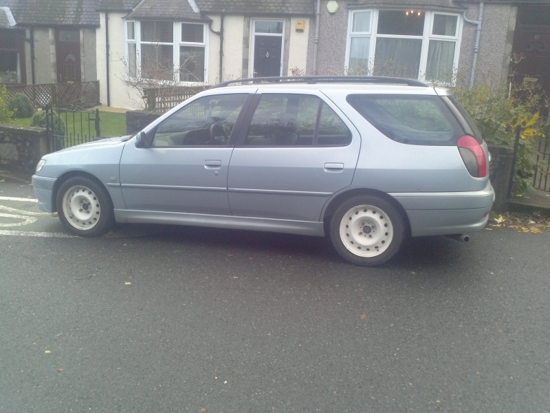

Poor man's 306 HDi estate. It looks pretty good for the money.
Still regret selling my 306 HDi estate in 2014. It went like stink with the 120hp remap.
I even fitted a mid section as a back section on the exhaust, resulting in a freer flowing exhaust, and the funky side exit!
Was there any difference noticeably with the remap? It's something I've considered when towing if the torque would be noticablr
