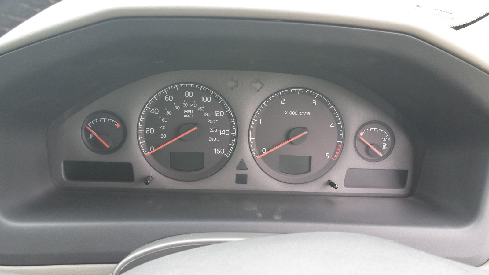

They have been dispatched to volvo diagnostic for repairs which in turn has knocked out most of the electrics.
Under the bonnet we have the warbly 5 pot of turbo diesel goodness, which requires either a fresh battery or an injector leak off test as it sometimes is slow to start.
It's hiding in the naughty corner of the drive until the clocks return, as one of the items that doesn't or is the indicators.

Eventually after head office politely told them to get the 3 parcels they were holding delivered, my clocks got seen by the chaps at Volvodiagnostic.Com who turned them around within a day and had them back to me by 1pm on Saturday.
Outstanding service and knowledge from them, highly recommended.
It took about 10 minutes to get the clocks back in, next I need to scan and clear the various faults it has acquired whilst the clocks were out.

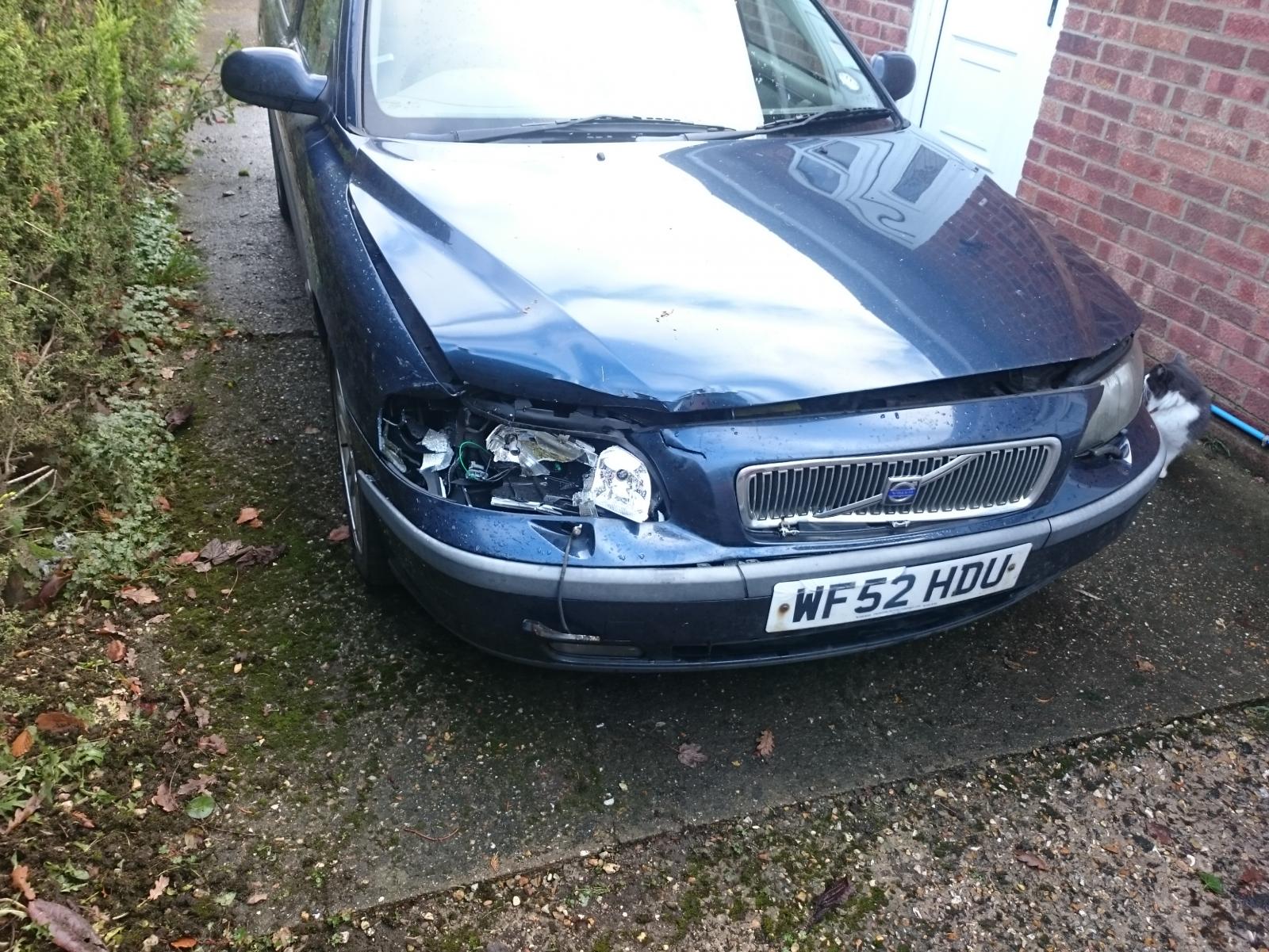

And sadly the tale ends here, an unfortunate series of events has caused a lot of front end damage to the Volvo, so it looks like 307k and out, unless I can find one to break for spares for mine.
That'll go again easily, like you say you just need to find a breakers yard with a suitable car in. How hard can that be?
Mine has also burst the rad so I'll need to strip it down and see what the intercooler and condenser look like. It as also bent the slam panel too.

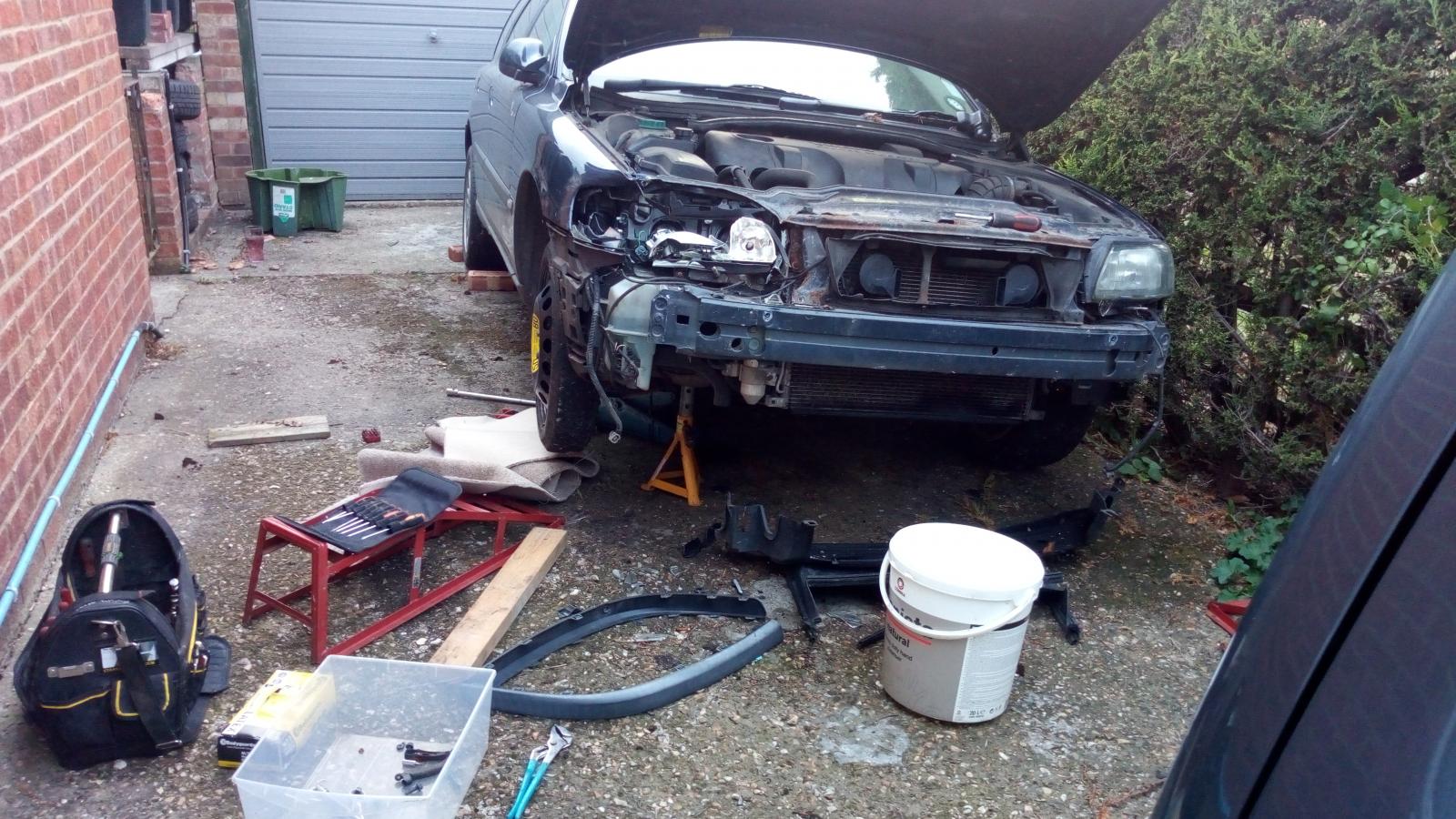

ight, I got stuck in...

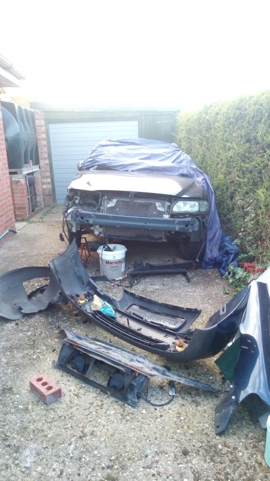

The first thing is to strip off the bent stuff and see how far I need to go...
With the remains of the headlamp and the bent wing removed, it was obvious that the top of the slam panel was bent too, so that has had to come of as well...
The end of play tonight, looking a little happier already...

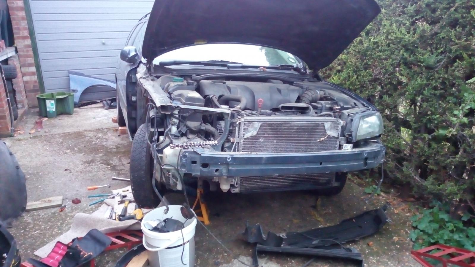

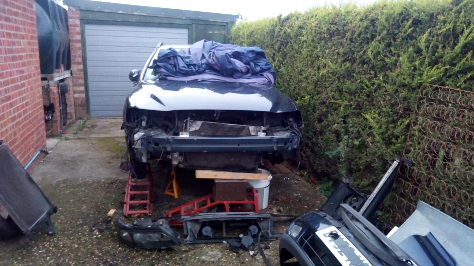

I had a bit of time on this over the weekend around while it was pissing it with rain.
Saturday saw us drop the straight bonnet back on the car, and have a good clean up of the broken glass and plastic that littered the under bonnet area.
I trial fitted the upper framework and found the support panel needed some straightening too, a bit of attention from the medium sized adjustment implement soon had it close to where it needed to be.
Today I decided to pull out the radiator and intercooler to assess the damage, this entailed stripping a lot of the front end off again as well as the passenger headlamp as I didn't want to disturb the aircon condenser.
With the radiator out, it is clear to see where the coolant went...
New radiator on order tomorrow I think.

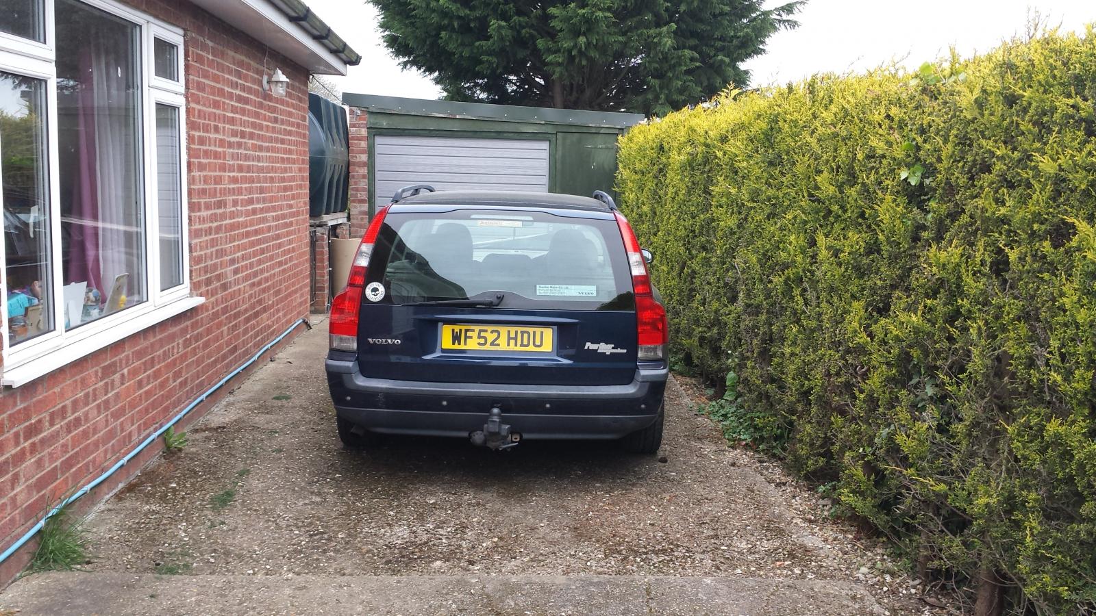

  • 1 year later...
Bumping this for an update later. I have done ALL TEH SHIT to this.
Late last year I burst a back shock towing our caravan, which kicked off a lot of other jobs that needed sorting.
Since it's layup, I serviced the car, replaced the rear shocks, front arm bushes and all of the engine mounts including both vacuum units.

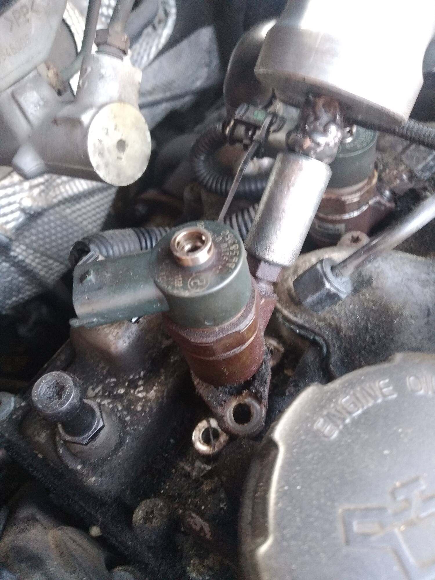

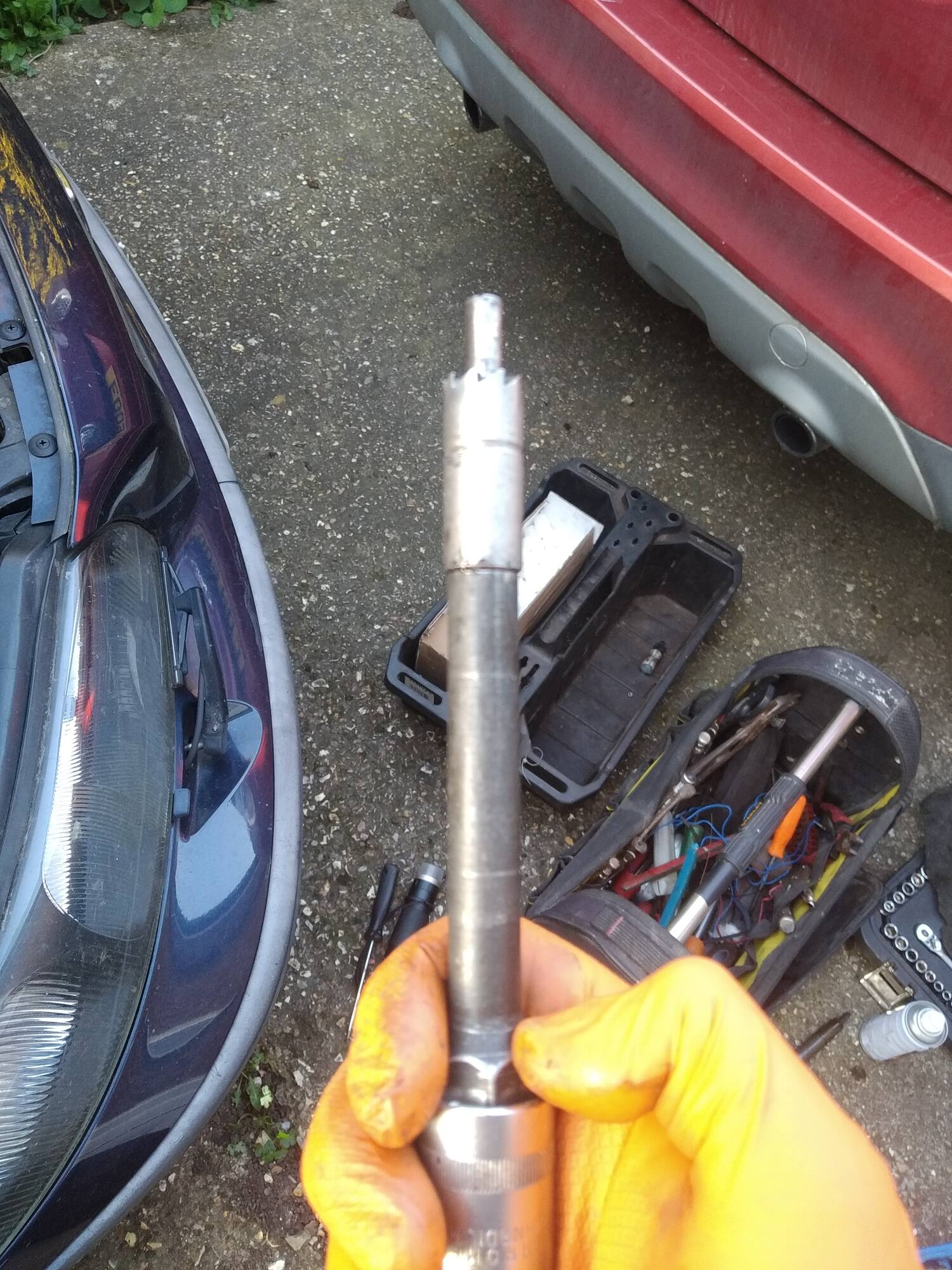

I tested the vac mounts and they behaved, so next onto the injectors...
One of these is not the same...
So tonight, another job...
Slide hammer was barely needed, the injector came out fairly easily.
Finally, a tool to clean the injector seat...
Sadly she still vibrates horribly.
Fuckety fuck fuck.
