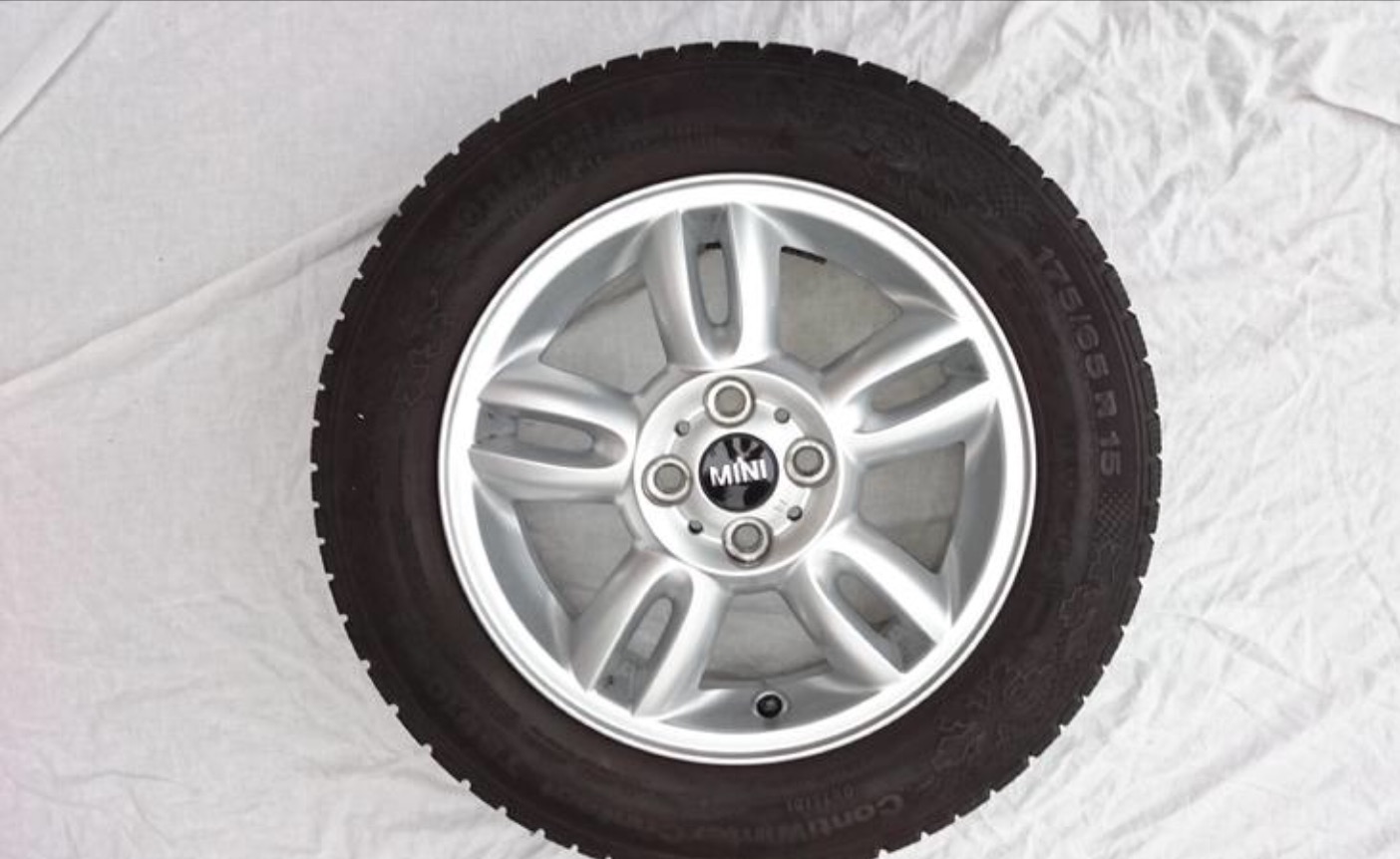

Today I acquired a set of brand new genuine set of mini wheels and tyres for a friends mini from my neighbour for a bargain price of £140 as she has kerbed her wheels more than a few times so are starting to look a bit tatty.
The only thing is the wheels on the car at the moment are 205 16s and the new wheels are 175 15s and wondered would it make much difference to the handling etc.
Also the new wheels came off a 2013 mini coupe when it was new and will be going on a 2004 R53 Bini so should I have any problems with the offset etc.
She will appreciate the lighter steering and better ride, the 16's are pretty harsh riding.
Unless your neighbour is Sabine Schmidt and she is planning a new assault on the ring tomorrow, I think you'll be fine.
There are a few fitment issues when fitting earlier, smaller (15") wheels to later cars, as the later cars have slightly larger discs.
However, as you will be fitting later wheels to an earlier car, you should be fine.

Was just thinking about caliper clearances if it was the cooper s.
But then I spent a further 15 minutes figuring out how to turn that stupid signature off
But the proposal is to fit later, smaller wheels to an early car.
Yes. 2013 wheels on a 2004 car is what I understood is the question.
I'd imagine it will ride better, so as long as she doesn't care about the bling it'll be fine.
Replacement tyres will be cheaper too. Improved ride comfort and lower costs equals win!
I'm not fitting the new wheels on the Bini for a couple of weeks now as the owner is moving and her new house won't have a dirty great big curb outside to damage the wheels on..
But it's good to know that the wheels will fit over the brakes ok..

Have you worked out the difference is rolling radius in these? Sounds like a good swap as long as you don't loose too much
No I wouldn't know where to start but I got it wrong the car is an R50 cooper so these came with 15 inch wheels as standard and it's got some optional 16 inch wheels on at the moment.
I doubt it will make much difference but the car has the device that tells you if you have a flat or slow puncture and after pumping the tyres up you reset a button.
I guess it's just a case of putting the new smaller wheels on and checking the pressures then resetting the tyre monitor rather than being like the useless Renault system which had special valves that I had on a Laguna 2.
2004 bini doesnt have 205 16s
195/55 R16
205/45 R17
or without runflats 175/65 R15
according to one of the comparison sites
Non run flats so the tyres will be 205/50/16 on the original wheels.
Does changing the wheel size affect the speedo or is it too small a change to have an effect?
I was wondering the same myself as the Bini comes with so many wheel size options from the factory surely every car can't be calibrated differently from the next one off the production line.
The overall rolling radius often stays within a few percent unless you're going mental. As you go up in wheel diameter, the aspect ratio and width change too so a mini might have had 175/55R15, 185/45R16 options which will be close enough. There's calculators online to help you out as the middle number is a percentage, not a size.
Also, Speedos are usually made to over-read by 5-10% so if you do change tyre size, you don't end up going faster than you thought you were.
A lot of car makers do this - my Jaaag and MG were offered with different wheel sizes (Jag 17-20, MG/Rover 75 15-18), but the overall rolling circumference tends to be kept very close by using different aspect ratios.  As others have mentioned, brakes may limit the sizes that can be fitted - 15" R75 wheels won't fit my MG as the brakes are bigger.
