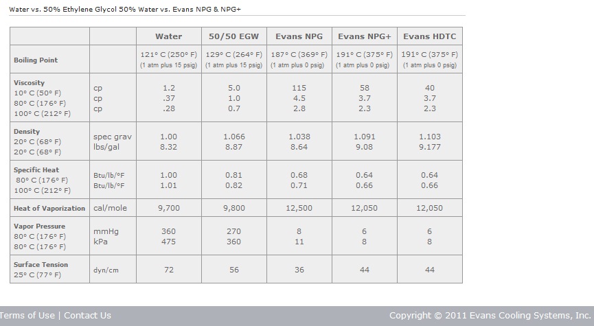

pshome Posted March 13, 2017 Posted March 13, 2017 They used to have this chart on their website, but it dissapeared some time ago, guess why..Good to have archives http://web.archive.org/web/20110710210032/http://www.evanscooling.com/water-based-vs-waterless-differentiators/ Specific heat almost half -> it cannot carry away the heat.Viscosity way up -> this will negatively impact the amount of liquid your water pump can haul around. Your engine will run significantly hotter with this stuff -> no good. From what i know, it was invented for military vehicules that have sealed colling systems and engines that were designed for this.It does not belong into cars with cooling systems designed to use water with classic antifreeze. M'coli, Mr_Bo11ox, Dave_Q and 2 others 5
Mr_Bo11ox Posted March 13, 2017 Posted March 13, 2017 Friggin nora, replace your water with something with 30% less heat capacity, If ever there was a product to define ‘snake oil’ its that. The thermostat will have to open more, increasing the coolant flow rate, to maintain the same temperature as water. Thus you will have less ‘margin’ before an overheat (i.e. less spare capacity to increase the flow rate through the radiator) AND you are going to have to put more work into the water pump (more pumping losses) to maintain the same temperature. I doubt the weekend racers factor that in when they are buying this crap from demon tweeks. Verdict: pointless shite. Vince70 and pshome 2
