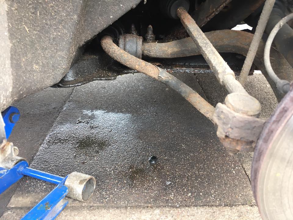

sutty2006 Posted February 17, 2017 Posted February 17, 2017 Buy a Xantia they said.......... It'll be fun(ny) they said........ Ive given up selling the Xantia. After battling through the MOT work and getting it road worthy, I feel its fighting against me at every post. I fixed the coolant leaks, then the exhaust fell off while parked at work. How that happens I dont know, it was fine when I parked it up. But anyway, I have a new issue that needs to be resolved. On my way home from work one day last week the ESP light came on. And stayed on. Until the following morning when it went out. Weird. So I decided to go to the shops in it for some garlic and cheese last saturday morning. I got the end of the road and lost brakes pretty much completely. Thats right. NO BRAKES. It felt like the ABS pump was firing constantly.This was fairly scary so I turned back and parked it up. I decided to check the LHM fluid, which I had checked a week previous (and it was fine). Suspension in top height, engine running the fluid was low. I topped it up with about 1/4 a litre. Brakes are still the same. If I pump the pedal at a standstill, its rock hard and fine but the moment I move the car the lack of braking force is severly reduced.Ive tried googling the fault but common issues on these Xantias is rare as the following is small (or undisclosed, which I dont blame them really) Any thoughts on the issue? I cant see it being air in the system as the brakes would be spongy at standstill. Its a 2.0 hdi by the way Failing that, I will hold a ceremonial burning sacrifice offering to the car gods.

sutty2006 Posted February 17, 2017 Author Posted February 17, 2017 It appears to have been leaking from the footbrake thingy....... I would normally call this a master cylinder as its bolted to the bulk head and attatched to the brake pedal. WTF is it. And where the F am I going to get a replacement!!!?
sutty2006 Posted February 17, 2017 Author Posted February 17, 2017 a little googling comes back as a doseur valve. WANKSTICKS

rml2345 Posted February 17, 2017 Posted February 17, 2017 If the doseur valve is conplete it might just be the seals which can be renewed. The chap at Plediaes can advise on cost etc. But if it's a only car might be a bollock ache. I think they're NLA new.
tommotech Posted February 17, 2017 Posted February 17, 2017 A used valve would be fine but I would run some hydraulic cleaning fluid through, hydraclean if I recall, before renewing LHM. Steering will feel nicer and suspension will work better too.
tabact Posted February 17, 2017 Posted February 17, 2017 If it's the same as a 1.8 pez one talk to Tabact and see if you can have the one off his scrap car, or Ruffgeezer has about 40 xantias parked in a field somewhere... That's one of the parts I'll being hanging onto. Having a browse of the French Car Forum repair parts for the valve could still available or could possibly be a perished pipe.https://www.frenchcarforum.co.uk/forum/viewtopic.php?t=45249 beko1987 1
beko1987 Posted February 17, 2017 Posted February 17, 2017 Sounds like potential easy fixes if it's just the rubber pipes as per that thread.
sutty2006 Posted February 17, 2017 Author Posted February 17, 2017 Looks like I'm taking the induction pipe off tomorrow for a better look 👠beko1987 1
beko1987 Posted February 17, 2017 Posted February 17, 2017 It is on the TD, I need to take them off to fit a cambelt cover, if I ever fit a cambelt cover...
