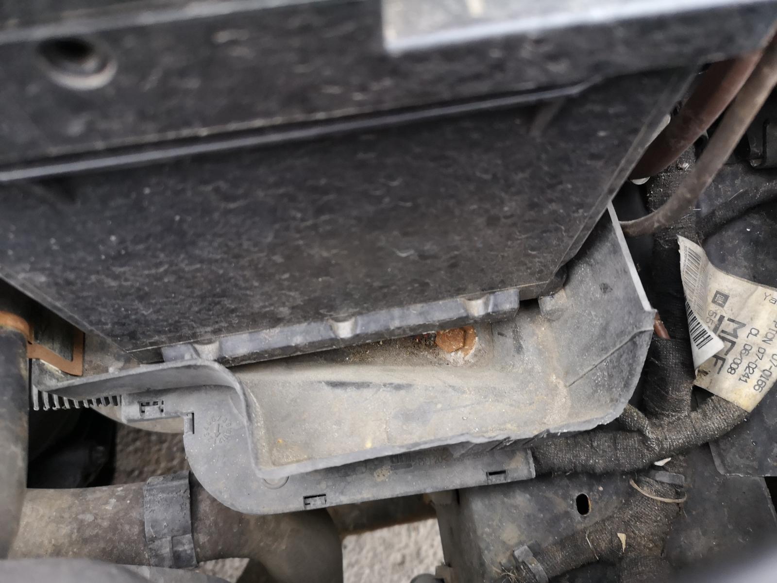

Super work! Nice neat job too.
Cheers! Don't want it catching on fire now do we...
so do the battery connection properly then you slacker! :mrgreen:

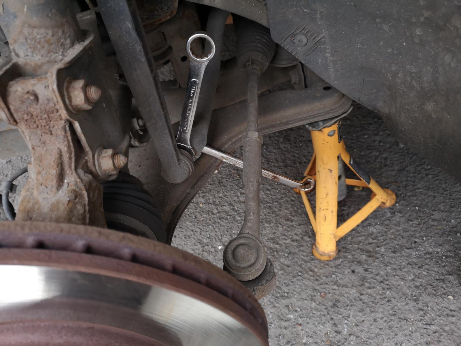

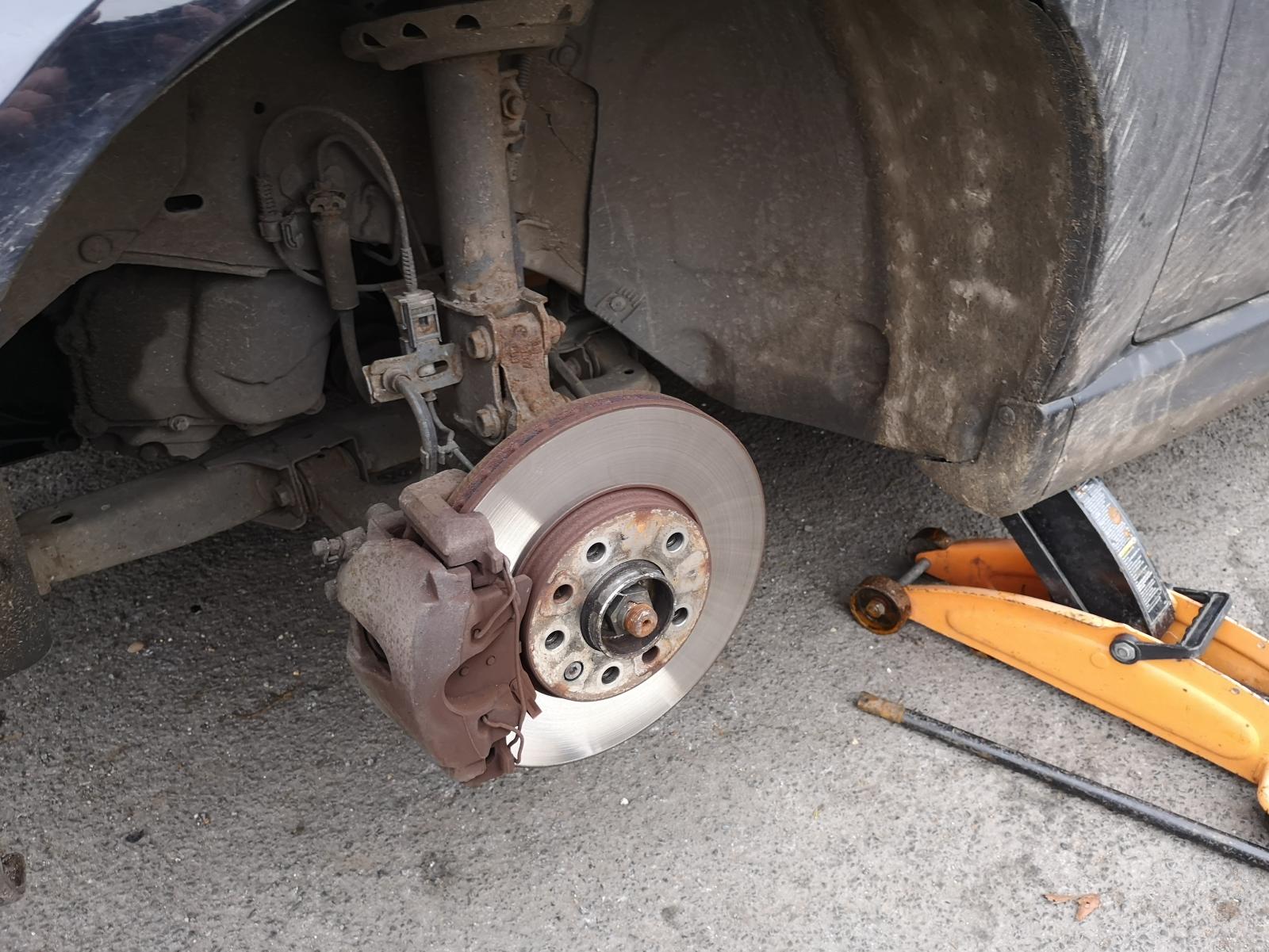

I then stopped it clonking
Old ones were gm branded. Knowing Amy sister they might be original... Fair play if they are, cars on 118k!
Nice smear of coppaslip on the hub face and bolts too.
Next!
Around the estate revealed no more clonking, although I am very lucky as I left my phone in the scuttle... It was fine!

Nope, rattle and clonk still there! Track rod ends maybe? Really don't want to do the ball joint!

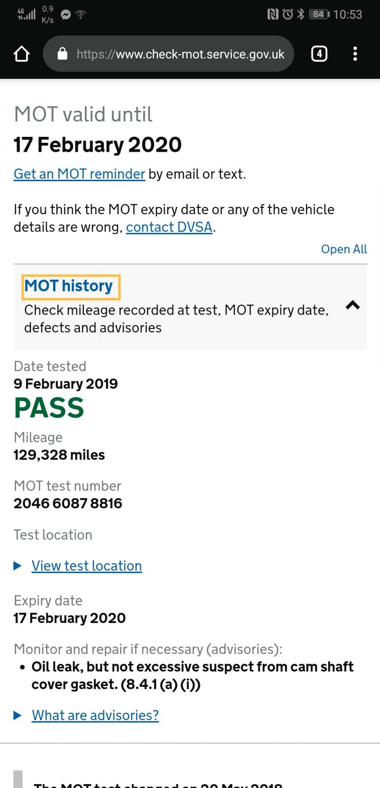

Dropped it off at it's MOT at 8am and had a quite nice 20 minute stroll back home, half tempted to walk back to get it too. No one else was in when i got there bar the receptionist, so no idea when itll get done. Ruddy £54 though, must be the highest they can charge! Mine will go to Mr Clutch for £35 as usual when its due I think!
MT08TWP f5f5f5f5
Good luck. Just remembered my reliants is up next week. Great.
Good luck - at least you have the hope of a pass!
Me, on the other hand...
It's not been done yet... It closes at 12.30, will give them a call in a bit and see what's happening. Out with Eva atm, the roof blew off the shed last night, so she took her first trip to wickes!
Huzzah! Cam cover can stay leaking, that's not where the major leak is! Not going to point that out to them though...
do you need to do the spring mod on the rear calipers ( if fitted ) ?
it does make the hand brake a bit heavier but it ensures the brakes back off
Not seen that before. Don't think so, they work OK at the moment, and Amy never leaves them in gear.
The meriva could have done with it, the cables used to freeze in icy weather and stick on! I got quite adept at lobbing a kettle of boiling water over the cables without kneeling down in the end!
:-D  :-D   I have that mod on my T4 !!
I watched the mot man briefly flash his torch at the caliper....turn away , and then it registered... so he  turned  back for a closer look   :shock:
I asked if it was a problem and  he said " Not at all ! :-D  I know they're prone to sticking !"
