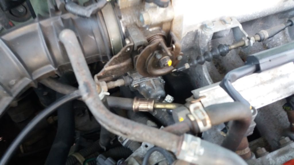

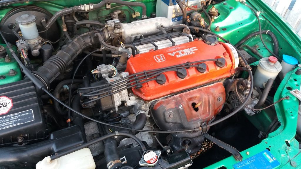

I have got the same engine and auto box fitted to my wifes old CRX and when i first got it it had been standing about and when it started getting some use the coolant was being pressurised and getting blown out of the rad overflow pipe on long runs which then led to low coolant and hot running.
I tracked my problem down to a clogged up cold start / idle speed control valve (metal dome shaped thing below throttle flap) and its pipes which sit under the throttle body and draw coolant off the inlet manifold.
The pipes to it were luke warm at best but after removing and cleaning the valve and pipes it all got nice and hot and sorted the poor circulation/pressurising problems.
It may be worth cutting the middle out of the original stat and refitting it then trying again to see how it goes that way you are less likely to have to chase out trapped air caused by the stat taking an age to open.
I guess being negative the car is 20 plus years old and the head gasket may just be degraded thru age and needs replacing which is a pleasant enough job.
If i wasn't down in Kent i would gladly pop around and have a look.
P.S the orange cam cover is not my doing honest..

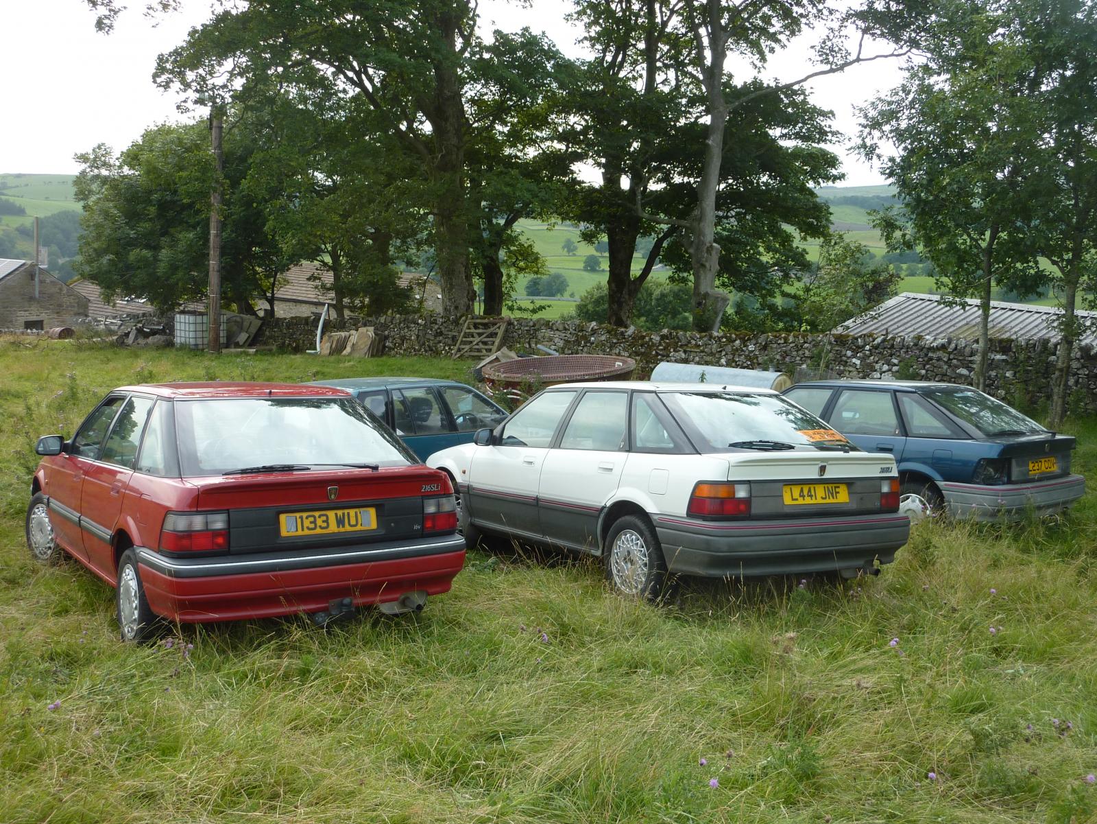

The Chompy_Rover is 90 mins from Manc, it's near Malham, so it's gonna be a four hour round trip minimum with spanner time but you're welcome to go up and raid it free of charge. Make a full day of it if you can.
It now looks like this:
I am in several thousand miles away just now, but please strip it for all you need (and more), pick it dry.

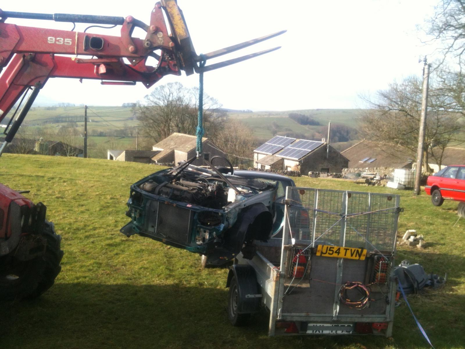

My bro Will (explosive_cabbage) may be on hand to help, tractor available, I'll send you his number Ghosty, and I'll warn the family that I've invited you and the lads to do as you wish with it.
If you fancy taking the whole car to strip at your leisure, borrow my big trailer for a week or two, Will can help you lift it on.
All I ask is that you don't drop anything in the field that animals could injure themselves on (broken glass, shrapnel etc).

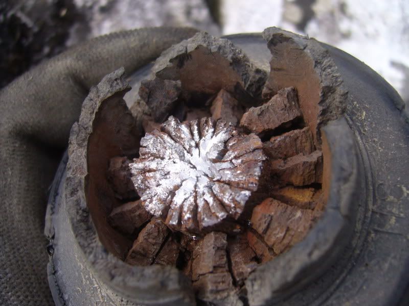

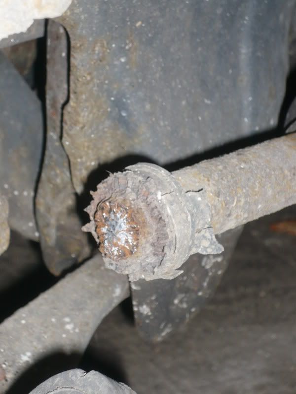

There's plenty of bits inside it too, lights, mirrors etc. It has helped out loads of Autoshite R8's over the years so many of the oft-failing items have gone, but there's a lot left. From memory, one or both of the CV joints are jiggered, but the driveshafts may be worth nabbing, they rust inside the rubber doughnut thing, on my white 216 I sheared one clean in half! New CV's can be found cheap enough.

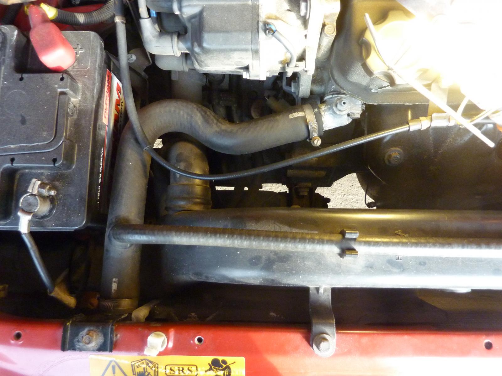

Anyone know anything about the cooling system on D series? We're loooking at the heater/matrix for now.
Compression is fine, removed some silicone that was blocking the radiator overflow to the expansion tank. It's ??? for now.
