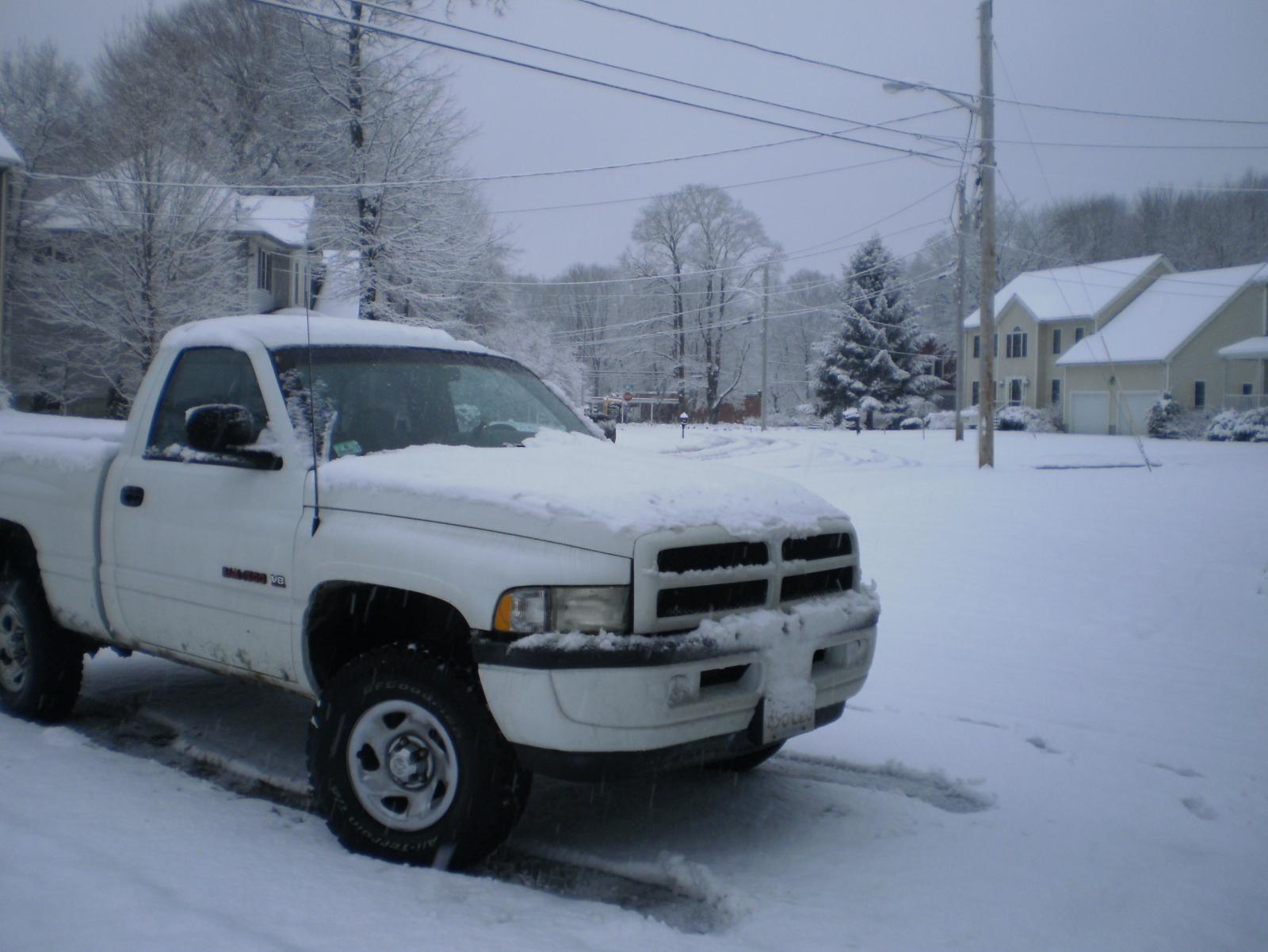

Knobbly M&S tyres - stuck shortly after I took this pic
