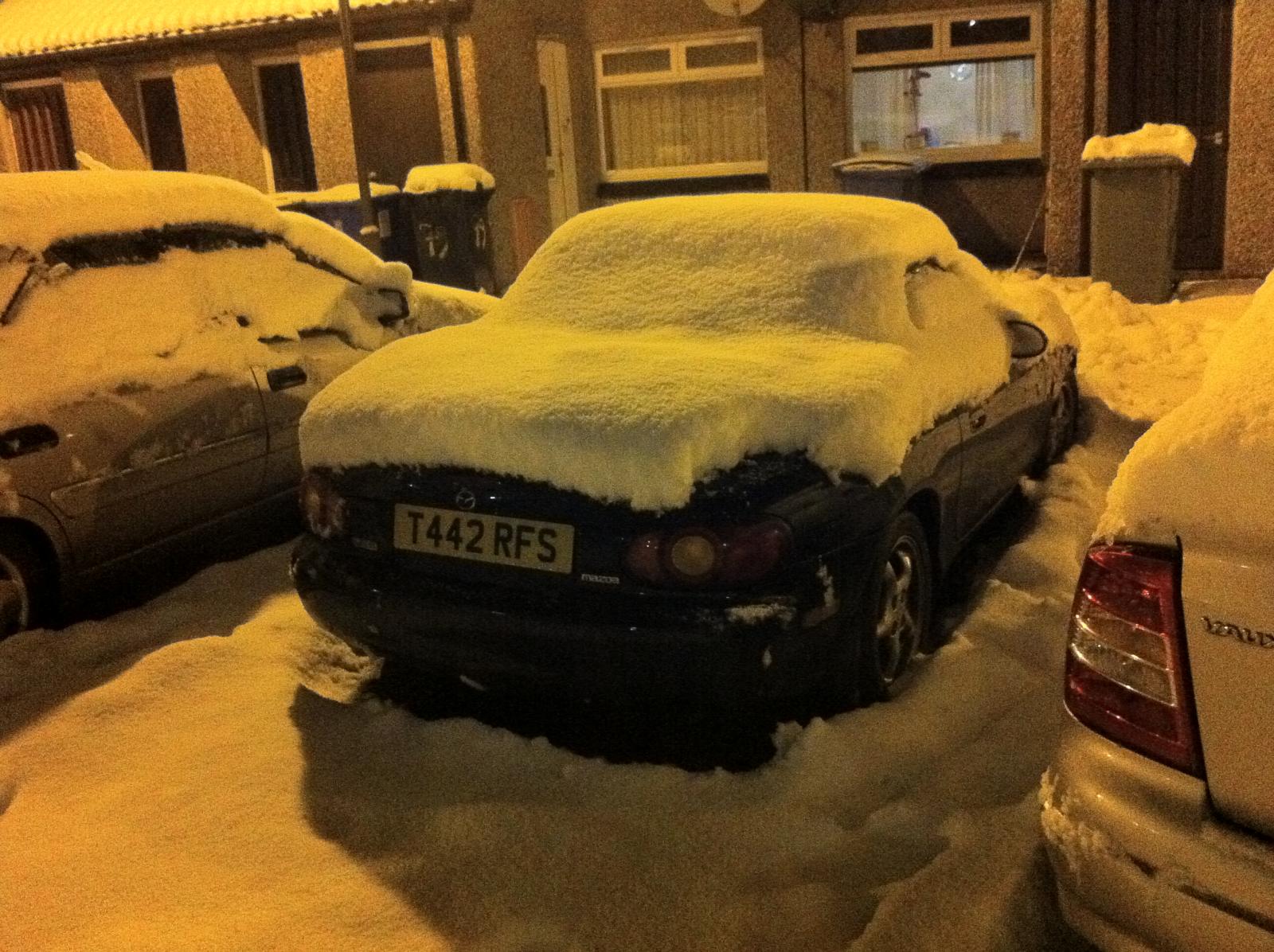

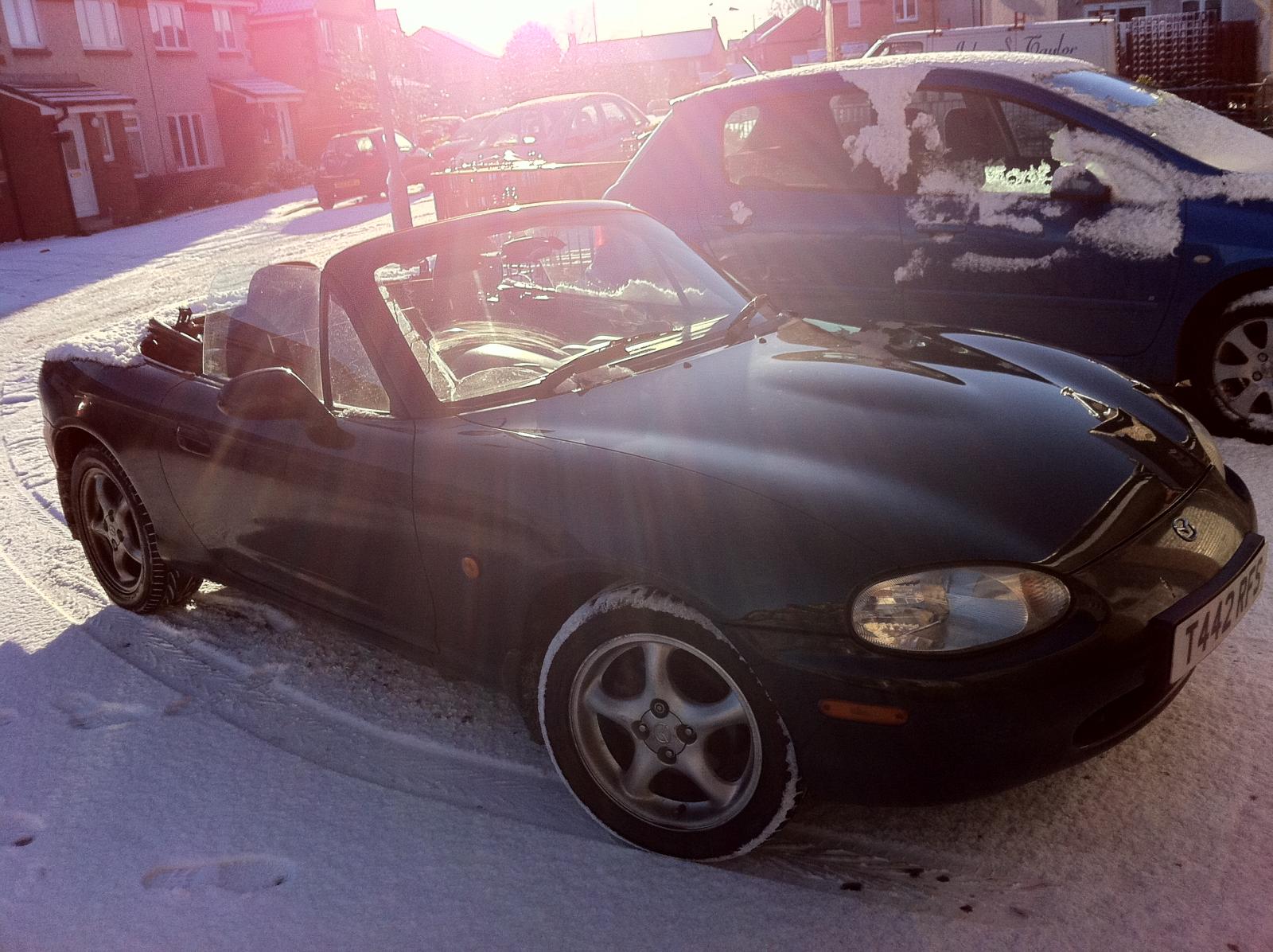

After the bad snow a few years ago the following year I put winter tyres on the back of my MX5. It was crazy how little grip there was. Great fun sometimes but always had to drive carefully.
It snowed a tiny bit that year. I took them off and never used them again.

In 2009 I just about managed getting about in the MX5 but in 2010 I just left it and cleared the snow off the roof. My Mum couldn't drive at the time so I ended up with my Dad's Vectra to run about in.
