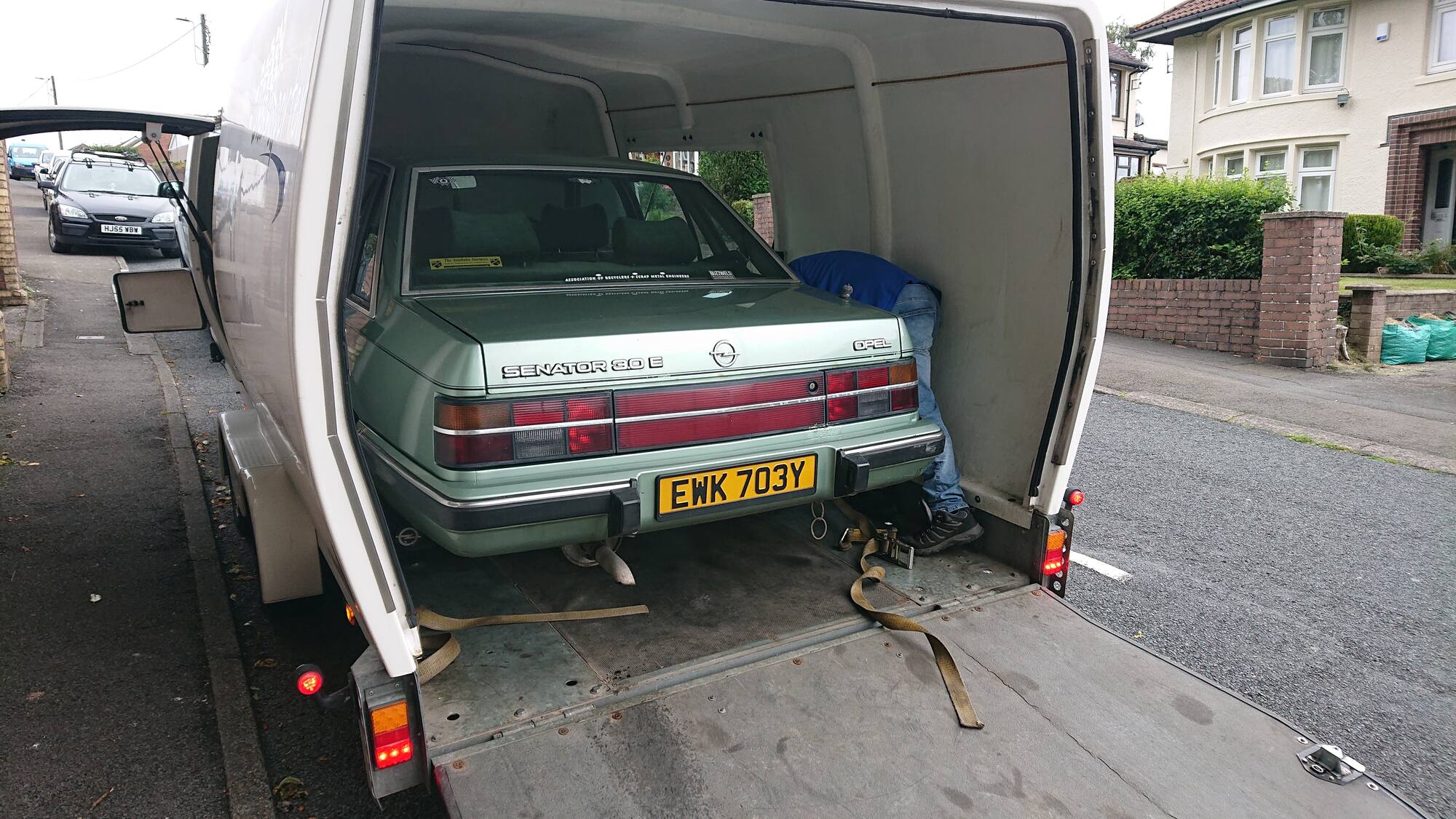

Royale80 Posted July 18, 2020 Author Posted July 18, 2020 Leaving for it's new home! Angrydicky, spartacus, theshadow and 2 others 3 2
