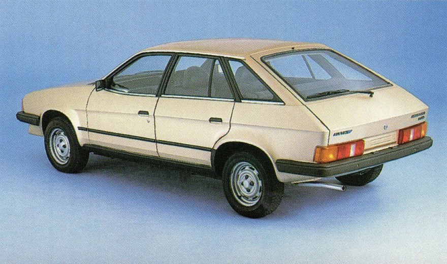

Station Posted February 12, 2017 Posted February 12, 2017 Must have been a HL, there was never a 2.0 L (although you could have a 1.7L auto if you were a masochist).Late 2.0 HL models did have the twin carbs:0273/in/album-72157643328249664/https://www.flickr.com/photos/61090099@N04/1365219Ambassador HL Jan 84.jpg(Jan 1984 brochure)Wow they named the glovebox Alan! What does the ASU do? My dad had one in gold in the early 90s. It was comfy with the same interior. My mate used to say it looked like the Amiga A500 mouse, which it totally does.And I called it the Austin Ambarrassador. Negative Creep, timolloyd, Pillock and 4 others 7
