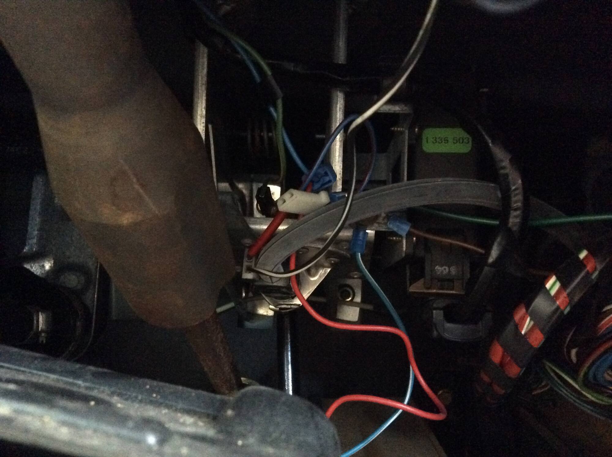

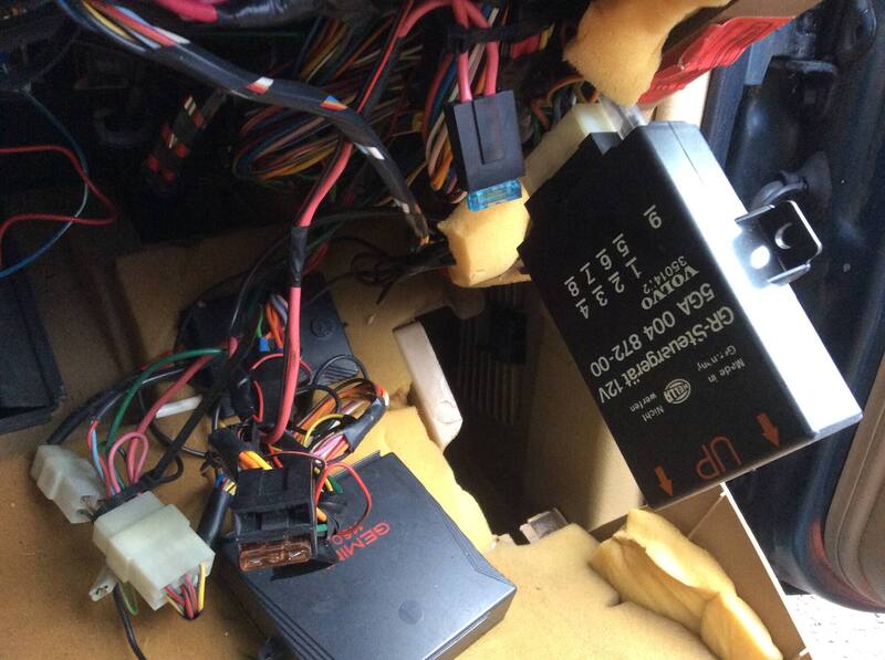

Here’s some more pics of the underside of the dash where the amplifier is supposed to be...
Someone on the VOC posted a pic of an amplifier and it’s location. There’s nothing here that looks like one or in the right place, no signs of the amplifier DIN cable either!
Unless I’m being blind!?
No amp I'd guess then given there isn't anything plugged into the amp-out socket on the head unit.

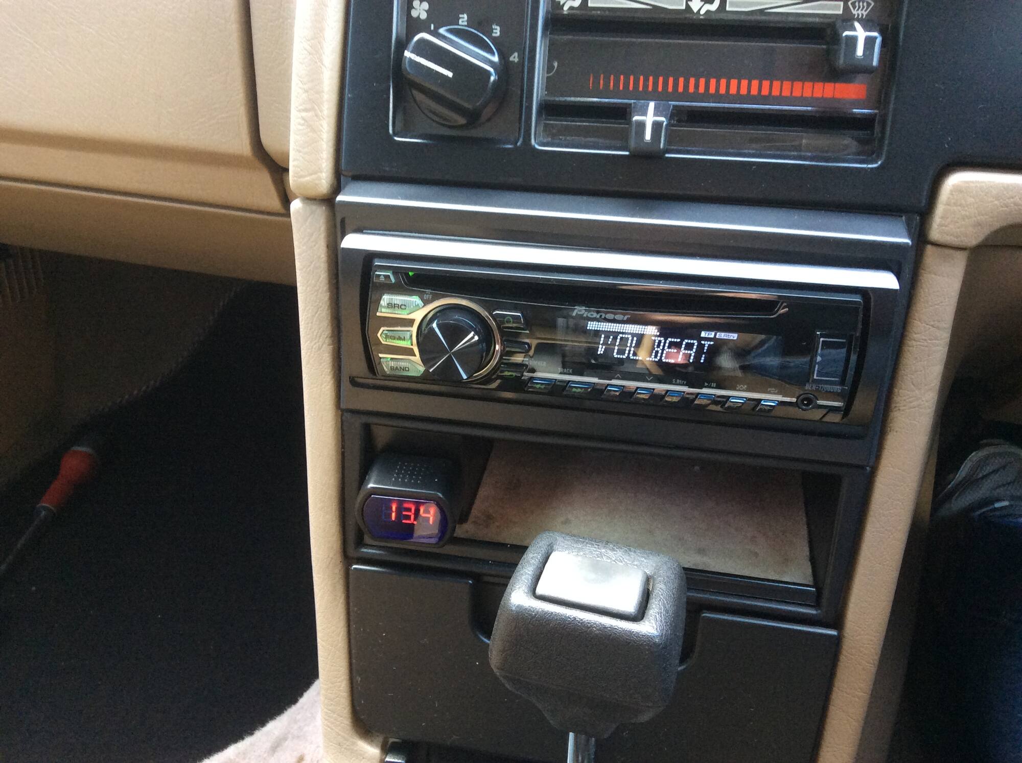

Haha! We have music!
Ive not touched this for a while due to waiting on parts to arrive and the utterly utterly FUCKING WANK weather we’ve had over the last 6 months... ok 6 months is a bit of an exaggeration but it feels like it! I just couldn’t face going outside in the pissing rain.
However, everything is now here, so I’ve started with sorting the radio out first just so I know if there’s something else not working or if it’s just the head unit.

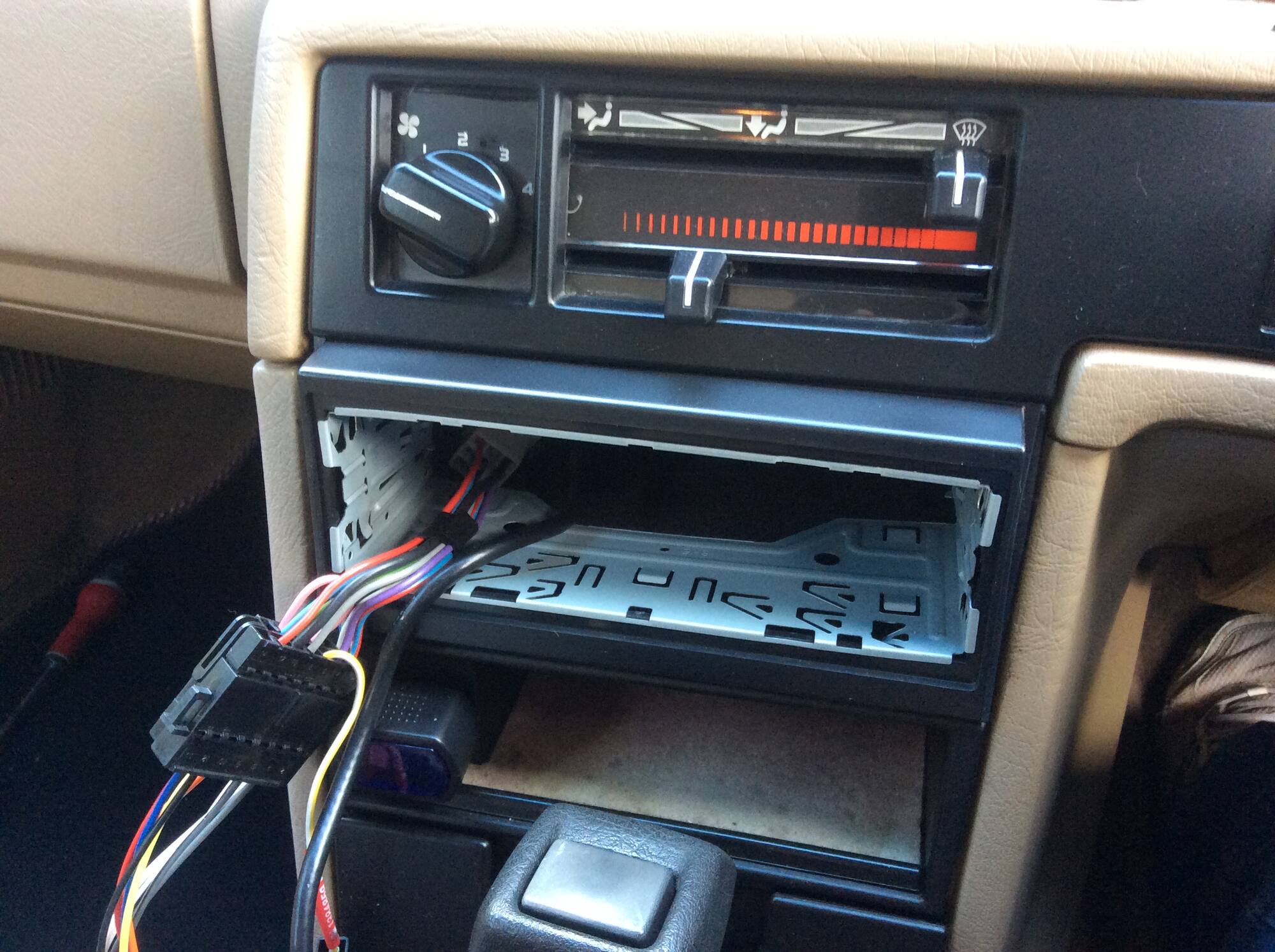

I bought two iso leads - both very similar but there was a slight variation in the pins in each of the plugs. I got both as you can guarantee if I only got one then it’d be wrong and I’d need the other!
Tried the first one which fit the cars loom multi plug. Then dug out a spare iso standard CD player head unit I already had and hooked it up... nothing! Not even any power! Ok...
Tried the second one which was a much shorter lead (good as there’s not much space behind the radio/centre console in this car! Connected up the radio and it powered on straight away! Connected up the aerial lead and it immediately picked up stations, seek works and everything plays well, the speakers seem to work perfectly. CD player also works fine and the electric aerial also works as it should still. Success! The fault must be with the original head unit.

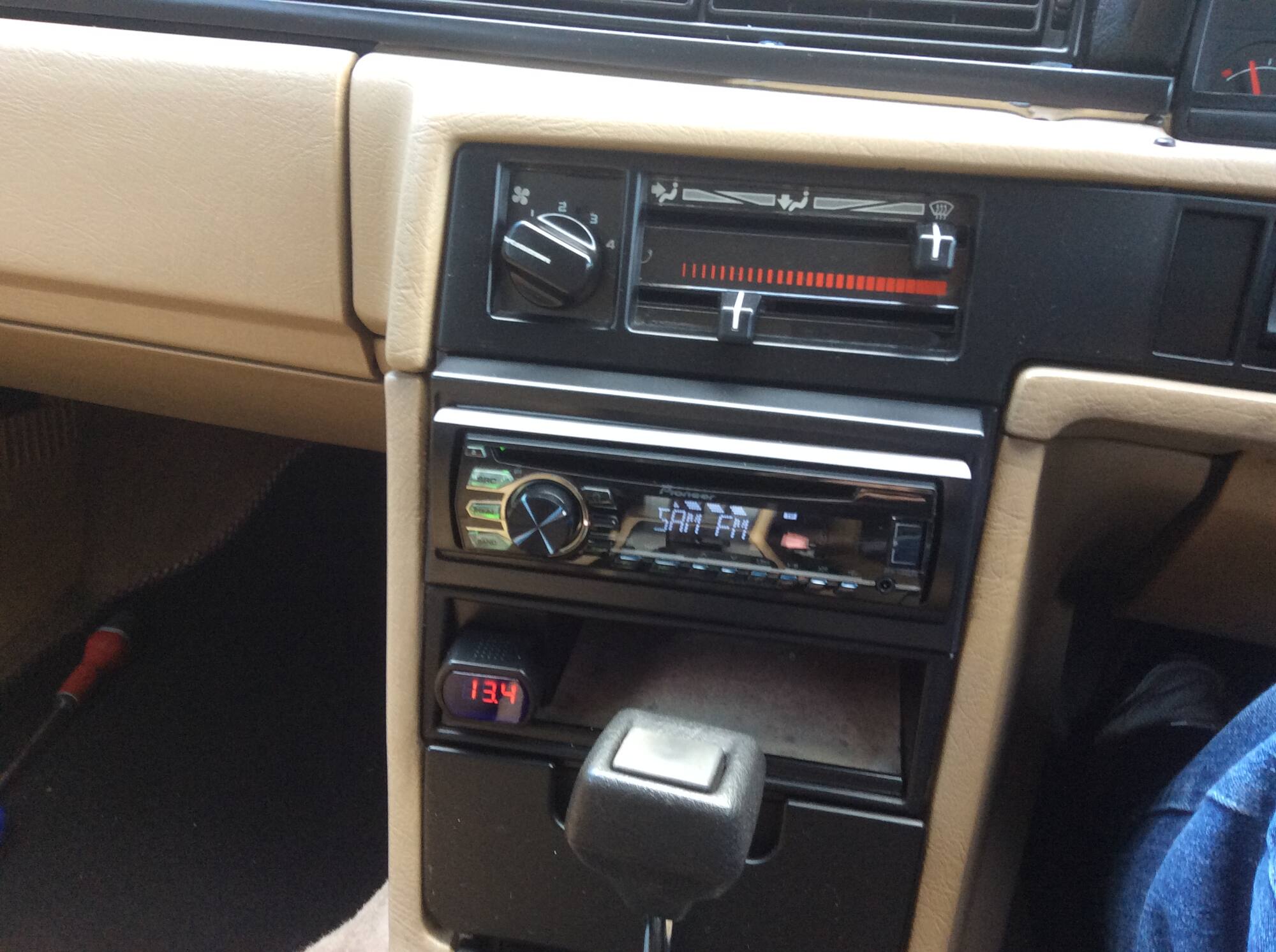

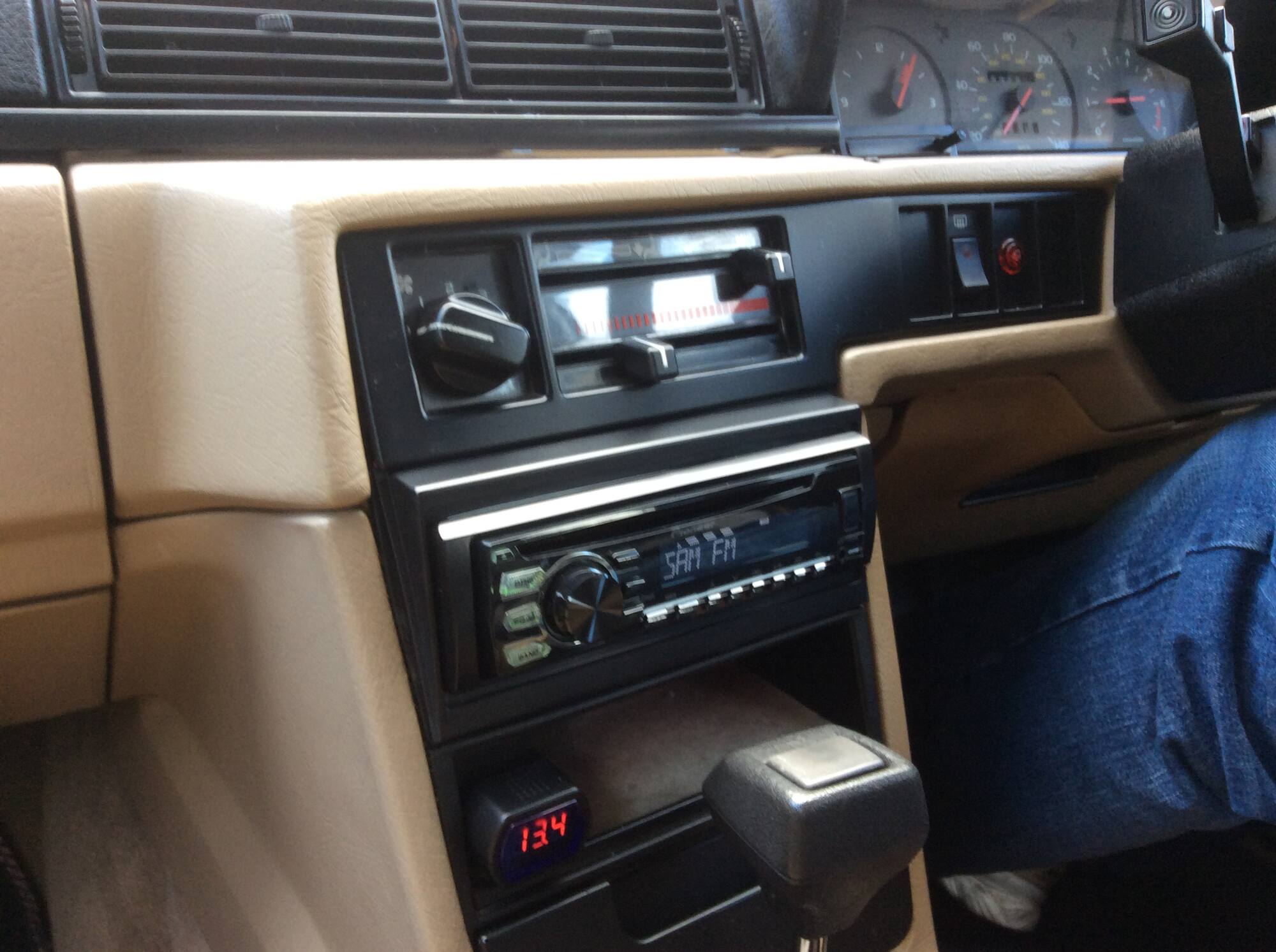

heres how it looks at the moment.
Radio on and picking up channels.
CD player on,
To get it to fit I had to get a dash facia adaptor. That fits fine and the radio security cage went in fine and the tabs bent over ok. The only downside is the cage edge is still very slightly visible at one end on top despite the radio itself having a front trim to hide this. The trim seems a bit loose though so I don’t think I can do much about that. I might pop the radio out and paint the edge of the cage black at some point to try and make it a bit less obvious.
I know it’s a modern head unit, which is something I wanted to avoid ideally but I don’t think it looks too bad tbh. On the plus side, it’s a CD player and it’s also got an AUX plug and can play from iPod etc too. And, most of all, it actually works! So I might leave it as is for now and see how I feel about it later. If it still bugs me I’ll just get an old radio/cassette off eBay or somewhere and fit that instead now I know everything works and can be plugged in ok. For now though, that’ll do!
Well played chap! That doesn't look too out of place and having aux in capability will be nice.
