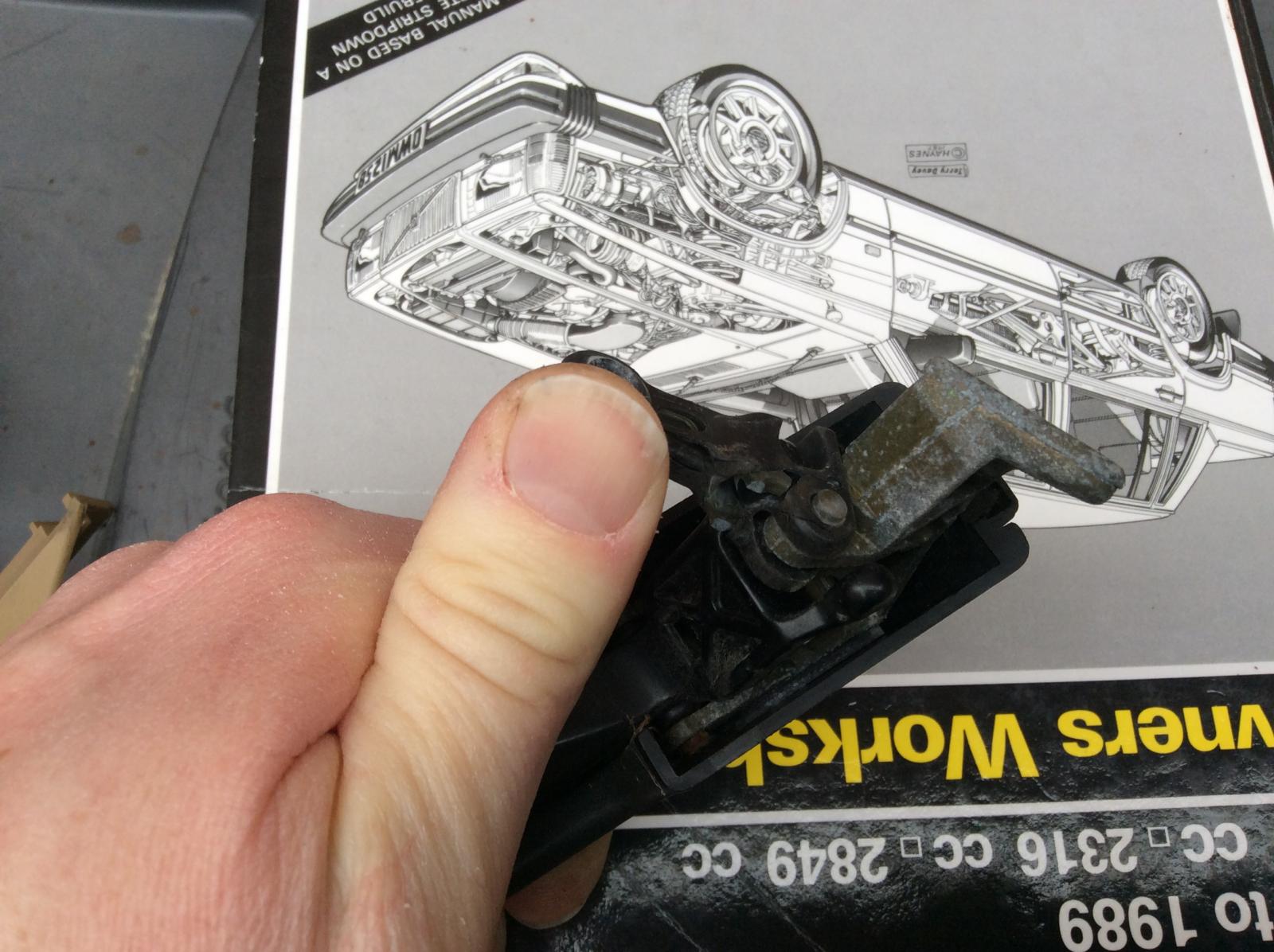

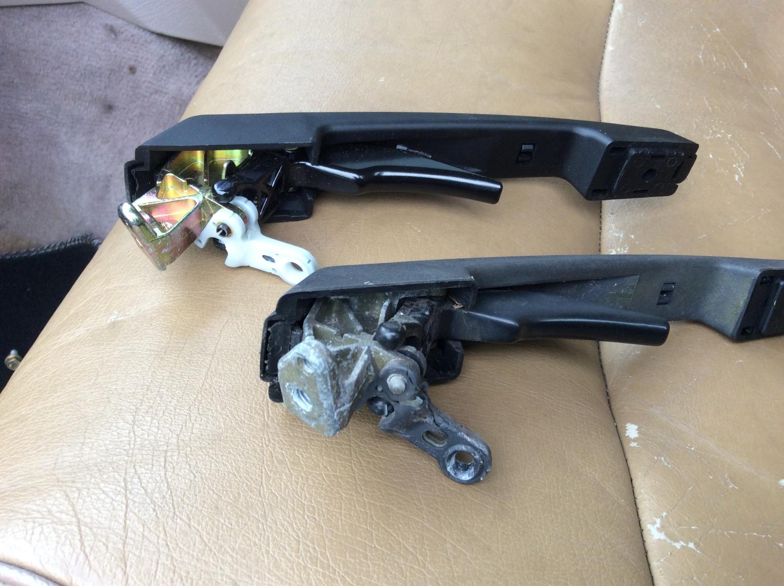

The handle has always been a bit sticky but more recently it’s been a real bitch to actually open. You have to pull the handle really hard and jolt the door to get it to open.
These cars seem to suffer a bit from this issue, my old saloon did it and I’ve fixed another estate one years ago in the garage.
The outside handle mechanism has a little arm that lifts the latch rod up or down inside the door, with old age this arm can start to bend and eventually snaps off. Mine has got to the stage of bending since the door will sometimes open.
The new handle was a new non original Swedish made replacement, £15 off eBay.

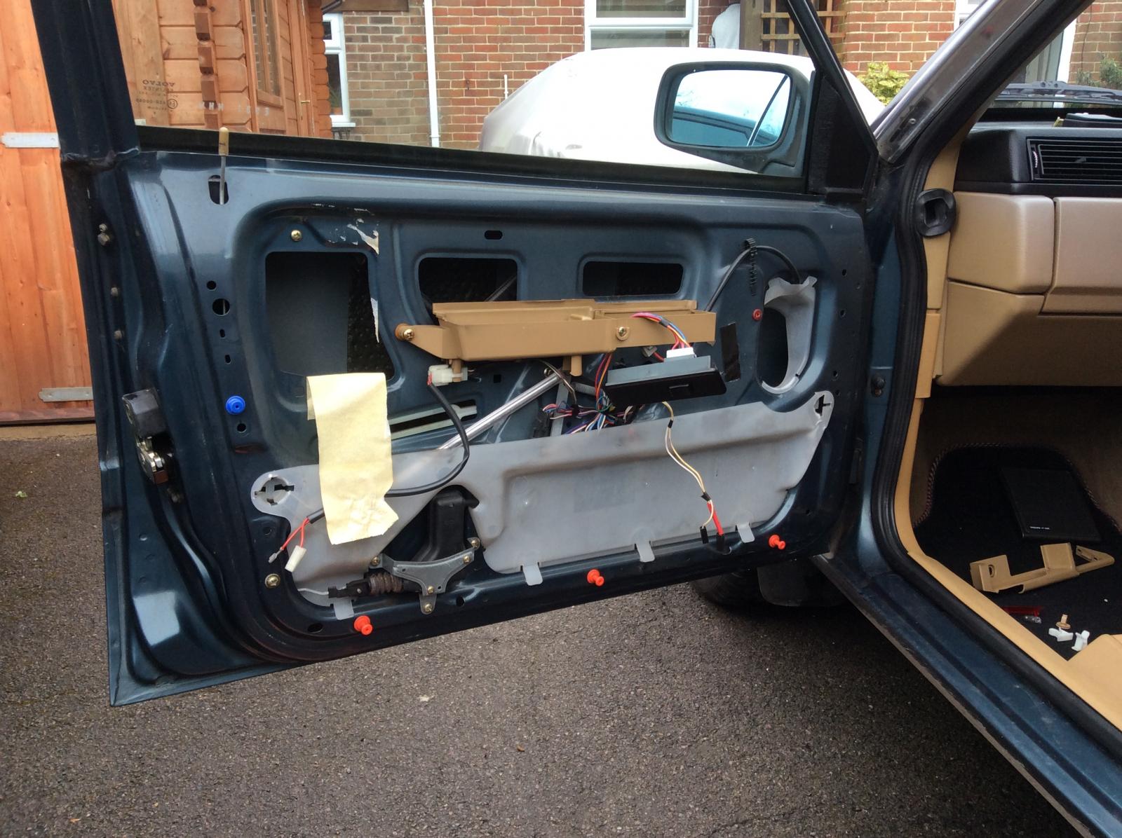

First job was to strip the door interior trim off.

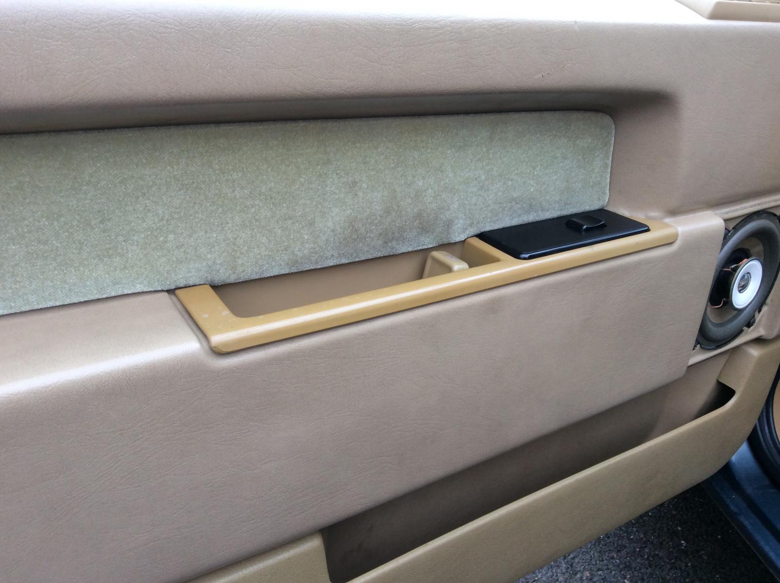

Note the broken trim for around the door handle! Good a time as any to replace this for the good ones I got from America.
Next was to remove the outside handle. Simple, one 10mm bolt inside the door, one in the end of the door shut area and a screw just above it. Then twist the handle to slide it off the latch pin.
Old and new side by side and you can see the damaged arm on the old handle.
While everything was in bits I’ve cleaned around the holes in the door under the handle, re greased the window mechanism and handle mechanism, cleaned out the dirt and crud from the inside of the door bottom then given that a good coat of Dynax S50 cavity wax to keep corrosion at bay. There’s non whatsoever yet but I figured it was a good idea to try keeping it like that!
Plenty of wax all over the door bottom, I’ve payed particular attention to the bottom corners. Future proofing!
Next was reassembly. This is where it gets awkward as the new handle has to go back in through the holes at an angle while trying to force the latch pin back through the hole in the handle. It’s incredibly tight but it will go. Eventually! You’ve just got to be careful you don’t break or bend the new part doing it or scratch your paintwork.
Tested and working perfectly. I went a bit over the top again with this by packing grease into all the moving parts of the new handle just to stop wear or corrosion and I’ve also greased the retaining bolts threads to prevent seizure.

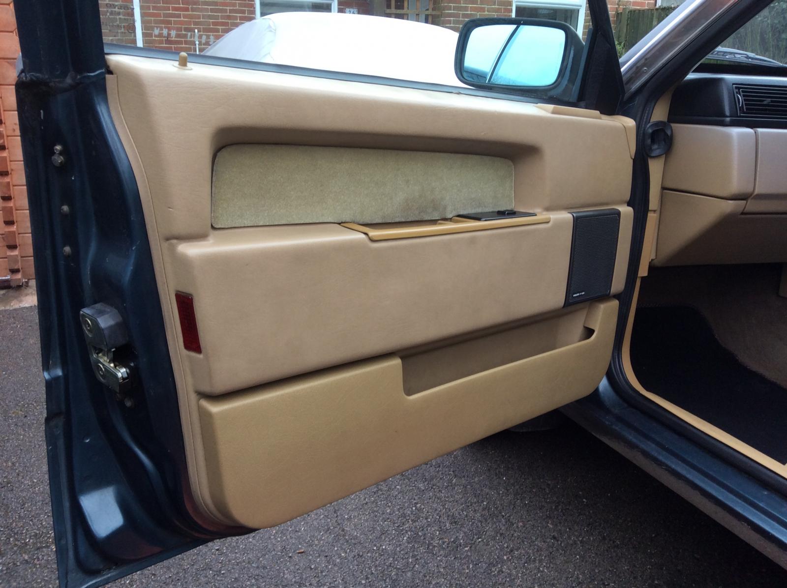

Then build up the door interior trim.
The new US sourced trim looks a million times better than that broken old part. They’re incredibly brittle though so need care when refitting.
Here’s another pic of the old handle with the arm being forced down to show how they fail.

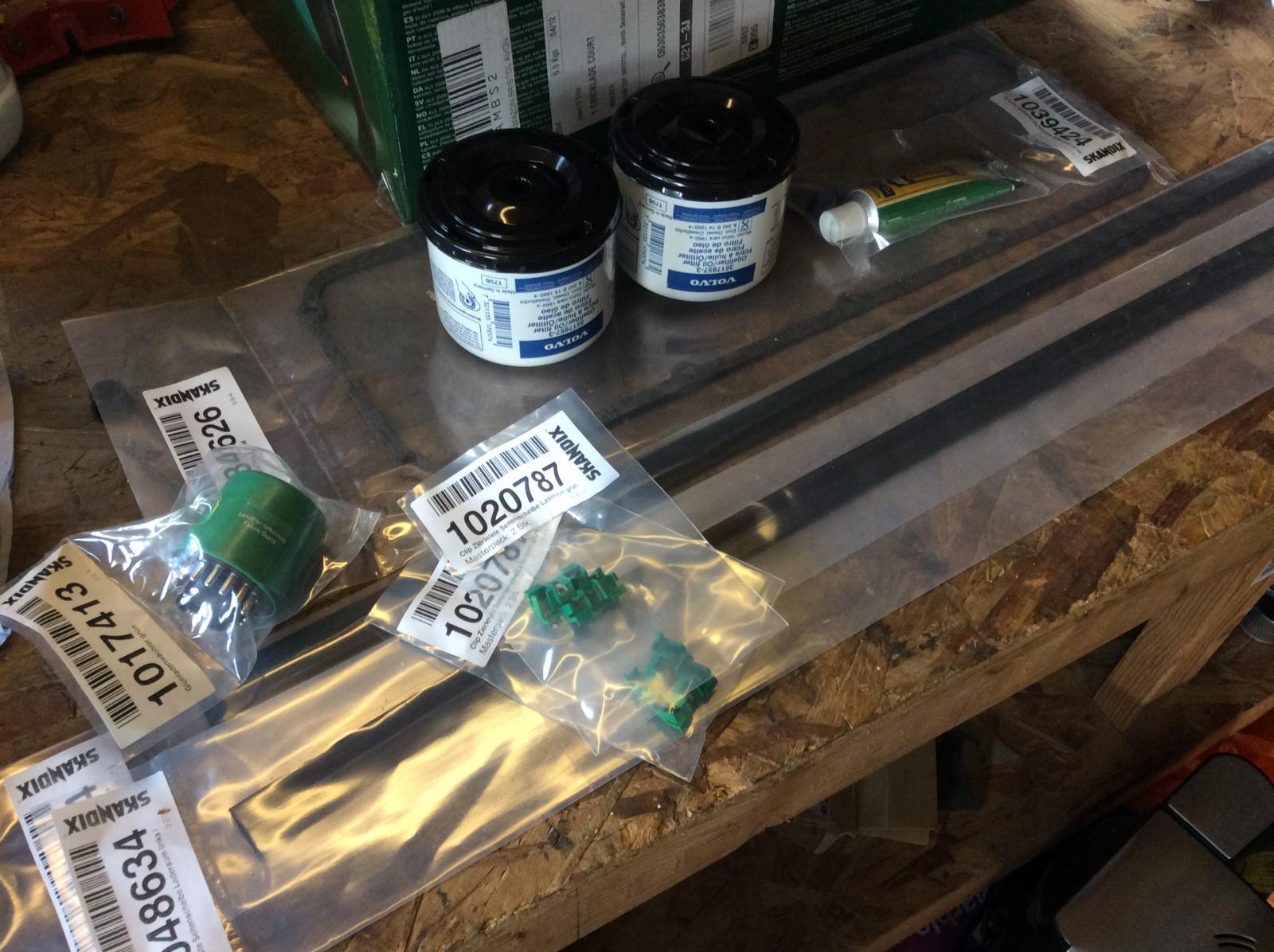

Just had a parts drop from Germania.
New lamp fail relay, rocker cover gasket, pair new estate window rubbers with new clips and glue, and a couple of genuine oil filters while I was at it!
Should give me something to do.
The lamp fail relay I’ll keep in the car as a backup. Since the MOT and resulting bulb fail warning light issue I’ve resoldered a connection inside the old lamp fail relay which so far appears to have cured the problem. Weather it’ll remain working or another part of it will fail I don’t know but at least I have a brand new replacement if I need it.
Next job will be to replace the estate window rubbers. Both are a bit tired and one has the end curling up where the glue has failed. The wind gets under it and peels it away when driving now which annoys me. They look pretty simple to do...

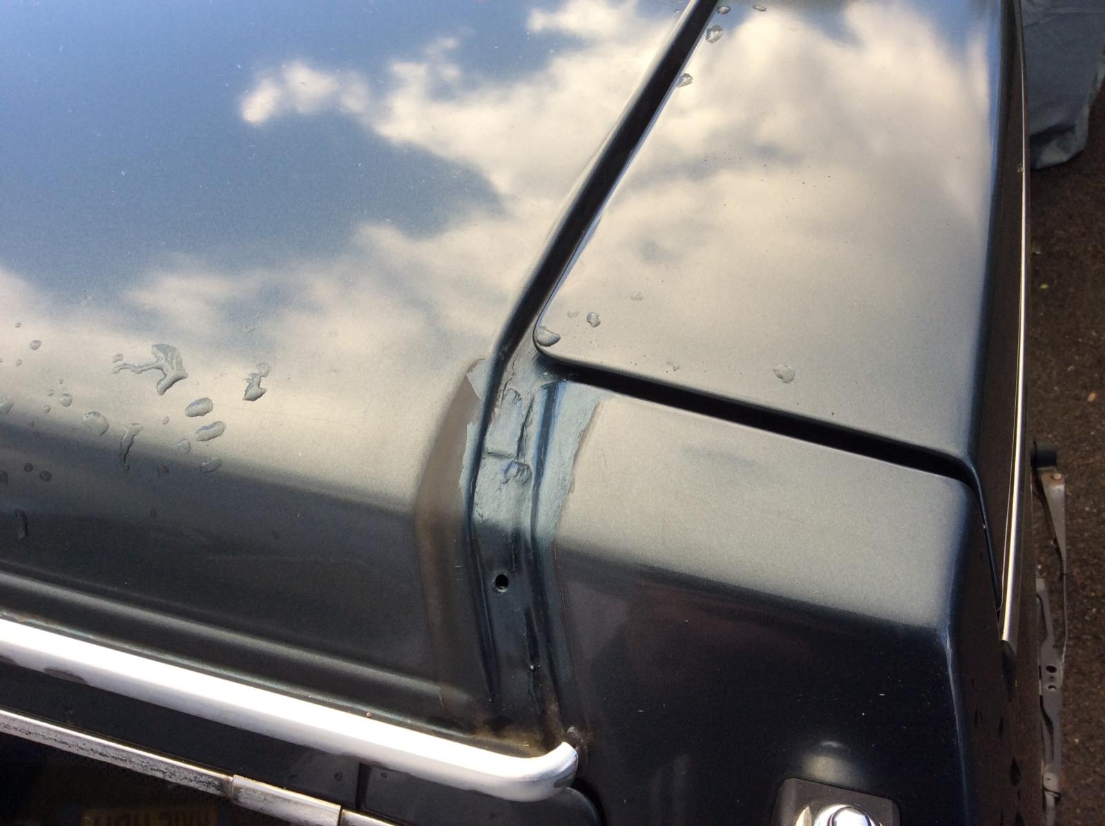

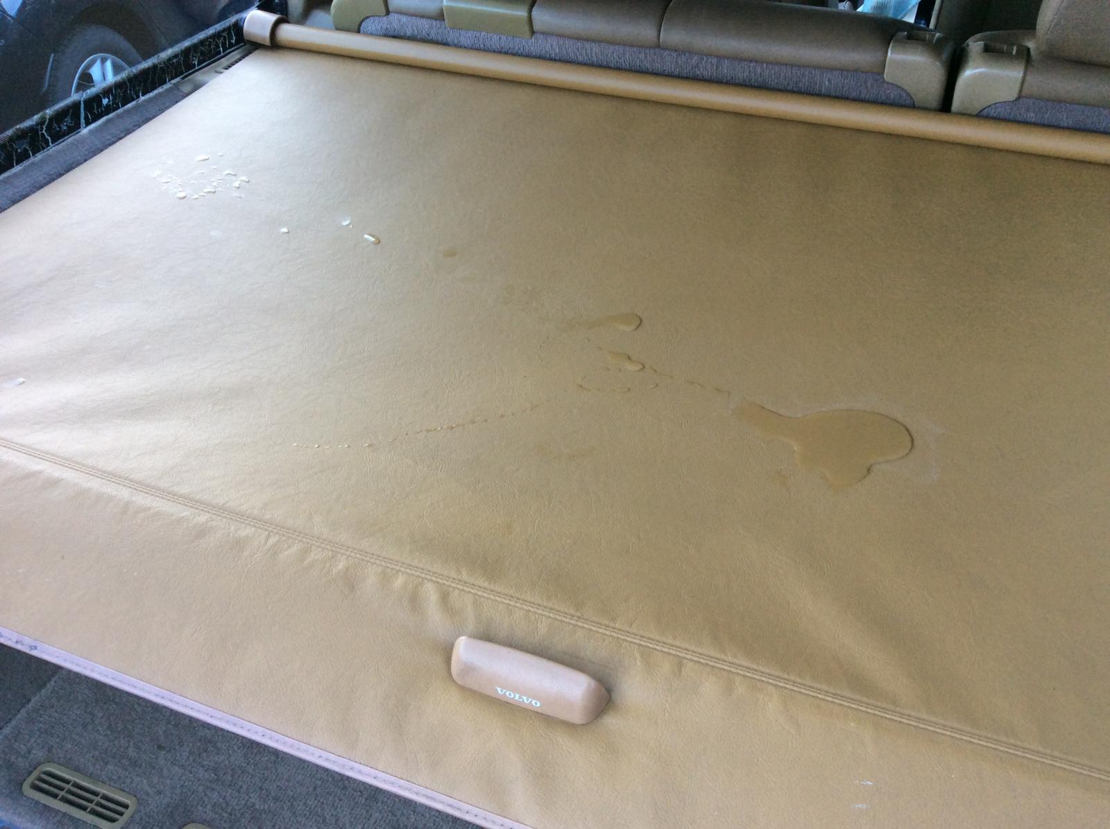

I walked past the car yesterday and noticed this on the load area cover.
Fucking water!

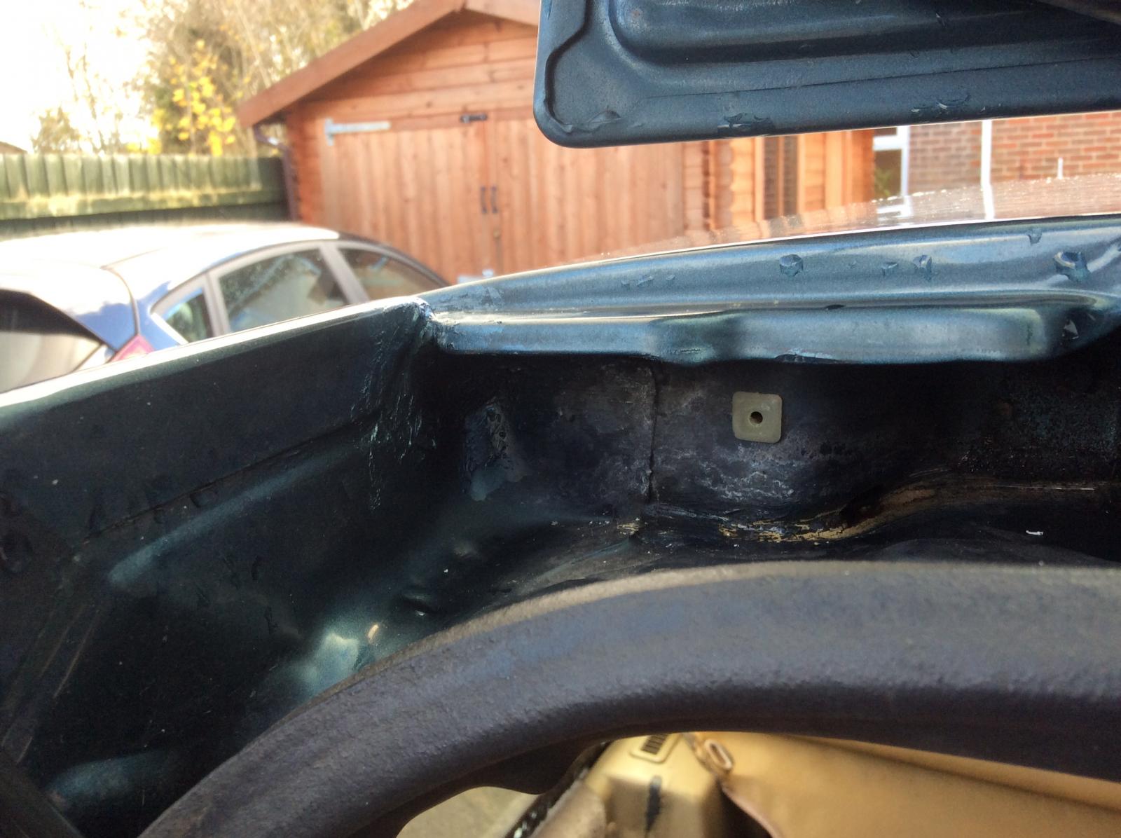

It’s been pissing down a lot recently and it’s getting in somewhere around the boot area. Further investigation revealed a tiny drip about halfway along the load area side window coming from under the plastic trim along the roof inside.
There’s nothing there that can possibly leak so the water must be getting in somewhere at the tailgate and running along behind the plastic trim before dripping down onto the load area cover.
So YET AGAIN I’ve got to remove the old very brittle plastic interior trims!
I hate doing this as there’s a very real prospect of breaking or shattering them taking it all down.

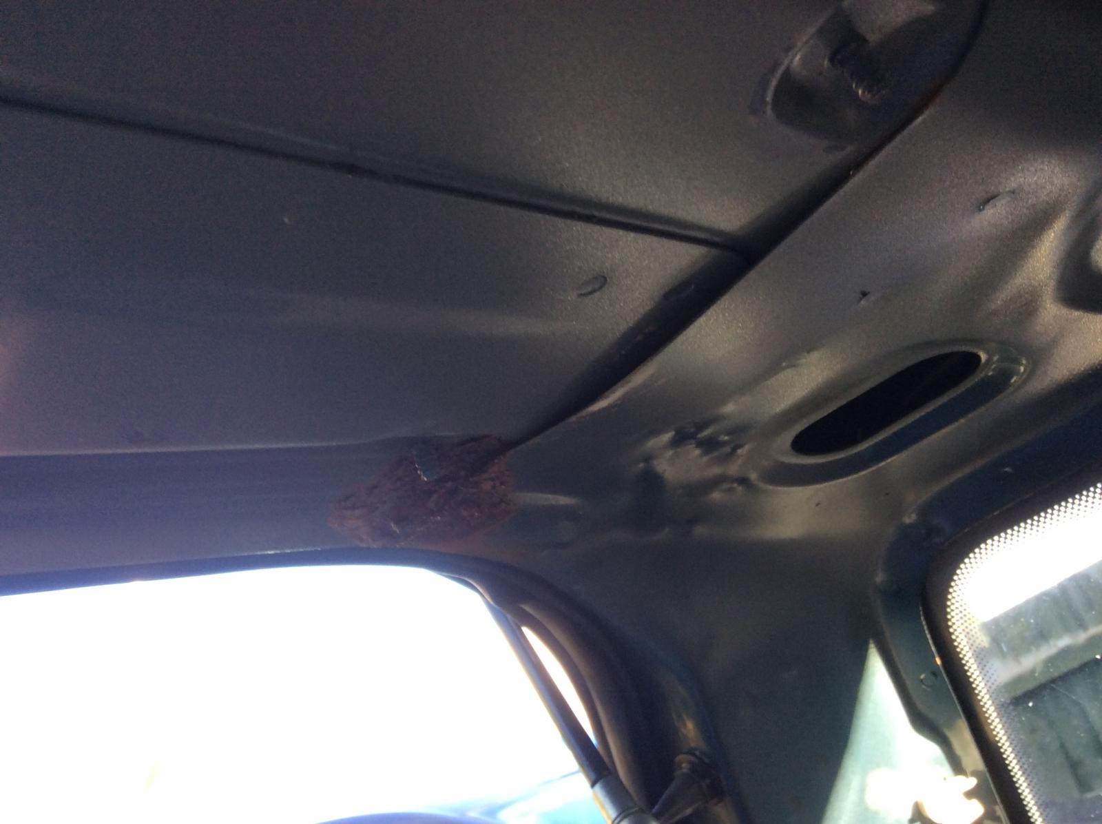

So, I’ve removed the side trim and the one above the tailgate opening which showed a rusty mark and rusty water staining on the inside of the roof above the tailgate opening.
It’s not gone through and there’s no sign of it whatsoever from outside the car in the tailgate shut area either so it’s not that that’s causing the leak but this is clearly where the water has been gathering before dripping down elsewhere.
I’ve tried sitting inside the boot with a torch and having someone else pour water over the car in this area while I look for leaks which didn’t show much either. It must be a very slow leak.
After much poking around and looking inside the framework inside the roof panels I can see a water mark running down from the very top corner of the boot/roof. On the outside of the car in this area are plastic trims which cover the panel join between roof skin and rear pillar...

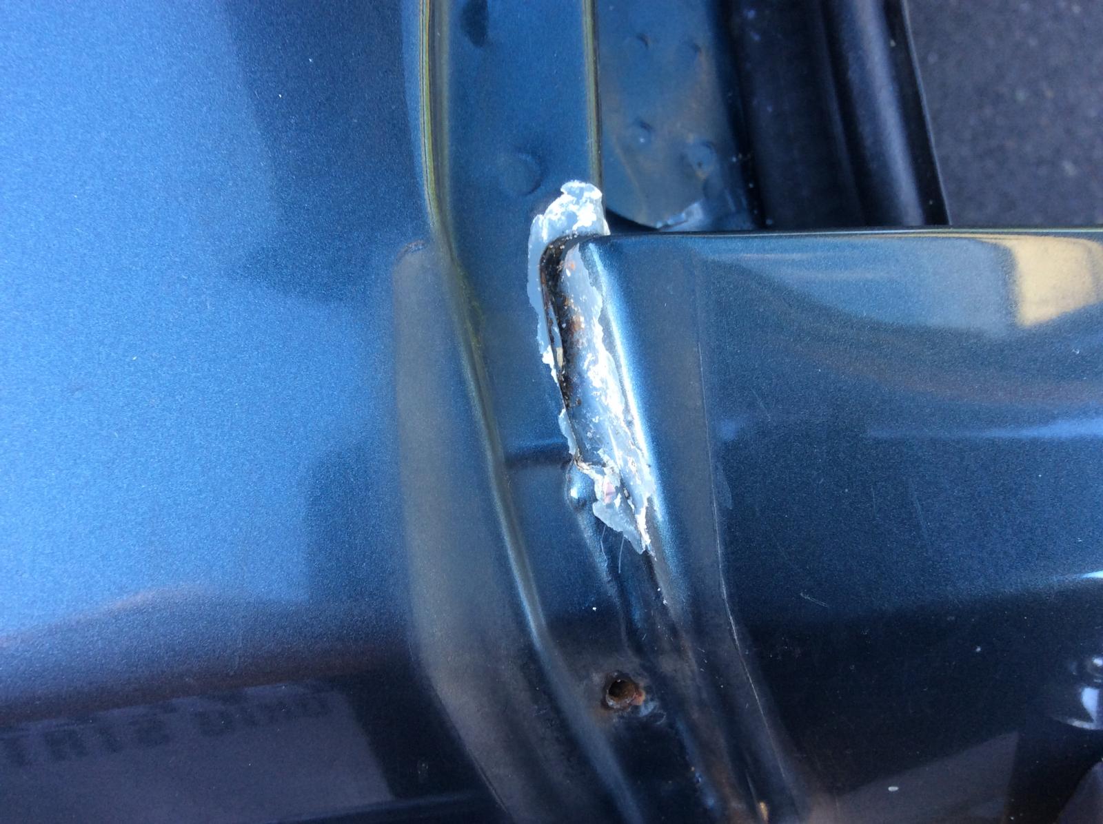

Took the plastic trim off and all I’ve found is a line of seam sealer at the join. This has gone extremely hard and started splitting which I think is where the water is getting in. This bit is where the water from the roof is directed into the gutters or down the tailgate shut area drains so can become quite wet!
Here it is after scraping the shitty old seam sealer out.
I’ve cleaned it all up and applied a bead of new sealer, forcing it into the seam and smoothing it off. You can’t see this anyway once the plastic trim is back on but once it’s dry I’ll paint it body colour. The leak was only on one side but I’ve also done the same thing to the other side (which was also cracking and probably wasn’t far off leaking itself). I’ve also repainted the two plastic trims as they looked a mess.
Once everything is dry I’ll reassemble and see what happens. Typically it’s just started pissing down again!
Rains stopped and it’s sunny again. Seam sealer has gone hard so I’ve painted it body colour. I’ve got a tin of the right colour paint so just painted it on with a modelling brush. It’s under the plastic trim anyway so you’ll never see it.
While that goes off I’ve sprayed the inside cavities of the rear roof section of the car with Dynax S50 cavity wax. Thought I might aswell since everything is in bits and it should help protect things inside. I’ve done this everywhere else as I’ve worked my way around the car.
Also aerosol painted the plastic trims for the rear roof/gutters. They looked absolutely shit before tbh, peeling paint and bare plastic showing through so I’ve rubbed them down, cleaned them up and sprayed them, primer, two coats of green-blue metallic and a coat of clear lacquer. Once that’s gone off (currently sat in front of a heater!) they can go back on with two new screws I found in my tool box to replace the rusty old ones.
The rusty blob inside the roof has also been wire brushed down and given a coat of rust converter.
Just starting to get dark now but I’ve reassembled the interior and refitted the newly painted plastic trims to the roof. I’ve sealed the retaining screws too by dipping the threads in the tin of seam sealer then winding them in which should rule that out too.
Looks much better now but I’ll just have to wait until it rains again before I’ll know if this has fixed the leak, which I’m sure will be soon. Fingers crossed!

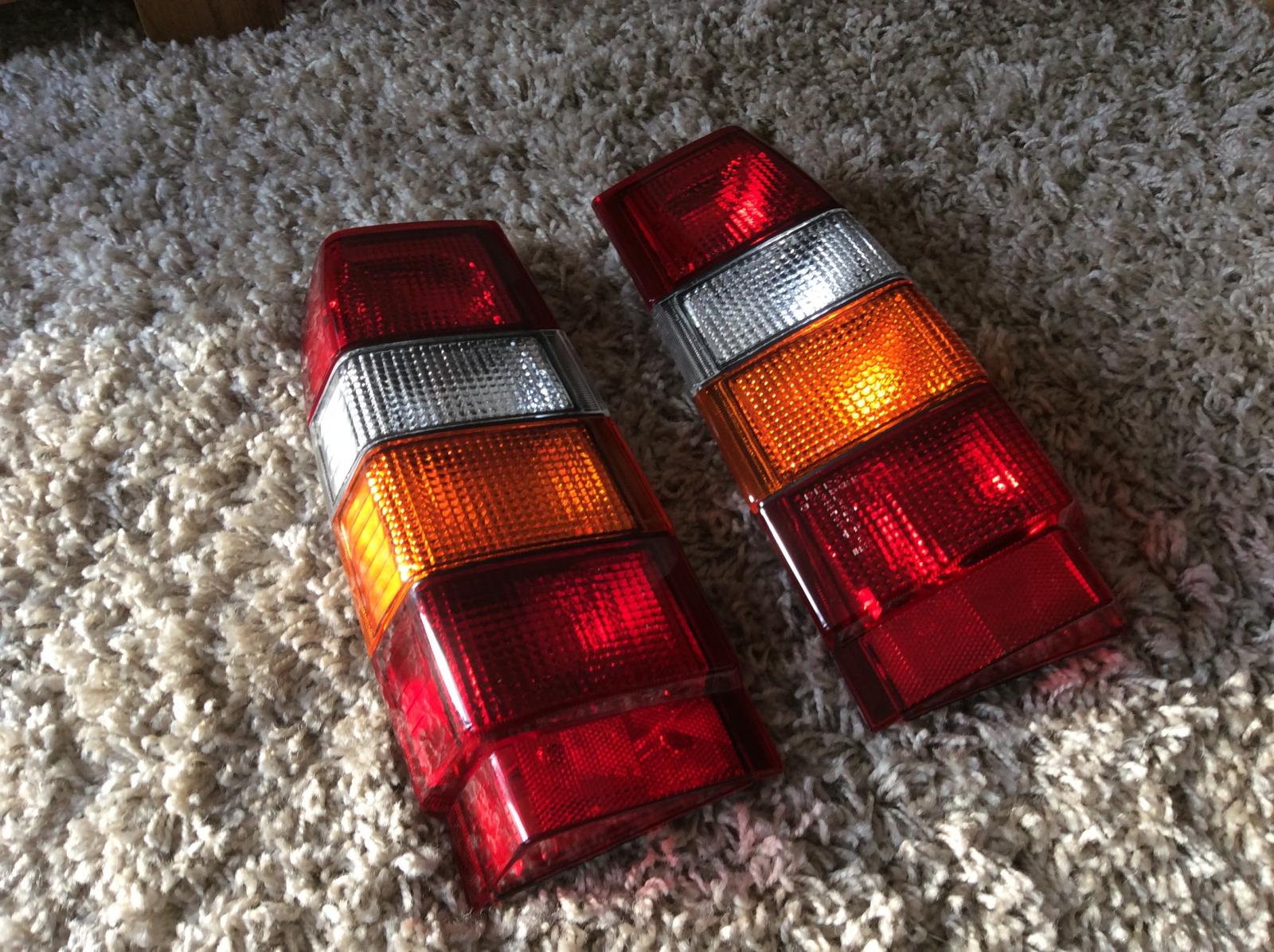

Got the Volvo it’s Xmas pressie today!
Nice brand new pair of tail lights.
There’s not much actually wrong with the old two but there’s a few faint age related cracks and crazing on them and they just look a bit grubby and old. One of them could do with a new seal too so I thought sod it!

Are those the Depo replacement clusters?
I found them to be a good quality lens and a good fit - both my 740 and 850 have had replacement lenses from them. I'd recommend a bit of silicone around the tops of them to prevent water ingress.
