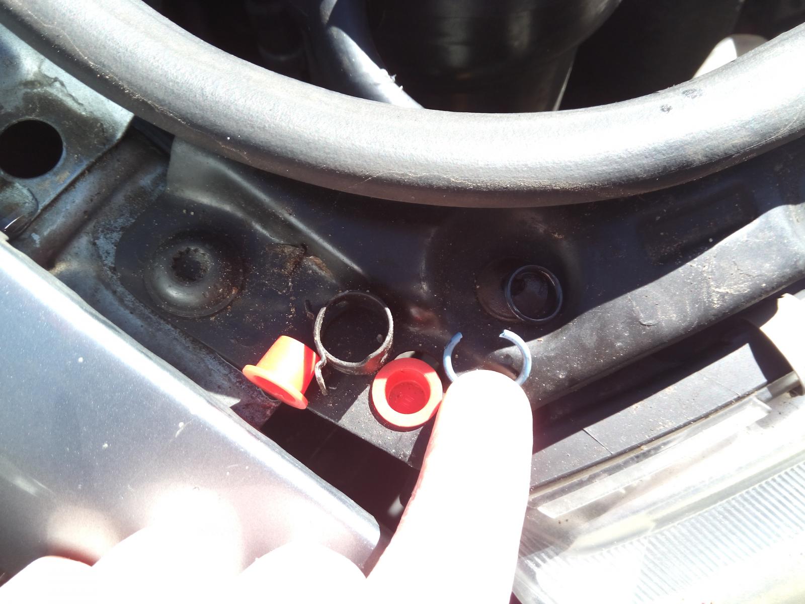

320touring Posted March 8, 2017 Author Posted March 8, 2017 At 8.35 this morning: Started straight off the key, then died after 15 seconds. 2nd time I gave it a rev and waited 20secs. Ran fine thereafter. Although I *think* it feels a bit sluggish uphill. Filter change may be a cheap option once back home. I code read it too- no codes logged
twosmoke300 Posted March 8, 2017 Posted March 8, 2017 Egr stuck partially open?Cam sensor playing up again?
320touring Posted March 8, 2017 Author Posted March 8, 2017 Have a video of what its doing.. It kinda sounds to me like either a fuelling issue or a sensor fault?
320touring Posted March 8, 2017 Author Posted March 8, 2017 Shared this with a tame mechanic mate - initial suspicion Is fuel filter - will blag one from hellfrauds and fit it asap. Worth it as a punt, and to rule it out.

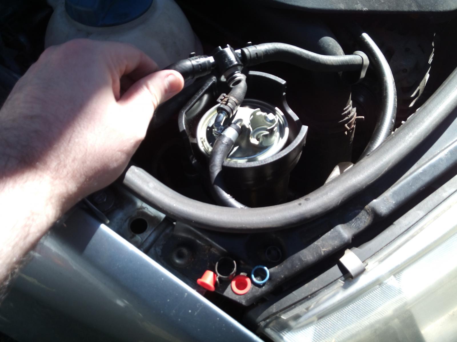

320touring Posted March 9, 2017 Author Posted March 9, 2017 Got round to fitting a fuel filter to this today.. Couldn't get the actual filter, so dun a bastardisation;) https://fuguttycars.wordpress.com/2017/03/09/patience-is-a-virtue/ dome, Lacquer Peel and LessThanEqual 3
320touring Posted March 9, 2017 Author Posted March 9, 2017 Top job, though isn't the PD self priming?Not as far as I'm aware? Didn't want to stress the starter anyways!
twosmoke300 Posted March 10, 2017 Posted March 10, 2017 Leccy in tank pump - turn the ign on for 3 secs til pump stops - turn ign off and back on again for 3 secs - repeat about 10 times and she's bled 320touring 1
twosmoke300 Posted March 10, 2017 Posted March 10, 2017 Oh and why not fit the right filter . ? Iirc they have a temp regulated return valve on the top of them . Common as muck filter
320touring Posted March 10, 2017 Author Posted March 10, 2017 Leccy in tank pump - turn the ign on for 3 secs til pump stops - turn ign off and back on again for 3 secs - repeat about 10 times and she's bledGreat to know:) Oh and why not fit the right filter . ? Iirc they have a temp regulated return valve on the top of them . Common as muck filterBecause I couldn't get it in time - I needed the car today, so had to sort it last night.That's kinds the point of my blog post, being patient to get the filter would mean I'd only have to do it the once. I'll change it over when I get the chance:) deffo only a temporary* fix

320touring Posted March 25, 2017 Author Posted March 25, 2017 In an astonishing turn of events, I changed the fuel filter seals (didn't do them when I did the filter as it was raining and I CBA:() It looks like the last person who did the filters never bothered either they were buggered! A quick self bleed (thanks to whoever let me know about that!) And she was back to starting reliably. Lesson learned- always do the seals! Bouyed by such success I felt it was worth giving her a wee pandering.. Hoover n tidy inside, plus a whole 3.99 worth of car washing! Suddenly it doesn't look so bad... CreepingJesus, stripped fred, CGSB and 2 others 5

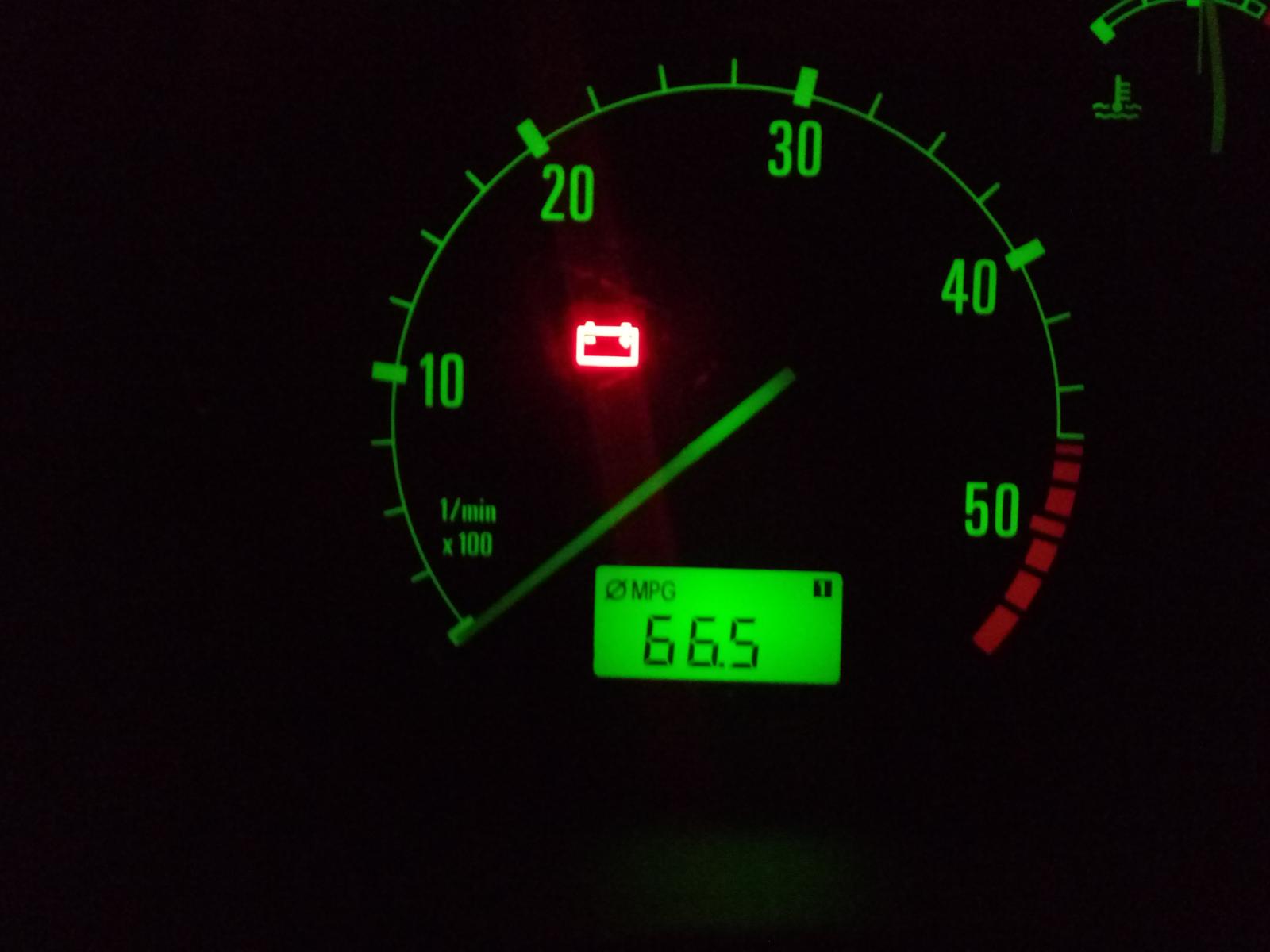

320touring Posted March 30, 2017 Author Posted March 30, 2017 I'm calling it fixed. 628miles on 43.63l of derv at £1.147/L means a healthy 65.44mpg.. Rapidly approaching crunch time though, could do with two tyres shortly, and decent ones would be circa £100 fitted. Dave_Q and The Moog 2
