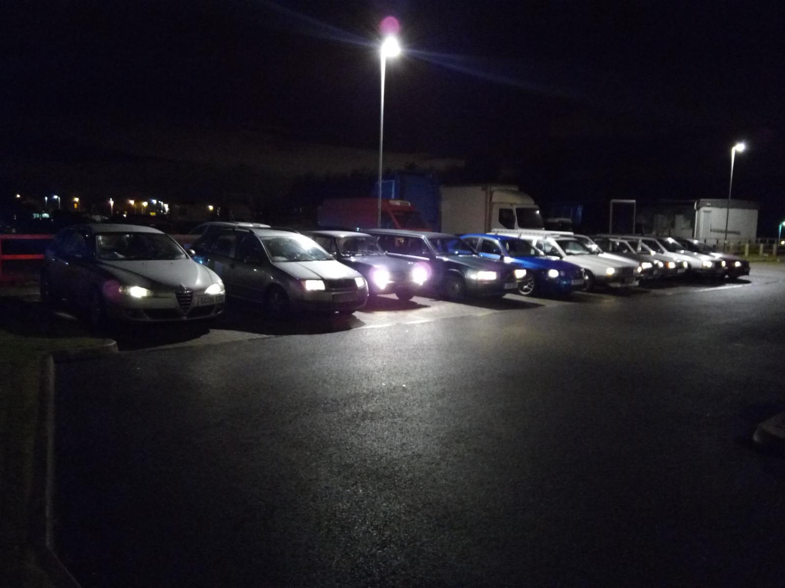

320touring Posted November 30, 2016 Author Posted November 30, 2016 This achieved its first Scotoshite tonight.. You can see it nestling next to Mr FPB7's Alfa of doom:)
320touring Posted December 1, 2016 Author Posted December 1, 2016 That's a good turnout !Aye you should come to the next one!

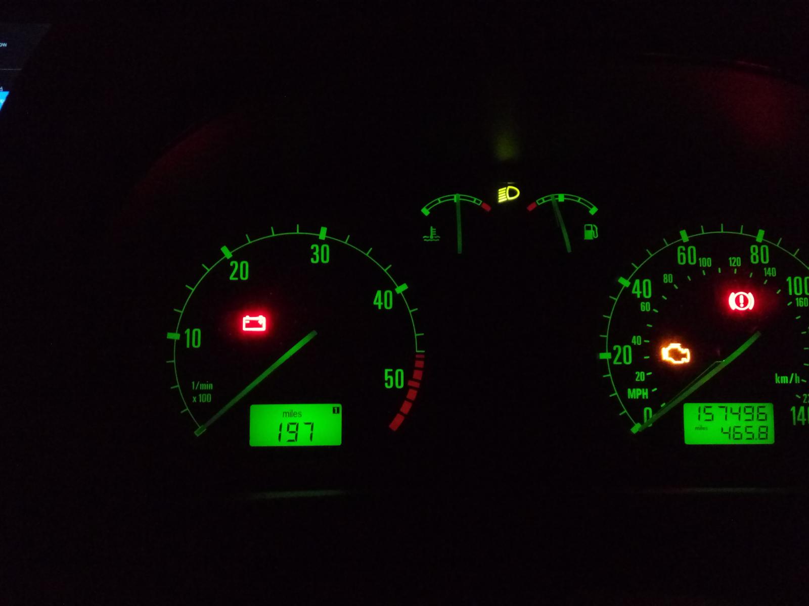

320touring Posted December 21, 2016 Author Posted December 21, 2016 Highs* and lows of a day in the new job.. High - Sunny St Helens Low - fabia throwing a CEL and flashing Glowplug light as I departed Birkenhead. High - as dictated by tradition or old charter or summink, TEBAY! Coprolalia 1

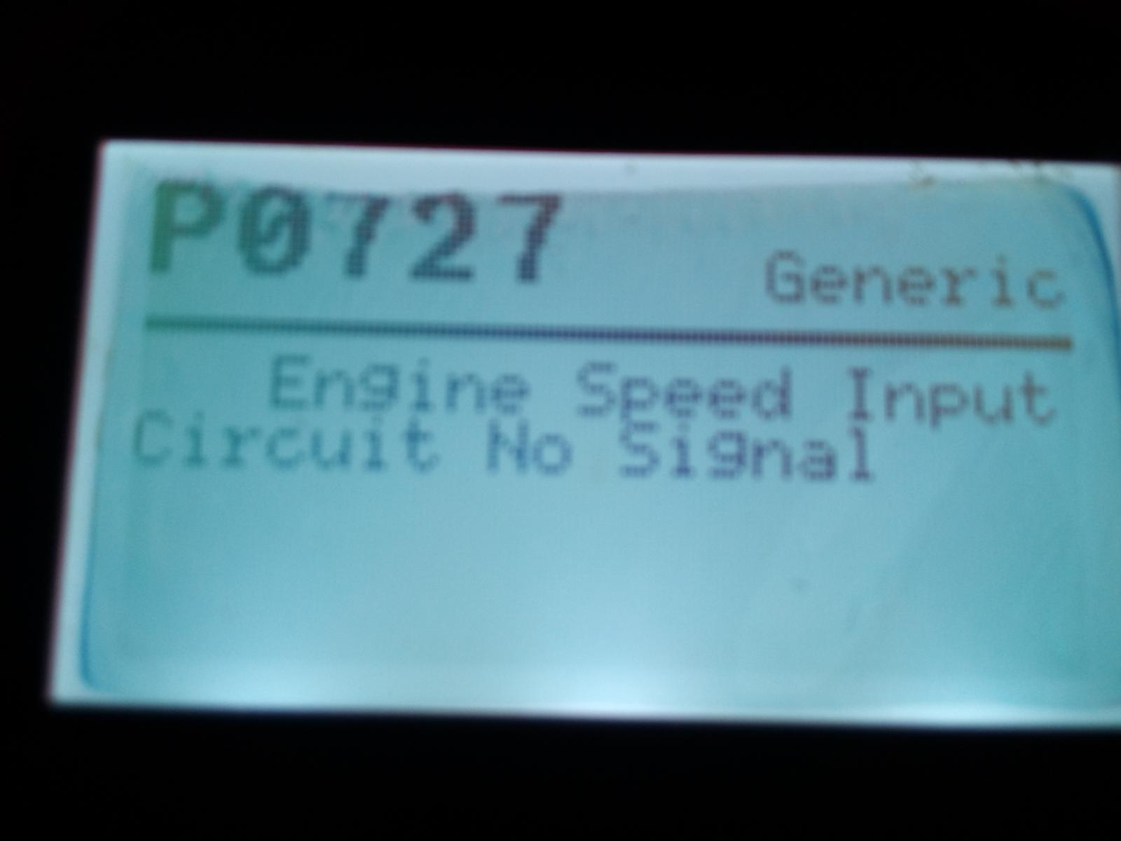

320touring Posted December 21, 2016 Author Posted December 21, 2016 Scrap it.I took a more measured approach and applied a dod of code reader when I got to Tebay. Looks like that fixed it til it happens again.. What do we reckon to it being a crank sensor? Lacquer Peel 1
twosmoke300 Posted December 21, 2016 Posted December 21, 2016 If it is just be thankful its not the later 2.0 tdi with the sensor that is part of the rear main oil seal housing . Gearbox out and new slave cyl just to change crank sensor ! Awesome Dick Cheeseburger, Lacquer Peel and 320touring 3
320touring Posted December 21, 2016 Author Posted December 21, 2016 If it is just be thankful its not the later 2.0 tdi with the sensor that is part of the rear main oil seal housing . Gearbox out and new slave cyl just to change crank sensor ! AwesomeAmen to that! Just topped her off fuel wise there. 503.5 miles on 36.57L means 62.59mpgs M'coli 1

bigfella2 Posted December 21, 2016 Posted December 21, 2016 If it is just be thankful its not the later 2.0 tdi with the sensor that is part of the rear main oil seal housing . Gearbox out and new slave cyl just to change crank sensor ! AwesomeSome of the later 1.9's have the same arrangement too, my 2k caddy has. Dont forget you need the expensive tool to change it too, or timing will be out and piss out oil too. Regarding the daft fuel gauge, chances are it's got an Ibiza sender in it, as fabia, polo and Ibiza are fundamentally same car, fabia and polo read empty to left, while Ibiza reads empty to right, noticed while driving swmbo Ibiza tonight.
320touring Posted December 21, 2016 Author Posted December 21, 2016 Some of the later 1.9's have the same arrangement too, my 2k caddy has. Dont forget you need the expensive tool to change it too, or timing will be out and piss out oil too. Regarding the daft fuel gauge, chances are it's got an Ibiza sender in it, as fabia, polo and Ibiza are fundamentally same car, fabia and polo read empty to left, while Ibiza reads empty to right, noticed while driving swmbo Ibiza tonight.That'd answer it re the sender. Luckily she's back on the original pump so that's not an issue now:)

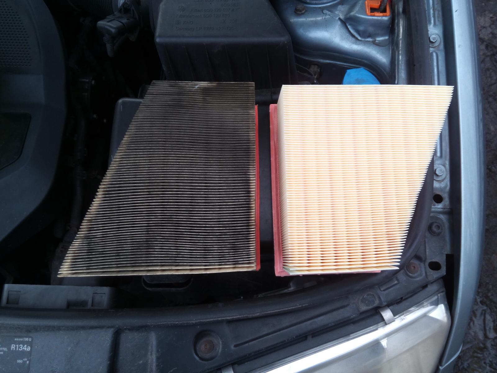

320touring Posted February 4, 2017 Author Posted February 4, 2017 Times for some updates on this.. To date she's done 3791 miles in my custody. Total spend to date has been a set of wipers (£11.50)An air filter (£5.98)Fuel - 289.28L totalling (£338)Purchase at (£400) £755.48 Or 19.9p per mile. Not too shabby at all. Last tank was a whopping 63.99mpg, so I actually fitted the air filter! The Moog, scdan4, Sigmund Fraud and 3 others 6
320touring Posted February 4, 2017 Author Posted February 4, 2017 That may have needed changingIndeed. I even haz Teh posh oil and a decent oil filter to make it have loobrikashunz
