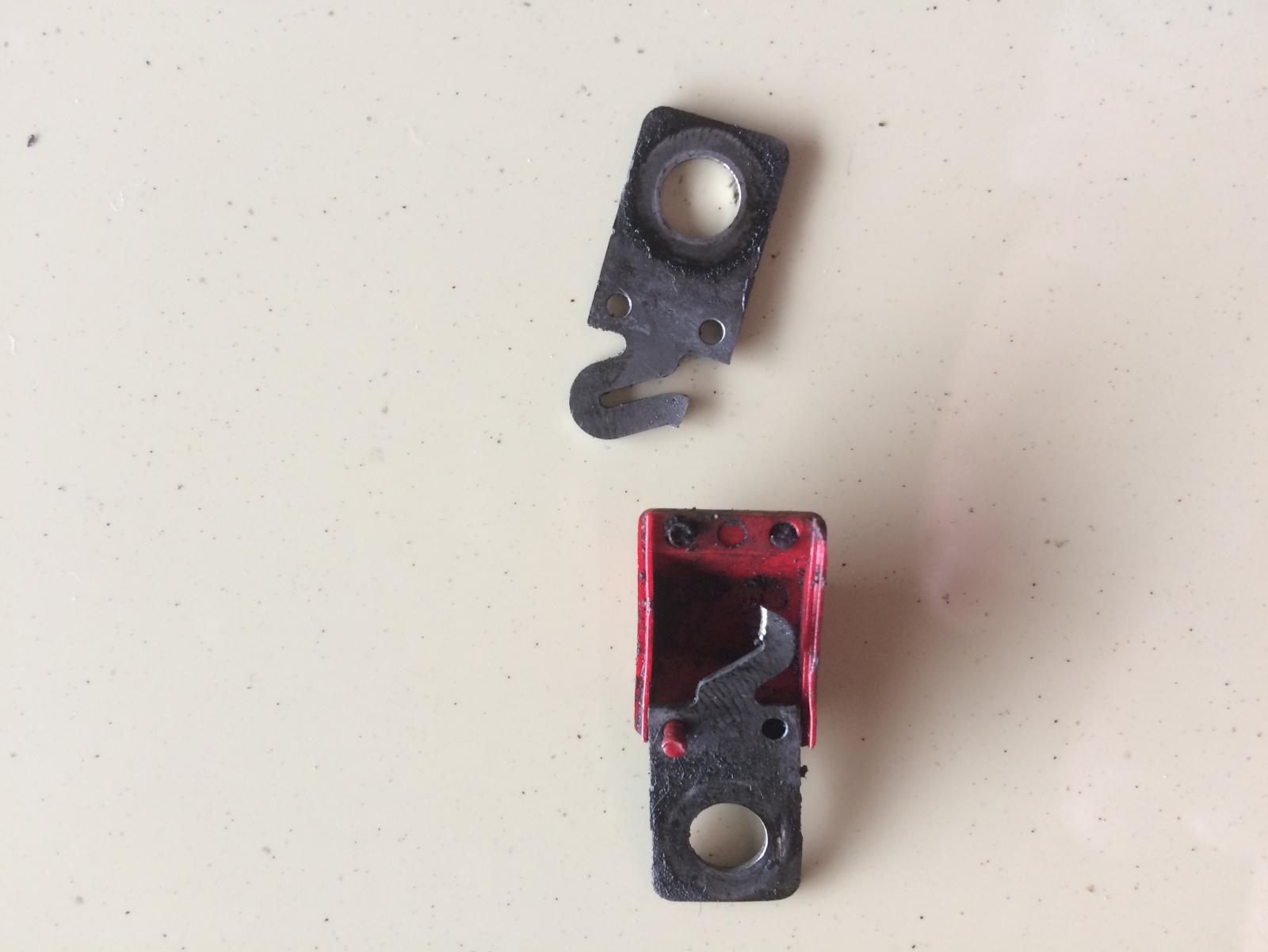

Just going to leave these pics here and let Ken provide the gory deets. In a nutshell we couldn't get the Alfa started this morning.
RE veehicle lectrix, I heart my Power Probe II.
Cheers matey, There was nothing when I switched the ignition on, no lights or anything. I am guessing this fuse blew as a result of us using jump leads? I've used them for years without any issue.
The battery is off now and will be trickle charged as a matter of course.
I obviously need a new fuse!!!!
Ther was also a small nut missing from the threaded post next to it as you can see in the picture.
