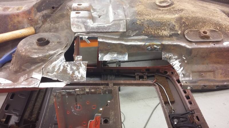

After cutting off the sill sections I set to cutting out the rot in the edge of the floor.  A few areas needed doing and after a day or so the floor was all fixed up on this side.
20161024_142856.thumb.jpg.f0f774928fe6bcd29f53ad3770b42a00.jpg20161024_142850.thumb.jpg.287ff04c676b73f2d4fe9e41441269d7.jpg

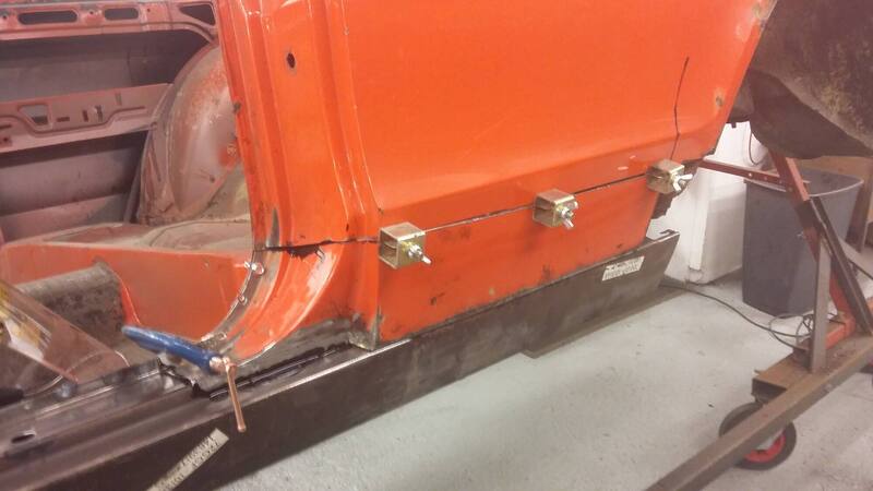

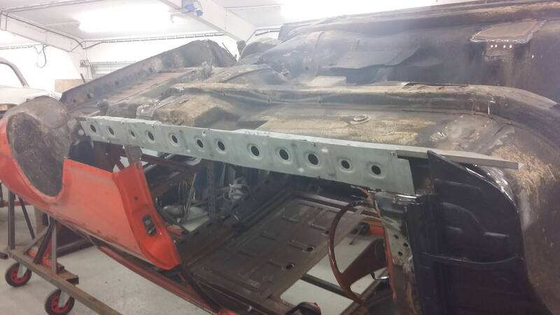

With that complete the inner sill and strengthener are temporarily fitted to check everything is going to work.  A bit of hammering later and the whole lot fits reasonably well.
20161022_155250.thumb.jpg.f1cfbf2ee0b5a75a5473c764c2ad7252.jpg20161022_155317.thumb.jpg.91015eee86ba5bca55ee18af98240f09.jpg

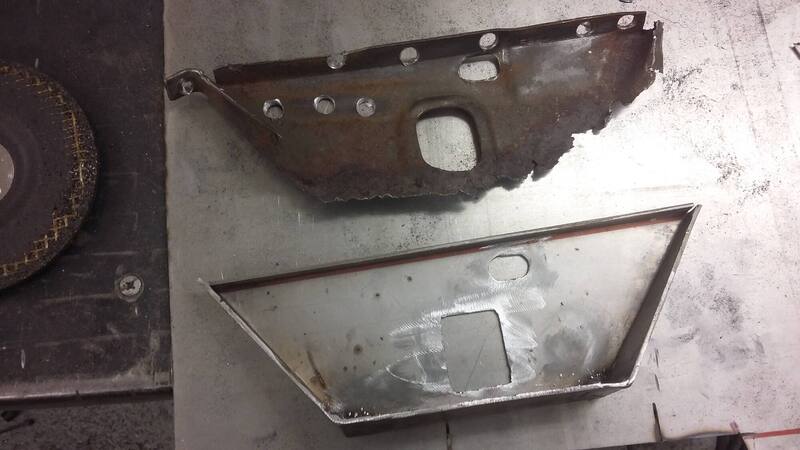

Next up was the jacking point.  Very little was left of the original so I has to guess what the original shape was and make another one.  Being a jacking point I made it from one piece of 2mm steel using a metal folder for the edges.
20161029_105416.thumb.jpg.4fa5e4a969374b856752f1bc3afc3bfc.jpg20161029_125518.thumb.jpg.9cdf50cdbc5b552d83da50a020095a52.jpg
A few adjustments and some more welding and it was back in place ready for the sill strenghthener to be welded over the top.

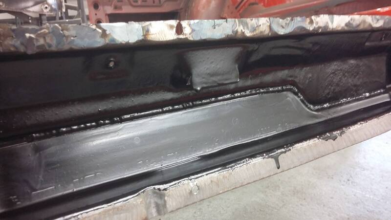

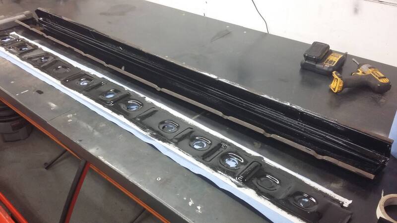

This is one of the few aftermarket panels being used on the car.  Unlike most aftermarket panels it actually fits quite well.  First job was to apply as much protection as possible to all parts of the new inner sill, jacking point and sill cover.  I also put in a bead of tiger seal along the seam where the lower part meets the floor as this area is prone to letting water in.
20161105_110051.thumb.jpg.67ac1de39cbd407caa3b4c033b7a0959.jpg20161105_115953.thumb.jpg.2d81665714669dd4861baf76b652f235.jpg
Before welding everything was once again mocked up to check the door gaps.

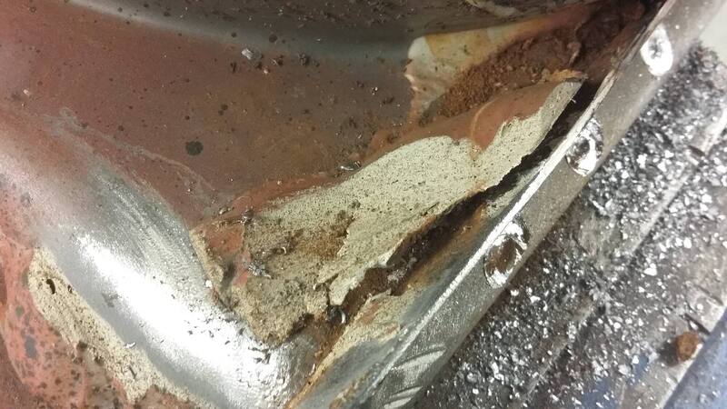

Every time I find factory seam sealer I find a ton of rust.  Dunno what Ford were using at the time but it seems to have more in common with a sponge rather sealer.  The bottom of the rear wing that I removed so I could replace the sill had loads in it.  Below is what was left when I peeled it all off.

So I went ahead and made new flanges for the whole thing and replaced a few bits here and there.

I've had my share of dealings with that seam sealer Ford were using. Exactly the same problem! I think it either dries or just ages to a point where it goes hard and stops sticking properly which then let's moisture past it.
When ever I've come across it, it often scrapes off fairly easily with a screwdriver or similar but leaves a rusty mark where it was.
That stretchy plasticky under seal stuff Ford used at the time can be a pain too. Some of it seems ok yet other areas will look ok but on inspection it's almost blistered and come away from the metal underneath. You can peel it off and find all the rusty beneath.
They also seam sealed onto bare metal rather than after priming.
Their just production cars, they never envisaged they'd last for ever
It burns very well if you weld near it so I try to get as much off as possible.  As you say it does come off very easily.  The black tar stuff in the floors is usually more resistant.
Its very interesting when you take a car apart to this level as you find all the little faults and water traps in it.  Most are there to keep the production cost down, but you do wonder how may are there on purpose to make sure you had to buy a new car later on.

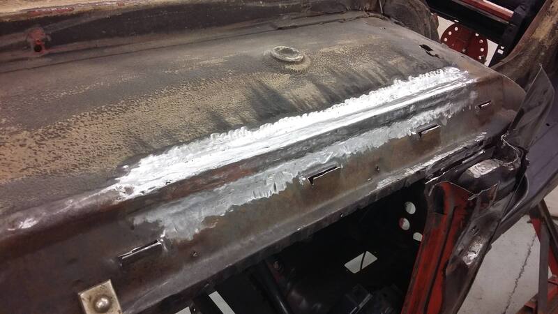

With the sill cover welded on and the bottom of the wing back where it should be I finished up the welding.  Right pain of a job due to all the shapes and curves but after a few hours work I had something that looked about right.
Next on the list is the replace the outriggers I cut off previously.  Make up end closers for the new sill and move onto the rear wheel arch.  The plan is to sort this side of the car before moving onto the other.  Leaving the other side alone gives me all the reference I need to ensure things go in the right place.  When I start that side I can use the repaired side as reference knowing its right.
