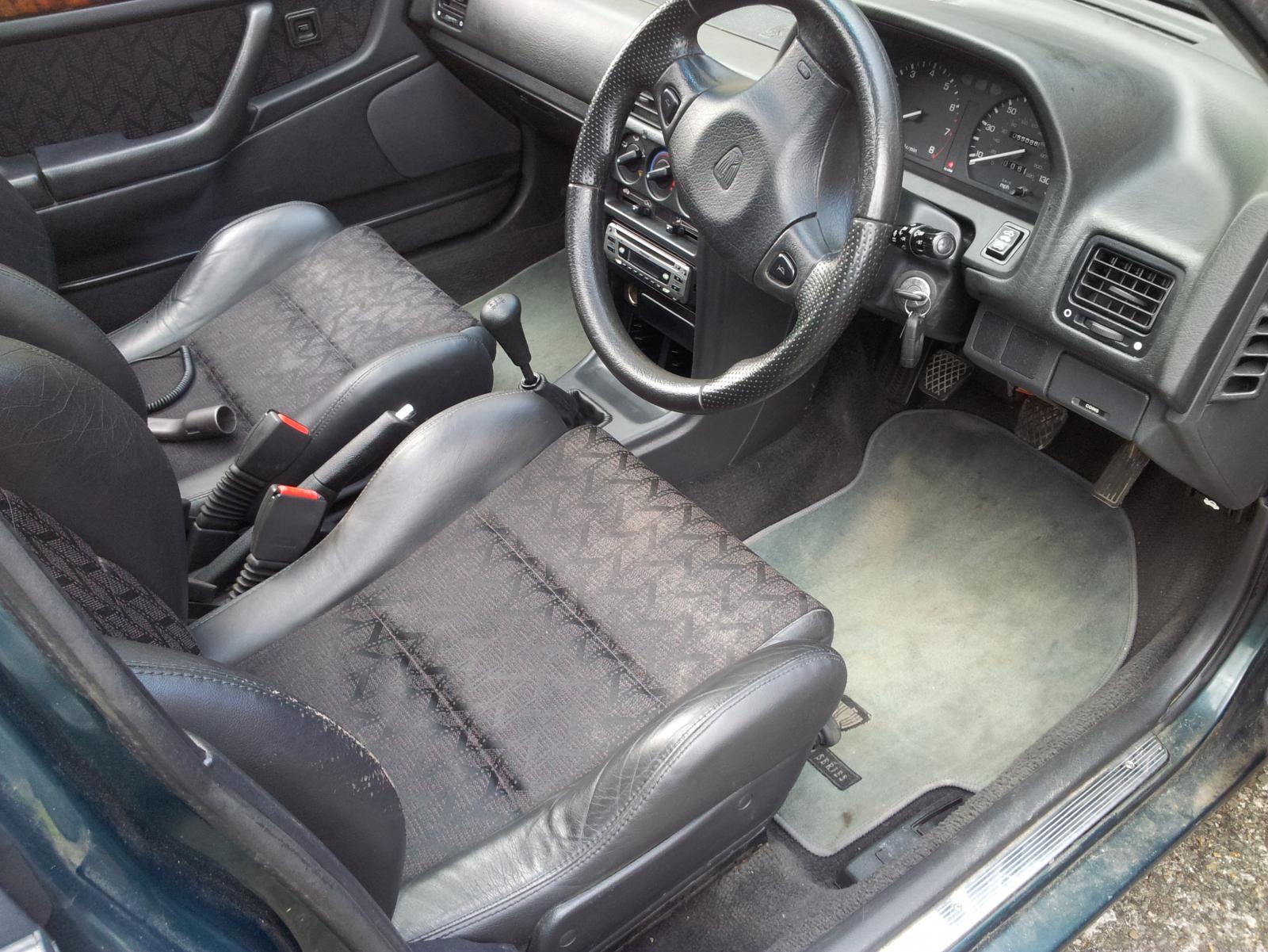

Revolting interior that smells like an old wheelie bin divested of much old rubbish and hoovered thoroughly, then sprayed with cleaning chemicals
Interior now smells pleasant and seats no longer look infectious

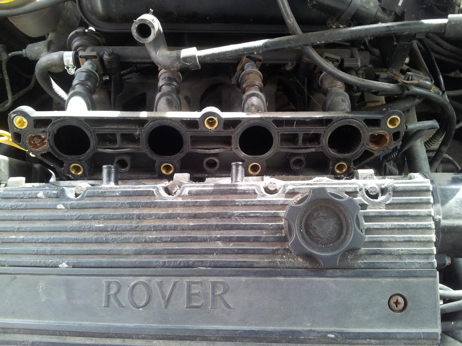

Small jet of water observed gushing from inlet manifold, suspect rubber seal most definitely no good, rest of car rather wonderful and will scrub up nicely.

Yo Phil! That gasket looks like one for a VVC or early alloy-manifold engine. The placca manifolds should just have a stringy green rubber seal thing I think!
I can see the rubber manifold seal in your pic and its defo buggered. Its black but any new ones you buy are green.
Ah, better not to have that gasket then? Rimmer Bros website had it listed for this car but there wasn't one there before.
I should have ordered the rubber seal as well really, it did look knackered and water is gushing out of it now. At least it's not going into the cylinders any more, in fact the engine runs beautifully with new plugs and cleaned up ignition parts.

Yeah, you don't need that gasket, just the rubber seal.
Ok, thanks. I'll keep it by for future use. I've ordered a rubber seal so hopefully in a few days it'll be leak-free.
Hope you didn't order one from Rimmers, the one I got from them (after much faff) was shit, wish I'd just got one from eBay or something.  Green replacement is much better.  Another water loss spot is the plastic thermostat housing which lives on the driver's side under the manifold and is just about impossible to get to with the manifold fitted.  Nice to know this quality ex-Bllx car is still in the fold.
That's useful to know, thanks. I got the rubber seal from ebay for a fiver as Rimmer Bros wanted £17 by times postage was added, hopefully it's Ok. Can't be much worse than the one that's on there anyway.

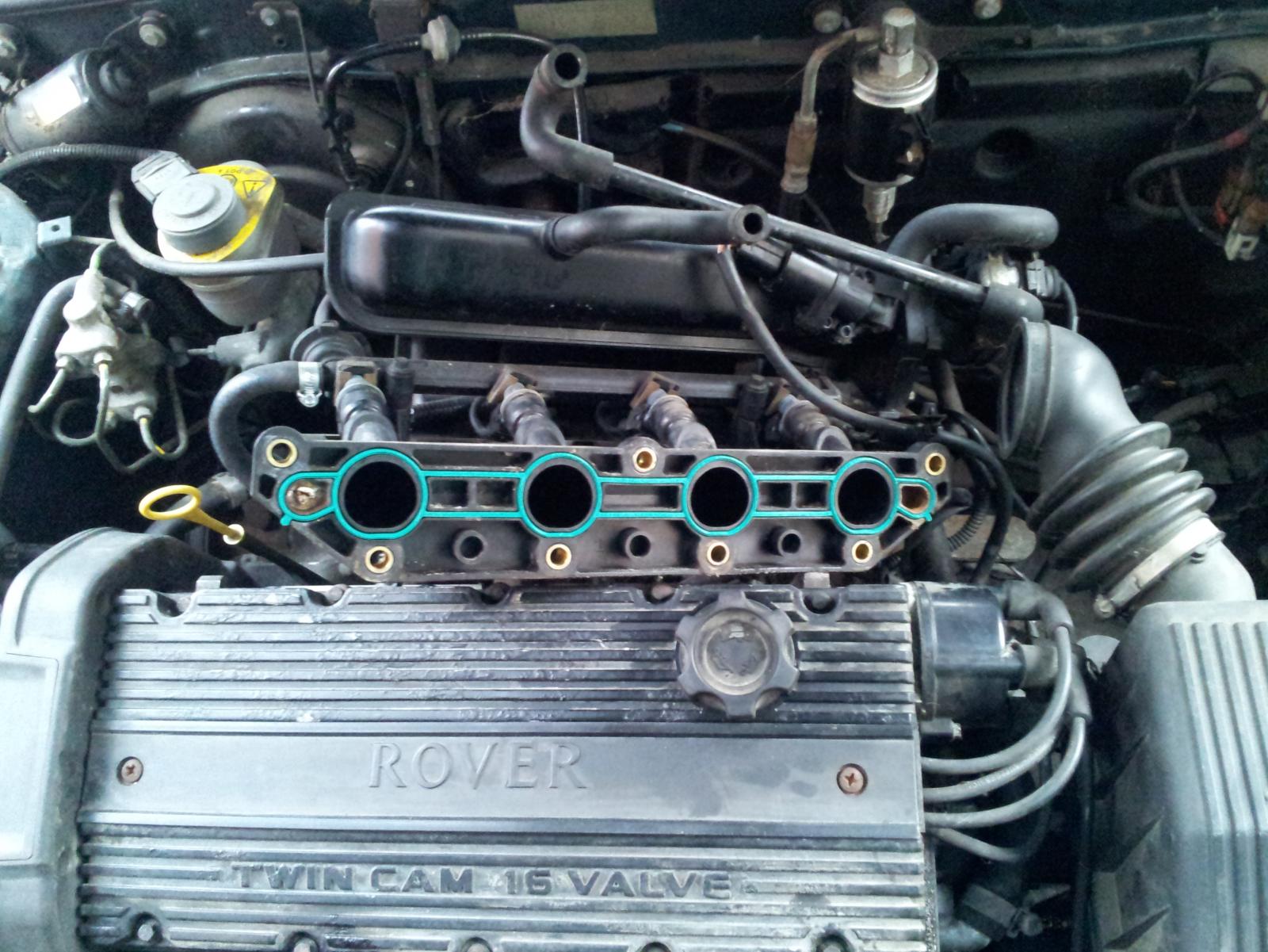

I used the last hour of daylight tonight to get it fitted.  Mr B, you were bang on the money, the old seal was hard, crispy and warped, not to mention split at one end.  The new one's much better, fitted perfectly and is also green.
Reassembled (getting good at this now) and was careful to tighten up all the bolts several times but without going mental on them as it's a plastic manifold (boo Rover, poor show).
Topped up the coolant again, fired it up and...
It still leaks.  Bugger.

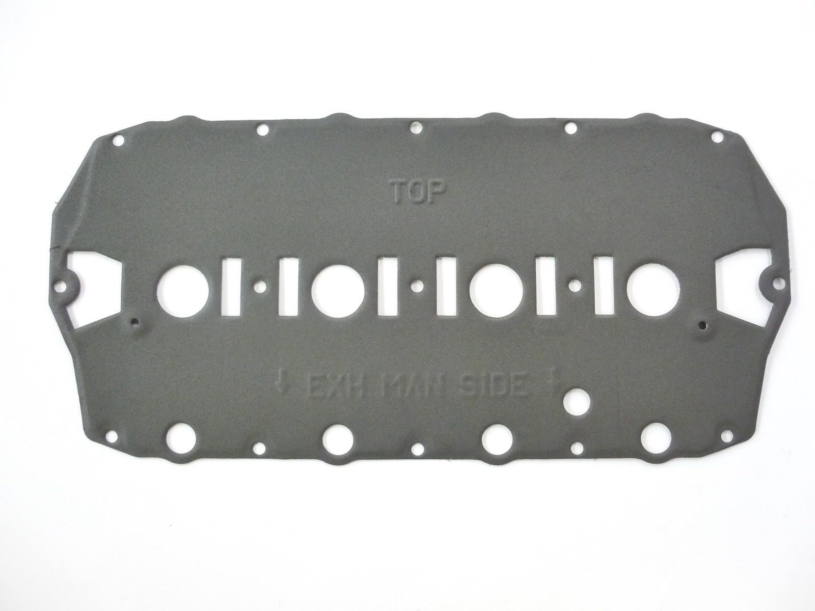

My 214Si leaked oil in exactly the same place. I was surprised to find that the cam cover on a K-Series hasn't got a gasket in the traditional sense, rather this elaborate sheet metal thing:
Easy enough to fit, but beware the razor-sharp edges!
That is odd, I wonder why? Oh well, no rush as I need to pull the cooling system to bits first!
I think the design of it must play a part in preventing the camshafts from throwing oil about; it greatly surprised me when I took it out of the box after collecting it from my then local Rover dealer (Time Tees Cars of Upminster), that's for sure.
Stopped the leak, however, although that might have also been down to using copious amounts of Loctite in conjunction with it.

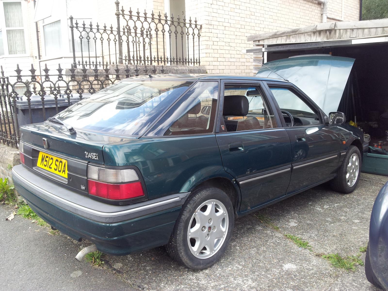

Sweet looking car Phil. Originally Birmingham registered. Love the mats too (obviously) It's rare to see an R8 with mats in but I know Bollz bought them for the car in his thread.
