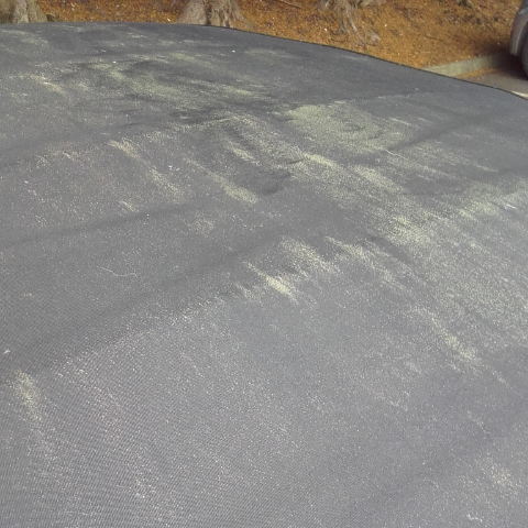

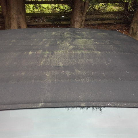

What's the best way of getting rid of the green moss type shite that seems to bastard breed on soft top hoods? It's a golf. The pics were taken in a car park with trees ahead. The vehicles isn't usually parked near trees.

I think cabrio hoods are a different kettle of crab. I've scrubbed this many times before. Tooth brush for the stitching kind of cleaning. Bastard green shite keeps coming back!

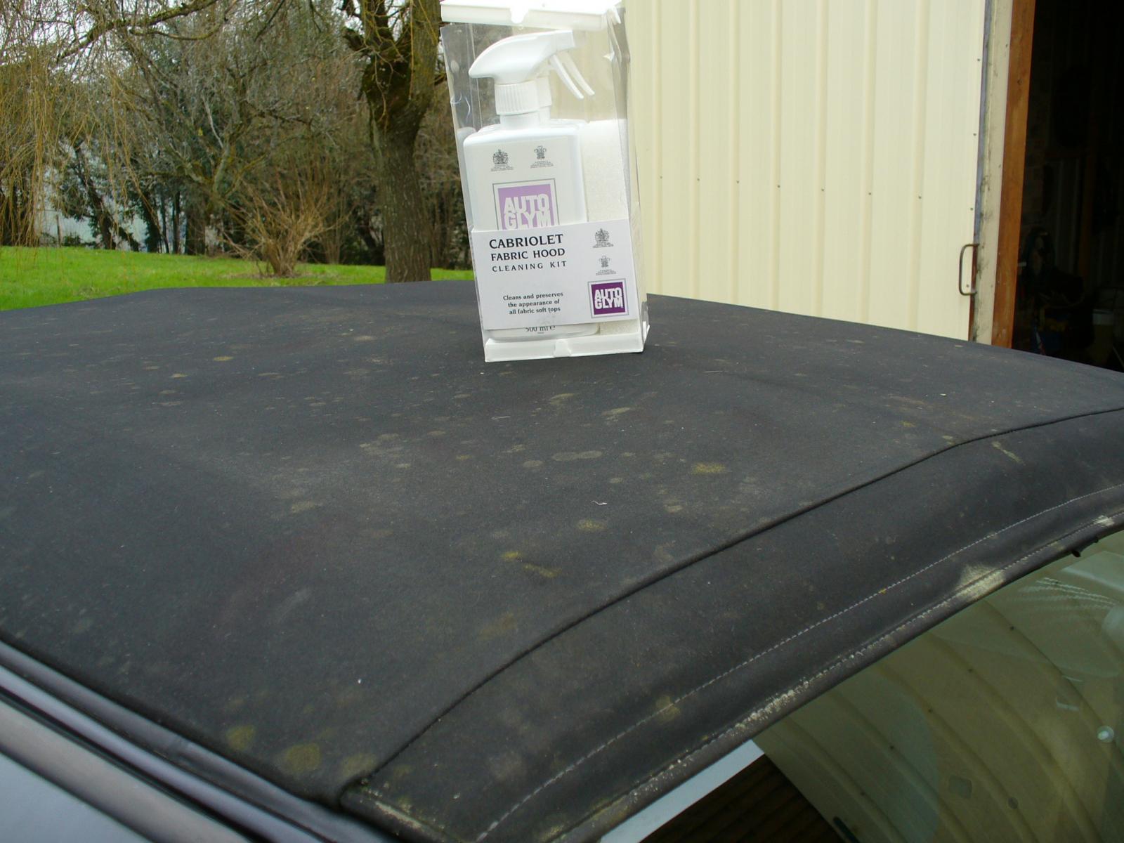

Autoglym roof cleaner has previously done wonders for both the cloth roof on my old e30 Baur and the vinyl on my mk1 mx5.  Comes in a pack with a rough sponge thing, think it's packaged as cloth roof cleaner but it removed green stuff off both.
Second vote for the Autoglym kit.

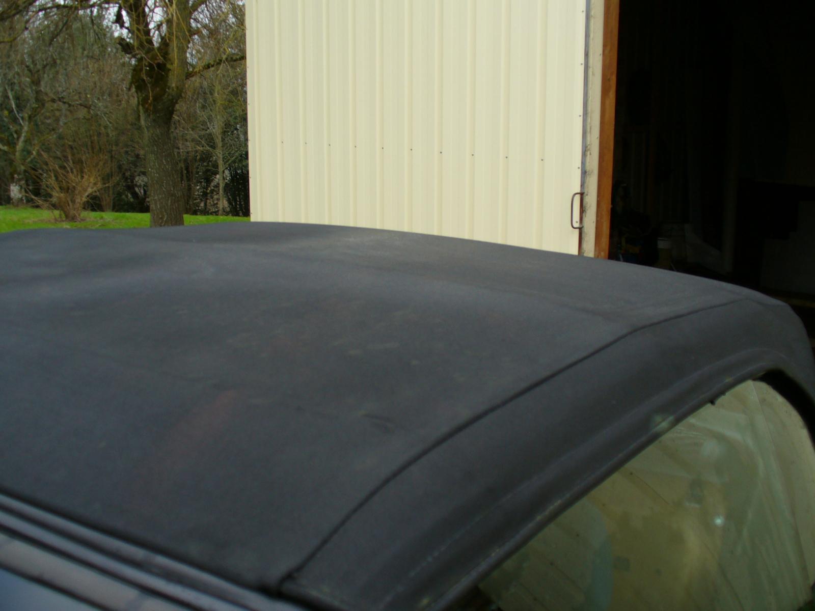

I did a second application a few days later and it came up mint.
The second part of the kit is to rewaterproof the hood after cleaning.
Renovo is great stuff for getting rid of the green sniz, the S2000s vinyl roof was a sod for going green and the Renovo kits brought it up like new.
The roof protector is very good as well.

Second vote for sterilised (Milton) warm water and a brush.
A smidgen or two cheaper than the Autoglym option I'd imagine.
Yeah, since the green shizz is "alive" you need something to kill it rather than just give it a bit of a wetting.
I used the Autoglym one with good results, but I was knackered after an MGF roof as I'm a massive weedy wuss. You need to give it a good old hoofing scrub.
Another vote for autoglym. It comes with a cleaner and a waterproofer. Had good results with the other half's beetle cabriolet.
