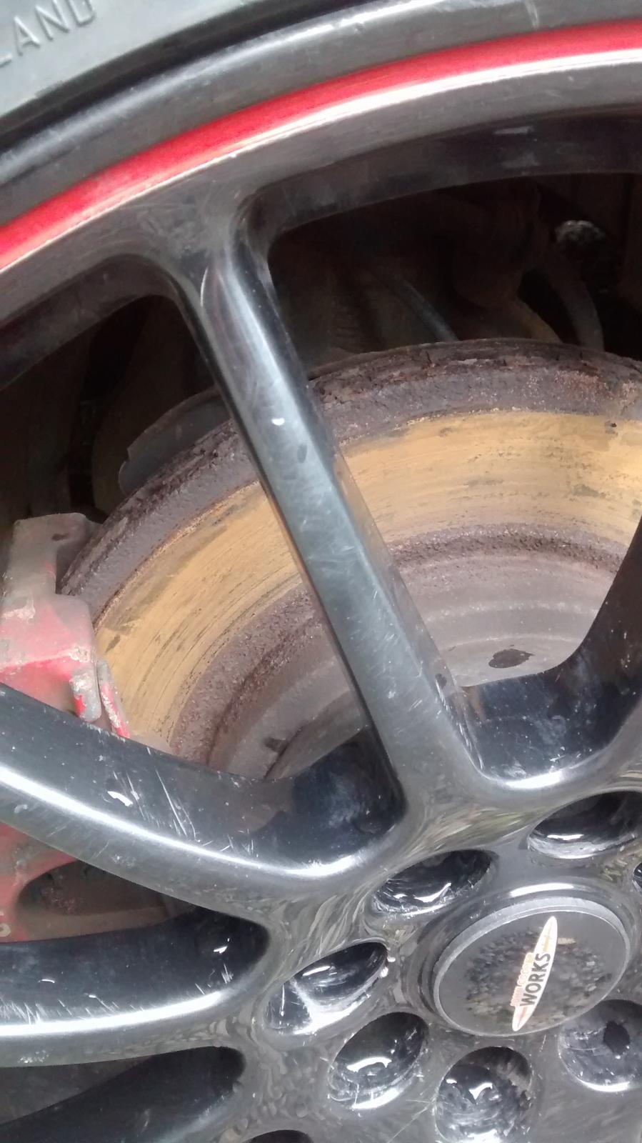

Front discs shot,

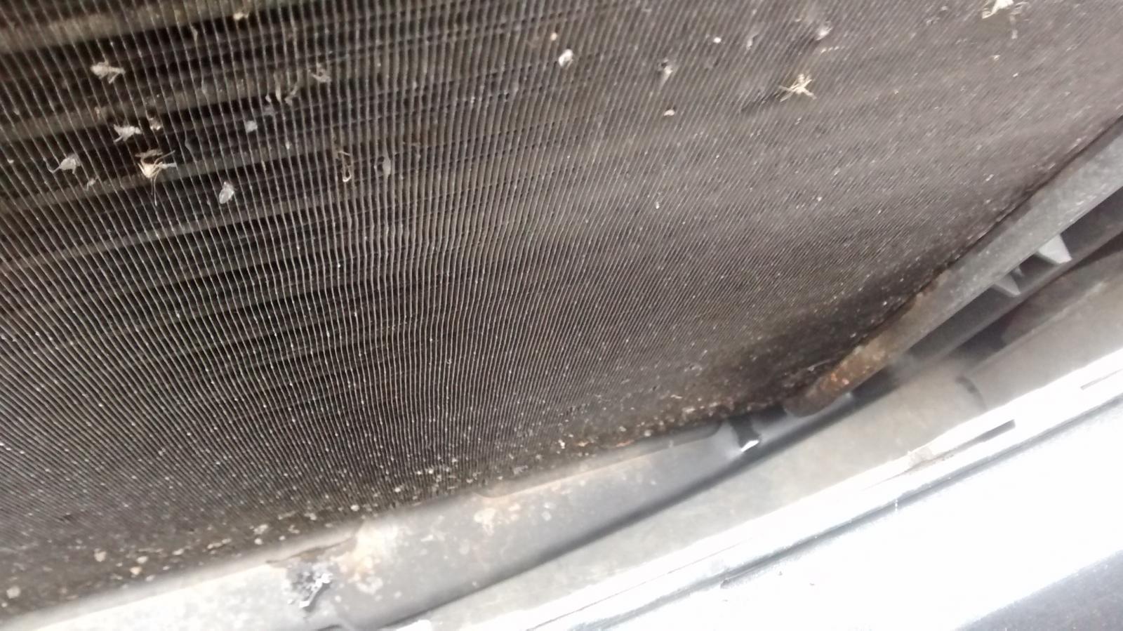

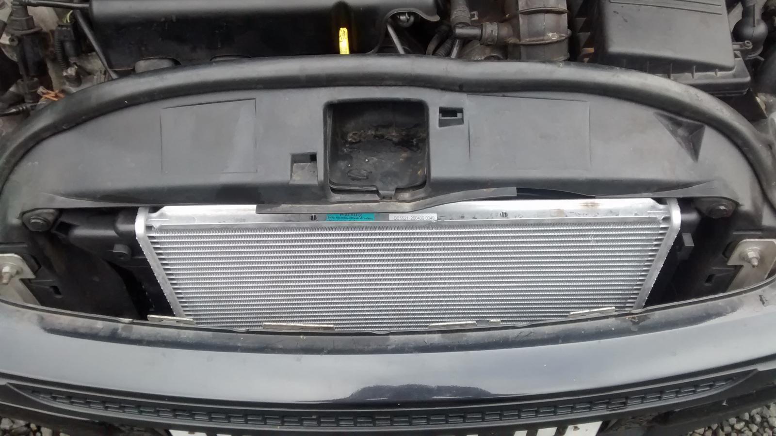

first job after scran the rad as it looks a doddle since no air con,
you can see its weeping down both bottom corners so after fighting with spring hose clips it was drained removed,
20 mins later and a quick bleed shinny bits.

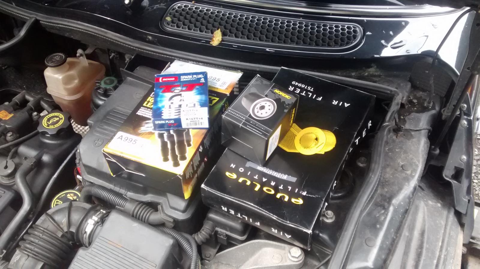

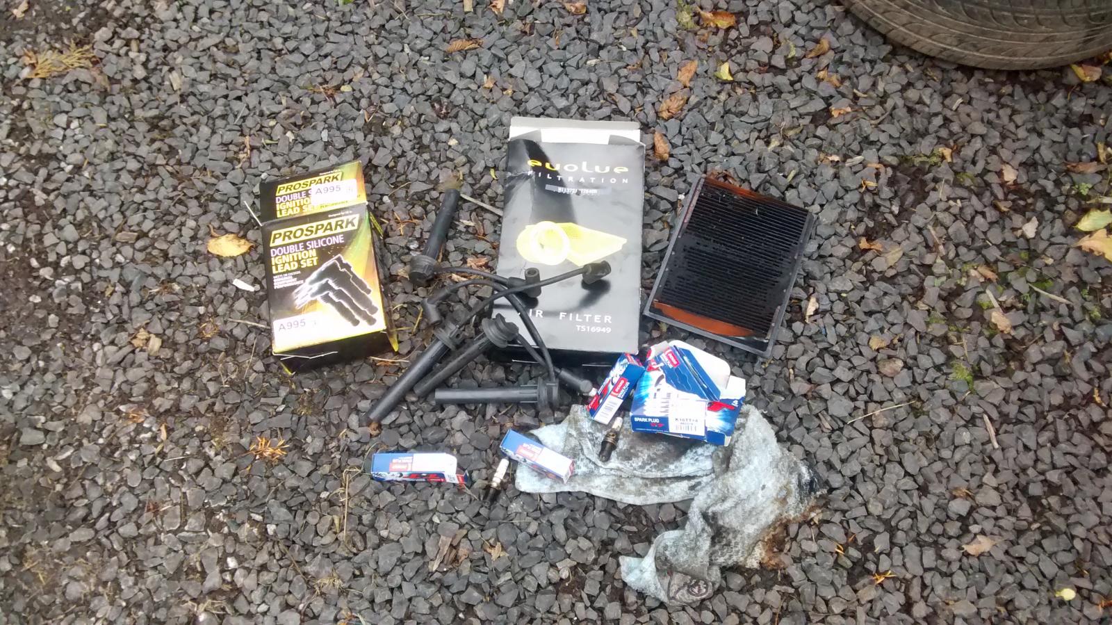

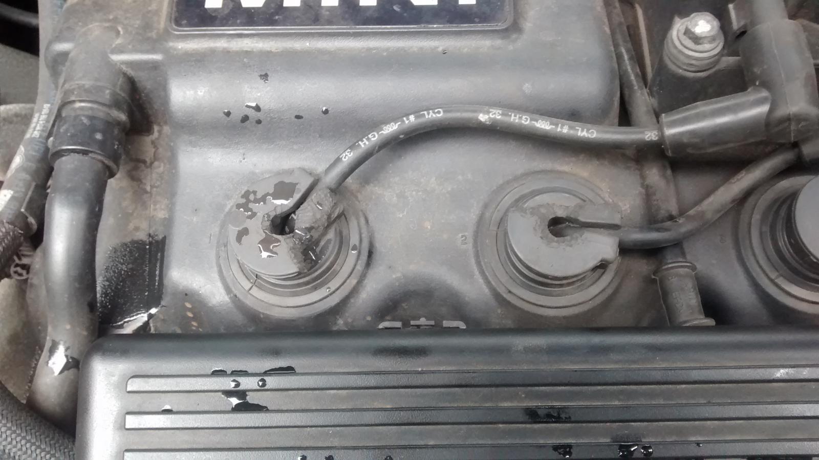

as the leads had been half eaten,

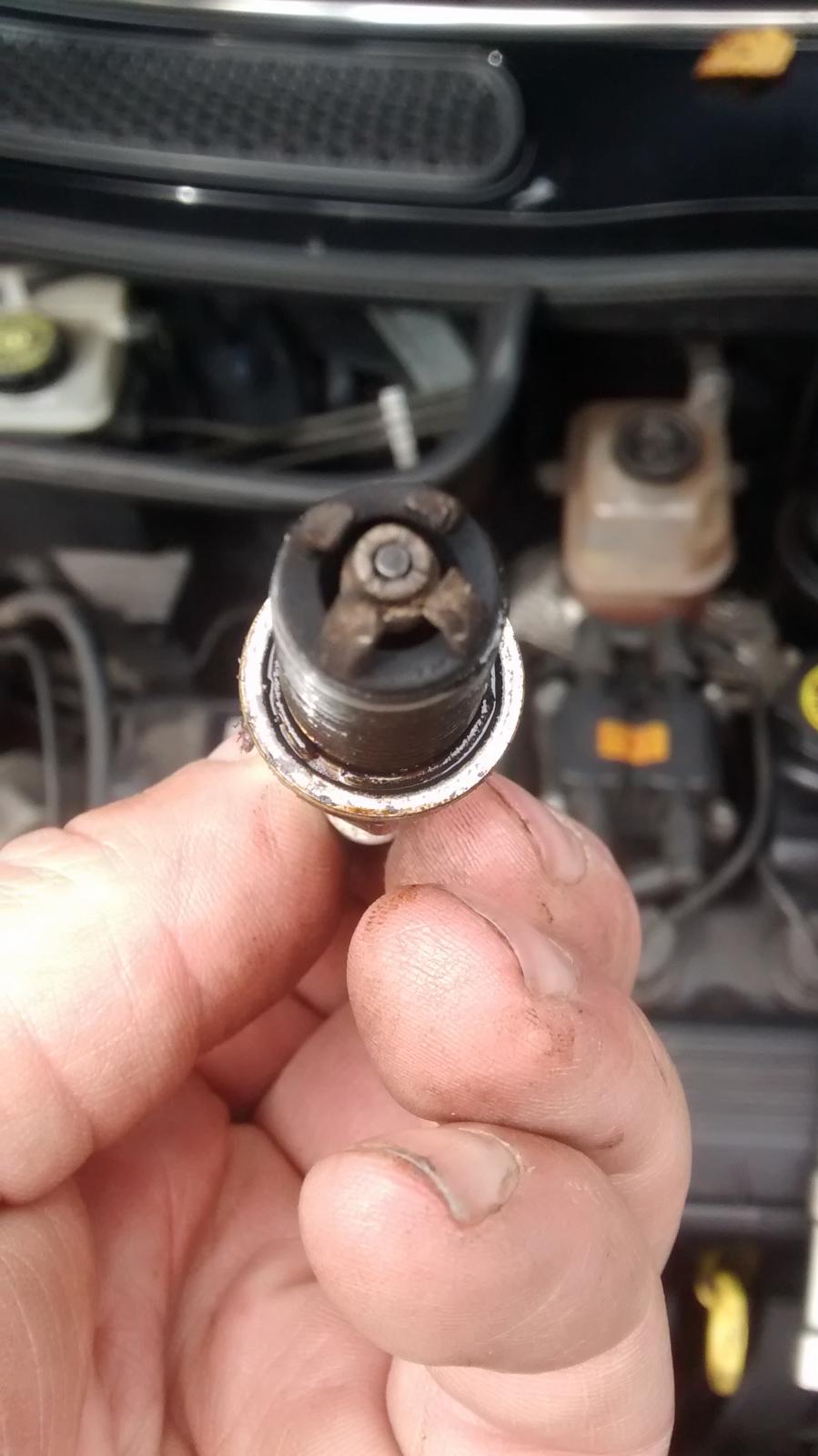

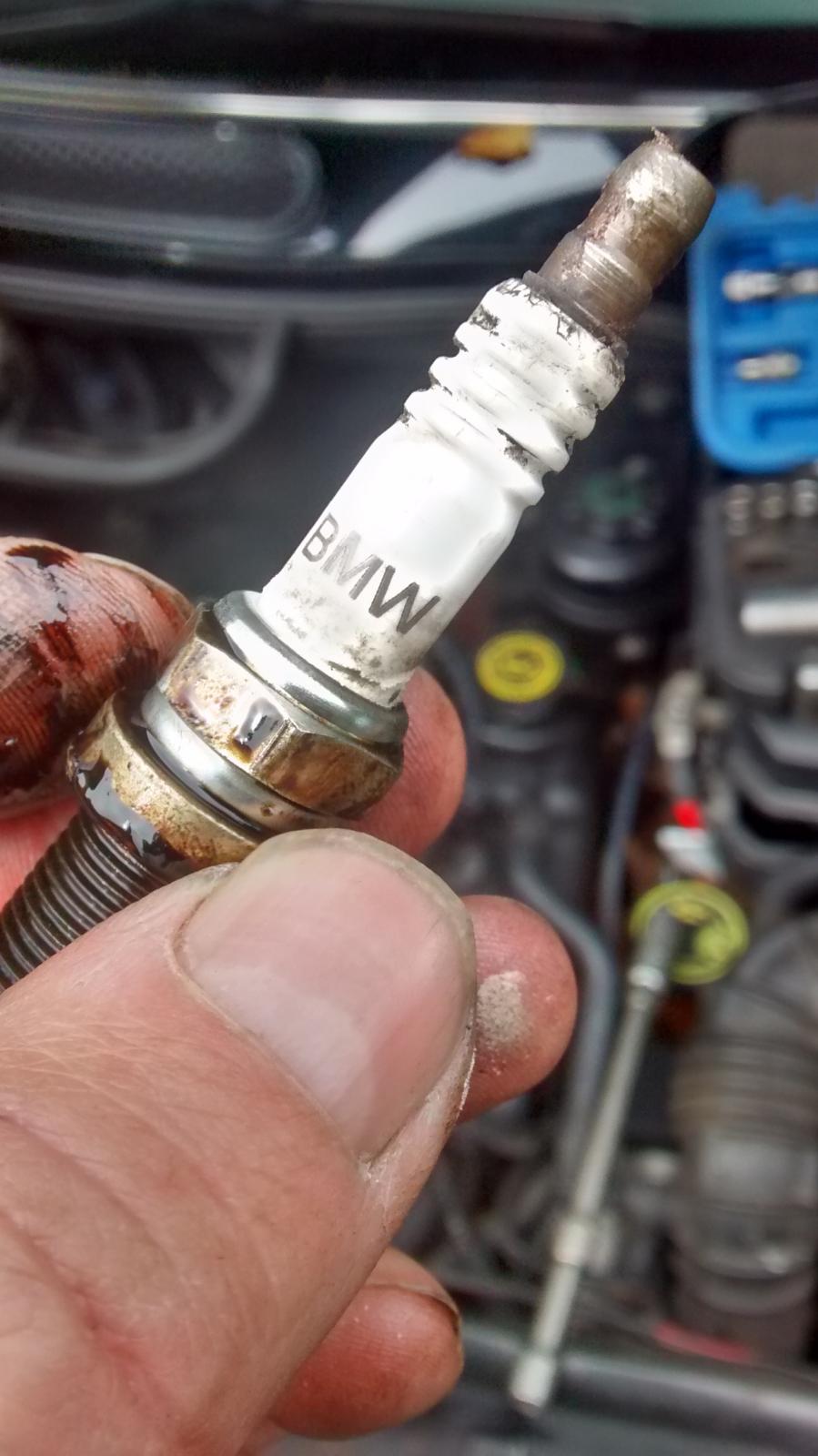

I ordered a new set for peace of mind, I removed the plugs and these are fancy looking things, BMW too so is it possible they could be the originals,

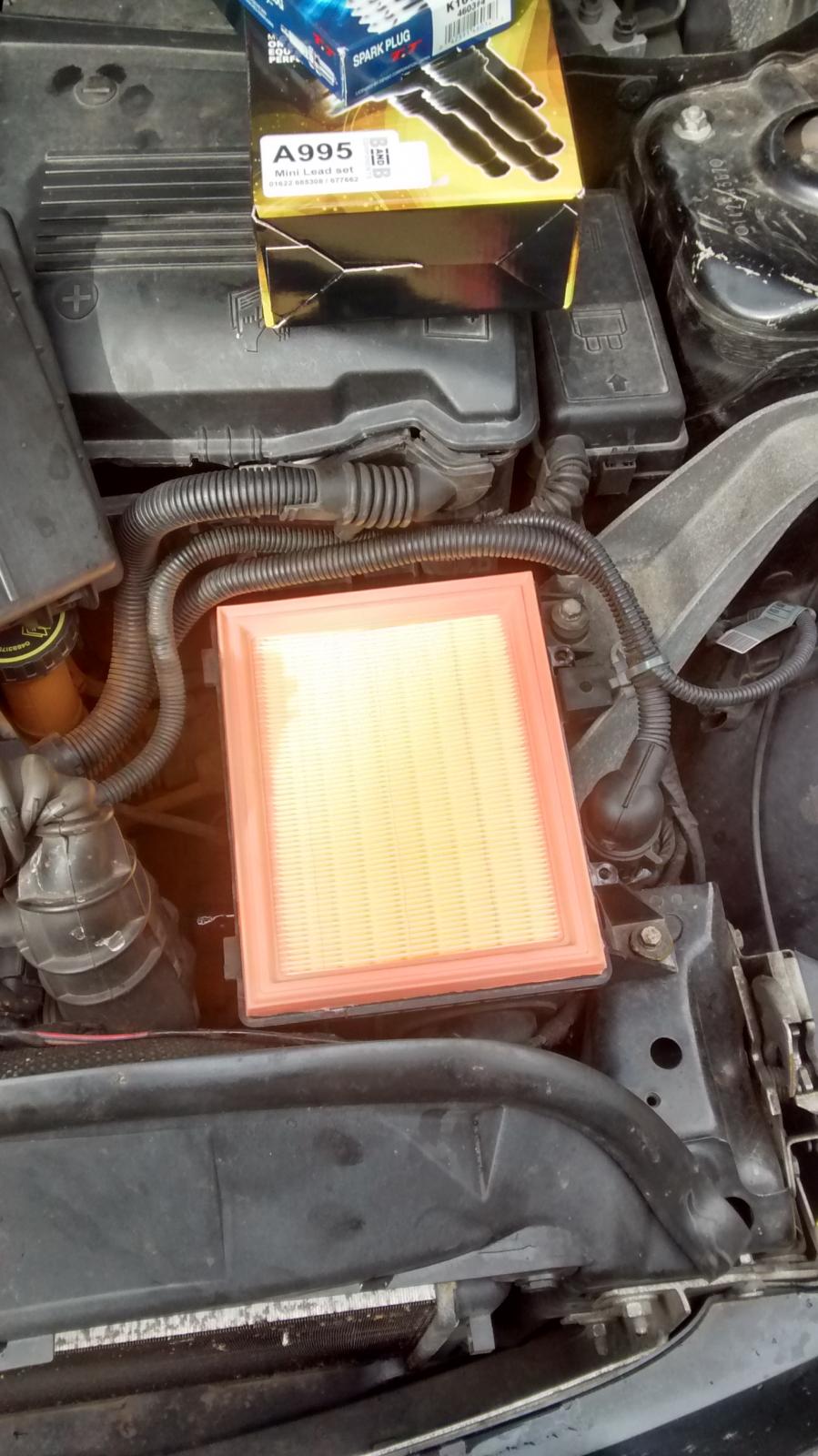

then I moved onto the filters and this could also be the original as it too was a genuine item.

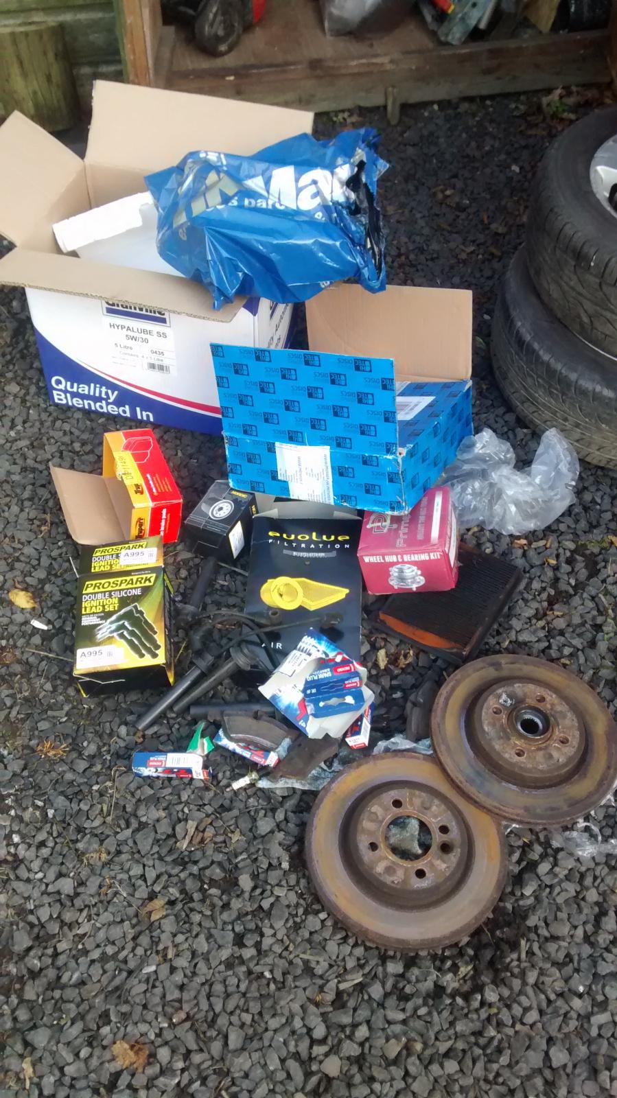

After changing the oil filter and replacing sump plug I filled her up and it took nearly the whole five litre tub,
first wave and the rubbish pile is growing.

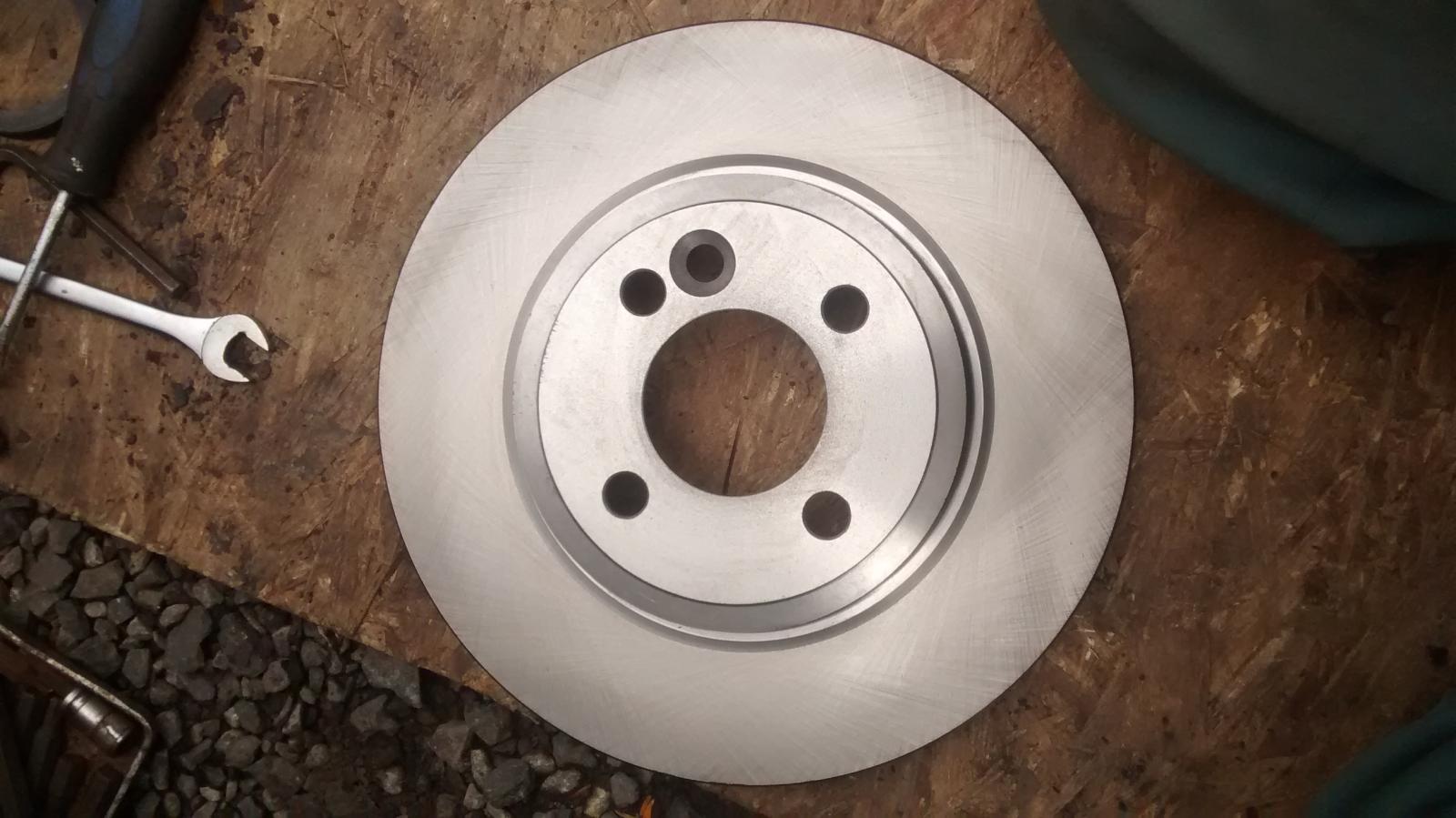

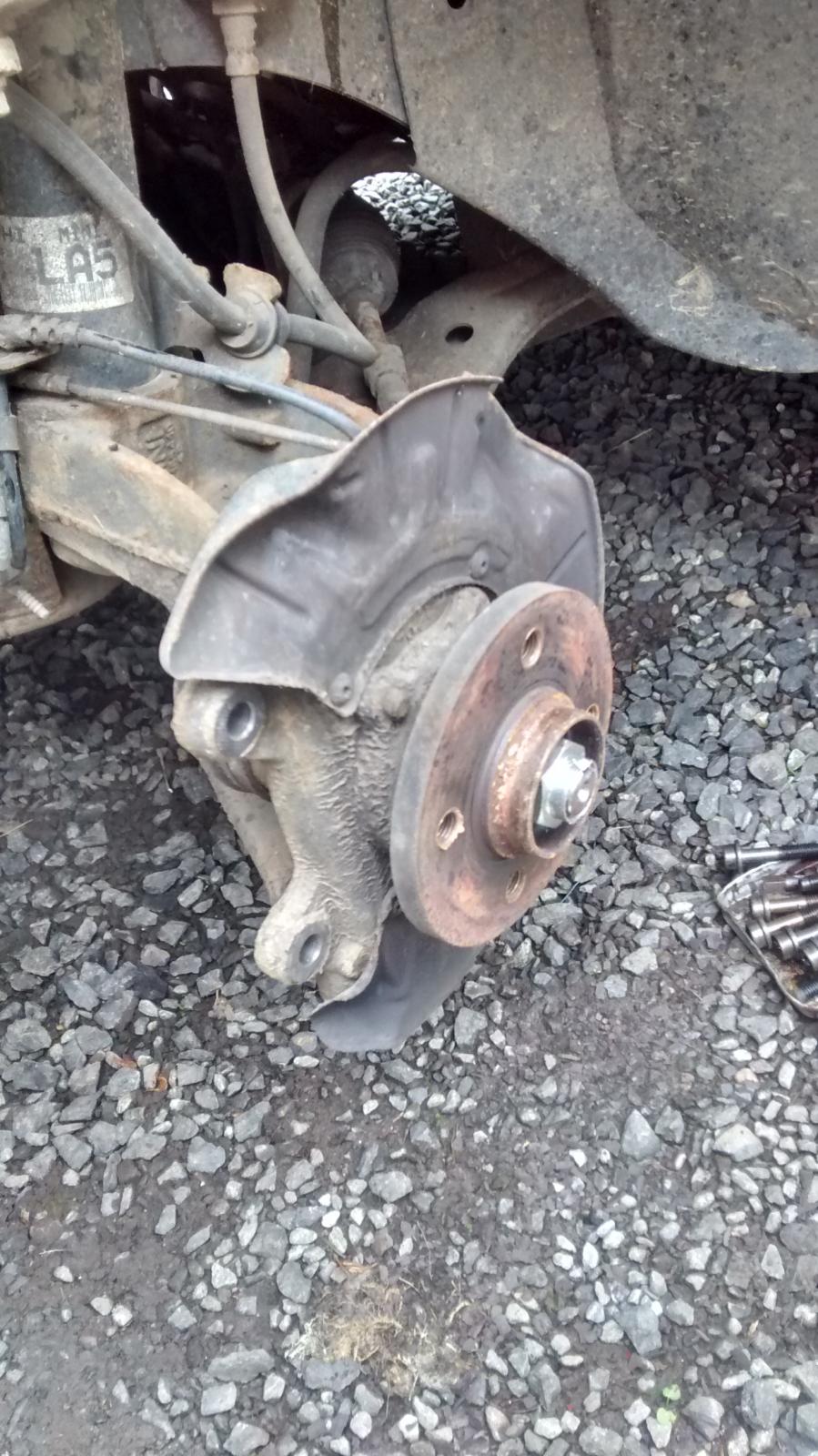

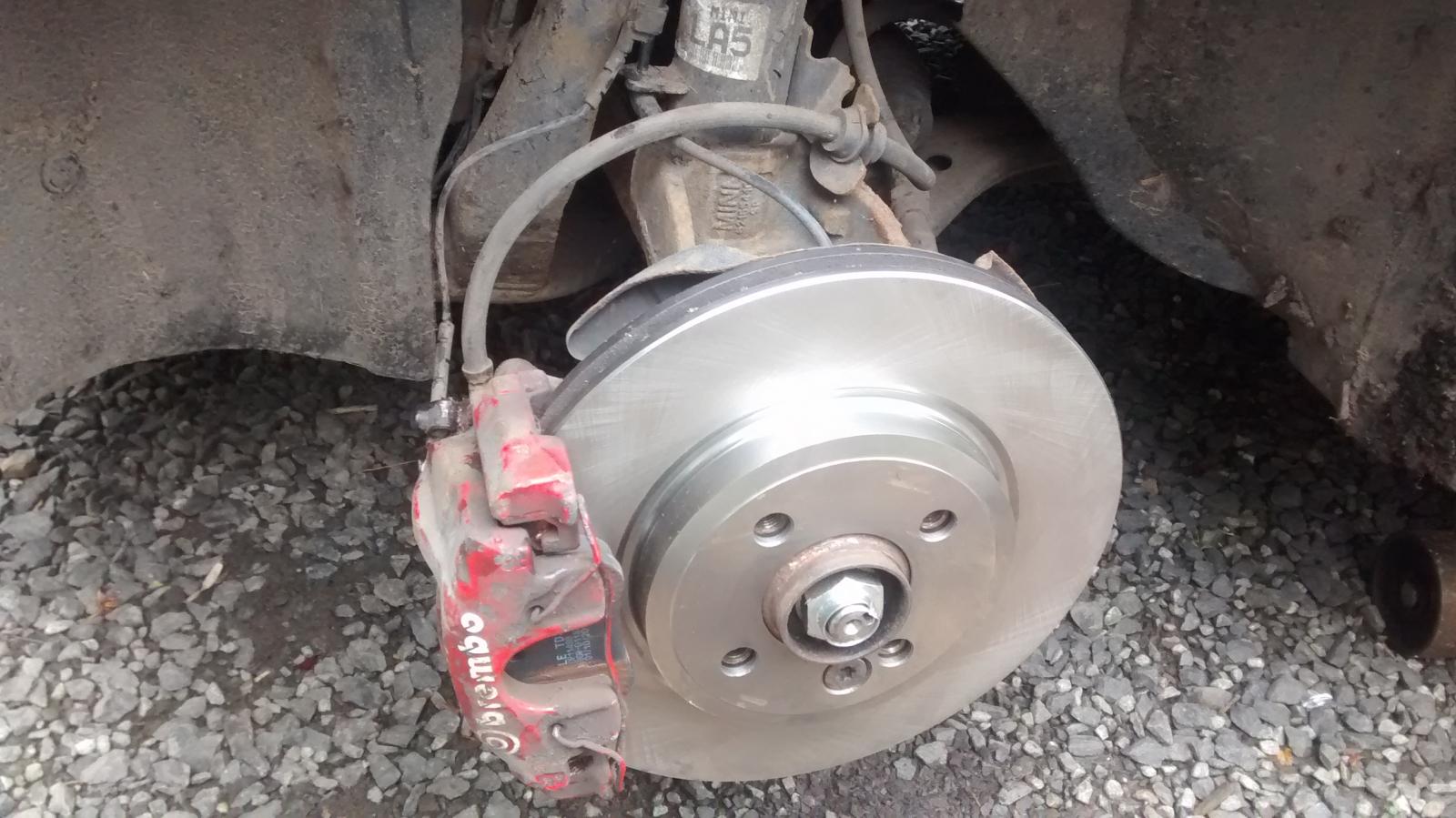

Next job was the brakes as the discs really are past it,
I jacked her up and removed the wheel and found a chunky torx bolt holding the disc which came out with ease, so now a simple case of pushing the pistons back and unbolting the calliper then removing the calliper mount.
more shiny bits,
I cleaned up the hub ready for the new disc, then refitted it all back together
wheel back on then moved onto the other side.

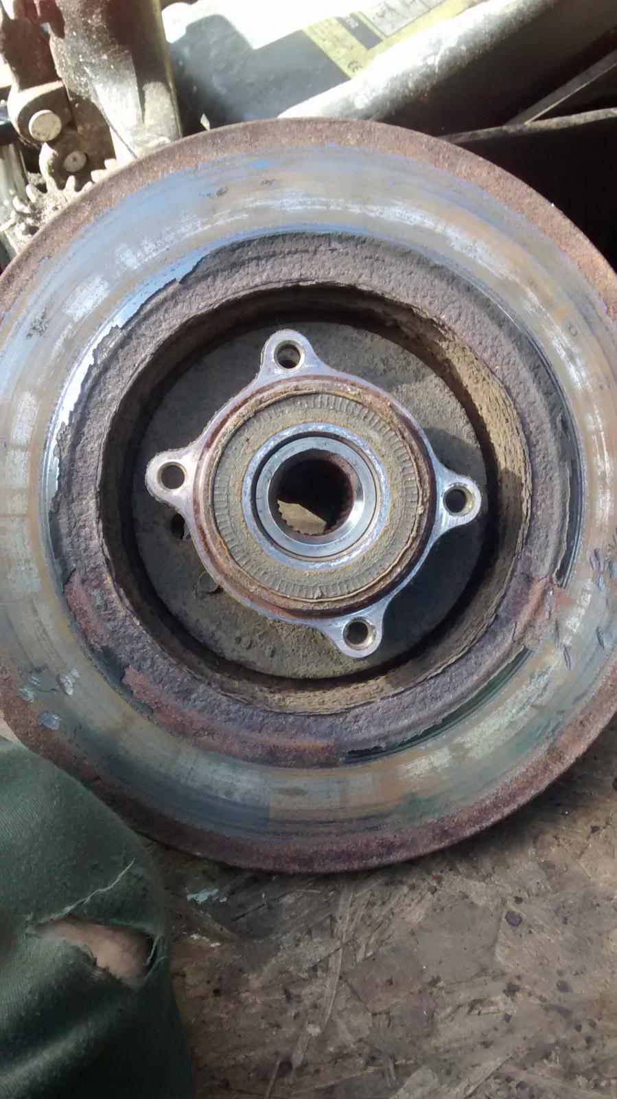

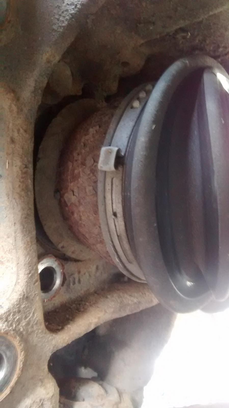

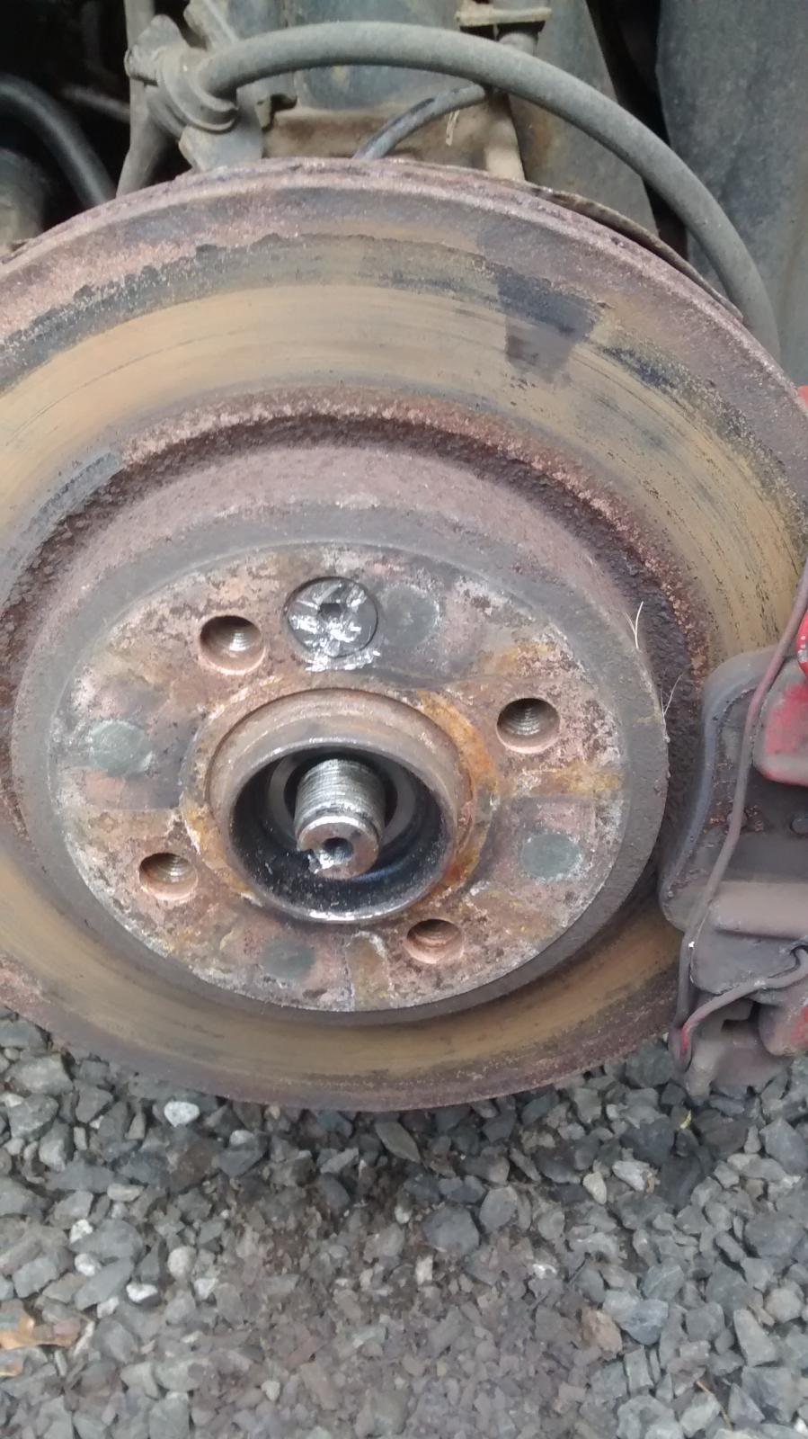

After my success I was sailing right up to this happened, the darn thing just wouldn't budge at all then after much hitting with hammers and swearing it was chewed beyond recognition,

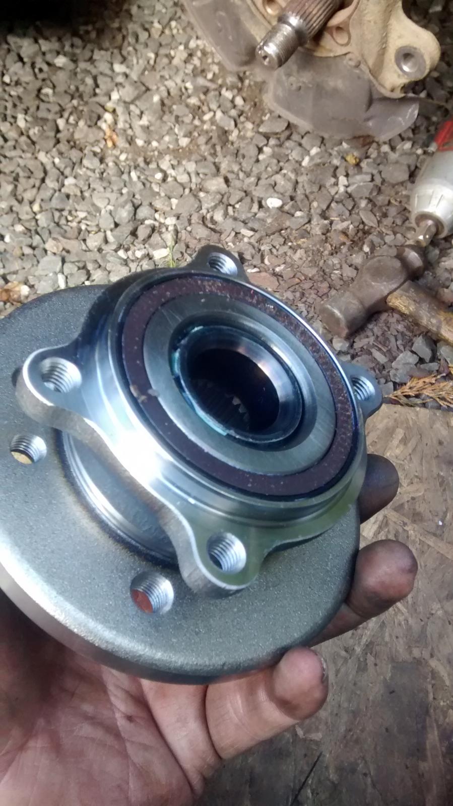

it was then I realised what a fool I was being as this was the side with the knackered wheel bearing so I undid the hub bolt from behind and bingo one disc complete with hub removed,
it was then just a simple job of bolting the new hub on and refitting the new brakes,
the rubbish pile is now even bigger.

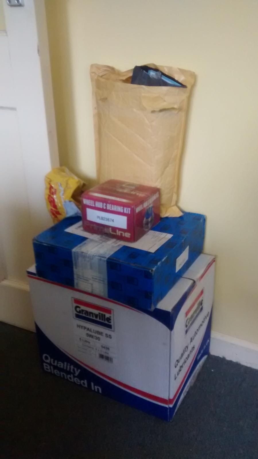

wheel bearing/hub £29.90
service kit £34.49

Not to bad cost wise for parts. That all in one hub wheel bearing looks like it keeps things simple.

I've noticed quite a few vehicles are using complete hubs now as I've only just done one on my Navarra

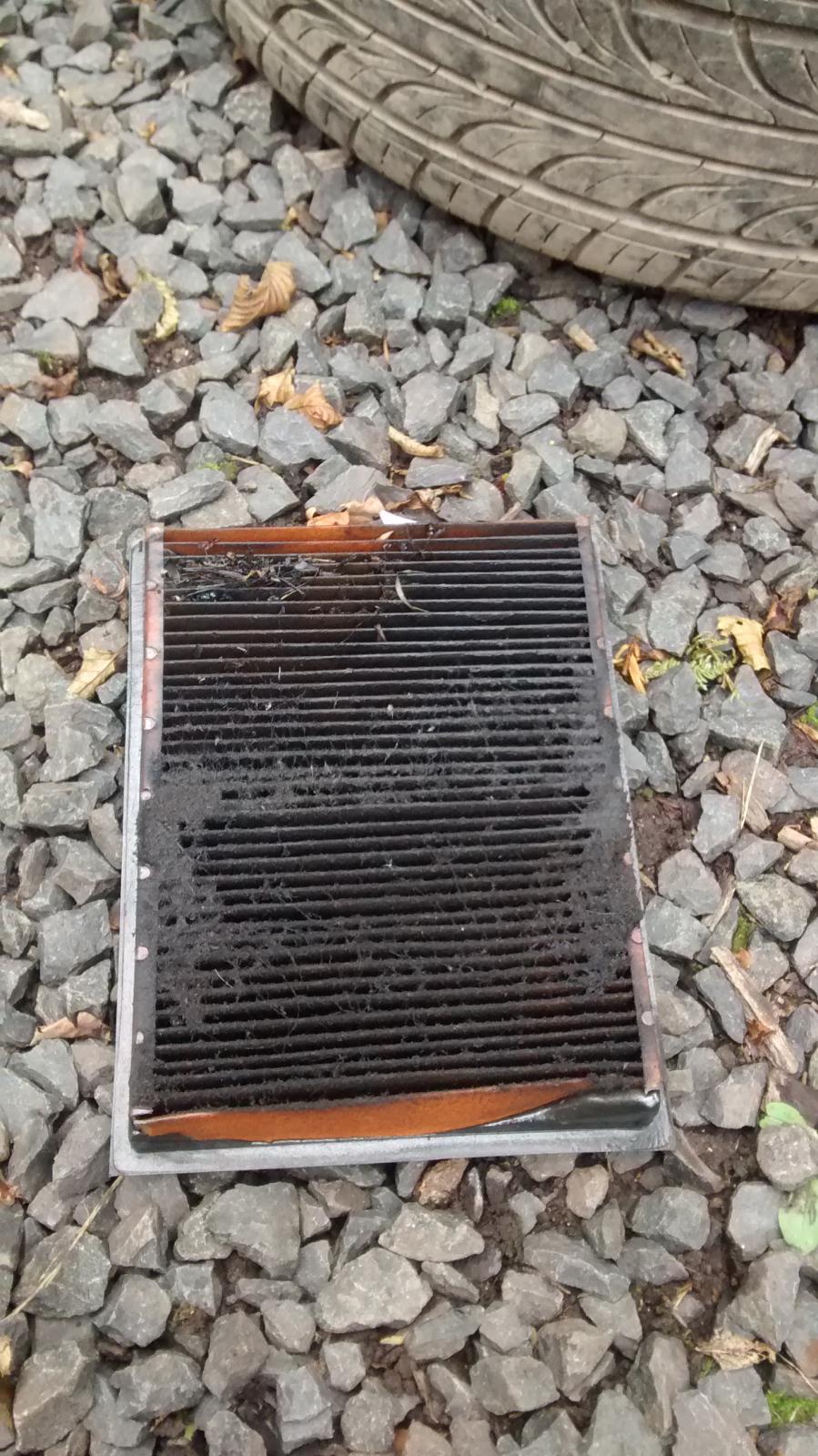

First service EVAR! That air filter is one of the worst Ive seen.
