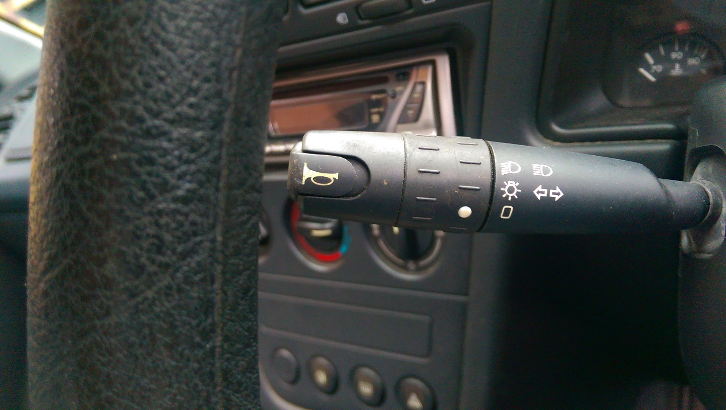

This afternoon, though, a fault befell it.
The steering column caught on fire a bit, and wisps of acrid smoke danced afore my wifes visage. Immediately after this she noticed that the indicator column stalk is now inarticulate and fixed in place.
I've removed it and stared at it for a bit and not even my most accusatory of glares can fix it, so now I need to source another.
It looks like this, and The Internet says that someone called Euro Car Parts is able to source one for something like £50, though there's no guarantee that they won't actually order a bass guitar and a loaf of bread instead because the part number is roughly similar.

If I remember, I'll have a look this weekend. How do you remove the indicator stalk? Just remove steering column cowl and unplug / unclip it?

Offers for stalks are flooding in - Carlo ( I must stop typing Carol in error) has slung an extremely similar looking 405 stalk in the post for me, if it doesn't do the job I may have a word with you.

Hearing of the recent incendiary antics of the indicator stalk on the 306, he rushed to the rescue with the offer of a replacement for the cost of postage. The only caveat being that it was a stalk for a 405. After a whirlwind tour of Google, punching in related keywords, I found absolutely nothing that confirmed cross-compatibility or otherwise.
So, YOLO, I reckoned, and quickly sent £3.30 in Carlo's direction. A look at the package reveals that he's 5p out of pocket.
So, two Philips and two Torx bolts later, it was out with the old.
"New" and old look near-as-dammit the same, except that the 405 version has a rather more funky-looking horn button at the end.
Vitally, the business end where it talks to the car seems virtually the same, too. There's the same number of pins, and assuming there's no arcane difference in pin assignment, all should be well.
There are a couple of extra connectors on the 405 version, though. So I ignored them.
Reassembly is the reverse of dismantlement, and not a Haynes 'Special Tool' in sight.
Not only an easy job, but a successful one, too! Full indicatory performance has returned, the flasher flashes and the horn horns, and the lights-on warning (which sounds the same as the warning you get at a level crossing) works tip-top.
