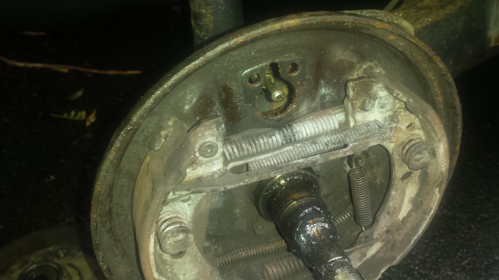

Well this got a new wheel cyl fitted today, all adjusted up and then taken for a retest.
still shyte. So think it'll need new shoes as the adjuster was moved as far as I could get it.
bumhats
Those shoes look to have loads of material on them so they must be a bit knackered then.
Did you break the glaze on the drum?
I'm just gunna put new shoes on, fit the other cyl and get it set up right. fed up fucking about with old bits..

Dropped this off at a local VW specialist tonight-They are going to fit new shoes and gitter adjusted up.
hopefully my bro can then drop ot aff for an MOT so it is available for use next week
Got it back from the garage eventually- they have a padlocked key drop and only gave me 2 codes.
The one that worked unlocked the top one, so I had to go fishing with cableties to liberate the key.
Handbrake feels much better after 1 new cable as the other freed off.
The old shoes are still on as the shoes they got supplied were the wrong ones.
brakes feel more even and they have apparently tested it on the rollers and it was ok on pedal and handbrake.
Hopefully my brother will take it for an MOT whilst I'm on holiday.
If the brakes still read low I'll take it back to the garage cos I'd asked them to ensure it was mot standard.
