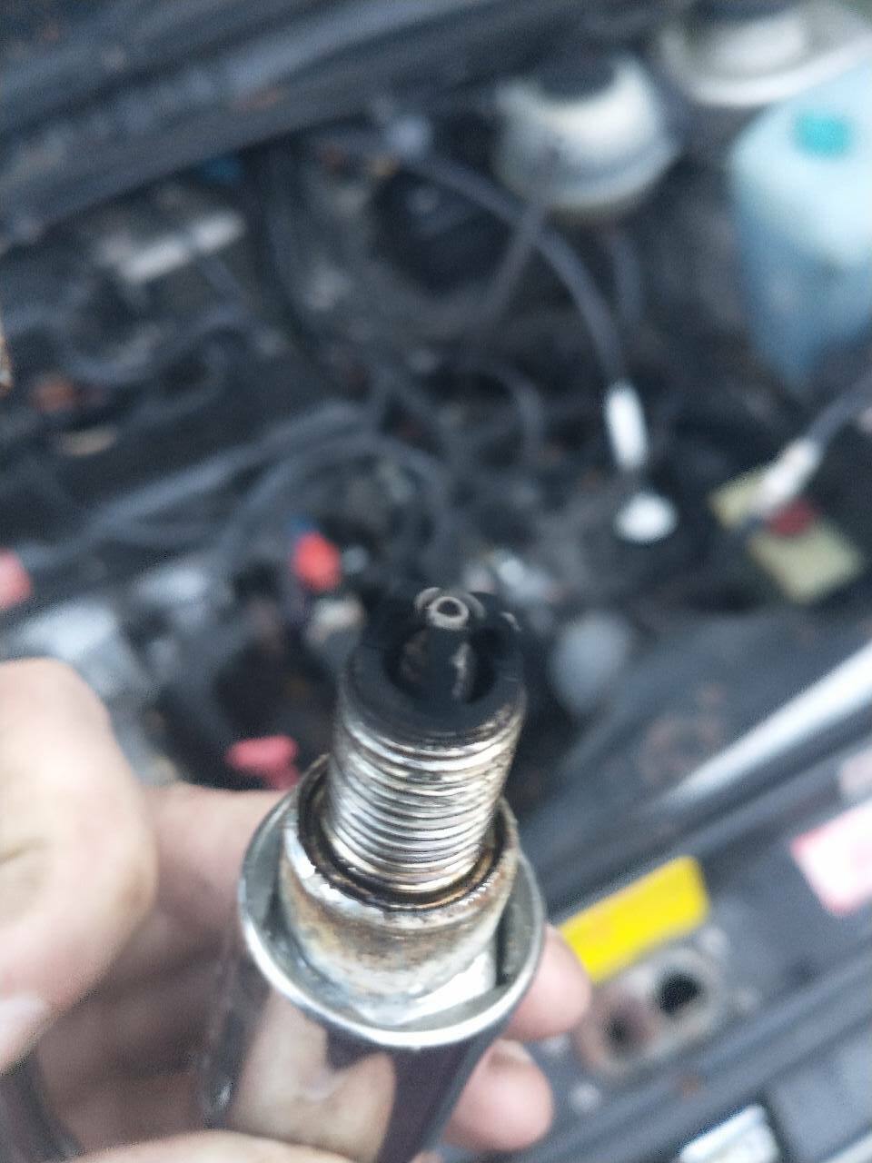

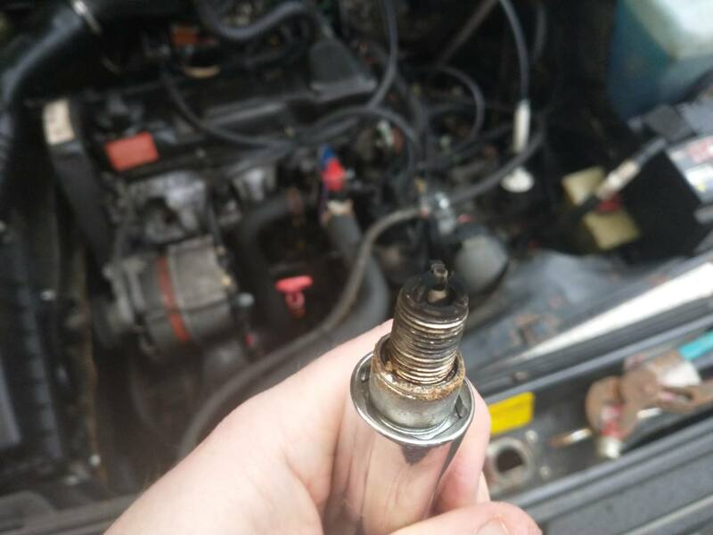

I pulled the plugs to see their condition..
That doesn't look too clever..

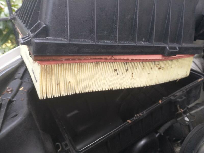

Airbox/ filter blocked?
Nup, no squirrels stashing their nuts here.

Got home and pulled a plug
Fuck

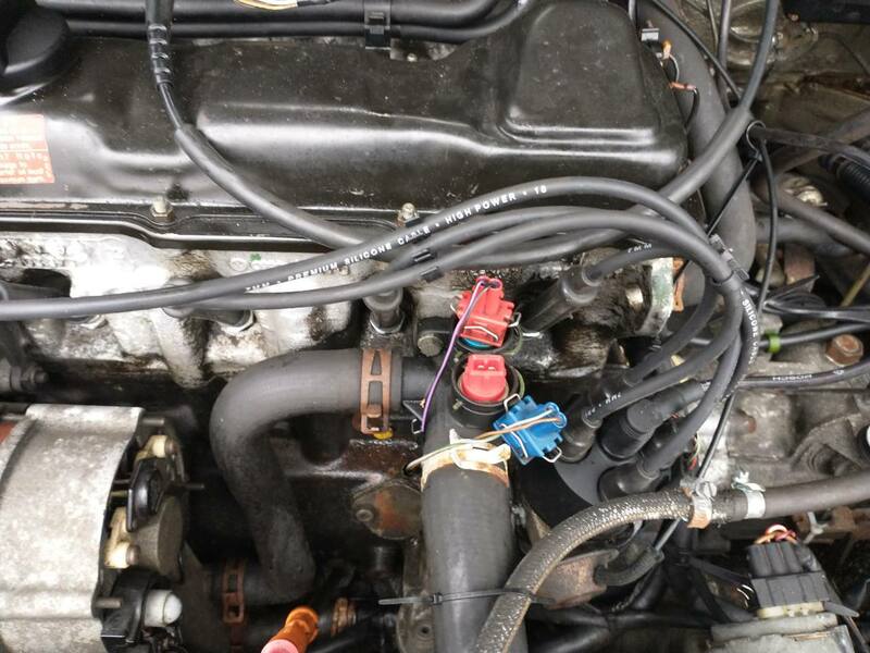

I made a call to @Mk2 Craig this evening, and picked his brains re the two main issues on this tub. Many thanks to him!
Our combined thoughts are as follows:

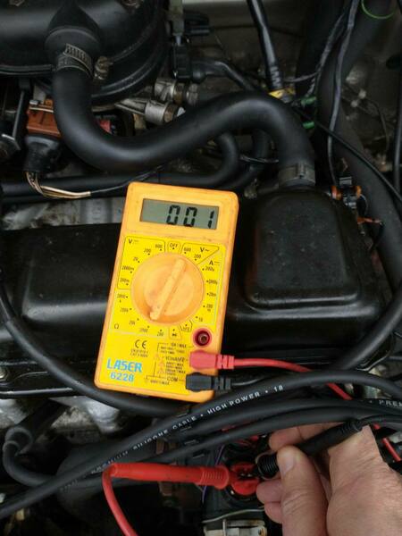

Rich Running:
Either a vacuum leak (although we would expect that to cause lean running)
Or a sensor issue. With the new sensor showing "1" when having resistance test ( like the old sensor) we suspect the sensors are both failed.
He confirmed that the wiring to the red sensor should just be for measuring resistance - so not to expect any voltage at it.
We suspect a combo of damaged wiring and dead sensor.
My next step is to swap the plug from the red sensor onto the blue sensor - it shows resistance that drops as the car warms up. If it makes the Gauge do something, we can rule out the wiring and focus on the sensor.

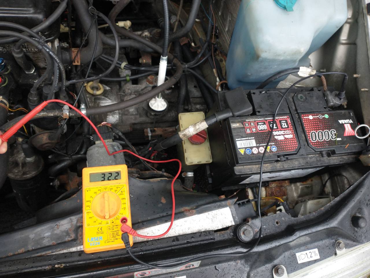

Second stab at the sensor issue today..
I connected the red plug to the blue sensor.
And ran the car up to temp. It ran rough (instantly solved with reattaching the blue connector). Needle didn't move.

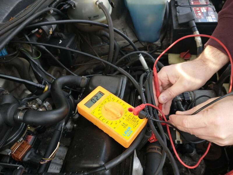

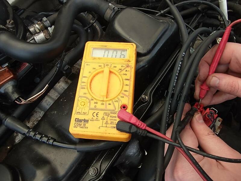

The new red sensor was tested at cold
Not much showing there.
Lastly, I grounded out both pins on the red plug to check for continuity
This is the right one
And the left
Could the differential reading be an issue?

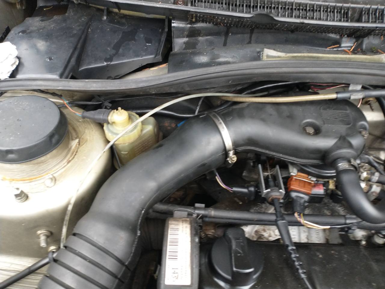

I also found this vac line hiding..IMG_20210219_143359949.thumb.jpg.a29c4d562a2104c28f06634aa48e525c.jpg
It goes to the back of the inlet hood
Thusly.
It's not a big line but it goes down to the airbox...
I don't think so.  All you are doing really is checking for continuity in the circuit which attaches to each pin, and as they are two different circuits they may well have different resistances if you earth them.
So I can assume the wires are in decent order as there is continuity?
I would say so.  In real life the sensor isn't earthing them, it is a variable resistance link between the two.
Thusly.
100% the same vac line that was not attached on the one forthcoming into my fleet. Made no difference.

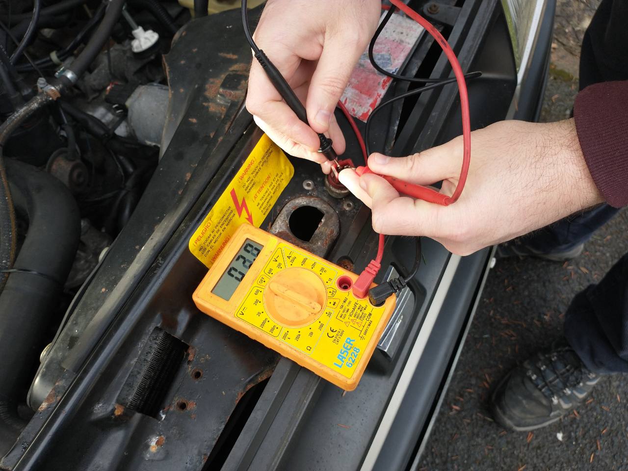

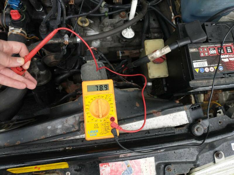

Got the two red sensors (old and new) tested cold
Old
New
That's 2.8 and 2.1 ohms respectively.
The blue one showed a "1"
I drove it for 25mins or so, then checked again..
Red
Blue
What this tells me, I am at a loss to know.

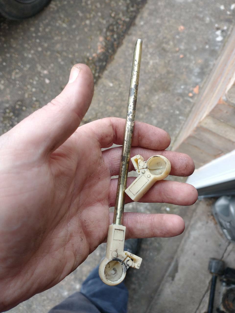

On the way back into the street, I couldn't get 1/2 gears...
Why?
IMG_20210221_114901929.thumb.jpg.86f981fcfbb47bfb7c609d954bbc237c.jpgIMG_20210221_120040885.thumb.jpg.b5442f8751a8f7d110045609267a0fd2.jpg
thats why. Selector rod had pulled out the cup.
As you can see, the end of the rod is flared
Hole in plastic not wide enough to get the tip in (🤭)
Looks to have had the plastic formed round the rod.
The rod was heated up, and pushed into the plastic. It's all back together and all gears are accessible. I'll likely buy another as a spare.

All the plugs on the throttle body were pulled, and cleaned. This was the worst.
With the car running, we then pulled one plug at a time.
The brown plug pictured stalled the car.
Two of the others caused rough running (showing the sensors were doing something)
The one attached to the Idle control valve didn't cause any change.

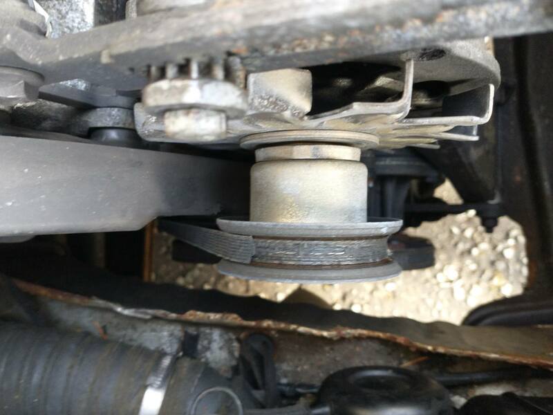

At this point the alternator belt was observed..
Fuck sake.

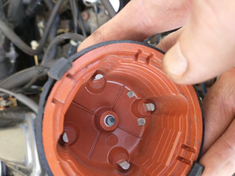

Last check was the rotor cap.
Hmm.
This came off the pins.
They were cleaned up with Emery paper. As was the rotor arm.
Still no difference.

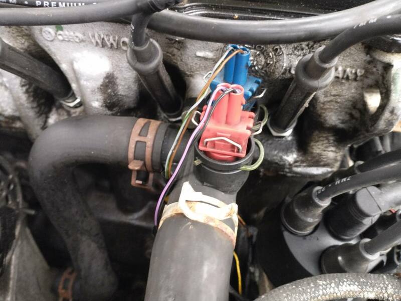

coolant sensors on vw should never show an open circuit. have you replaced both sensors with new ones?
Only replaced the red one so far. Blue one was my next port of call.
Will double check the reading at cold today. Thanks
blue feeds signal to ecu for engine temp. always replace the rubber o rings too.

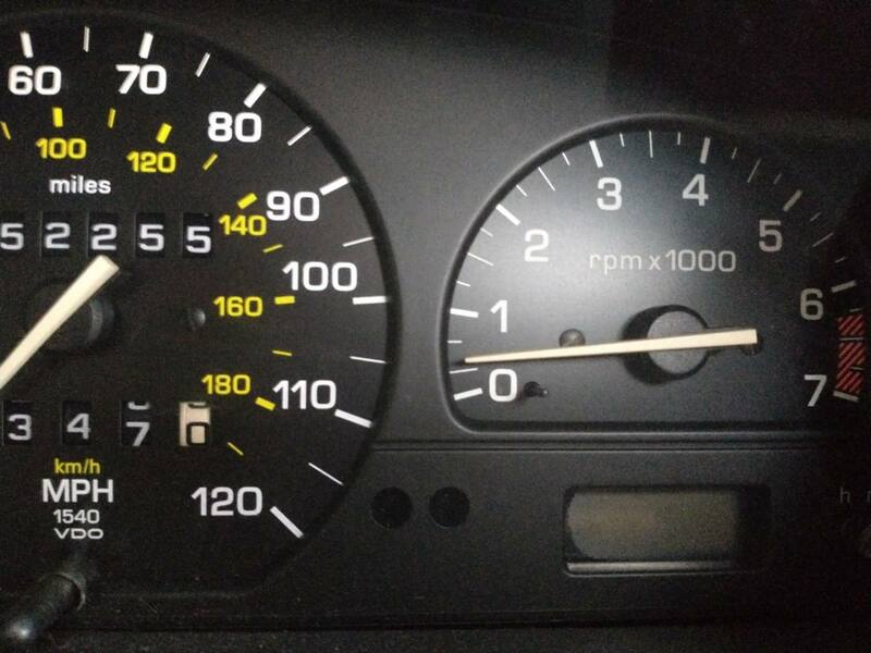

Is it worthwhile firing a new dizzy cap, leads and plugs on anyway given it looks like that caps breaking up?
Alternatively a cheap spark tester to have to hand to check what the spark is doing when it’s not idling/running right?
I got one of those online spark testers from eBay a while back. Fine for occasional use. (Not that I’ve owned a petrol in years)
Also - do you know the temp gauge works? I always thought that if a temp sensor wasn’t working in those engines you could swap plugs to test the gauge is working correctly. Assuming at least one of them is working?

  • 320touring changed the title to 320Touring's 1993 SEAT Toledo- BLUE SENSOR OF DOOM 25/02/2021
The new blue sensor appeared today.
After work, and in between showers, I endeavoured to fit it.IMG_20210225_165144705.thumb.jpg.46febd7563a7722328902753f80b022a.jpg
Looking at the colours, I dunno if this is correct.
Lads...
New one tests at 2550 ohms cold
Old one tests at 4400 ohms cold
Could it be?!
