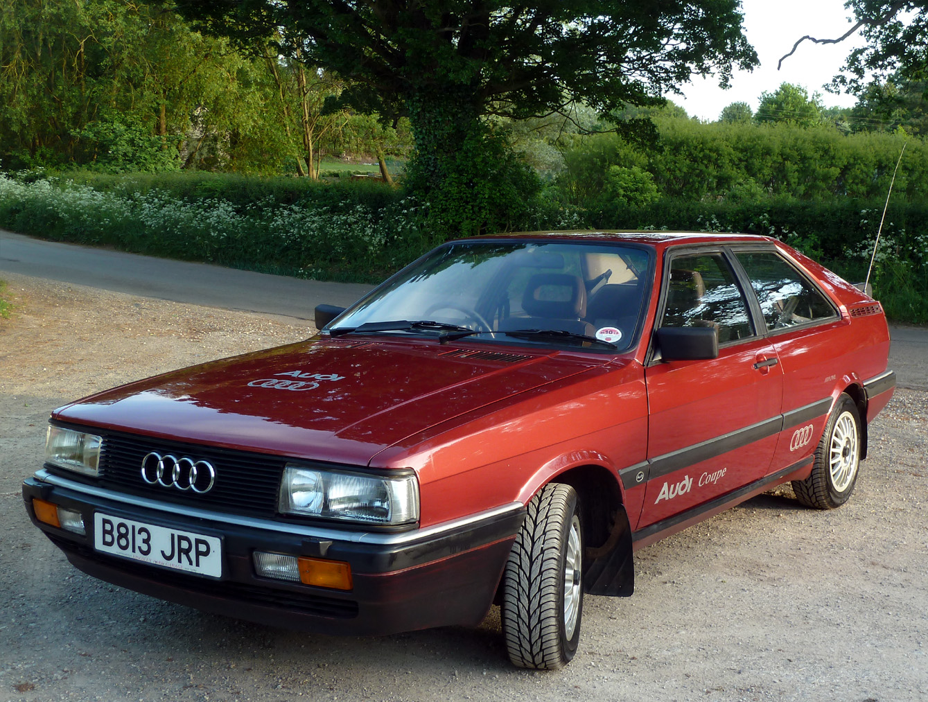

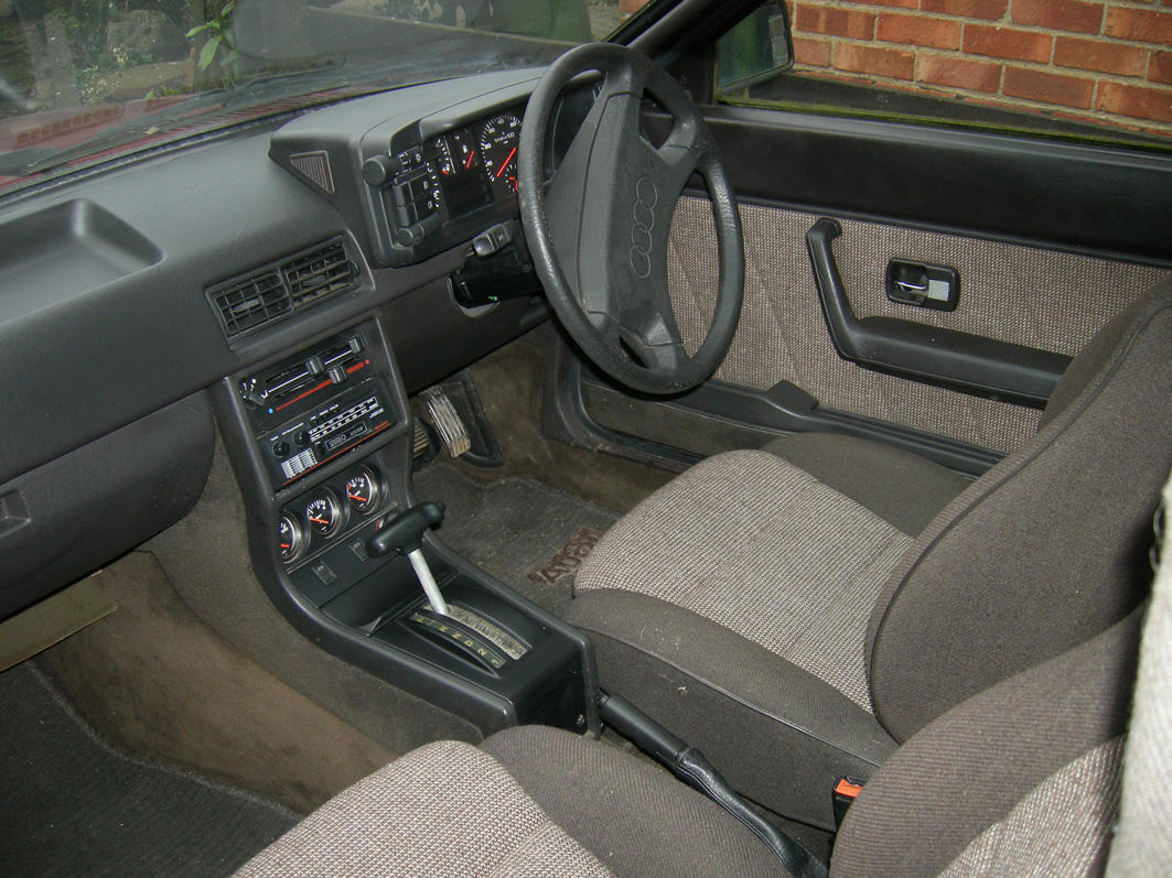

Six-cylinder Posted August 16, 2016 Posted August 16, 2016 Back in 2011 I had this lovely GT 5 pot 2 Ltr Auto and it was utterly spoilt by the 3 speed auto gearbox. It was sluggish and disappointing but the idea of changing it to a manual never occurred to me because of the amount of work, if you want a manual buy a manual. Laseraligningfoofooflanges 1

Rod/b Posted August 16, 2016 Author Posted August 16, 2016 Back in 2011 I had this lovely GT 5 pot 2 Ltr Auto and it was utterly spoilt by the 3 speed auto gearbox. It was sluggish and disappointing but the idea of changing it to a manual never occurred to me because of the amount of work, if you want a manual buy a manual.Nice, but those stickers though. Won't be so easy to just buy a manual, as this one's the only one in the country...
