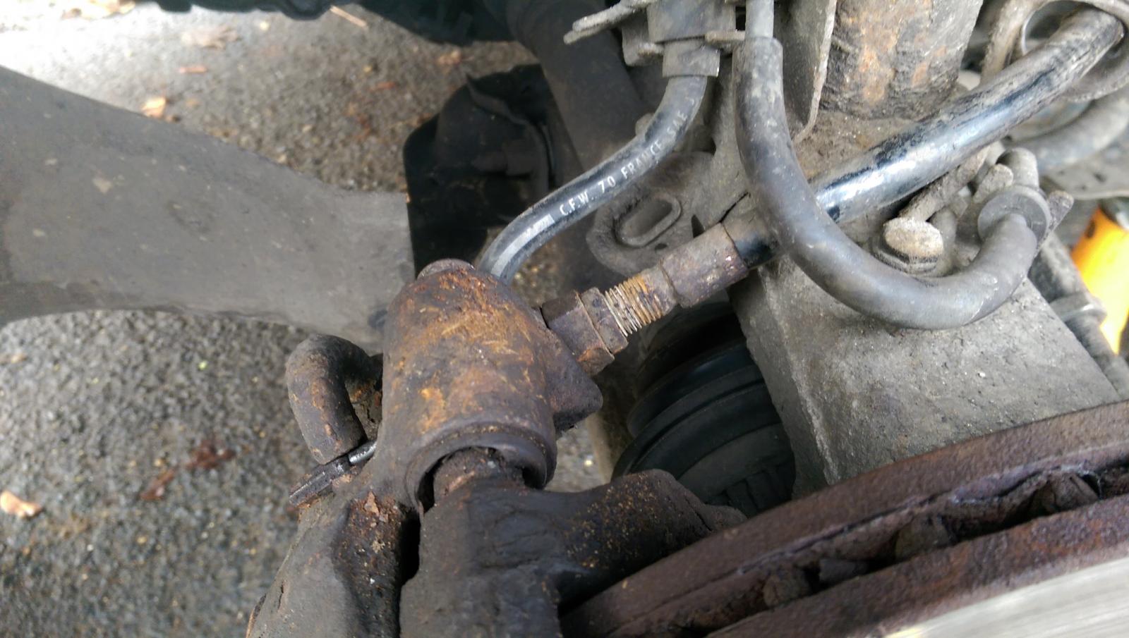

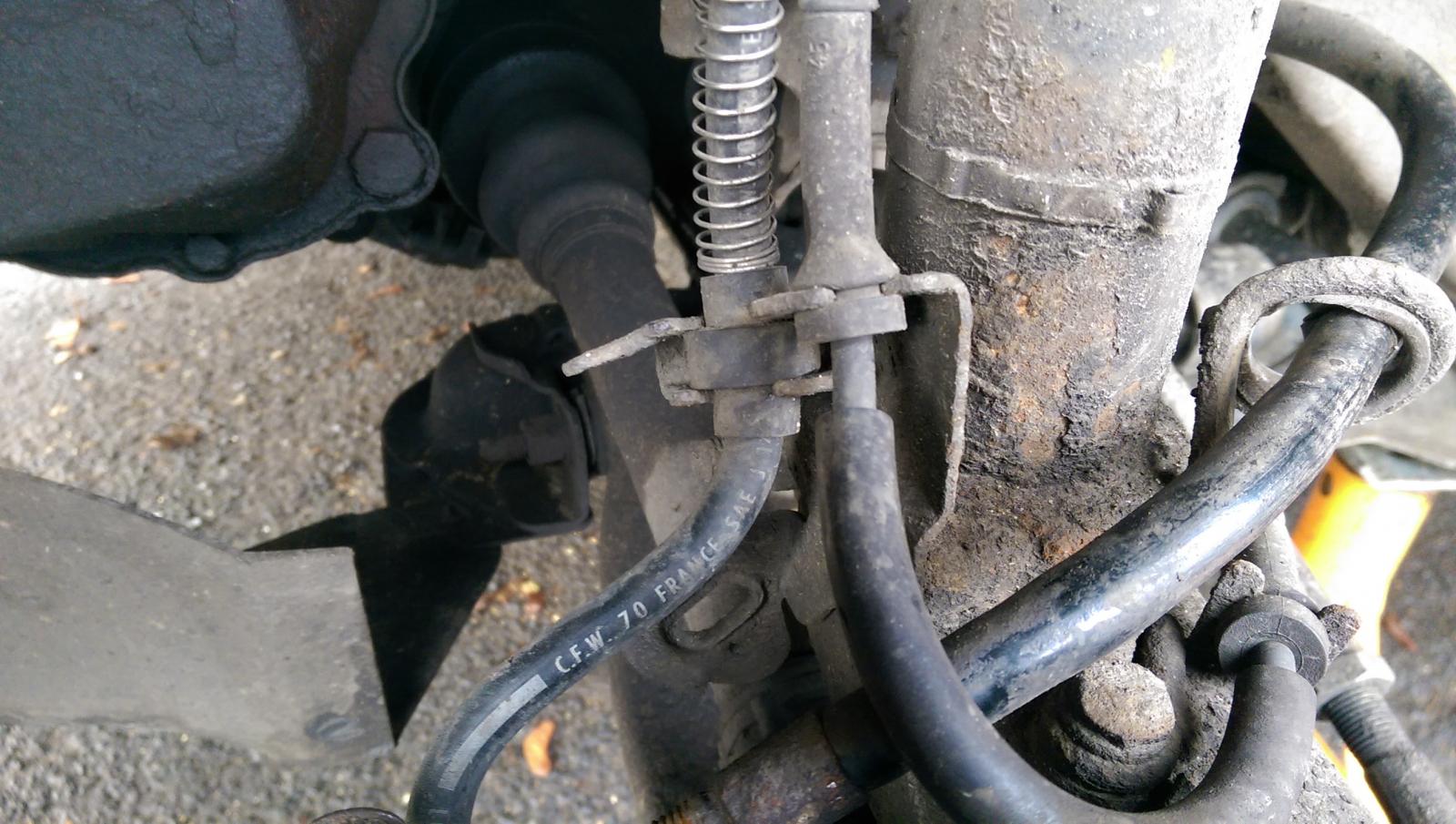

beko1987 Posted December 3, 2016 Author Posted December 3, 2016 Well that wasn't fantastic... Failures: Bloody numberplate bulb stopped working again, not too worried about thatDrivers seat insecure - it does rock alot. I'm going to take it out and see/hope something can be tightened up, otherwise I need to get hold of a drivers seat within 10 working daysParking brake lever has no reserve travel (even after he re-tested it on the front wheels). He says the lever goes right up and hits the stop, how do I adjust the cables on this and hope that helps it? Then the big ones: Exhaust noise, excessive level of smoke and excessive smoke or vapor of any colour, despite me ragging it to the test centre. I'm gonna have to grovel to my dad for the cash for a new exhaust I think, but how can I drop the smoke down? I know chompy improved the fuel pump, I think with modified innards, but can I just turn the fuelling down or summat to help it? Not fussed if I de-tune it or owt, I just want a pass! I'll need hand holding through that too as I've never done it before So, drivers seat and exhaust... buggar! 10 working days to fix for a free re-test On the plus side though, not a word was said about the rust or tyres.

Richard Posted December 3, 2016 Posted December 3, 2016 You are legal but if an accident was caused by something you've been made aware of, e.g. if it rolled away when parked, you would have a bit of explaining to do- but you still wouldn't be done for not having an MOT. IIRC the handbrake cables are adjusted under the centre console somewhere.

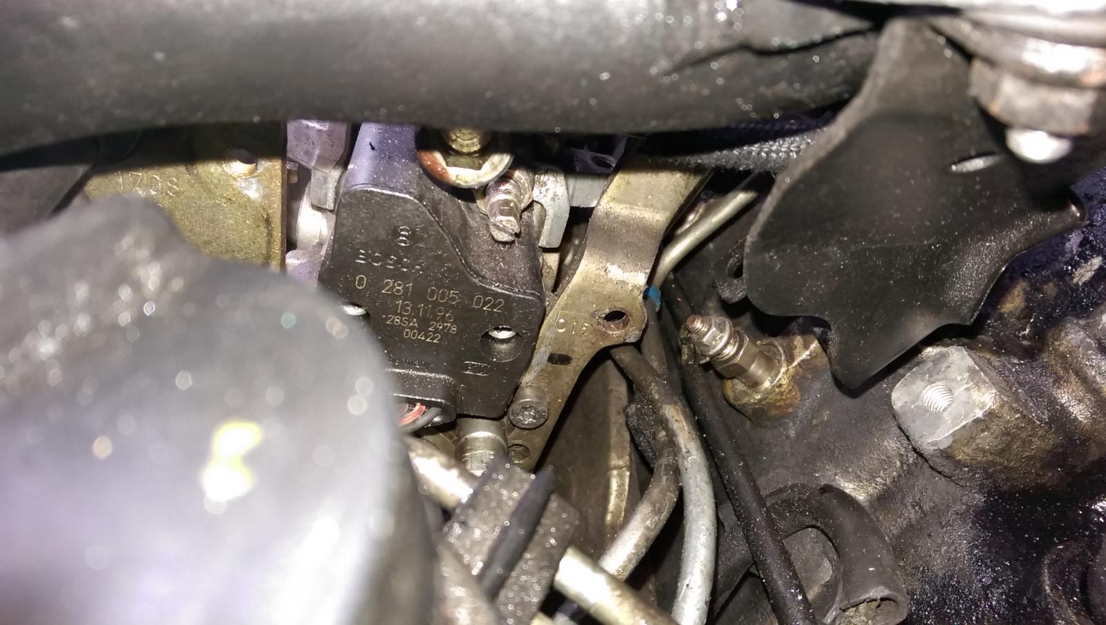

Arthur Foxhake Posted December 3, 2016 Posted December 3, 2016 Find the fuel screw and turn it out a quarter turn and the smoke should clear. It's the slotted one with a securing nut. Lacquer Peel, Dave_Q and beko1987 3

beko1987 Posted December 3, 2016 Author Posted December 3, 2016 That's my thoughts tbh. If I can dial it down a bit I'd be happy, then take it back with a new exhaust and everything else fixed and really fucking rag it and hope/run it low on derv and put 20l of veg in. Dads asked me to send him the exhaust links... Handbrake and brake pipe advisory fixed (i think, still out here but cable adjustment at the caliper has the lever to 4 clicks before it stops rather than near vertical as it was before
conkerman Posted December 3, 2016 Posted December 3, 2016 Just turn the fuelling screw down as mentioned above. Sent from my Vodafone Smart ultra 6 using Tapatalk The Moog and beko1987 2

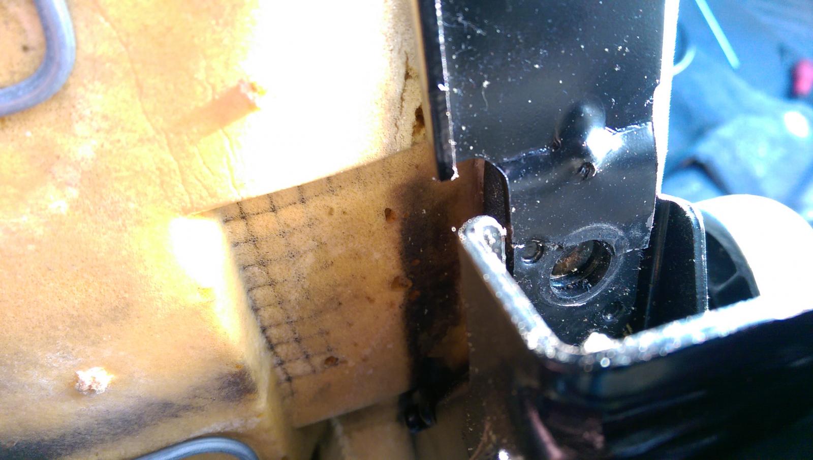

beko1987 Posted December 3, 2016 Author Posted December 3, 2016 Seat fixed, well bodged. Bloody frame is snapped on one side, 2 bolts missing and all the rest loose. Moving a bolt to the cracked side has it all held down nicely, and nipping all the rest up has improved things alot. New front seats wanted though! Having a rolly then onto fueling oldcars 1
beko1987 Posted December 3, 2016 Author Posted December 3, 2016 I can't get to the lock nut without removing this black box of wires, do I remove it or is it doable with it fitted?

oldcars Posted December 3, 2016 Posted December 3, 2016 Seat fixed, well bodged. Bloody frame is snapped on one side, 2 bolts missing and all the rest loose. Moving a bolt to the cracked side has it all held down nicely, and nipping all the rest up has improved things alot. New front seats wanted though! Having a rolly then onto fuelingYour cracking on. Could the crack be welded up, and then you would just need some bolts.

The Moog Posted December 3, 2016 Posted December 3, 2016 Fuel screw is doable without removing box of bits. Undo lock nut then turn with screw driver. The exhaust is a straight through which I don't think helps. It was a pain to get through last year. They put magic potion in it to get it through got it mega hot and then it squeaked through.
