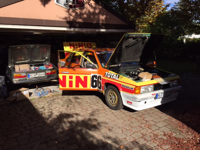

pshome Posted October 22, 2016 Author Posted October 22, 2016 Update on the Dinin Tagora PRV.Completed the engine work today, carbs adjusted, CO is fine, seems to run OK, but no road test done yet.Valves rattle a lot in spite of just being adjusted, seems a lot of dirt still in there.Cylinder 4 was giving a bit of trouble refusing to fire at idle. A shot of DOT4 into the carb sorted it with a big puff and a nice cloud, fun! Skizzer, Junkman, steve_earwig and 2 others 5

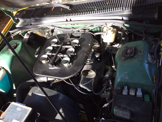

pshome Posted October 23, 2016 Author Posted October 23, 2016 Took off both covers, no signs of rockers hitting them, double checked valve clearance, all perfect, still rattles. Remember: engine has been sitting for 24 years, i am confident it just needs to be driven a bit and things will smooth out. Today's work was a bit hit and miss... Choke lever to be installed in the center console, something Talbot properly bodged. I left that job to Michael and ignored the constant moaning coming from inside the car. Got myself busy installing the airbox, trumpets, choke flap mounted on the side of the airbox and various tubes around that. Looks nice, but... .. after two hours annoying fiddling it became clear that the front end of the choke cable is the wrong position and choke would only travel half way. This of course can only be adjusted with the airbox off... Asimo, Sigmund Fraud, BorniteIdentity and 2 others 5

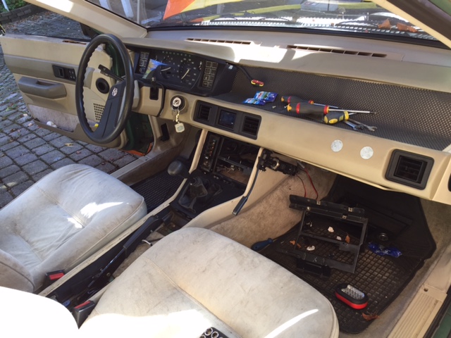

pshome Posted November 5, 2017 Author Posted November 5, 2017 Paul, the Dinin Tagora got a new look, engine and drivetrain, but still has its shabby interior with integrating door boards, crumbling or missing plastic all around, cracked seat covers and a roof lining fastened with pins. Time to use the sunny autumn days to replace the interior with the good one we saved from the Tagora SX that donated the V6 engine. Paul's interior is quickly removed, and the first step is to replace the stained beige carpet with the freshly washed grey one from the donor car. With a little jerking and pushing, it's in, that was an easy start. We continue with the dashboard, looks like a lot of work, in the end it was done quickly. Loosen the steering column, a few screws, the cables are all fitted with plugs and that's it. The freshly polished centre console and the steering wheel column trim complete that day’s work. The roof is more work, the old one falls down on its own, the Gauls' fear of this danger is absolutely justified. Since we had the cardboard braking into parts when doing Theo’s (the golden Tagora) roof, we decided to leave it in place this time. Gets just a good brushing so that the new cloth will stick. The new cloth will just be glued onto the board while in place. The seller assured me that the special padding adhesive does not penetrate and cause ugly stains, as it unfortunately happened with Theo. Looks good! Next step: the roof trim. It’s made out of brittle plastic that loses all elasticity over time and breaks if you only look at it. Even with the all the bits we have saved out of four different Tagora, a complete set can only be assembled after gluing some broken parts together. After all, there's nothing missing, that's worth a lot. The mends are reinforced so that they do not break away again when being installed.. A can of spray paint ensures uniform grey. Of course, it didn't go well, three mends turned into five at the end. Next time I'll be gluing reinforcing plastic strips all around before I start the installation.Many hours and curses later everything is fine.Finding a complete set of unbroken handles (made out of unobtainium) in my parts bin lifts the mood enormously. The next step is the hat rack, fresh imitation leather straight out of Ebay lets the sunburned part shine in a new brilliance. The seats urgently need a deep cleaning with carpet foam which also chases the rather unpleasant smell. The headrests look particularly bad, one of the previous owners was apparently a bulk consumer of hair pomade. At the end of the day everything is as good as new and the seats invite you to a comfortable ride without having to worry about getting a skin disease. The thoroughly cleaned door panels and side trims are ready for installation. A strip of adhesive tape prevents the upper edge from fraying and facilitates installation. Looks good! Finish line: Instrument panel, on-board computer and a new cassette radio find their place. Now Paul is a real SX with a height-adjustable driver's seat, headrests at the rear and an additional cigarette lighter for the gentlemen in the rear seats. Sigmund Fraud, Sudsprint, cort1977 and 20 others 23
