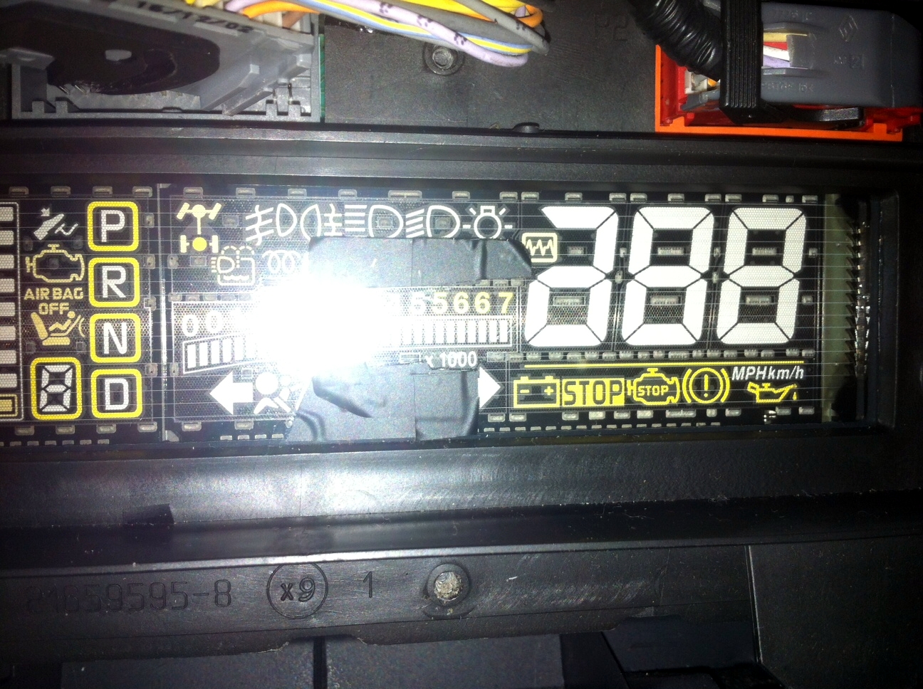

Yep, not one but two pieces of electrical tape.  The upper one covering the "SERVICE" light and the lower one covering the airbag, ABS and traction control lights.  Whoever did it thought carefully about the parallax effect from the driver's seat - in the photo it looks like half the right-hand indicator tell-tale is covered, but it wasn't.  In retrospect, however, I realise the upper piece of tape was obscuring the bottom quarter of the sidelight and dipped-beam telltales.
The upper dashboard is fairly easy to take apart (missing screws from Billy Bodger's tape escapade helping me) and, once the tape was removed, it turns out that all warning lights operate as intended.  I can only assume that at some point in the car's past, an issue caused certain lights to come on that a previous owner decided to 'solve' temporarily, then the issue was solved properly but the tape was not removed...
Fingers crossed that when the MOT comes round in February I don't need to put the tape back.

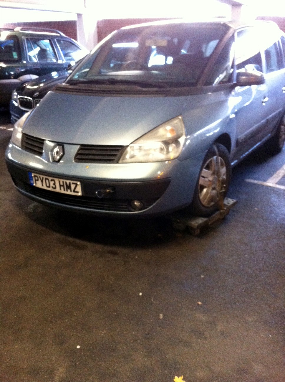

As you may have seen in the GOM thread I had some fun with this today. Reversing into a space at a central Reading multi-storey, I heard a loud 'clunk' from the front and suddenly found that the car would not go where it was pointed. Pulling forwards and then trying to go backwards again, it felt like the car was trying (and failing) to mount a high kerb.

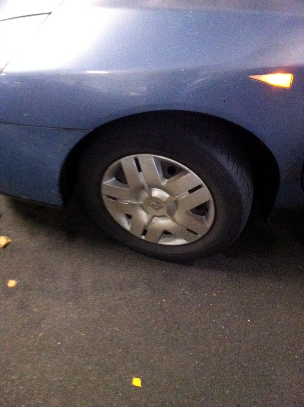

Getting out, here's what the offside front wheel looked like:

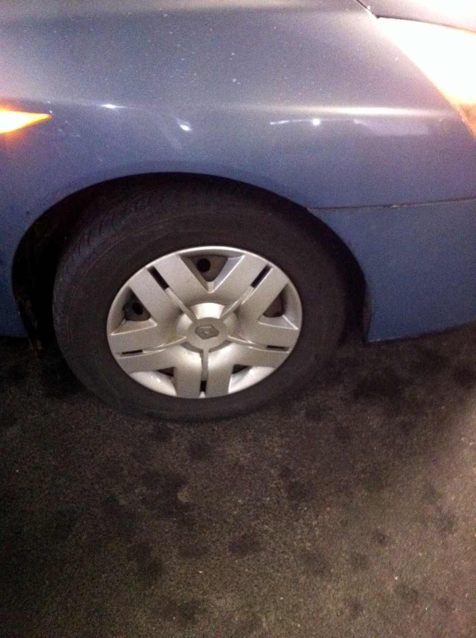

But the nearside looked like this:
Oh dear. Only the offside responded to steering input.
I called AutoAid, who amazingly recognised my membership number this time, and a nice man from Ravenscroft in Fleet appeared quickly. He diagnosed the inner tie rod had pulled out of the rack, and it looked like it was cross-threaded. He fished out a skateboard so the car could be pulled out on a rope:
Thankfully there was enough headroom for the Transit. Once it was through the exit barrier it was winched onto a flatbed and I did the 'trip of shame' to my local garage. That's the third time in the last five months one of our cars has arrived there on a flatbed (the second time for this one).
Thankfully they were able to get it up on a ramp straight away, replace both tie rods and track rod ends, repair the rack thread, and then sort the tracking again so I was able to pick it up this evening.
They'd never seen anything like it and thought I was a very lucky boy indeed. It's not possible to prove, but they did wonder if the previous tracking adjustment a month ago (see above entry) may have caused or accelerated the issue. On the drive back the car does seem to drive a lot better with much less corrective steering input required; before it felt like the front dampers were past their best, and I did wonder if the rear beam was bent (there's nowhere to jack the car except the jacking points which leaves you nowhere to put axle stands - the workshop manual states dire warnings) so I wonder if this has been building up for a while and causing 'bump steer' issues. Time will tell. The front tyres, especially the nearside, are badly feathered on the outside edges (less than 20% of the tread width thankfully) so will also be interesting to see if that doesn't get any worse. At least I am getting better at judging the width and no longer clouting width restrictors.

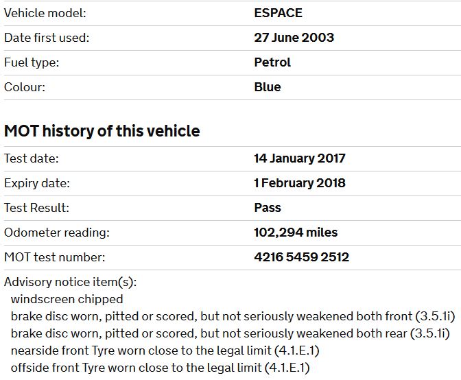

The first MOT took place a week ago; all was going fairly swimmingly (my usual tester - stern but fair - commenting positively on the condition underneath) until the n/s front was jacked up and waggled.  The balljoint was absolutely knackered - that would explain the wandering steering then.  Extremely embarrassed about not investigating it myself, really.
So another £272.10 (for the MOT at full price, a complete nearside lower arm and labour) brings us to a repair and maintenance cost of just over 30p/mile - still harrowing.  I'm hopeful the next few months will be relatively cheap - but fate has a funny way of pissing on your chips, doesn't it?
