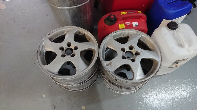

new* wheels curtesy of a AS Volvo licker have been waiting for attention. One of the recent bits of serendipity in my life has been our new unit, which is between a friendly drifting mad mechanic with a decent tyre machine to appease his habit and a wheel stripping place. You can guess what’s coming.
These turn into these
and are given to the stripper.
black or silver is the current problem. Silver winning, marginally.
Silver, or gun metal grey. Black wheels look shit on everything

the masses have been heard, ral 7015 slate grey ordered.

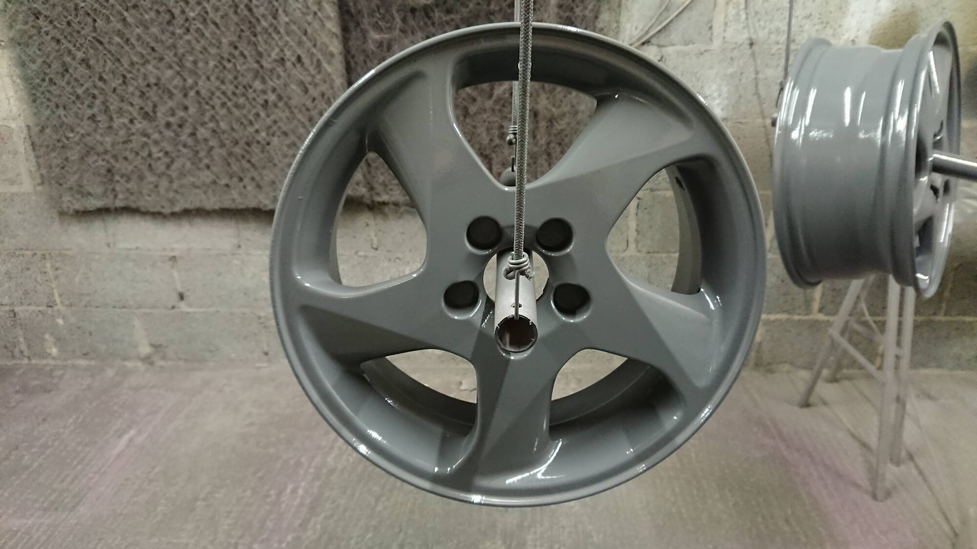

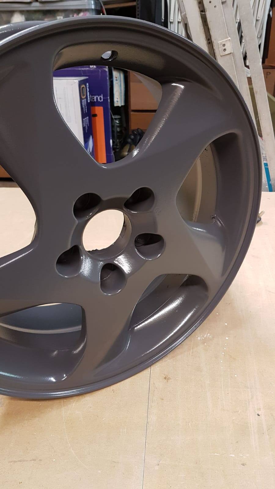

The moons of Managing to get the day to myself and the spray booth being empty aligned. Hurrah. (Although I should have been working, but am not due to payment being viewed as optional. Happily this has caused chaos, I was booked elsewhere all week by 9.30, missed from site by 11, the money was in bank by midday and he’s got all week to think about his actions)
Get the new wheels gurt lush. It’s bad form to paint the clamping faces (paint melts when it gets hot reducing the clamping force as it gives and then acting as a lubricant), so mask them off.
Then wash with thinners, hang and hit with a decent coat of etch primer.
Looks promising. Doesn’t take long to dry, then rub back with red scotchbrite (cos the grey scotchbrite cupboard was bare), air wash it down then a grip coat
which was far heavier than intended, then a heavy heavy topcoat.
the colour is all washed out and wrong in this photo as it’s under proper bright led strips. It’s darker than its showing and will darken a bit more as it cures. I think it’ll be an ok colour on the car in daylight.
thats the worst wheel above, which was also found to be slightly beaten up, (so will go on the back) so I’m well pleased with the finish. Can always change the colour later!

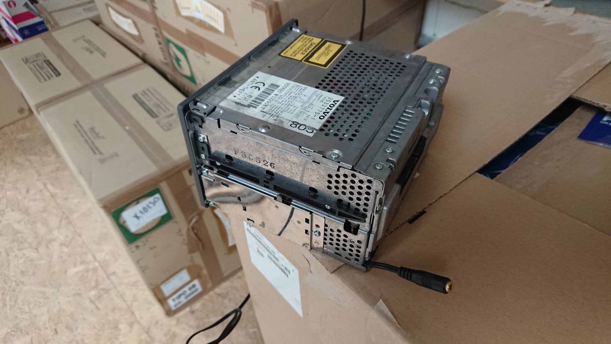

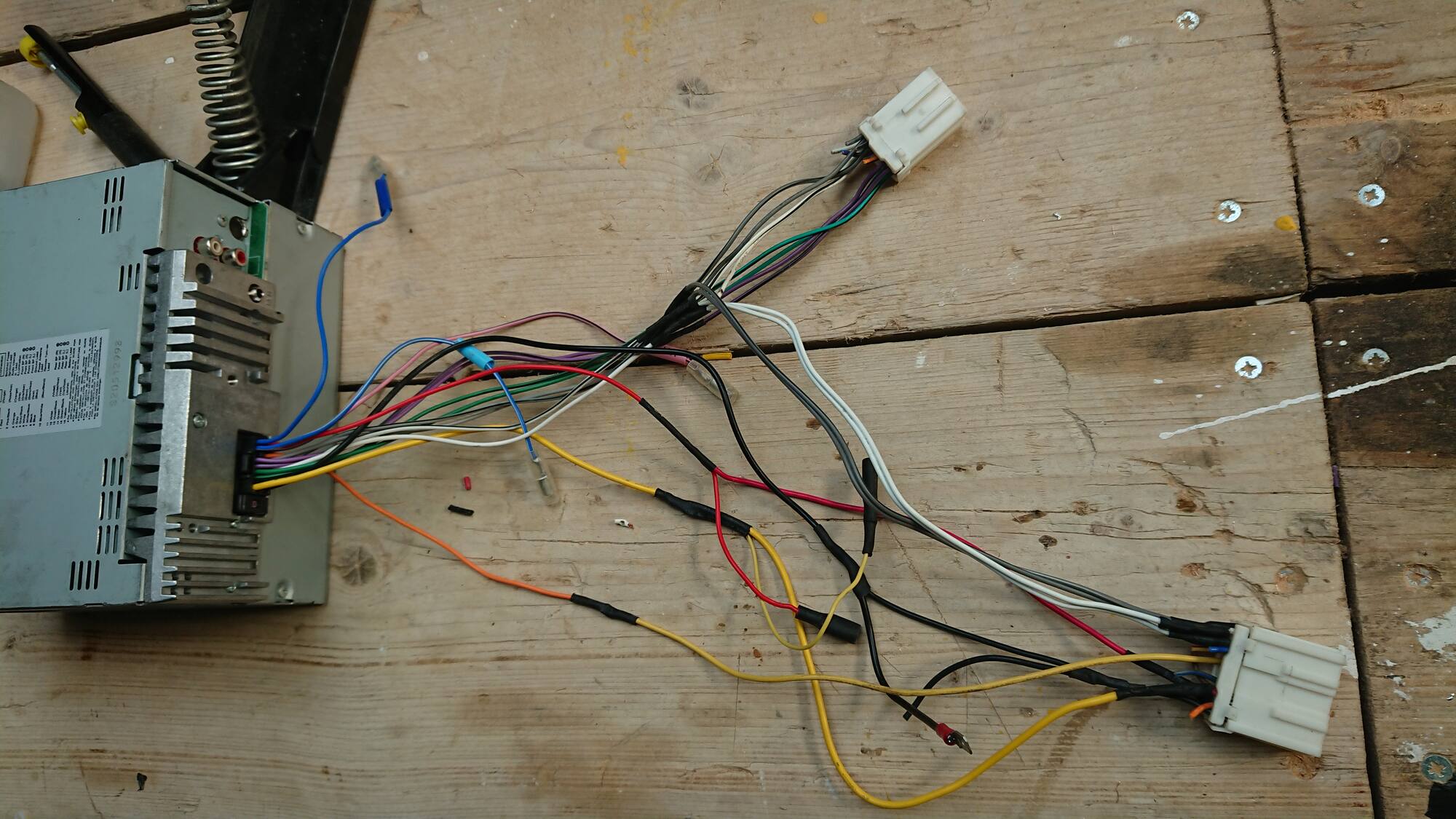

the ICE has been upgraded baby. But fuck me what a palaver. I’m normally not to bad at lectrics but this somehow ate about 20 hours of my life. Every twatty little hitch. But it’s done, is nice and tidy and works well. Anyone got a cheap sub?
Its in to Tom next door for all new belts and tensioners today. A real birthday job. Popped in and was presented with the crankshaft pulley.
Not a lot of life left in that! Water pump and Crankshaft oil seal were also leaking
Other than that nothing too scary has been reported but it’s feeling like a preventative maintenance win for me right now.
That first picture is what I think the monster under my bed looks like!
There’s a YTHO in there somewhere
2 hours ago, sutty2006 said:
That CD player looks smart in there!
I was well pleased with it despite it being the result of a fuck up.
Was worse than that. At least 2phone kits were hidden in there as well. Spliced adapter loom city.
I started with the pure digital kit which i knew needed an aux input on the head unit which I knew didn’t have one, but that was fine and dandy as I’d read about the sc80* aux hack.
carefully opened the head unit, split it apart and soldered in an aux. Very pleased with myself.
Test installed with jury loom and it’s utter gash. Anything on the aux channel is horrendous. Must have ballsed the soldering, so dismantle and reassemble, except mr ham fisted twat here manages to peel the conductor strips off from the base of the ribbon cable at the end. Reinstall with no cd just to see and it’s the same. Turns out you can’t hack an input on the sc805. Should’ve read more first.
Gumtree alpine double din does look lush (and it appeals to the teenager in me) and was cheap. But had no cage and also pointed out that Volvo has a slightly different idea of double din to alpine, so despite being wedged in with blue tack it also needed a rib hacksawing off the dashboard. And came with yet another different fucking loom.
still, got it in and all’s good. Drive home basking in high fidelity paradise. Turn off the headlights and the radio dies.ffs.
Somehow the dash illumination feed had become the switched live, and the switched live was to battery. Rewire, again. Hooray, better? Power sorted but sound gash on the digital radio again. I cannot communicate how much that pissed me off. So I ignored it for a week, then pushed the aux in Jack on the headunit fully home, and wadda you know, sorted. Ffs.
what a palaver.

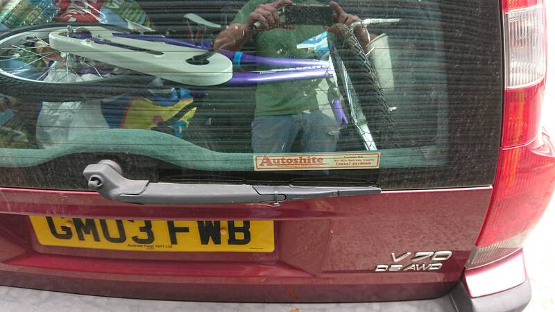

I think I have a problem. But first, good news. Picked up my shiny new wheels.
and they look lovely, and also look as if they will look ok on the car.
But look closely. Not that car, oh no. You see this is my problem,
I think I've become a volvo licker. It's a posh one too.
All the better for dragging tatania and her pony across that damp field. And known for being a touch problematical. For added explodey shite points its also the geartronic gearbox. Which has a judder in reverse and bangs and surges on changes going forwards.

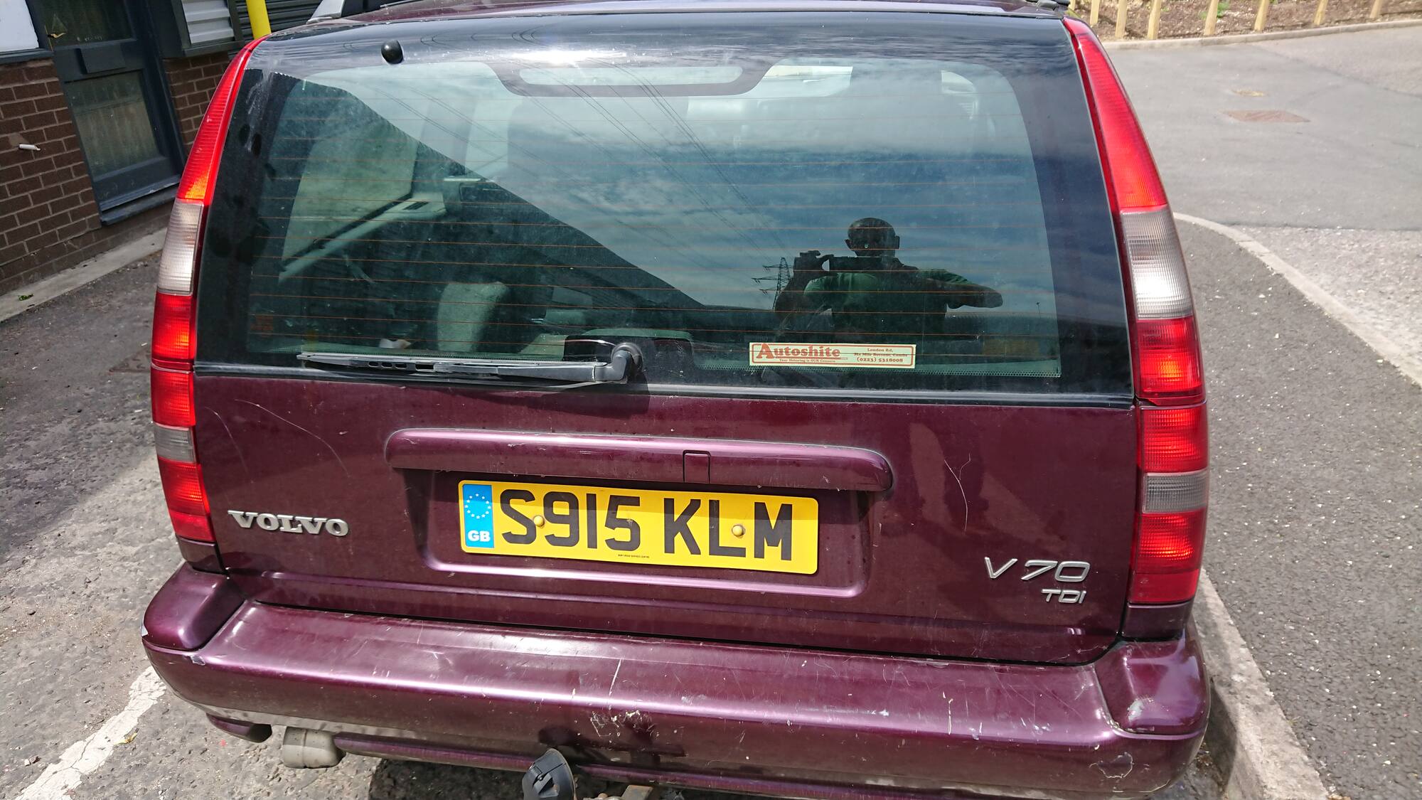

Life has a sudden new difficulty. “I’m taking the Volvo” “which one?”
The Throbber has now become the de facto name for the old(er) one. It certainly has a certain ring to it.
Anyway, whilst I’ve been distracted with the new(er) one The Throbber was placated with a Super Tom fitted full belt, idler, crank puller kit. All Kwality Kit as well. Surely a good enough gift?
No. The Throbber was a total bellend about it and refused to time up so it didn’t sound like a skeleton wanking in a biscuit tin. Tom took it back apart, counted teeth, measured lengths, borrowed another set of locking pins incase his were somehow screwy. Totally threw him, until he got the dial gauge out and spent a few hours forensic mechanicing.
The Throbbers dark past has come back to haunt it. The engine is (to some extent) a bitsa. There is a mix of Volvo and VW pulleys on the camshaft. And contrary to popular belief we now know that they are not, quite, the same. The position of the timing mark relative to the pulley keyway is different between VAG and Volvo. You bitch.
Our assumption is that the old belt went on following a cambelt break / pump seize / head smashing episode. Any previous owners able to shed any light?
and speaking of previous owners, I paid sutty 600 quid for The Throbber...
Ouch. You bitch.
Still, now it’s good for a few years, and strong enough to support some tuning goodies. Happy days.
