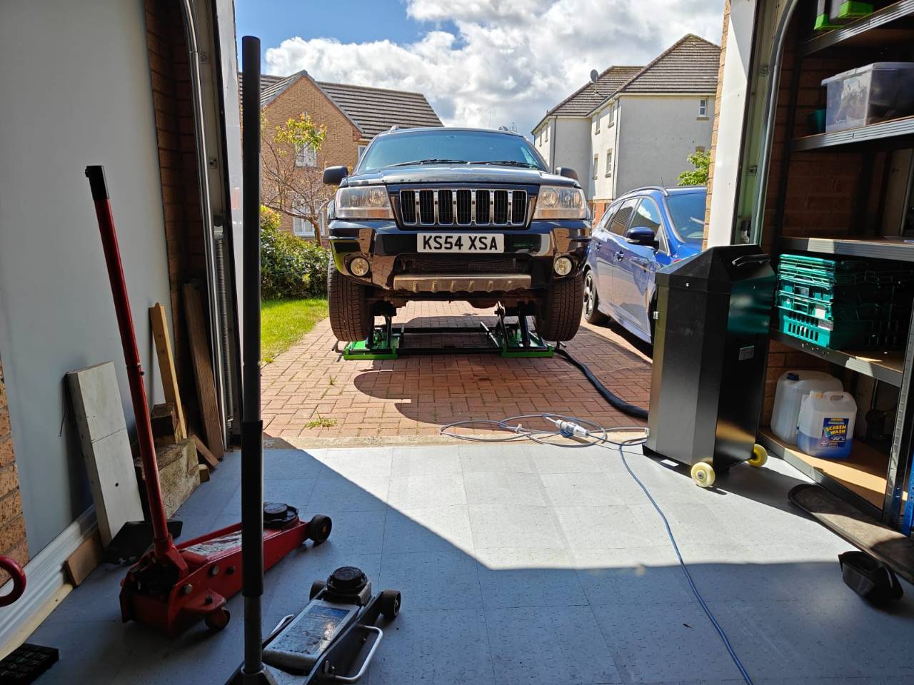

Today I got under it and gave it a poke around.
Grease nipples
Greased! For probably the first time ever. Note my Bilstein shocks, because RaceHeep
It also got an oil change-handily I had 5w30 in stock and my Halfords trade card gets me Euro Crap Parts stock at bargain prices-£7 for a Mann filter was pretty good.
The transfer case has a leak and the fluid level is low so I've ordered up the correct stuff after cracking off both fill and drain plugs.
The power steering doesn't feel great so I've ordered the correct fluid for it to flush the system out. I've a hunch it's had ATF put in it which it shouldn't have.
Other than that it's not bad underneath with nothing obviously fucked. It feels a bit vague to drive but I have been mostly driving pointier stuff recently so I guess that shouldn't be a surprise. I might get alignment done as the wheel is off centre. It does drive straight though. The MOT is until January so I'll let it earn its keep a bit and get it through a test before doing too much else to it. A brake fluid flush and new rear springs and shocks might happen, as might some new bushes to tighten things up. There are none particularly bad but most of them look original.

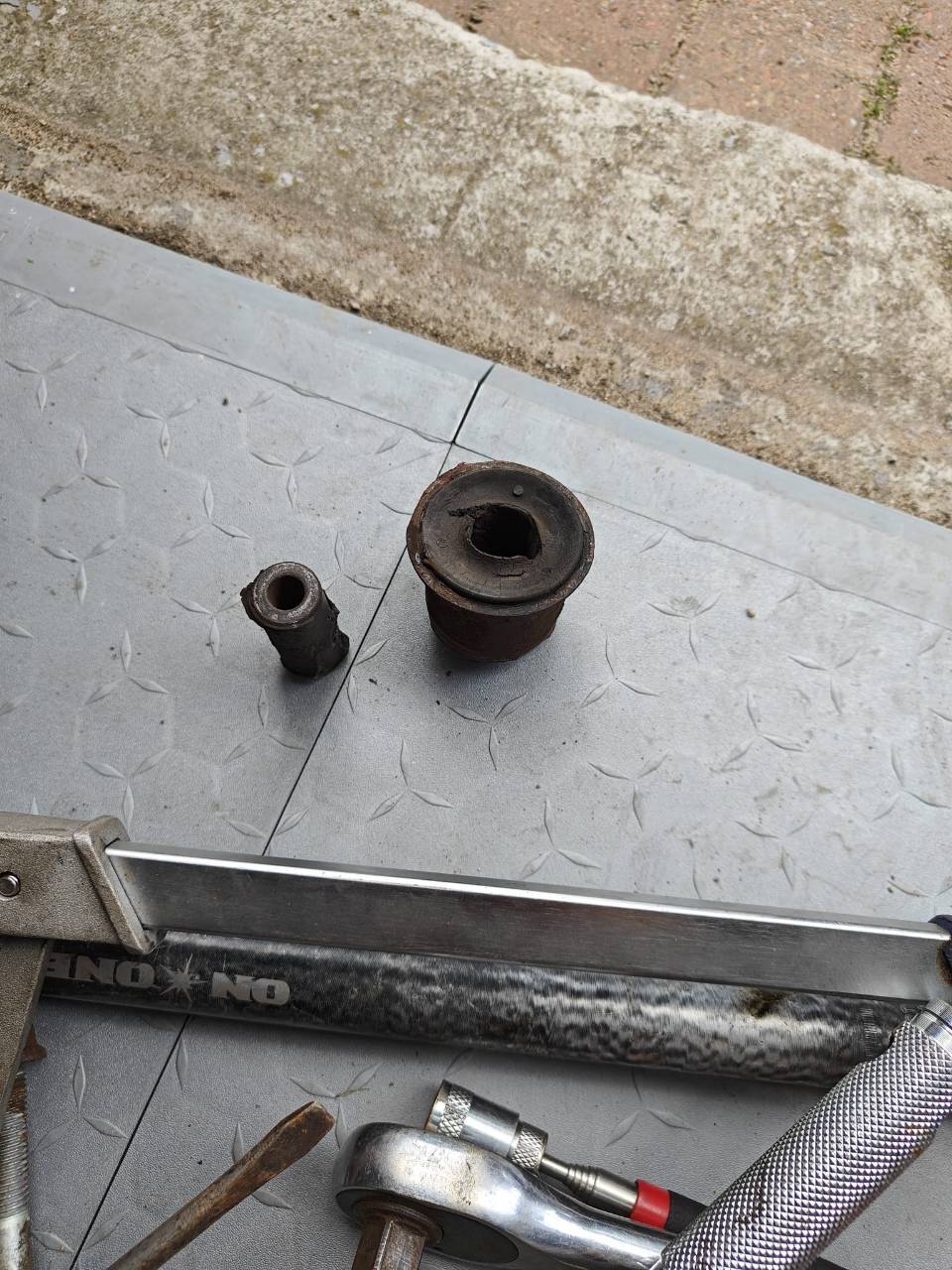

It's at this stage just now. Everything old is off it and I've fitted a new caliper and disc to one side.
The old springs were definitely passed their best, with the weight of the car on them there was a noticeable bend in them. They had this "hockey puck" lift which consists of runner spacers to jack it up. As the new springs have a 1.5" lift to match the front they're a bit longer.
Might be fun getting these in.
That's where it's at now. I've ordered a new brake line to replace the really crusty one in the pic above.

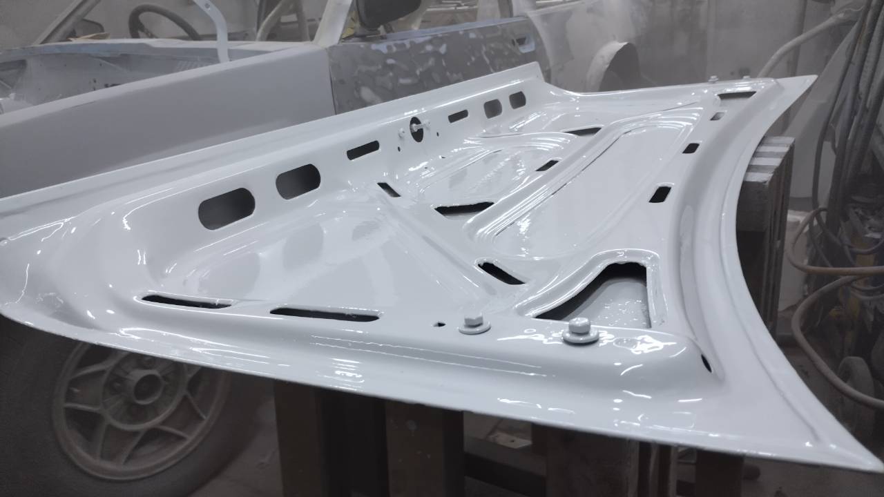

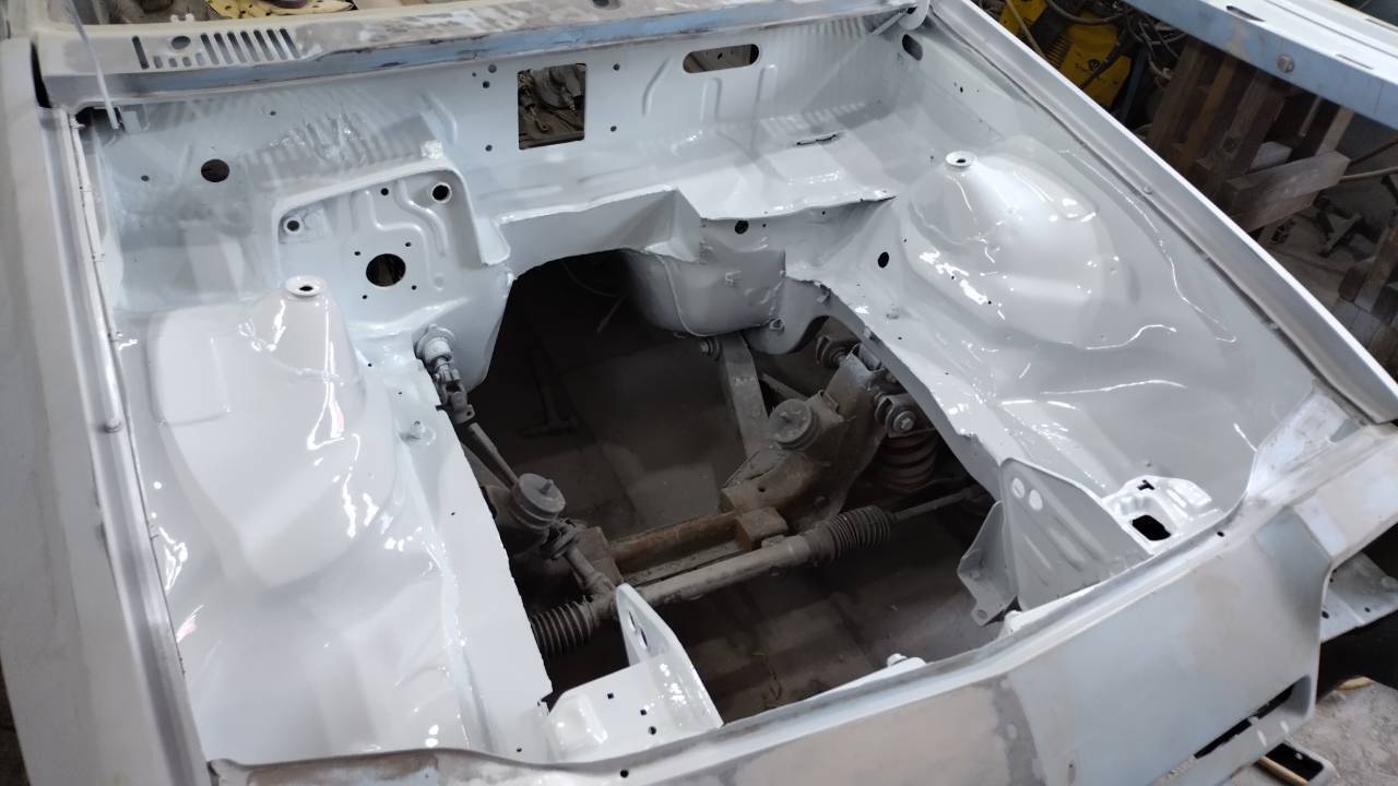

Couple of Manta pics.
Just doing tons of bodywork.
IMG_20240222_100501.jpg.4de996b5e8884e3f9bc481d2b4d67787.thumb.jpg.d172c1dc8359e829132e5d71c4a1d73a.jpg
IMG_20240222_100456.jpg.b5f39bedb719794957b15c6b7c465482.thumb.jpg.6ffae1abf0f2c0d39d53780e7d2ed30a.jpg
Test spray of the colour on the boot.
IMG_20240223_120014.thumb.jpg.a51fa3b8fefabce4f3e6c31c77259ee7.jpg.e7cde78cf2850b2069511adc1ff3dcab.jpgIMG_20240223_120034.thumb.jpg.90e241c1651f4991a9755455eaa4a581.jpg.28f7a6b455ab9714e187c8ad0a59b0fe.jpgIMG_20240223_120115.thumb.jpg.040d86d56d1e20e168747198c32130f9.jpg.676f2ea7ee2fd0340f399ed925d9a088.jpgIMG_20240223_115957.thumb.jpg.51b35f90b38310be9933920a5d880d97.jpg.cd4b51135229b036b11d528e5d4427b6.jpg
Quarters are body worked ready for the kit to be bonded on but I need to wait till  @dome is here so I canny be blamed for any squinty arches.

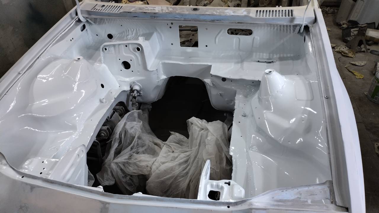

Doors are all prepped and in primer with the rears ready to spray on Wed or Thurs.
Engine bay and all the inner arches should be white before middle of next week.

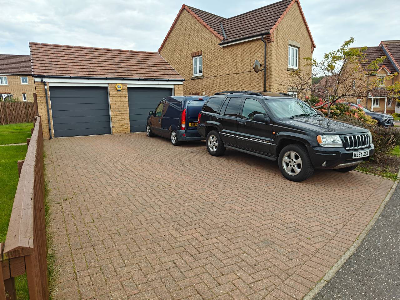

Yep, we've moved in. House prices have lowered significantly with the addition of these two to the driveway.
And talking about lowered, the Kangoo was worked hard.
No officer, I don't know why it's dragging its arse along the road🫣
More importantly, I've treated myself to a new toy for the garage...
Yet to be used in anger but it's going to be a game changer I'm sure.

So, after a month of settling in to the new house it was time to get back onto fleet maintenance.
The Heep has had a slightly wayward feel to the steering which I tracked down to the 2 bushes which secure the front axle to the upper arms. The sort of job that would be a pain in the ass without a lift of some sort...
Turns out having a lift just makes it easier to get to the hard bit 🤦‍♂️
To be fair, the first bush wasn't too hard to get out, although I spent fucking ages trying to find the correct size of sockets/nut and bolts and random crap lying around the garage to make a press of some sort. Handily this one was fucked so it came out relatively easily.
Aye, that'll be fucked.
I soon worked out that the new one wasn't going to go in easily so picked this up on facebook marketplace.
This made things a lot easier for getting the new one in.
The socket in the picture is stopping the two flanges from getting pressed together when pushing the bush in. Great* bit of design there.
At this point sadly the success ends. The other bush, which to be fair wasn't nearly as bad, refused to budge. Conscious of having a dead Heep on my drive and also of the worrying amount the front axle moved when you undo these arms I decided to play safe and leave it as it is.
Here's me using a ratchet strap to drag things back in line. I ended up lowering it down on its wheels(carefully!) and everything lined up.
 Great* fun
It definitely drives better now so I'm calling that a win. The other bush can wait.

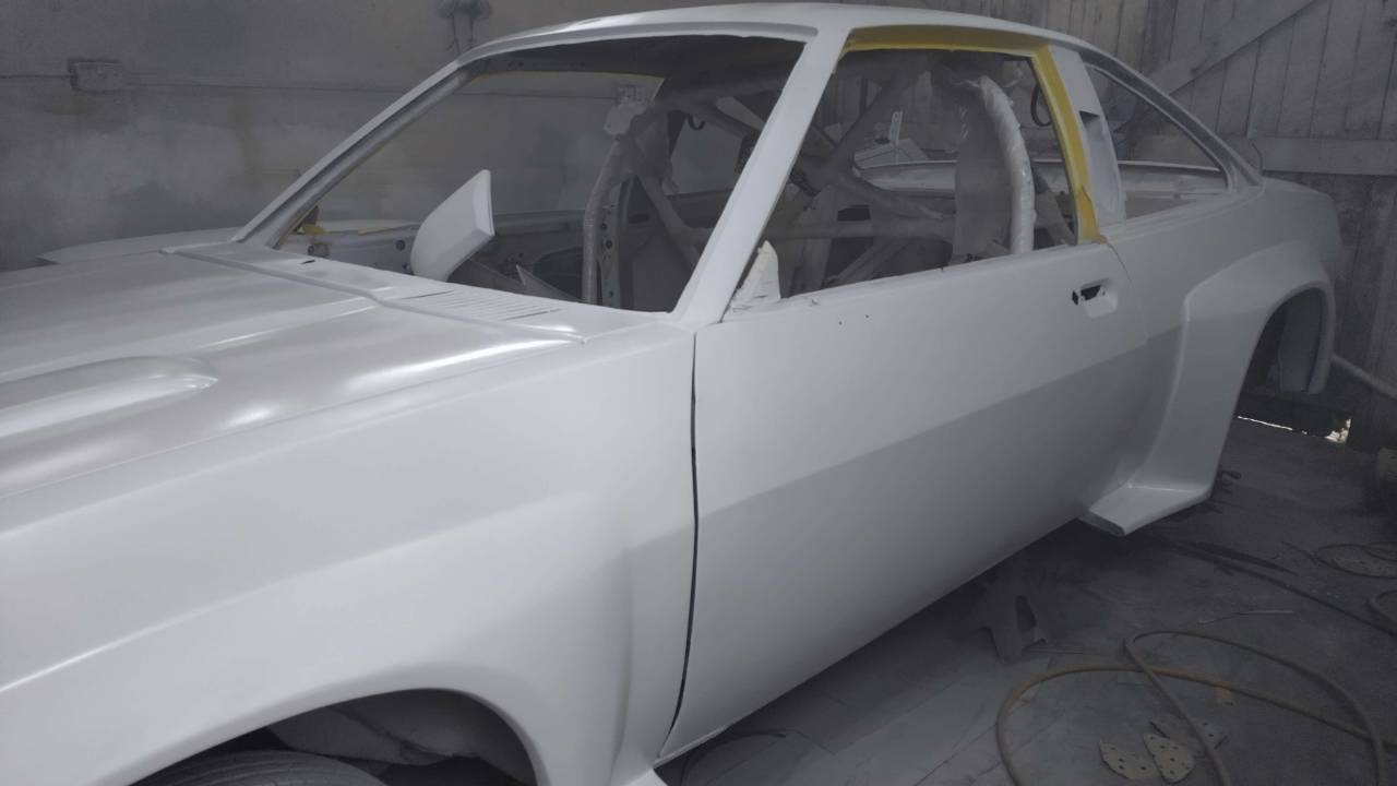

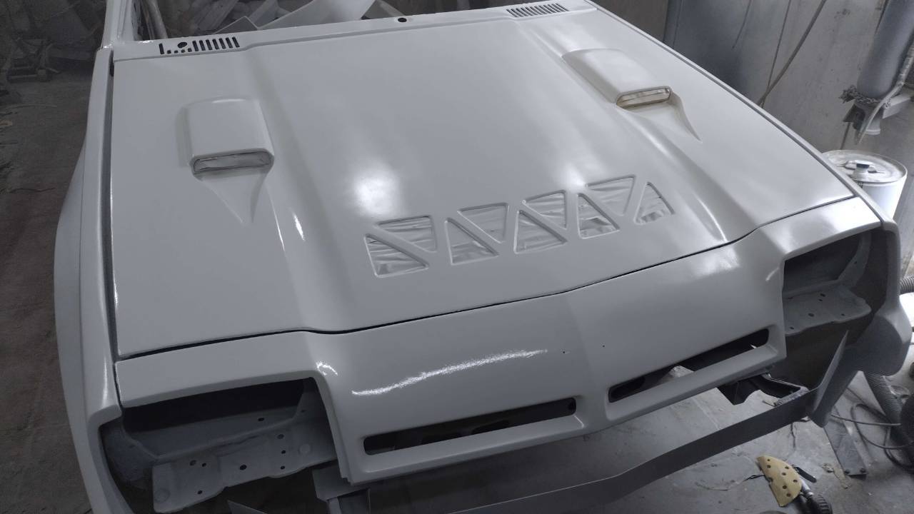

First lot of primer shot today
IMG_20240613_115252.jpg.3ff6dbd405f34c3ca8bbdc7048c46ac8.jpgIMG_20240613_115236.jpg.ecb178133939a291fe24a35389b3e079.jpgIMG_20240613_115223.jpg.9dc8a5dc277b12dd9e2ef8fbca3e4a9a.jpg
Needs blocked and all the wee crap bits filled in etc but it's getting there.
Worst fitting body kit ever and I'll never fit another one as long as I live.
