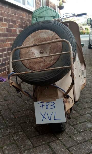

strangeangel Posted October 8, 2020 Author Posted October 8, 2020 It's the DVLA innit... they were never going to get this 100% right: Oh well... when it seemed for a time that this would be unregisterable and at best would end up wearing a Q registration I'll take that. egg and LightBulbFun 2
LightBulbFun Posted October 8, 2020 Posted October 8, 2020 1 hour ago, strangeangel said: It's the DVLA innit... they were never going to get this 100% right: Oh well... when it seemed for a time that this would be unregisterable and at best would end up wearing a Q registration I'll take that. ah yeah I feared something like that might happen from discussion on my thread about this common DVLA error it seems to originate from the fact the DVLA data entry clerks dont know how to read their own forms etc or enter the data from said forms into the correct boxes on their computer but out of curiosity do you remember how you filled the Manufacturer, Make, and Model bit out on the V55/5? I always found that bit interesting as a V5 only has Make, Type, variant, and Version, it does not have Manufacturer or Model in its list of data points, so im curious to know how the Manufacturer Make and Model on the V55/5 line up with the Make, Type, Variant and Version on the V5 LOL, and it might help us figure out the above common DVLA error of the Model info getting included on the same line/box as the make info, and how to avoid it etc (currently the way I I think I would do it is just fill in the manufacturer or make box and leave the other 2 blank, so they cant fluff it up!) but yeah happy to see its on the DVLA after all the work that went into it! hopefully the logbook will be with you soon strangeangel 1

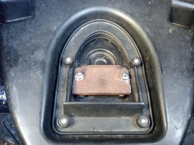

strangeangel Posted October 17, 2020 Author Posted October 17, 2020 Bit of progress today; not a lot as I seem to have spent a lot of time thinking in an attempt to avoid screwing up. Still, the newly-drilled out fork bridge is reinstalled, complete with new steering head bearings. No more up and down play at the end of the handlebars! The bearing seat wasn't as bad as I first thought, but it got a smear of Bearing Fit anyway. New fork seals are installed too, the forks now just need re-filling, re-assembling and bolting back on (hopefully tomorrow). Cavcraft, LightBulbFun and grizgut 3
