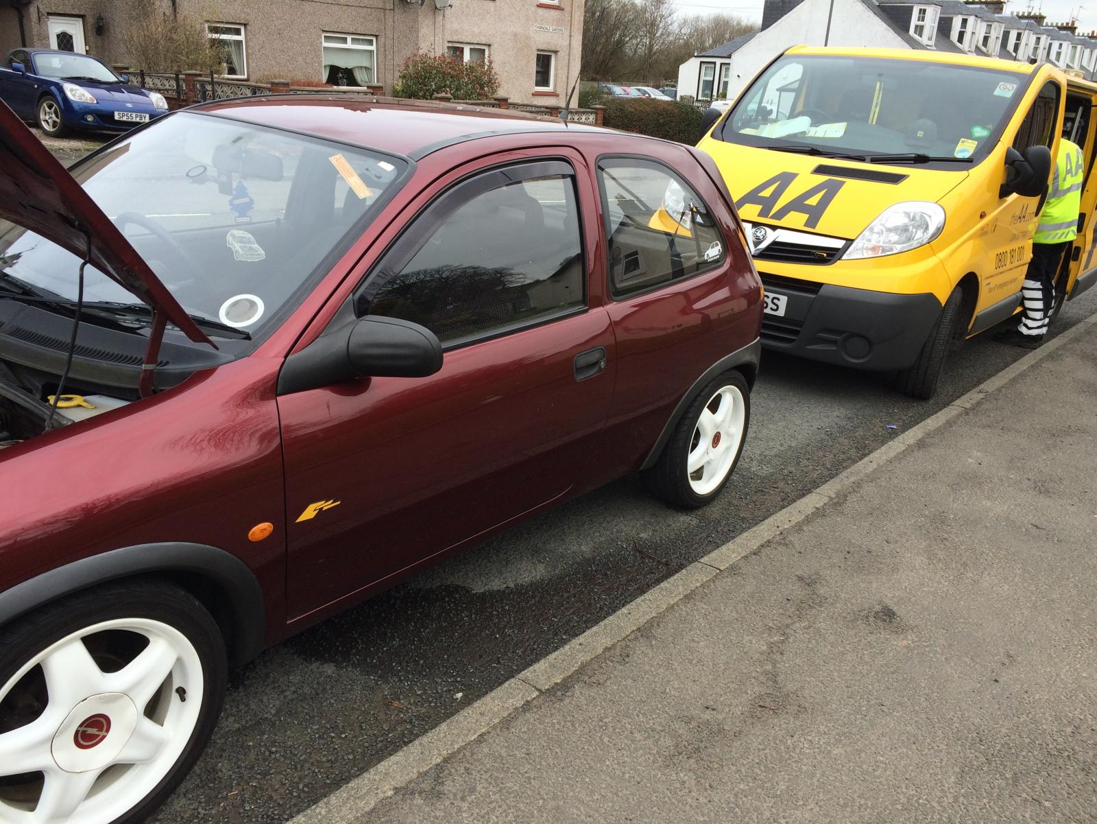

Split_Pin Posted April 2, 2016 Author Posted April 2, 2016 Arrived in half an hour. Currently 1000% impressed with his shiteists methods of jamming open the stat! Lacquer Peel, Barry Cade and Cavcraft 3

Split_Pin Posted April 2, 2016 Author Posted April 2, 2016 Yes definitely the thermostat. He had all sorts of clinical looking equipment attached to the header tank. One test for Co2, fluid on the test tube stayed blue which was good and also pressure tested it, nothing excessive. Tell you what though, I've sorted the misfire, he was revving it quite a bit to test the circulation of the coolant and it sounded healthy again: egg 1

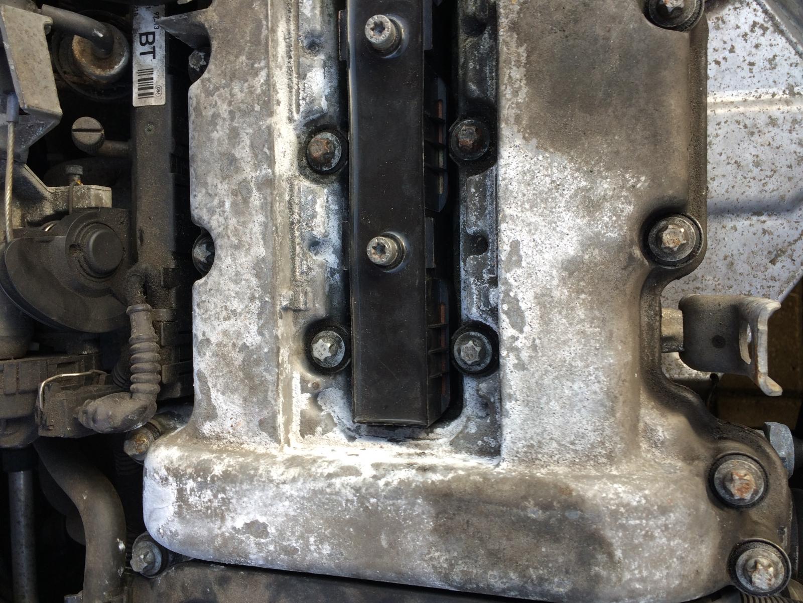

Split_Pin Posted May 13, 2016 Author Posted May 13, 2016 Started it up again tonight, fired up ok but there was previously a barely imperceptible top end knock which has become slightly louder and doesn't go away when warmed up. When you Rev the engine it doesn't appear to get louder however and the general noise drowns it out. You know that feeling you get when your dog or cat starts acting a little strangely and you just 'know' that it's time is up? That's how I am viewing this engine just now. Also, what the heck is the white stuff all over the rocker cover, it feels like emulsified washing powder??
