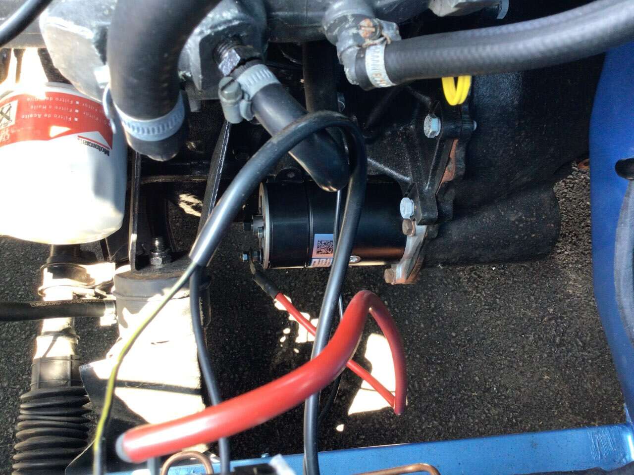

Starter motor. This is the car’s original part and does work. But, it’s developed an annoying habit of not engaging or releasing as quickly as it should or even at all sometimes.
I’ve tried giving it a quick clean up, spray down with WD40 and exercising it, which seems to have made it a bit better but after a while it returned to being a pain again. The last time I took it out I managed to snap off the brass live terminal bolt too so I decided to replace it since a reconditioned part isn’t too expensive.
You can see the gear isn’t moving freely as it should as it’s jammed in the middle in the pic.
New recon part fitted. The only thing I had to do was trim the unnecessarily long bolt that holds the strap/cover on the end together as it kept fouling on the side of the engine block. You can see the same had been done on the original part too!
Start’s and spins over really easily now and there is no awful grinding noise where the ring gear and starter aren’t separating quickly enough. Lovely and quiet.
I did have a quick look at some of the ring gears teeth while the starter was out and there’s no damage or chips to any teeth. Probably only a matter of time before damage was done however.

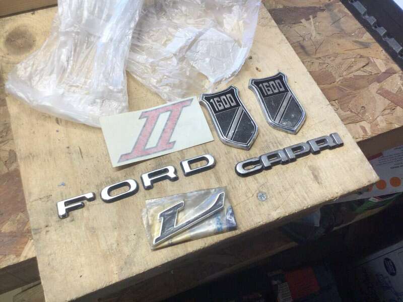

Tailgate badges are on!
They took an unnecessarily long time to fit though.
The ‘L’ and ‘Capri’ ones weren’t too bad but the ‘FORD’ letters were a bit of a pain. Mainly because it required me to measure and do maths and shit to get them centred and spaced right. Me and maths do not get on. Not at all!
In my defence though, as we all know, mathematics is a fantastic theory, however in the real world it just doesn’t work. At all. Ever.
The tape is a bastard! It seems strong, but it’s a shit bag to cut into shapes or around the holes in the letters. It seems very squishy too, you can wobble the letters a bit although they don’t come off. Maybe it takes a bit to cure?
II badge was dead easy, it’s just a vinyl decal so as long as the surface is clean and free of grease/polish etc it’s fine.
The ‘L’ badge was a new old stock part, correct style L for this cars age, but unfortunately the original sticky tape on the back of it had long since gone hard and no longer sticky so I had to scrape all that off and put new on.

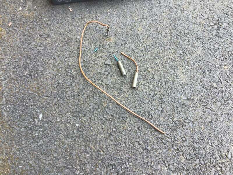

So I’ve had a play around and close look at the wires and the live wire turned out to have loads of dirt and corrosion inside it’s connector to the sender, which will obviously cause high resistance and low volts. The earth wire that runs only a short length from the sender earth pin up into the cabin/boot floor to a clean earth connection on the body, was absolutely rotten! It looks ok but the copper inside was all green and powdery at the sender (outside the car) end and the connector was also full of corrosion and dirt.
I think I’ve found the issue then!
I’ve disconnected both wires, completely replaced the earth wire with new and new connector eye for the body end. Then to be safe I’ve cut the live wire back a few inches and soldered on a new length of wire to make it the right length again, and put a new connector on. Tested it on the multimeter and it’s now perfect.
Ran into a problem with the earth though, as the connection to the sender earth pin is a weird size female bullet type connection. Which I don’t have any new ones of!
To check the gauge itself works I just connected the live wire and earth wire to together, which immediately sent the gauge up to max. Result!
The connection for the earth pin left me scratching my head for a bit and searching everywhere for anything that might work. Eventually I had a eureka moment and found a single brass chocolate block connector. Stripped off the plastic insulation and managed to slide the brass connector over the earth pin and tighten it with the connector’s screw, then slide the earth wire into the other end and tighten that up too! Is it really a bodge if it works that well!?
It’s a solid connection anyway so with the live connected up and the ignition on…
We get a quarter of a tank of gas! Which is about right as I did put a big Gerry can of fuel into it last year. Thank god it was a simple fix!

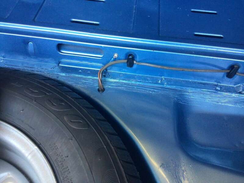

Here’s the wiring in the boot.
And the sender end with the bodge fixed self made connector.
Ill see if I can find something better to do it properly later but for now this works fine.
Heres the dead earth wire and old connector’s. I’m surprised how rotten the end of that wire had become. Old age and damp I guess.
