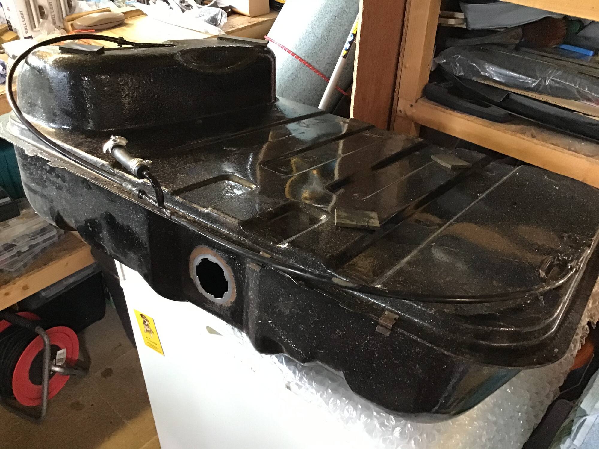

Just a little bit done today. My backs aching like a mother today, I think from laying in an awkward position yesterday.
Ive dragged the fuel tank out from its corner in the garage and had a look over it. It weighs a shit ton load too so not a good thing for me to lift today, but oh well!
It’s pretty clean & tidy on the outside. It was painted quite some time back, and though it’s not perfect it’s good enough for something that lives under the car. I’ve dusted off the cobwebs from the outside, and wiped off some of the spider shit and dead woodlice. There’s no rust as it’d been cleaned back before painting but it’s a bit rough and uneven in places and there’s a little dent in one corner. It’s ok though.
Removed the foam temporary bung from the filler neck hole -
Then removed the sender unit -

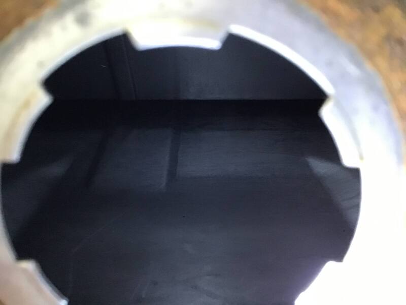

For a 46 year old steel tank thats pretty dam clean inside! All I found was a couple of little crumbs of sandy stuff and one or two little cobweb bits so I’ve hoovered them out.
On the outside there’s two breather tubes, one on the higher end of the tank and one on the opposite end, these are linked by a length of plastic fuel pipe with a T piece in the middle. On the spare end of the T piece is a short stub of rubber fuel hose and two jubilee clamps to secure it. This joins onto the end of the plastic breather pipe already fitted to the car. The hose was pretty old and soft and the old clamps were rusted solid so I’ve replaced them all for new.

Despite it’s rough appearance I’m actually pleasantly surprised by how good the tank is inside. I’d expected it to be much more rusty tbh. The tank out of my Mercury is only a year older and that was absolutely full of rust and muck and had to be replaced so this is a bit of a bonus.

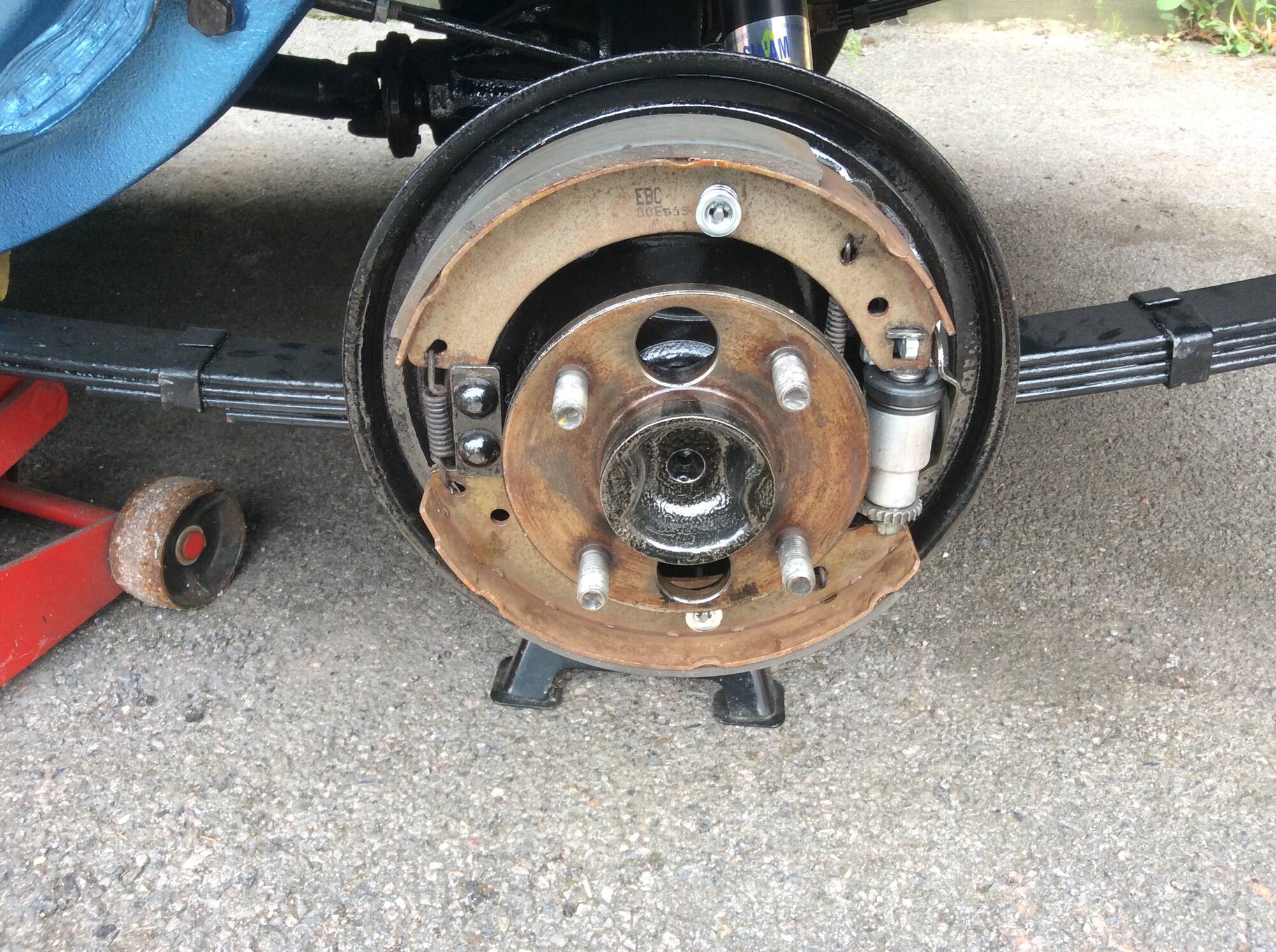

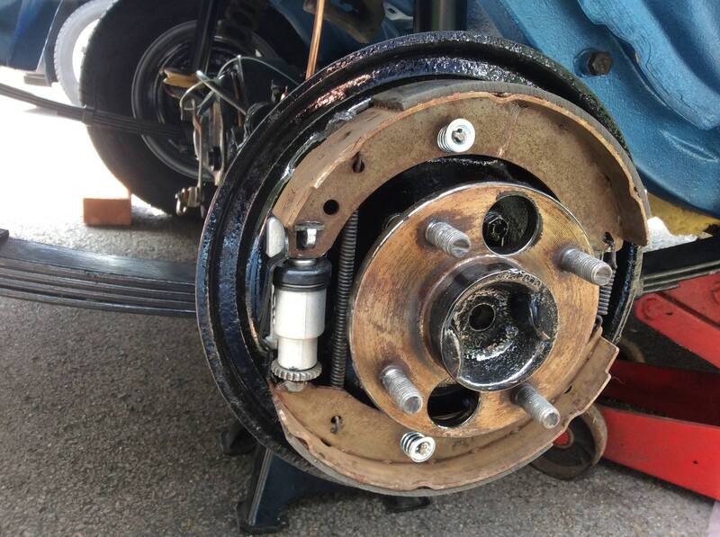

The rear brakes are totally different to yours too, yours has the standard double acting wheel cylinders with separate adjusters. Mine has old (mk2 Cortina etc era) single acting floating cylinders, with the adjuster combined on the cylinders. Then the handbrake arms go through the back plate to the cable, but inside the drum there’s a little finger that pokes down onto the adjust cog. As it all wears the movement just pulls the finger and winds the cog out to move the shoes further out.
Its not a bad set up, very basic and easy to work on, but the weakest bit is the adjuster fingers. They get old and just snap off meaning you get no self adjustment. On mine both of them had snapped off, one did it on the motorway but as I was driving you could hear it rattling around inside the drum! I couldn’t get replacements then either so had to manually adjust the rear brakes every 6 months or whatever it was!
Ive got a pair of new ones now (at great cost!).
Ha ha ha, self adjusters working as they should!
Click them round with a screwdriver until the drum just goes on, like everyone does.
I was still doing that on our MK6 Transit.
Totally different to my set up! Even the shoes are rotated 90 degrees. I like the theory of your set up but can imagine how good it is in real life usage!
Yep, they’re an odd set up, but probably very much of their era I would imagine. I know mk1’s use this set up and mk2 Cortina’s etc do too.
It’s very simple, and so easy to build up new brakes, but I wouldn’t expect they’re as good at actually braking as your car! I’d imagine doIng a comparison between the two would probably show the deficiencies in mine!

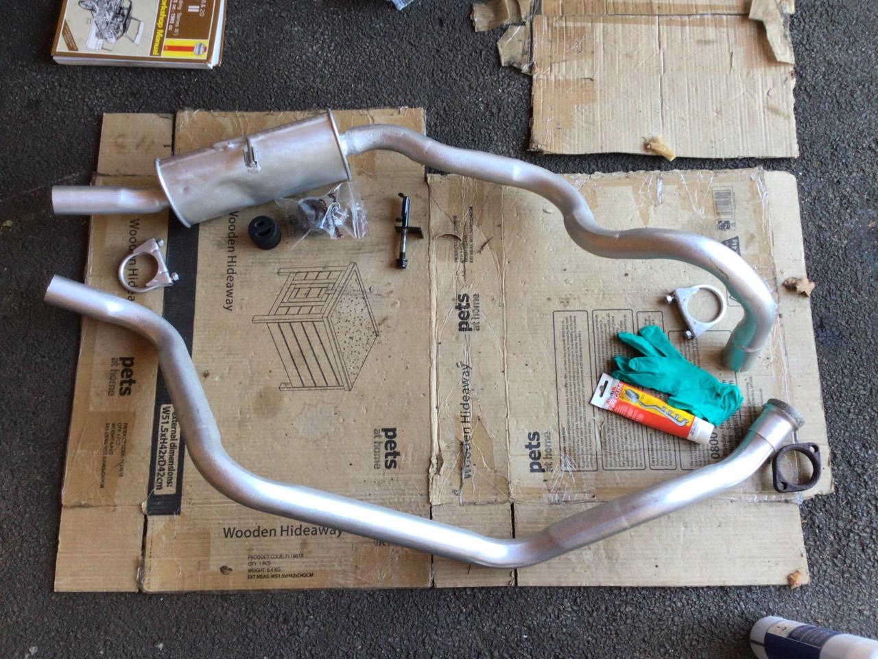

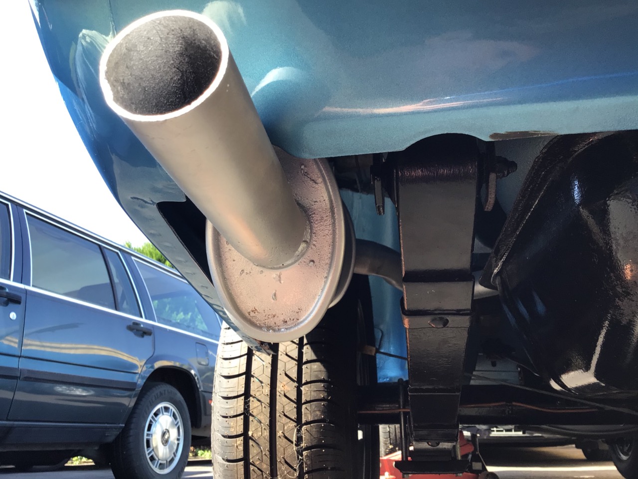

Job number 1; fit the sodding exhaust!
Id cleaned this up and given it a coat of paint a while ago then put it away ready to fit when I got round to it.
Here’s all the bits,
Front pipe, rear pipe/silencer and new & old rubber mounts, clamps and repaired & painted hangers.
The original rubbers are still probably usable but are beginning to crack and perish so I bunged a full set of new ones on. The two black hangers are the originals and have been removed from the shell, stripped, repaired where needed (rust!) and painted in chassis black. The big middle box clamp is one I ‘acquired’ years ago from a former employer! It’s in really good unused condition (original was broken and rotten). The front pipe - manifold clamp had been cleaned and repainted when I did the rest of the exhaust but I put it away somewhere safe... so safe I can’t find the damn thing! So the one I used here is a spare. It’s still a bit rusty and I’ll just take it off when the good one surfaces. For now it fits and works.
Getting it in place wasn’t particularly easy, it’s heavy and awkward to do laying on your back on a driveway! First thing was put the front pipe in place and just nip it up to hold it, then slide on the middle pipe/box. Then I fitted the rear pipe/box which slides in at an awkward angle over the rear axle. The hanger for it bolts through the rear chassis leg with one of the rubber mounts between it and the silencer can. This one mounting was an absolute arse hole to get on as there’s no space to get your hands in, the new rubber was incredibly tight and I was scared shitless of knocking the paint around the tailpipe! Got it in the end though!
With everything loosely joined together and hung from the mounts I could slide it and adjust the position of the whole system so it runs clear of everything and doesn’t knock against the body. Once happy I sealed up the joints with a bit of exhaust paste and did up the clamps, then finally tightened the two manifold studs.
Sounds easy, but it was actually time consuming and hard work! But it’s on now.
You might notice a bit of rust starting to come through the silver exhaust paint... not much I can do about it unfortunately! It’s an old used system and I couldn’t get it to bare metal all over. I knew it’d do this eventually though, it is what it is. It should be ok for a while but I’d like to get a new custom made system fitted at some point, so it’ll be fine until then.

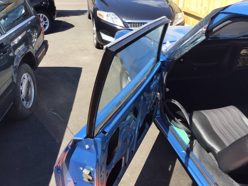

Today, I’ve made a start on the passenger side door.
Firstly I’ve hoovered out the inside of the door to get rid of any dust, dirt and cobwebs etc then offered up the door handle and a few other bits to see where they sat inside the door and where the fixings go. Once happy I broke out a new box of Silent Coat sound deadening pads and stuck a load of them inside the door, onto the back of the outer skin panel. It’s almost completely covered (missing only the points where things fit onto the panel and the extreme outer edges). The door feels absolutely solid now, and doesn’t have that empty ‘tinny’ sound. It’s probably heavier than it ever has been now too!
With that done, out came yet another couple of cans of Dynax S50 cavity wax! I’ve sprayed all the exposed surfaces inside the door, and used extension wands to get it into all the seams around the edges of the panel. It is literally everywhere! Being a hot sunny afternoon helped as it thins the wax and lets it flow into crevices and joints easier.
I had to stop there as the excess was literally pissing out of the drain holes in the door bottom! I just left it sat for an hour with old pots under each drain hole to catch the drips! Hopefully by tomorrow it will have drained and gone hard.
Tomorrow’s job will be to start building up the door itself (handle, lock mechanism etc etc). I’ve also got to drill a hole through the A post for the courtesy light switch, and drill two holes through the door skin itself my lovely new mirrors! Not something I’m particularly looking forward to! Get it wrong and it leaves a mess! The new door seals also need finally cutting to size and pushing into place. They’ve been fitted since the car came home so should have shrunk/stretched as much as they’re ever likely to by now so cutting them shouldn’t pose future problems regarding the ends shrinking away from each other.
Ive also got to remove the top section of the door frame as one of its fixing bolts has snapped, so it needs drilling out, re-tapping and new bolts fitted.
I’ll try to get a few more pics tomorrow too.

Next job was to repair the snapped bolt on the passenger door frame. On a Capri the entire window frame can unbolt (5 bolts) and lift out of the door itself. Naturally the one that had snapped was the difficult to get at one.
So with the frame off the car I covered the snapped end in WD40 and tried to just wind it out, which didn’t work. So I centre punched the snapped end, then drilled the little bastard out then re-tapped the threads. Sounds easy but it took ages! The old snapped bolt was absolutely rock solid and took an age to drill without work hardening it.
It was in the process of this I noticed the frames rubber & felt seal channel for the door glass was actually broken in half with a lump missing. So that was ripped out for replacement while I was at it. It was well overdue too as the rubber was split and gone hard, bits of it just crumbled taking it out. Fortunately because I horde stuff, I had a brand new seal in the shed (it’s been sat there in it’s bag for about 15 years!) so that’s now fitted.
The frame was an absolute arse to refit to the door as it’s tight anyway and your scared of scratching paint or smashing the glass! Got there in the end but everything is now properly aligned and properly fitted now so it wasn’t a wasted day.
Here’s the door itself with the wax and sound deadening inside. Just need to remember to remove the masking tape covering the holes.
The door feels very heavy and solid now. Feels like a quality car the way the door closes! I’ve wound the window up tight for now so hopefully it pushes against the new seal and seats it properly.
