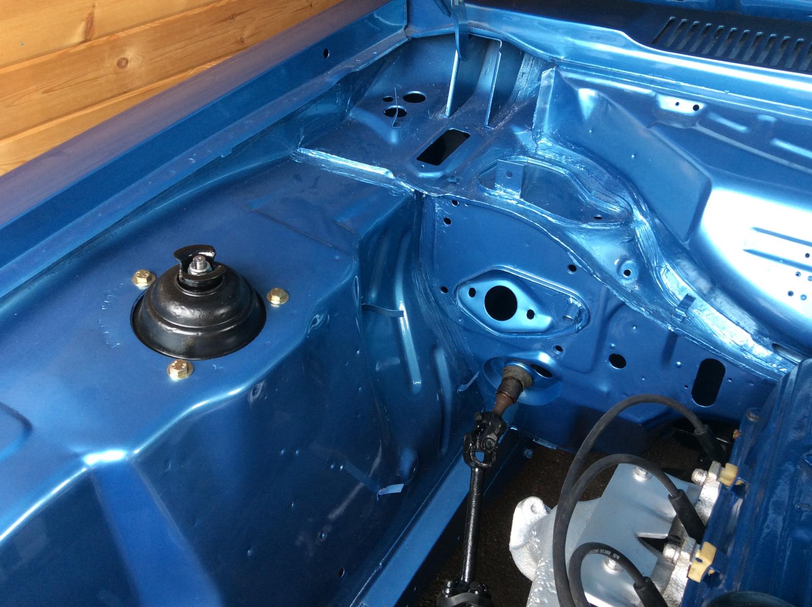

Here’s a few engine bay pics now I can open the bonnet properly.
It looks brilliant inn the engine bay, lovely and smooth and clean. There’s lots of dust and specks of polish residue that’ll need wiping off though.

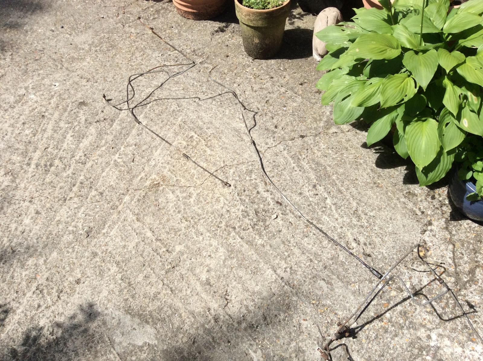

I’ve sorted the old brake pipes, I’ve layed them out next to the car to see how they went (I’d forgotten!), pretty simple really.
The new line kit has a number tag on each length of line. You cross reference that number to a list supplied in the kit and it tells you exactly where that line is for. Looks a piece of piss to do tbh. I’ve offered the new up to the old lines and they’re all present and correct. There’s an odd mix of metric and imperial unions on these cars, again all these are new and ready fixed onto the ready flared pipes, all of them are in the correct places. Seems like a good kit so far.
Only thing not included is the 3 way splitter that bolts to the inner drivers side wing under the bonnet. There’s no valves or anything on this car. 1 port on the master cylinder does the two front brakes via the 3 way splitter. The other port on the master cylinder goes under the car to one rear wheel cylinder, then another brake line comes off the bleed nipple port of the wheel cylinder, across the axle to the other wheel cylinder which has its bleed nipple in place as usual. Easy and simple!

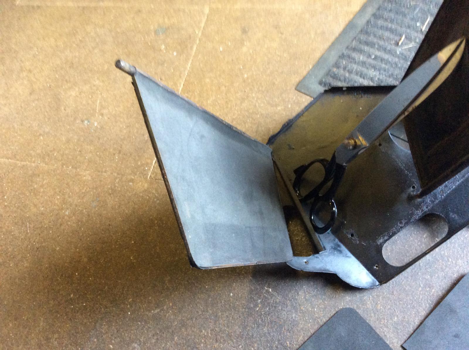

I’ve also re-foamed my flaps!
I found some thin foam in my model making box. I think it was a cutting mat or similar but this is a much better use for it! I’ve cut it to size and stuck it onto the heater box flaps for the sound deadening that was all disintegrated and missing. Evostick impact worked a treat on that.
This is now finished and can be put back together and back into the car at some stage.

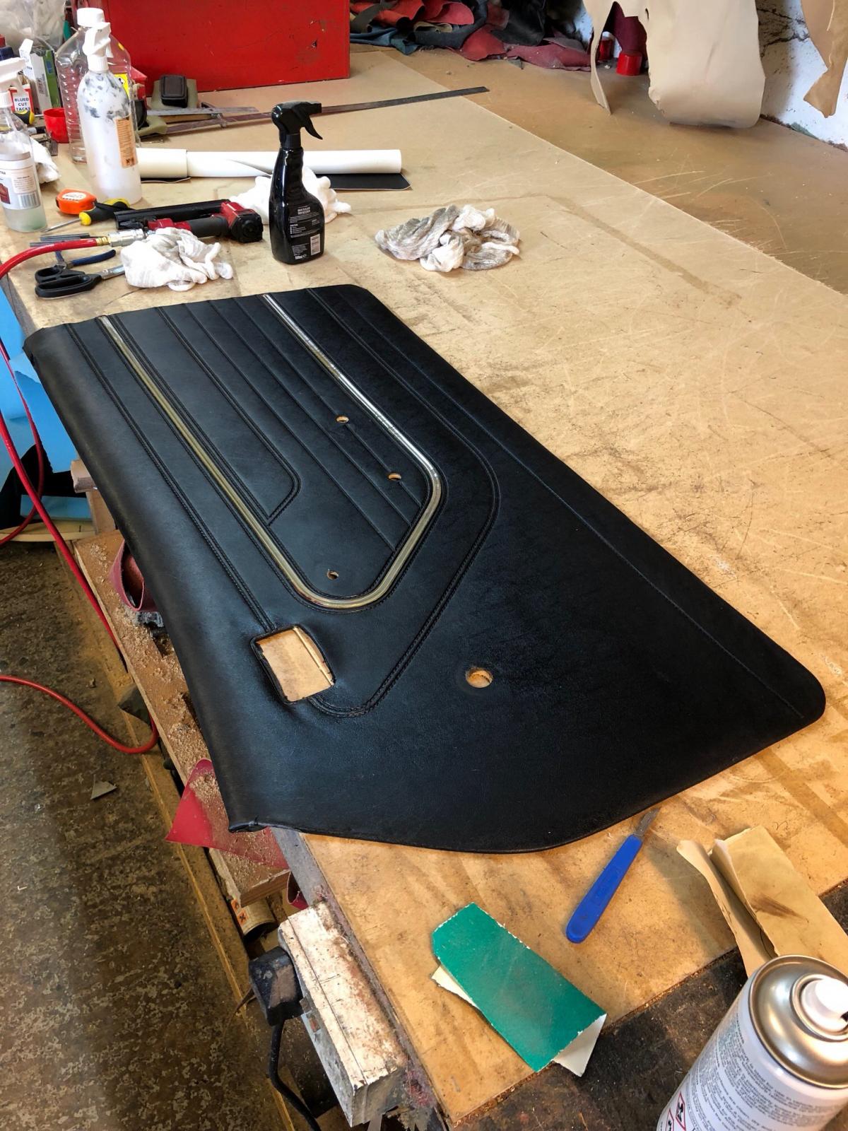

Just for a comparison.
This is the same door card before and after.
How they’ve done it I don’t know because it was pretty well fucked before! The bottom edge especially was all torn and crumpled up.

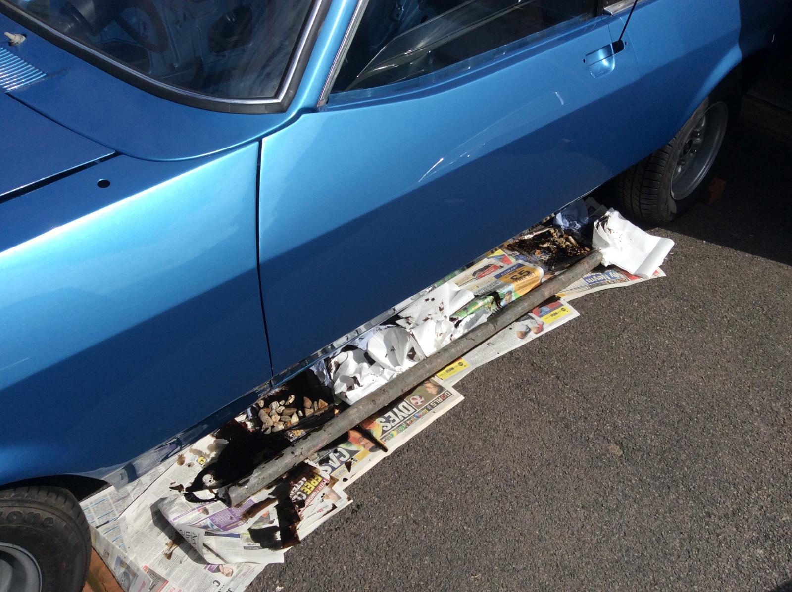

This afternoon I’ve started the cavity waxing.
It’s been roasting hot today so while it was a grim hot sweaty job for me it’ll be perfect for the car!
My usual method for this is to leave the car in full sun all morning to get warm. Easy today.
Then either park on a slope of jack up one end of the car so all the wax runs down the panels and seams. I’d put various pots, cut open bottles etc and old newspapers under the car to catch the drips.
I started with the front chassis legs which were easy while the floor bungs were all out. Then I’ve done the sills, paying extra attention to the front A post base and rear sill end cavity. Afterwards I sprayed a load more into the interior crossmembers under the front and rear seats and the little cavity above the rear spring mounts. Finally for today I’ve sprayed a load of wax around the rear wheel arch to inner arch bowl seams and into the insides of the rear quarter panels.
It was unbelievably hot inside the car doing this, even the floor pan itself was too hot to touch in the sun. That’s good though as it makes the wax extra thin and helps it to soak into the spot welded seams and run down through all the cavity’s and drain holes.
I’ve really gone to town with it too given how much was pissing out of the car underneath!
I’ve got about 50% of the car done so far. For now I’ve pushed it back into the garage with fresh newspapers under it and I’ll leave it a day or so to finish dripping and dry off. Then I’ll do the exact same on the rear half of the car.
