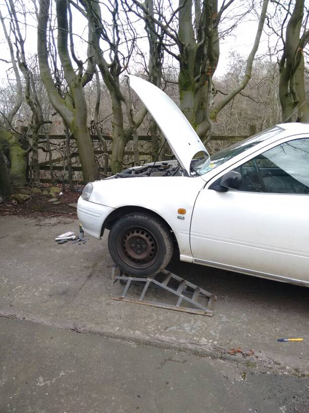

Up on ramps today and looks like all connection are clean and tight.
I think it is the starter solenoid thing. Will have to try and get it off to have a look at it.
Up she goes

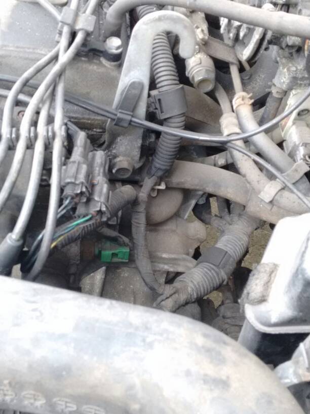

Hunt for starter
Not from top.

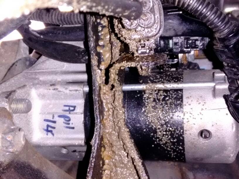

Looks like it has had a secondhand one previously
And that the CV joint has been spinning grease up it

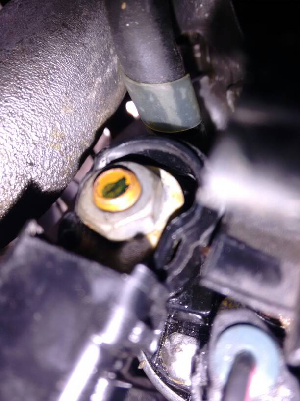

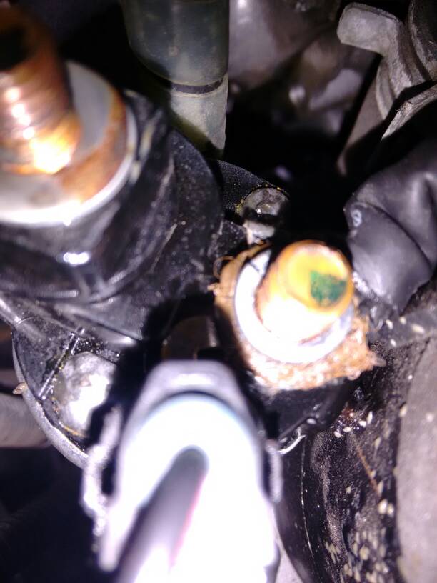

Connection off and cleaned
It starts on button again. I will wait and see how we get on. Replacement looks an arse as it is tucked down under the inlet fannymould
Since cleaning and tightening everything it seems a happier car, so will put the warranty claim paperwork away :-)
