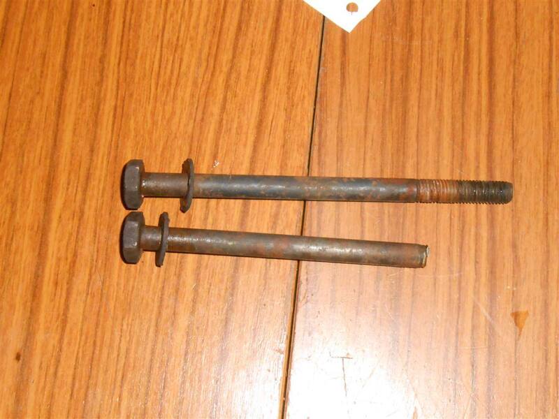

-The long through bolts that hold on the suspension arms were well and truly seized solid and no matter what I tried I failed to remove them. Eventually I had to pay a man with some machinery to come out and do it.

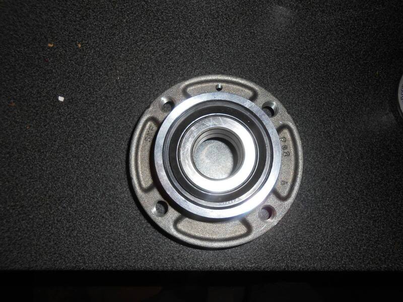

-At the same time both rear hubs were condemned, which started the whole fiasco of the bearing cups mentioned in my post above. I spent around three months searching for these bloody things to no avail, during which time my MoT had expired so I had a car illegally sat on the street on axle stands and no way of putting it back together. Typically, just after I’d sourced a pair of ABS hubs with the bearing cups included someone announced they were having a set of 100 3D printed.
-Whilst the new nearside hub went on without issue, when I tried tightening the offside hubnut I found that the stub axle thread was knackered. I ordered a 30mm x 1.5mm rethreading die which was advertised as taking 2-3 days to arrive from Basingstoke, which in fact took three weeks to arrive from Guangzhou. Not that it mattered, as when I went to rethread the stub axle it turns out there wasn’t enough metal left into which to cut a new thread.
-When the new stub axle eventually arrived from Barry at Bourne Citroen (after a prolonged delay as his wife lost it in the boot of their car) it refused to stay in place when I tried mounting the hub onto it. You can see details of the calculated precision engineering* developed by Strangeangel and I to overcome this problem on his BX thread here.

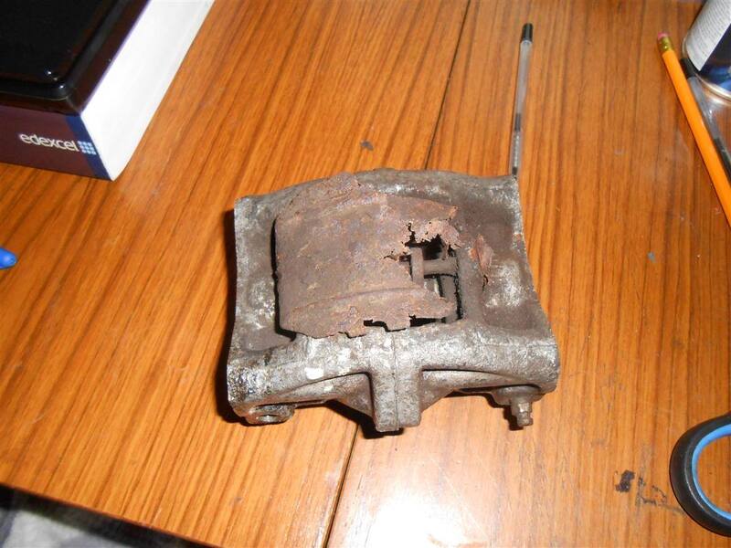

-When it came to the brakes I bought a pair of new calipers as the old ones were pretty shagged. Despite the ones I bought being identical to all the others I saw for sale online and the ones in the Haynes manual, they were completely different to the calipers that came off this car and when fitted fouled on the disc. Eventually I ended up restoring the old ones once I’d finally unseized the pistons and had the absolute joy of removing the old bleed nipples.
One of the brake calipers before refurbishment but after an hour of wire brushing. Absolutely every component you see here was completely fucked.

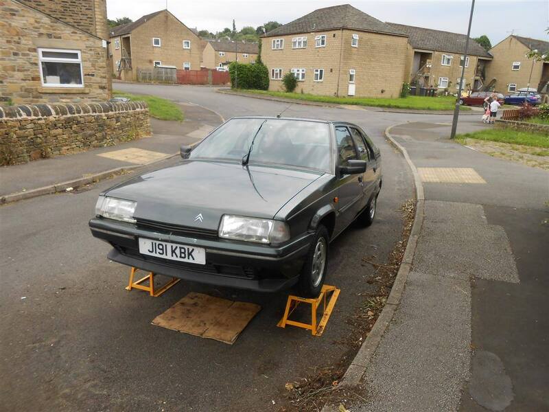

Here's how things looked once finished, the LHM slick below being my fault rather than the car's. It's amazing what a lick of paint can do.
And a record shot of the auspicious moment the BX finally returned to four wheels.

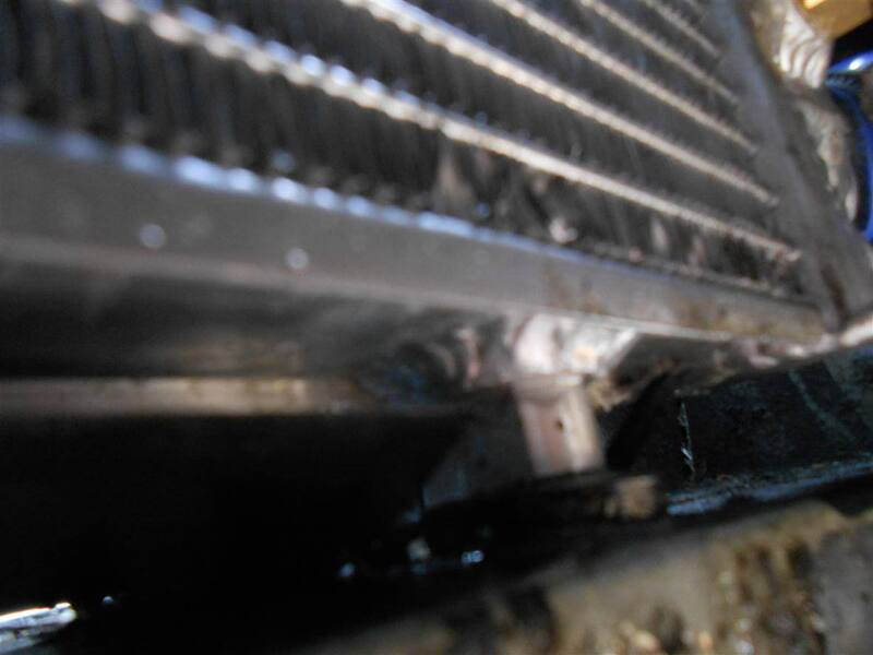

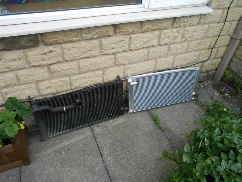

The old radiator came out easily enough, and with good reason: while I'd assumed it flopped around the engine bay because it was only mounted at the bottom, it turned out it wasn't mounted to anything at all, being merely suspended in the engine bay by the coolant hoses. Despite this somebody had still seen fit to change the bottom radiator mounts (more on this later).
As you can see, the old and new radiators are virtually identical, aside from the new one being twice as thick, narrower and taller.

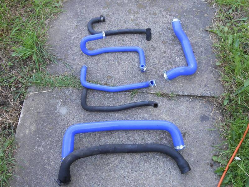

Removing the coolant hoses was a less easy experience. To gain access to the crankcase end of the bottom hose for removal I ended up having to take off the offside wheel and wheelarch liner, and even then the driveshaft and crankshaft pulley were in the way, leaving me loosening a jubilee clip I couldn't see in a place I could barely fit a screwdriver. The middle hoses were held on with the most ridiculously beefy clips ever (certainly made out of better metal than anything else on the car), but there was no access for any cutting tool capable of cutting them off so I spent an hour and a half jabbing at them with various flathead screwdrivers until they fell apart.
Once they were off the hoses were a bit depressing to behold. Most of them were cracked but had been sleeved, but even the sleeving was now beginning to perish. Old vs. new shot:
With the new hoses on it was time to install the new radiator. Or it would have been if the radiator didn't just rest on the obviously incorrect mounting bushes. Why somebody bothered to change these, then didn't actually use them to mount the radiator I don't know, but there must be some logic behind it. As expected, Citroen used a size and shape of mounting bush that nobody else has ever used, so I ordered some original ones from Bourne Citroen. Which then inexplicably took three weeks to arrive, ruining my until then super-speedy progress.
So, obviously with all the correct parts installed the radiator went in without issue, didn't it?
No.
It turns out that the first batch of these radiators had been machined incorrectly, whilst the offside mounting stud should have been no more than 12mm in diameter it was actually closer to 22mm. The manufacturers had promised to correct their mistake on further batches then obviously hadn't bothered, but with a quick blast of cutting disc action I managed to sort it easily.

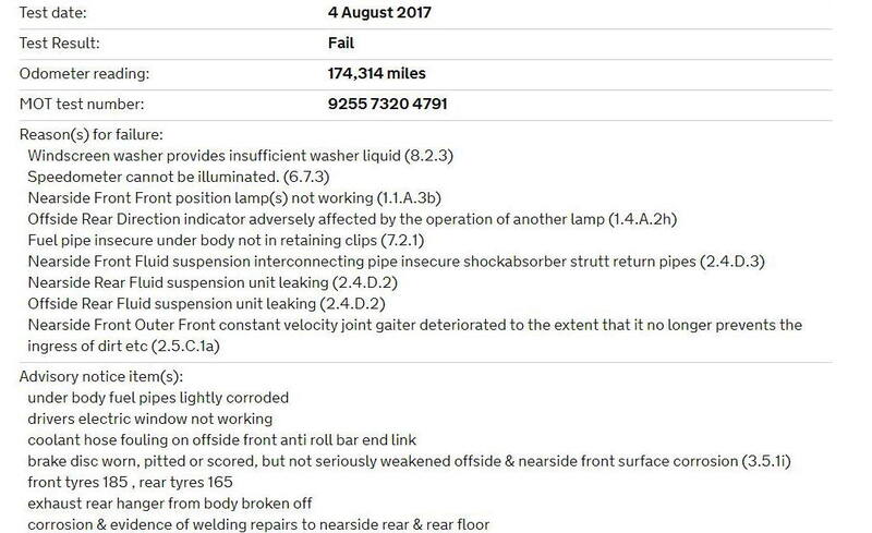

And so to the final instalment in this triumvirate of long, rambling and possibly quite tedious posts. On Friday the BX made its first journey of the year to the MoT station. I didn't really know whether it would pass or fail but I had my fingers crossed that it wouldn't fail too badly, and my prayers were answered.
The only major point of note there is the rear suspension cylinders, which are worn and leaking. I'd only expected them to fail on the basis of split rubber gaiters, a job I'd decided to leave for the MoT garage as by the time I'd done everything else on the rear axle I really couldn't be arsed. As it's the cylinders themselves at fault the garage refuses to do the job, the owner appearing to have erroneously assumed I'm some kind of hydropneumatics expert who can do it better.
It's a pain that the one component I didn't either rebuild or replace is fucked, but that's life.
The strut return pipe just needs re-attaching and the garage have agreed to do the CV boot and the fuel pipe so I don't have to worry about those.
The speedo can be discounted as it's always illuminated, something the tester didn't realise.
The windscreen washer fails every year, the washer pump worked when it went into the test station but didn't work by the time it came out. I guess I'll just replace it and see what happens.
I'm not sure what's happening with the rear lights, when the indicators flash the tail lights dim. I'm a complete electrical novice so don't have a clue where to look or what to look for.
As for the advisories, I was forewarned that they were going to throw everything they could find in there, so I expected plenty of petty free-typed items. There's nothing I didn't know about (coolant hose aside, something I'll have to inspect), the corrosion they mention is a couple of 50p sized holes, one in the NSR wheelarch and one on the boot floor.
Which brings me to the best news of the whole occasion. It appears the rear subframe mounts - the killer of many a BX - have already been welded, to a high standard too. I'd already noticed that most of the regular BX grot spots had been attended to, so literally the only rust underneath the car is that mentioned on the MoT. I'm most pleased by this, who cares if a car's mechanically a dog so long as it has a solid shell?
