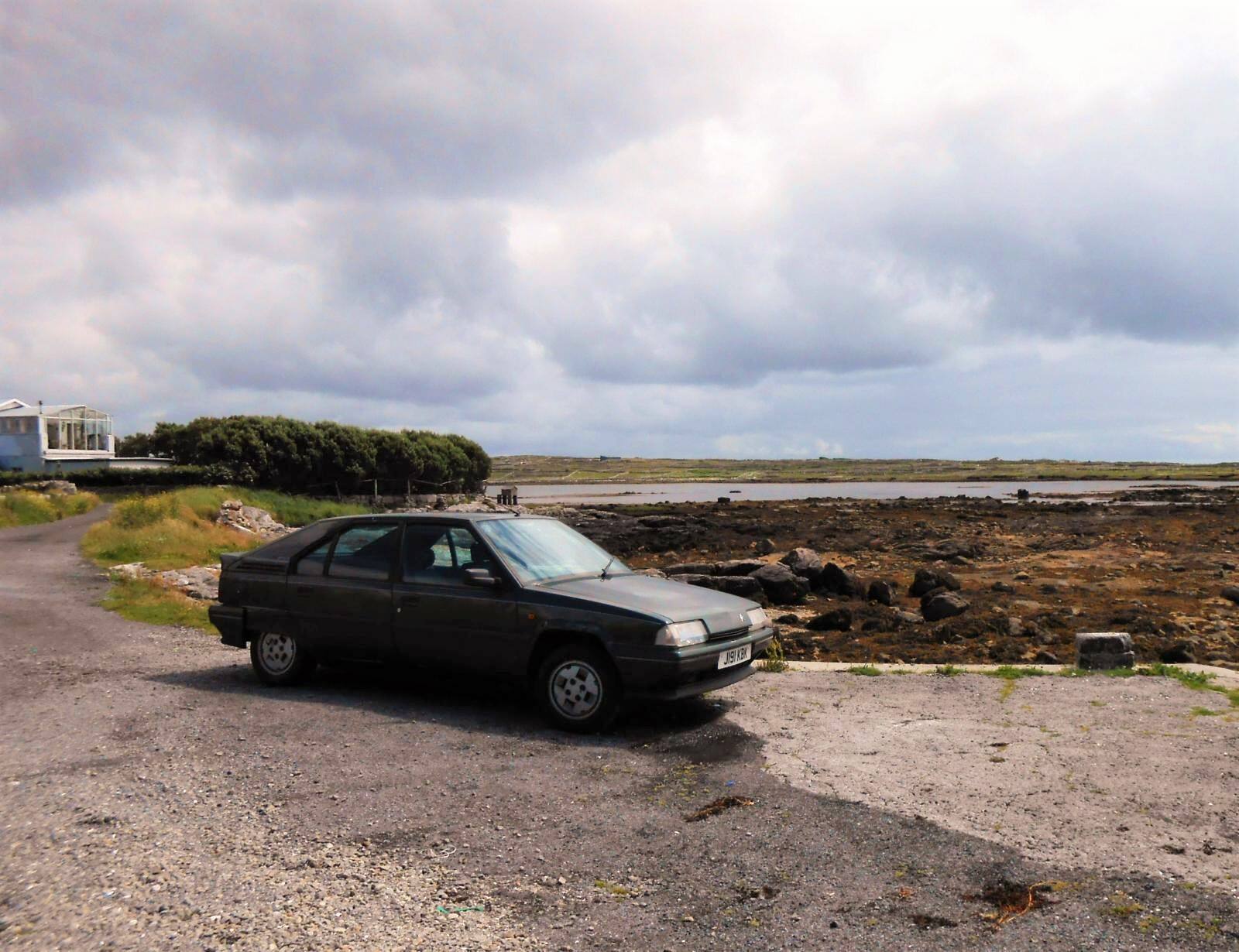

As evidenced by this picture of the BX at Kilbaha harbour at the mouth of the River Shannon, not only did the BX manage to start for more than five seconds last week, it also managed to travel all the way to Ireland without catastrophic failure.
1574916017_post-20075-0-15534800-1506990201(2).thumb.jpg.1eeb6e3bf93bf5db5e1386a8d96ef2dc.jpg
You may consider taking a Citroen that doesn't have a particularly great track record of reliability to another country without valid breakdown cover a bit mad - especially as I only had it running a couple of hours before we were due to leave - but it was a gamble that largely paid off. Until, whilst roaming around the wilderness of Connemara, we noticed a trail of fluid being left in our wake.
Fearing hydraulic-induced oblivion, I pulled over only to find that it was the new stop solenoid leaking a bit of diesel down the front of the engine. No problem, thought I, I'll merely fit the fatter rubber seal from the old one. This turned out to be a mistake, as when I restarted the engine the top of the solenoid turned into a diesel fountain, covering me, Mrs. Cleon-Fonte, the engine bay and the windscreen, but fortunately not the alternator. Attempts to stop the raging torrent by switching off the engine failed, as neither the key or the kill lever on the fuel pump had any effect, so eventually I had remove one of the fuel hoses enough to create an air lock in the system.
Fortunately a local had seen all this from his house nearby, and bundled us into his ancient Peugeot Expert so we could travel around his neighbours and see if any of them had a spare solenoid. It seems that whilst virtually everyone in that area of rural County Galway has at least one Peugeot XUD lying around in their garden or garage, they're all Bosch pumped. Eventually one of the people we visited managed to put a call in to a relative at a garage in the nearest town, who agreed to nab a Lucas solenoid from work and bring it down when he'd finished. So at twilight in a remote layby, I met with a man I'd never met before in a Peugeot 406 HDi (with missing front wing and blowing exhaust), money was exchanged for a suspicious looking package, and with that he disappeared into the wilderness.
Apart from that incident though, the BX was a picture of cast iron reliability across 1400 miles in just over a week. But if you are going to break down, Connemara is highly recommended as a place to do it.

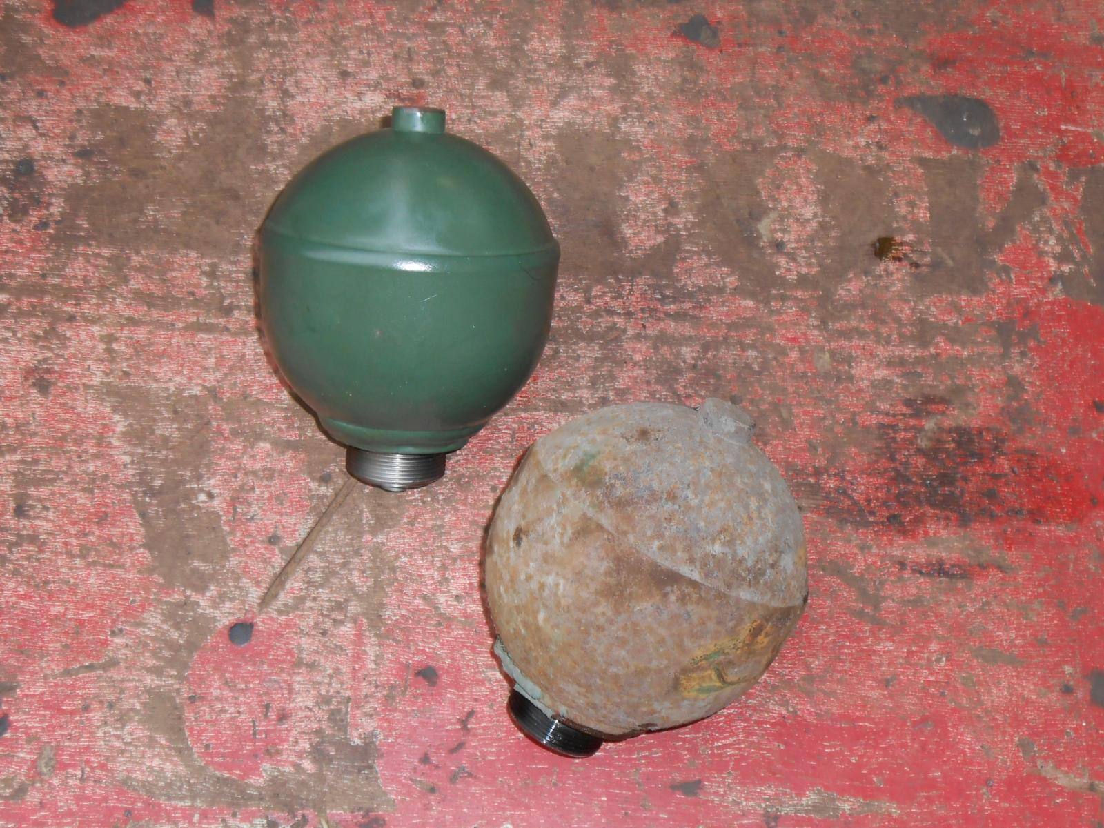

Another visit was paid to my mechanic on SD1-related business yesterday with a view to changing the BX's barely legal rear tyres at the same time. I mentioned to him the trouble I'd been having removing the spheres, and the next thing I knew a rudimentary sphere removal tool was unearthed, thrust into my hand and I was told to crack on.
Offside rear sphere, old vs. new.
And the nearside. Manky.
I can now see that trying to remove the old spheres with a chain wrench and hammer/chisel was futile, as even with the proper equipment it took two of us half an hour to remove each rear sphere, and even the front ones took a good deal of violence and swearing before they'd loosen. The previous owner must have tightened them in with some kind of machine, so reluctant were they to move (or perhaps they were the originals?).
So yet again the BX has been transformed, not least because the ride quality had deteriorated so much recently. The hillarious lowrider-style bounce has gone, it crashes much less over indifferent surfaces and several of my interior rattles have disappeared. Combined with the new tyres the handling is far superior to before (and it was already pretty damn good). Admittedly it's no magic carpet, but it does a good impression of one. I can see what all the hype is about now.

GR13 news on the spheres, the old ones look truly rank.
They were awful, it's no wonder the suspension had virtually no damping function before.
