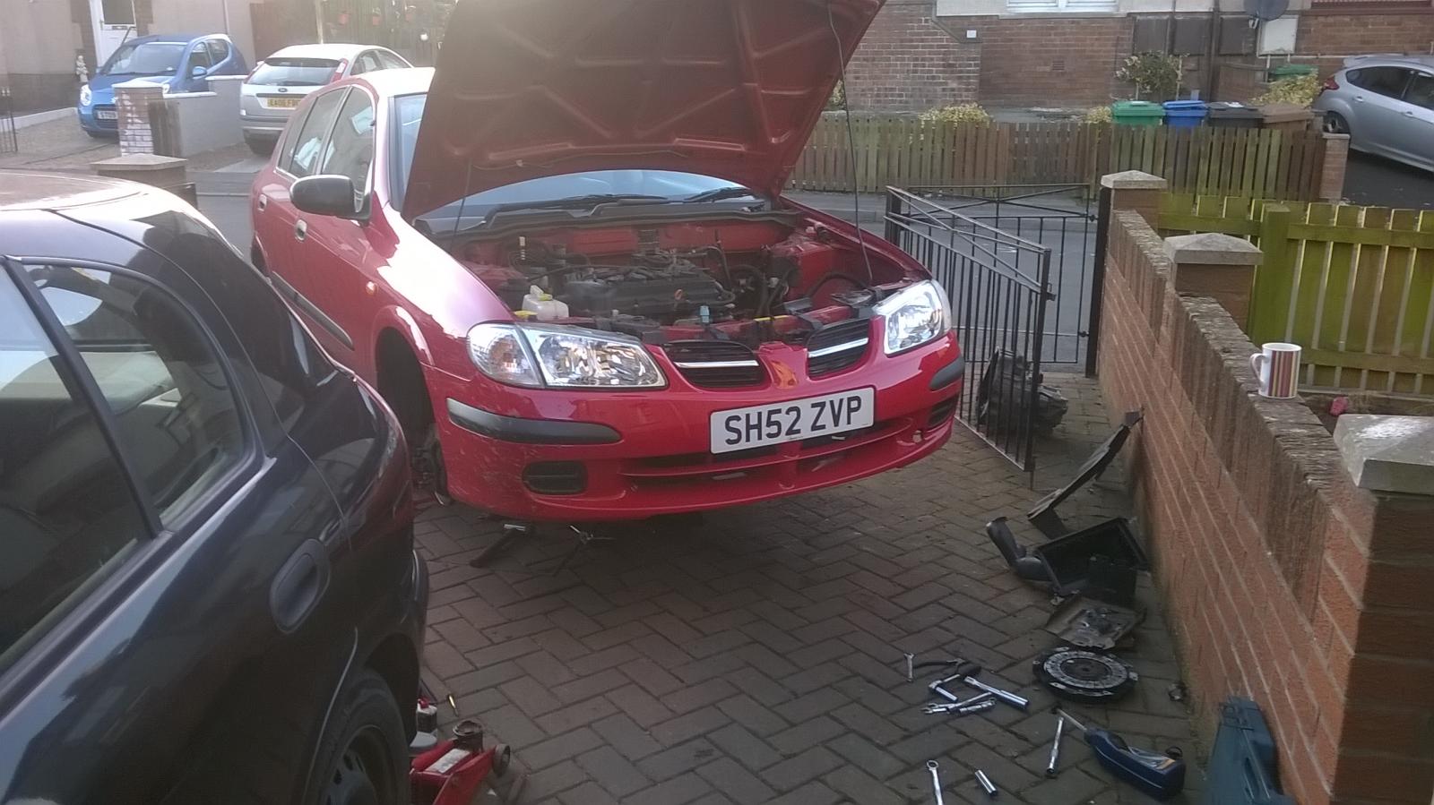

After a daft call out to t'other side of the water last night, I arranged to pick up another Almera for spares, and dragged it home on the back of the Vito.It;s a non runner, but guy swore blind the gearbox is good. I took the chance... we shall see.

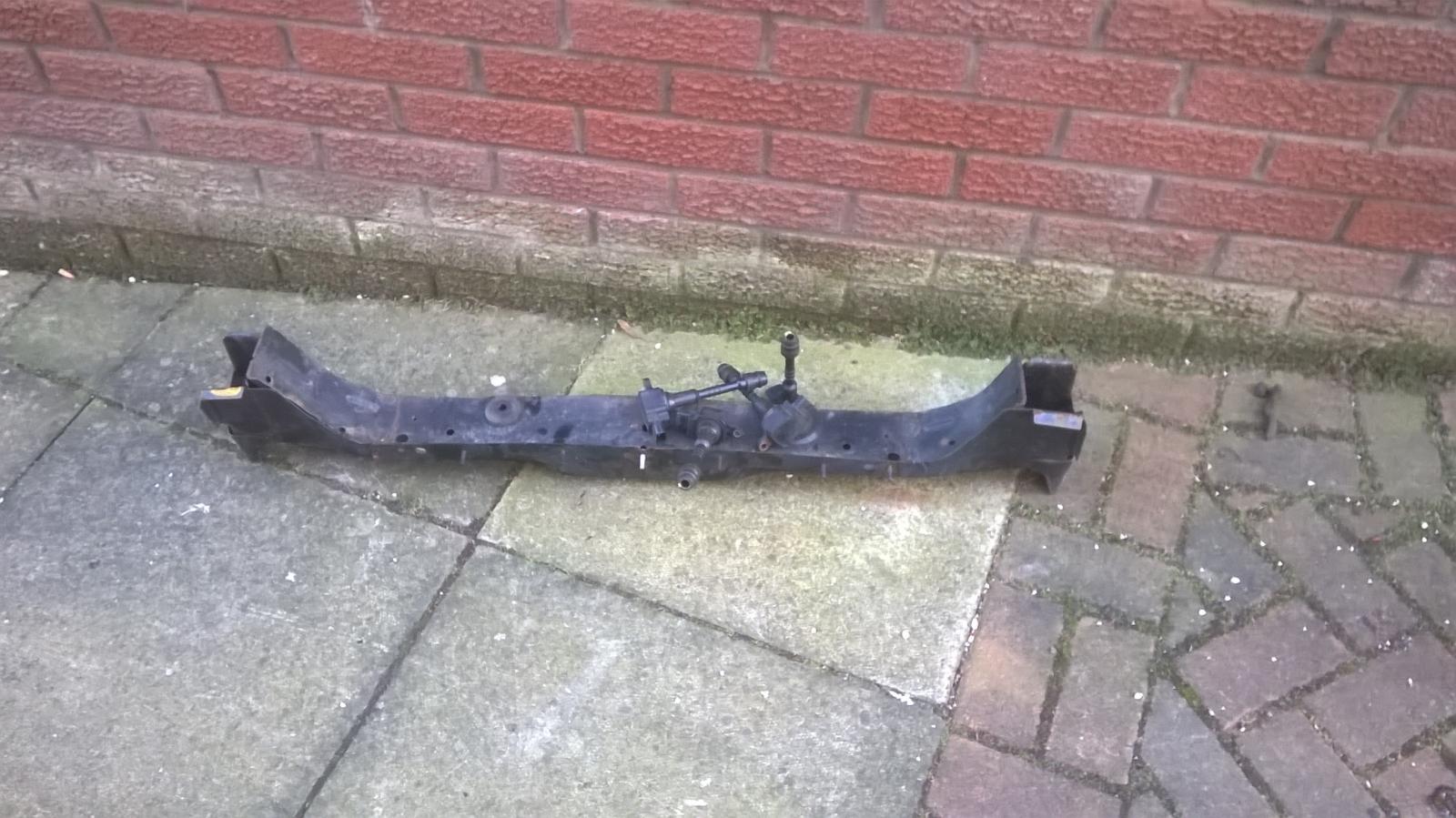

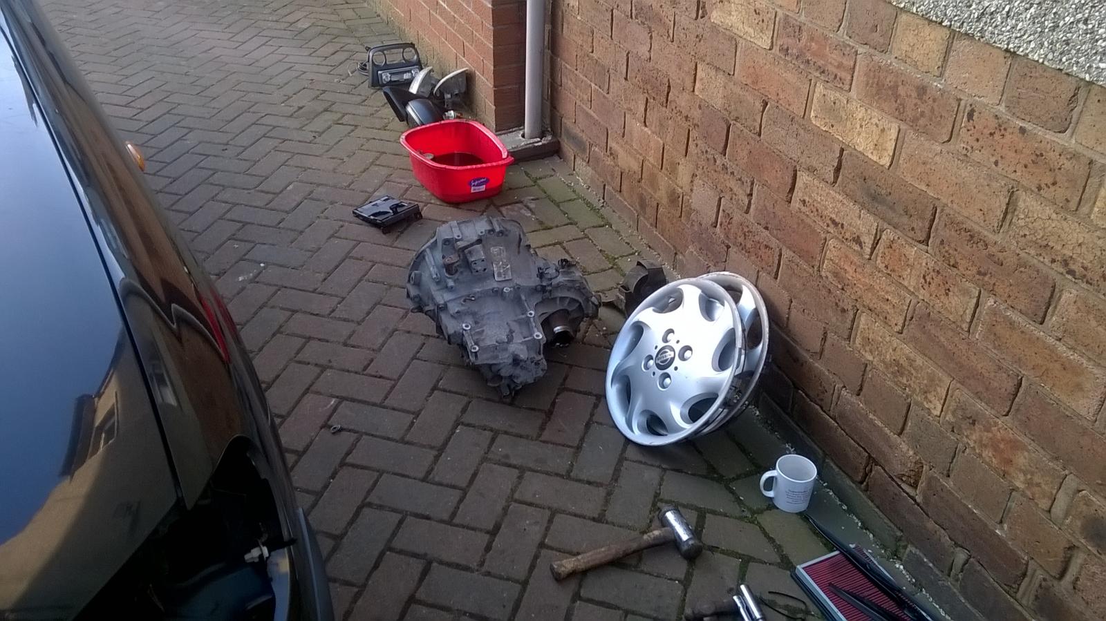

Anyway, stripped it today ( on call but quiet) and have the box out, very recent clutch in it, so that bodes well, and the oil was up to the mark and clean. As a Brucie Bonus it has a new front crossmember, which I need too, 2 new tyres,new front discs and pads and a Pioneer CD player, so this covered the cost of the car so far. I took a few other bits as spares to stash away.

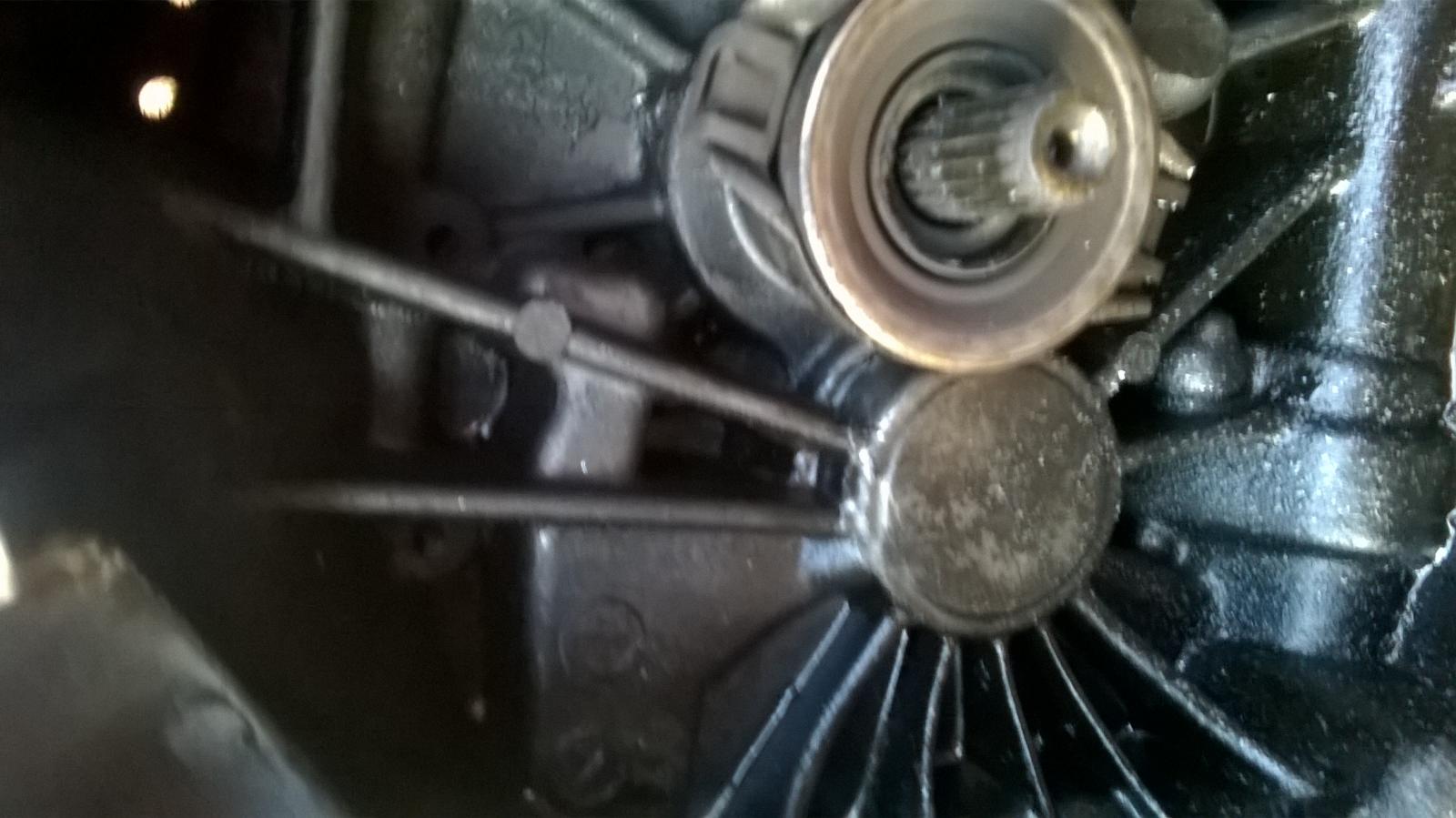

You can see the problem with the original, 51,000 mile box. Bearing has gone and cracked the casing. Oil was filthy, and filler plug seized solid. Clutch was worn right to the rivets too- dangers of buying a low mile giffer car. Crossmember was gone- just not there. engine crossmember was bolted to a scrap of rusty metal. Upside- all the bits are good on the black one. There is a 12v socket in the rear, but the cover has been broken off.

I'll whip the socket out tomorrow! Change the box oil- this is supposed to be changed every 2 years I believe. The fill/drain plugs seize up so tight they round off...
I've never heard or seen a front crossmember dissolve like on a Nissan. Cross models too, Micra, Primera, Almera. Do the newer ones like the Cashcow/Puke suffer the same? They must have painted them with water out of the North Sea.
No idea why they do it, both Almera's are as clean as a whistle, apart from the crossmembers. This subject can lead to fisticuffs on an MOT forum.....is it a fail.....or not. New cars don't tend to have crossmembers. Punto's were also rampant for it, but that was obviously just a bolt on radiator bracket.

Suck sess. New crossmember on today,new discs and pads,a quick oil change then hold breath for test run.
Smooth,quiet and rather nice. Happy.
After changing the gearbox on my 19-year-old N15, the crossmember on that was absolutely fine, and from what I could see also original.
I can see why they dissolve because they are in amongst all the shit and salt from the roads but it is odd that mine is still in good shape. Even the bolts holding it on at either end weren't seized. The drain plug on my replacement box was seized so we gave it a seeing to with a blowtorch and that freed it off. The old one was in pretty good shape actually so we recycled the old gearbox plug since it was in better shape.
