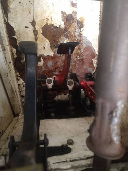

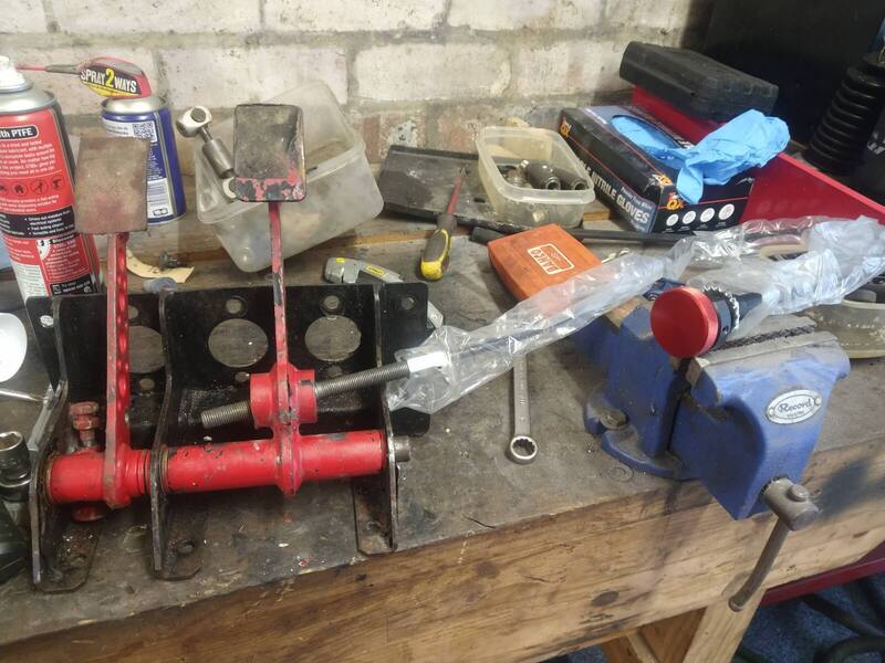

First up, the brakes. This runs twin master cylinders split into front and rear circuits and getting the balance right is a bit of a pain. When i got it the fronts did nothing. I adjusted it so it felt good, the MOT tester reported the rears did nothing!
i had a bias adjustable bar to add to fit which will make setup easier. Strap in and I'll try and explain.

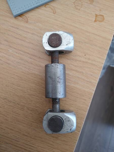

This is the brake pedal. On the right is the pivot, on the left is where this bar sat with a threaded rod which attached to a master cylinder on either side.

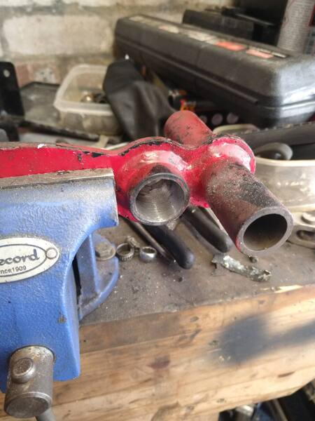

The rod.
The problem with this setup was that the only way of adjusting it was to vary how deep each master cylinder rod was screwed into the alloy parts. Not ideal.

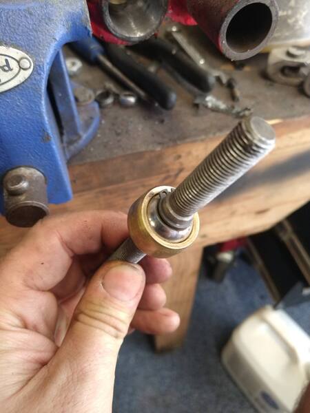

I had purchased a bias adjuster which looks like this
The brass part is mounted on a spherical bearing which allows the angle of the rod to change.
However, the brass part was too big to fit inside the tube on my brake pedal. I stuck it in a box and forgot about it.
Until last weekend!

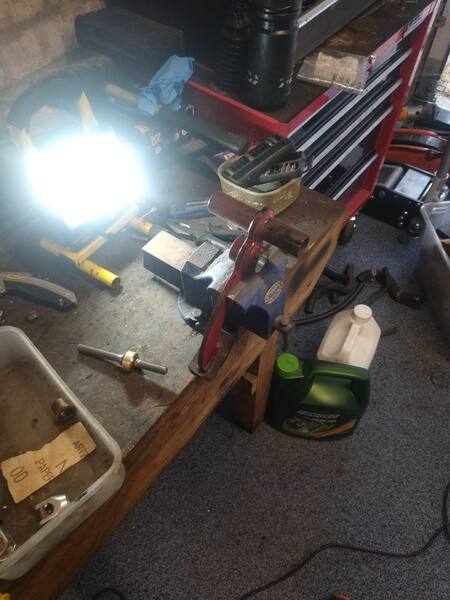

A selection of flap wheels were purchased and I set about enlarging the tube to allow the adjuster to fit.
The light here allowed me to trial fit it and see where I needed to take more metal away.
Eventually I got it to fit. Here it is back in the pedal box with a remote adjuster trial fitted. It was cheap to buy and who doesn't need a big shiny knob on their dash? I'll probably never adjust it once it's set up but at least it'll look cool.
Fitted back into the car and adjusted up (a clutch fluid leak has stripped the paint off the floor, that'll get attended to shortly)
Handily as its small with it up on axle stands i can put one hand on the brake pedal and one on a wheel to adjust it up. At the minute I've adjusted it so with gentle pressure the fronts are locked and the rears are just below the point of locking. The MOT tester can twiddle my knob to get the reading he wants to see on the rollers :)
You can see the two pivot points are not in line, this is because the back brake (Right as viewed in the pic) has very little movement to engage compared to the front (left) The way the pivot has been adjusted (towards the right) means when you apply the brake the front moves in more than the rear.
It's not perfect-with the brake set up like this it's adjusted almost all the way to the rear so i may need to rethink things a bit. The weather is shite up here just now so that can wait.

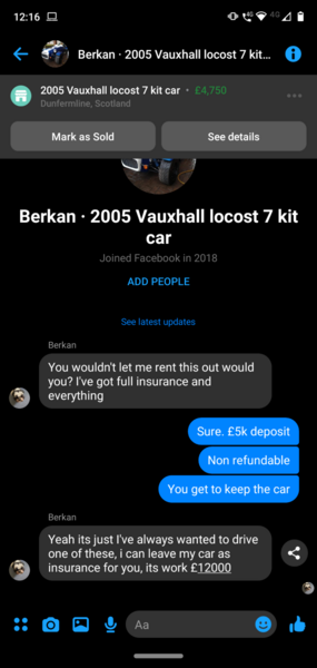

It's been advertised and naturally the idiots are coming out of the woodwork...
I reckon slightly different paint job, full rollcage and I'd be willing to rent it from you whilst leaving my £0.5k car as collateral.
On a more serious note, I think you've underpriced it. All the other ones on at the same price have smaller engines, less love and fewer spares.
