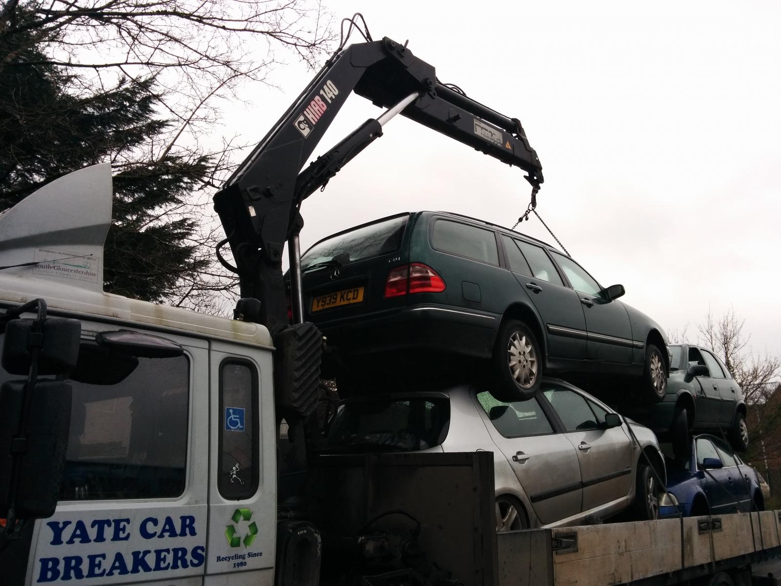

Down at the local pull-your-own part scrapyard yesterday, another E320 had met its fate...
Had more holes in the body panels than a colander. Interestingly the MOT hasn't expired.
That merc has not even had an rust advisory or fail on the mot.
