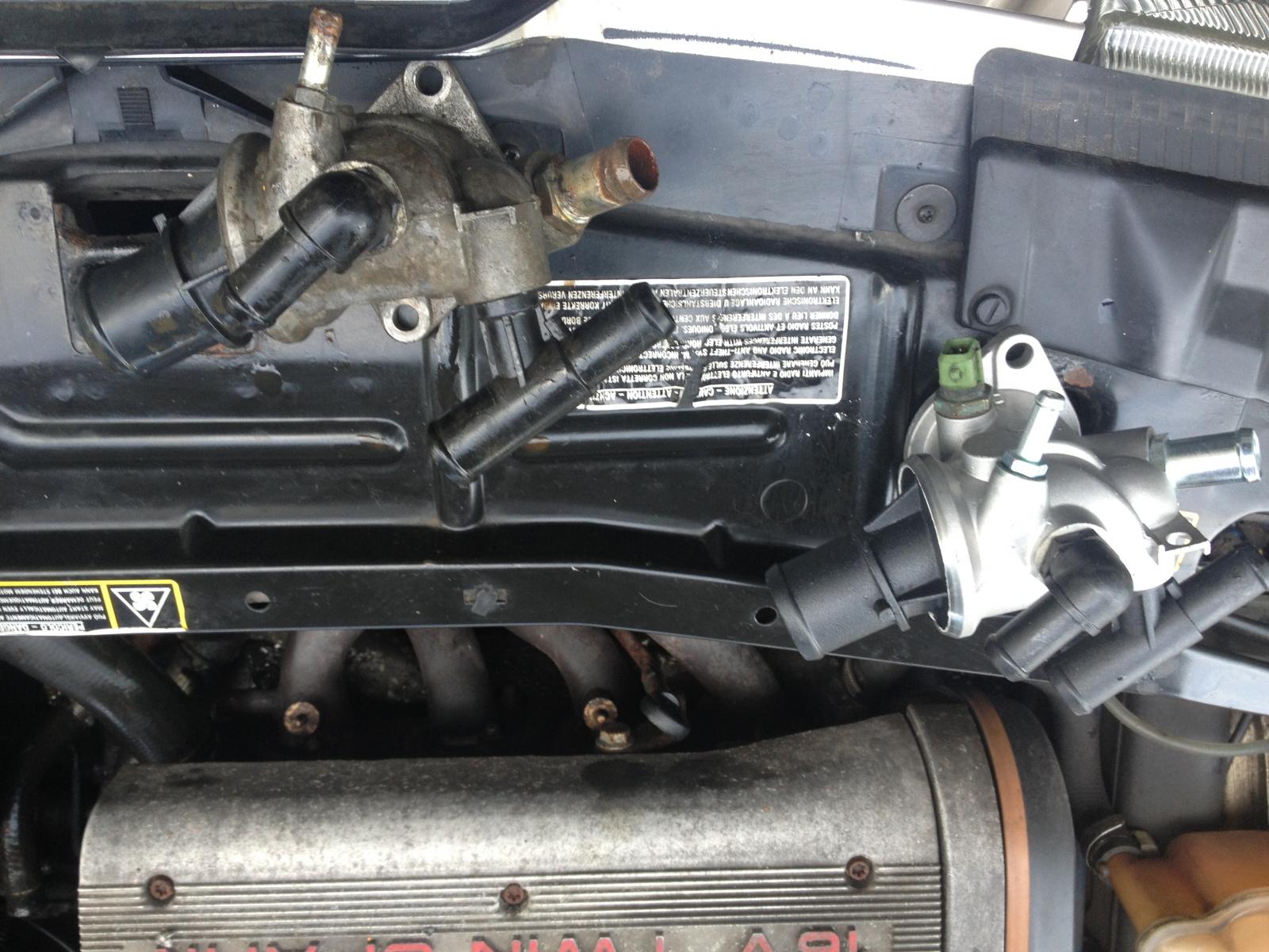

These Alfa 'stats are always stuck open. Think they are made by Vernet or someone? Anyway, they're expensive (£100+ on the JTDs) and a faff to change.
I fixed the problem on my last two 156s by pushing a 70s Renault 5 'inline' thermostat into the top hose. They are easy to get on ebay and cost a fiver- works an absolute treat. Get the hottest you can, 88°c I think.
It also has the added benefit of really annoying people on the Alfa forums  :-D
Time to pop a 'stat in, Neil?
Stat may be built into housing based on what I can find.
coolant looks manky, so cheeky clean and see where we are at first. Some folks have flushed and got back normal function.
failing that £23 for new body/stat combo:)

I changed the one on my 156 JTD, it was a total pain in the arse, there's a big heat exchanger bolted on to it for the EGR valve, looks like a mini steam engine boiler with tubes going through, and having the five cylinder JTD access was tight. I wish I'd known about the inline thermostat would have just done this!

These 'stats do come as part of the housing, the one in my 155 is similar ( and was similarly borked 'till I swapped it out)

I'm sure the inline stat will work in so far as it will stop the coolant getting to the radiator, but surely the stat housing is made that way for a reason?
What functions are done by the various spidery bits coming off it?
I considered the inline bodge for our 147 but just got over myself and ordered the correct one.
It was a Circoli spesh from Euros for a shade under £35 with a discount code.
It didn't look mega qualz but the car warms up properly now and it hasn't leaked yet so we'll see.
