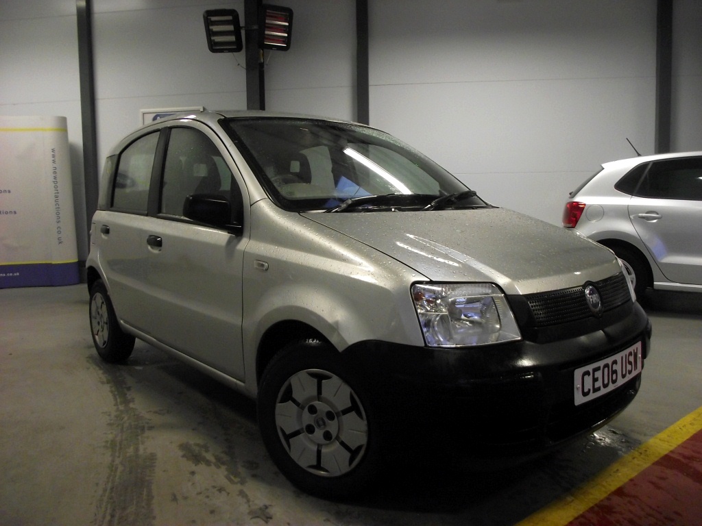

I haven't seen the car yet let alone driven it, bought it at auction using live bid having only seen a couple of photos
Did test drive a brand new one a few years ago and quite liked it though
